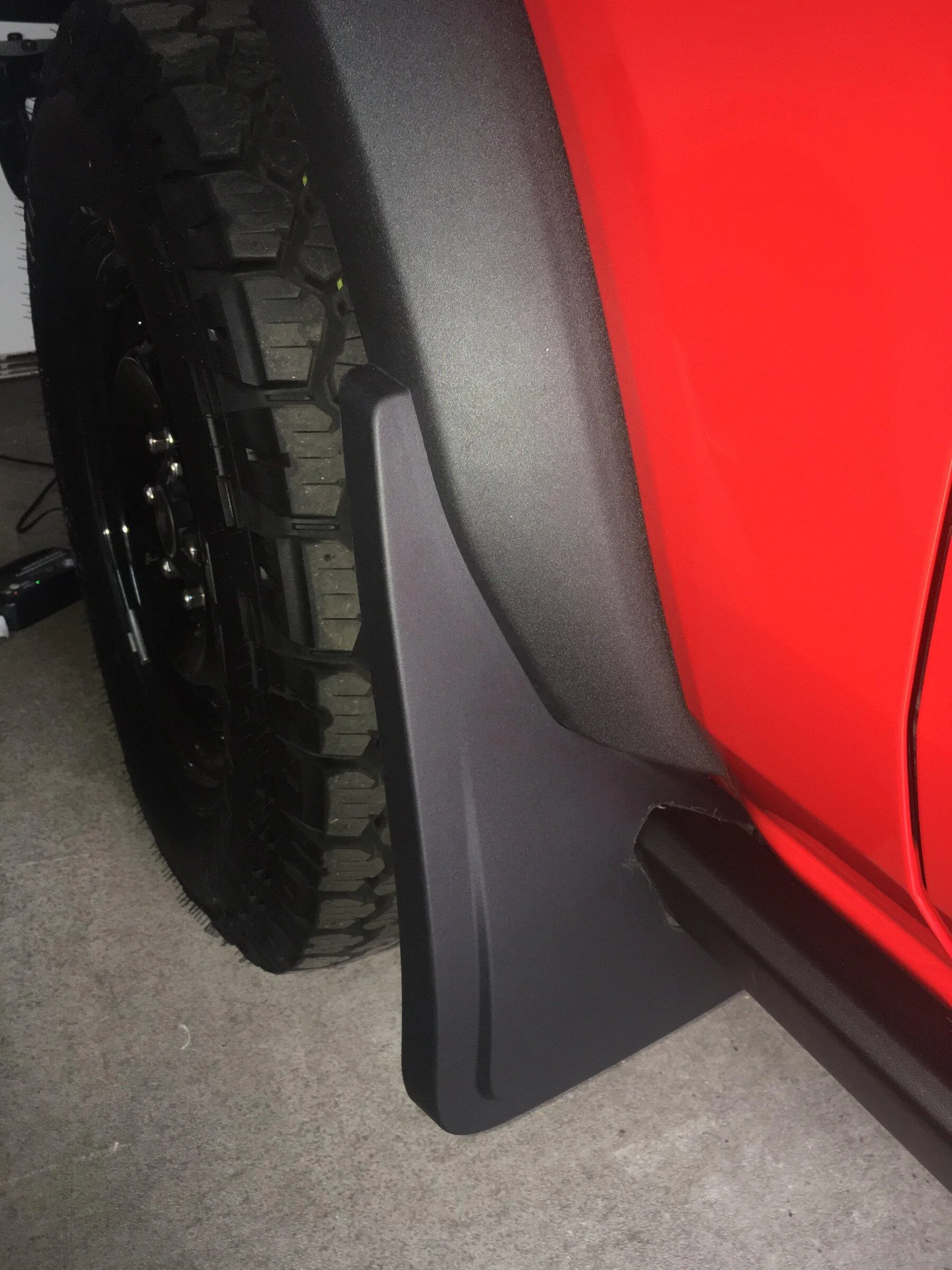

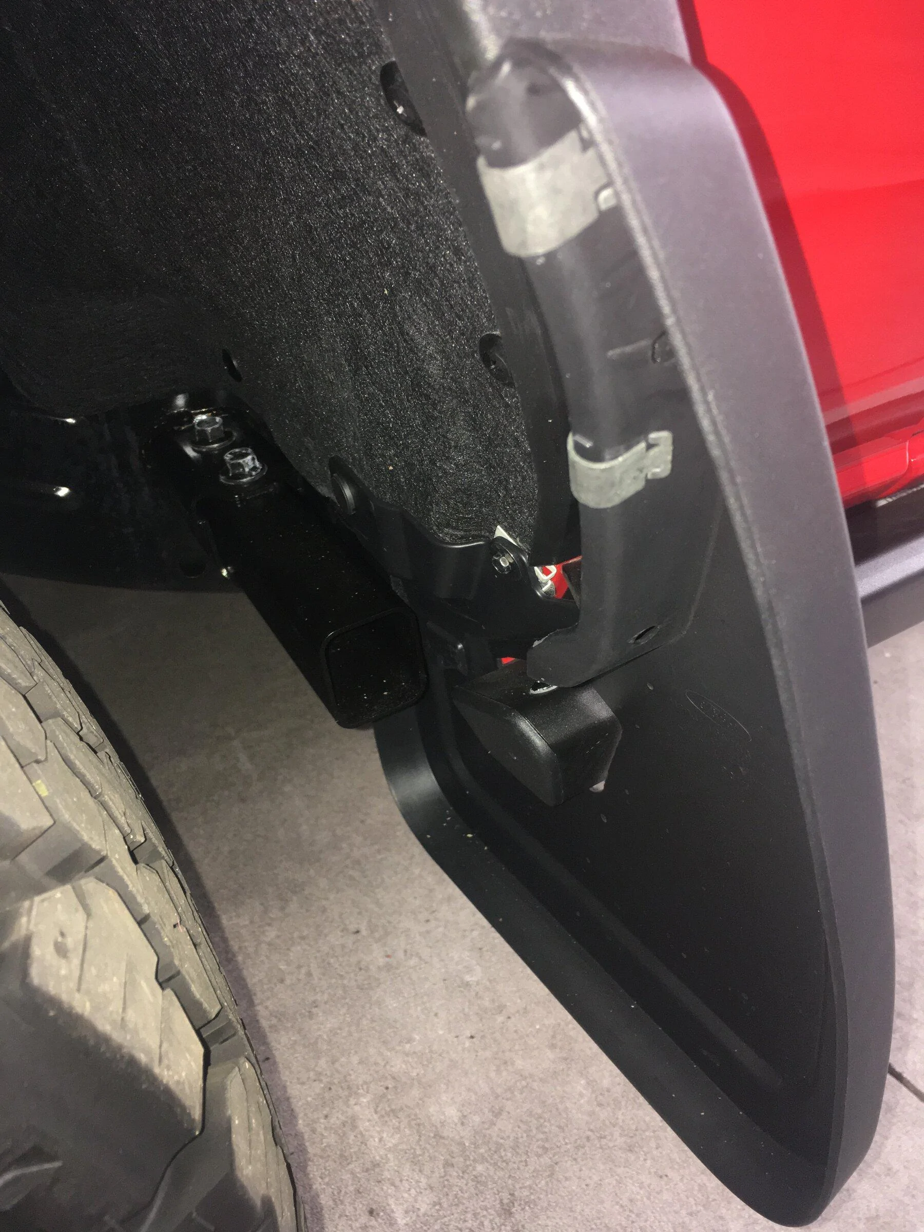

I used the Ford flaps on the front only and did not drill for the 2 supplied pins that would have gone through the fender flares.
They seem to be sturdy enough without the pins.

I didn’t drill holes in the fender flares because I wanted to have the option of removing them, or if they came off, not having holes visible. The clips supplied, as shown in post #4, very securely hold the splash guard to the fender flare. The other two bolts replace existing bolts. I’ve had mine on for almost a year and have been off-road with them at least 20 times.
