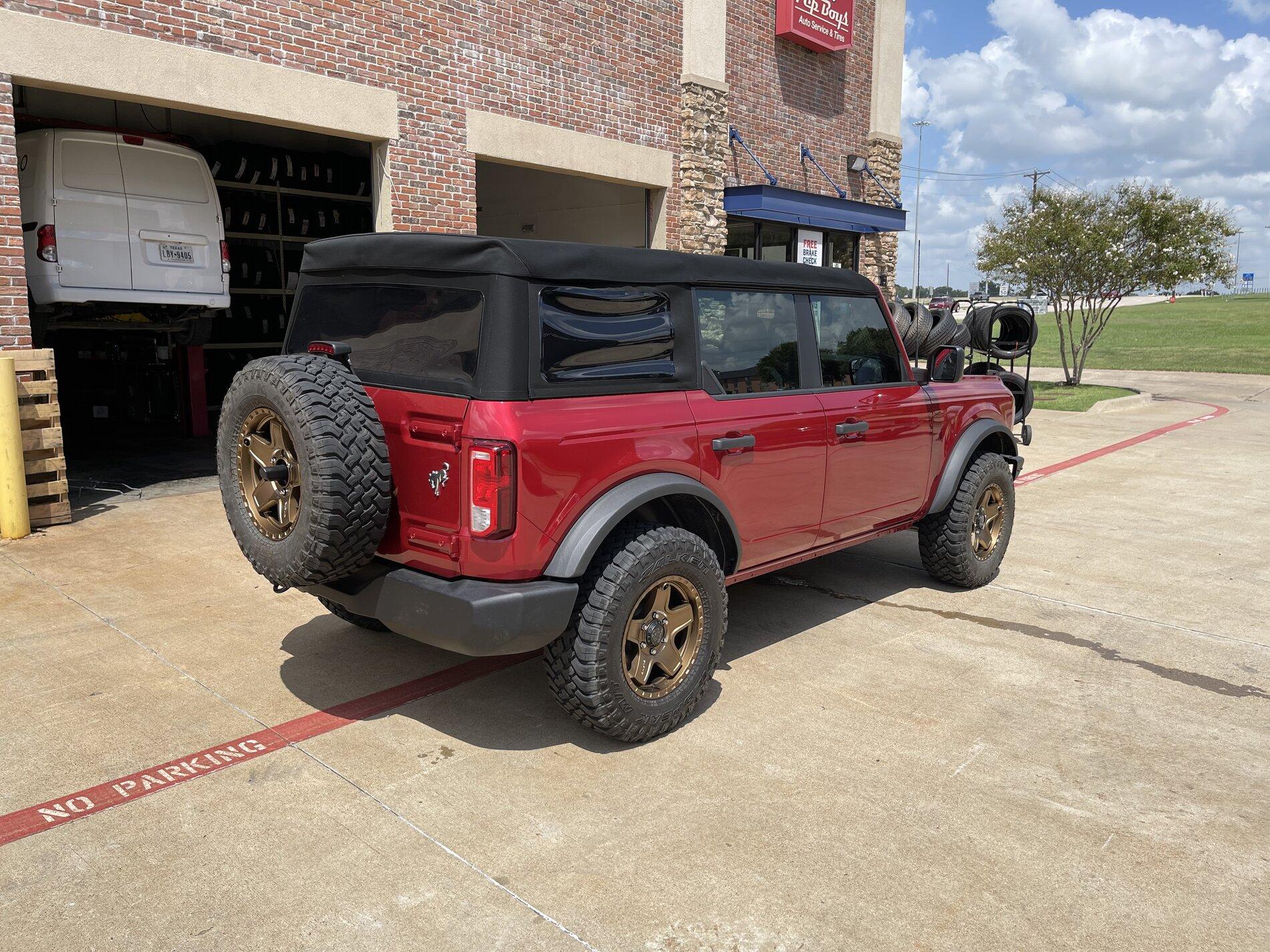

I have a base, base 4 door Bronco. I wanted to upgrade tires to 33s and replace the base steelies.
For tires, I was able to find take offs in my area from several new jeep owners. I got a set of five Falken WildPeaks.(285/70r17) for $600 with less than 5k miles on them. They look new.
For wheels, this was a real struggle. Most wheel companies are not set-up for the Bronco yet, Discount Tires include. Several will not let you buy them without verifying fitment by entering your vehicle which blocks the process(Discount Tires).
TireRack does have the Bronco configured for wheels and tires on their web site. I was able to easily find a set of wheels(w/lugs) that I wanted, verify fitment, arrange delivery to a local installer and schedule an install appointment. Wheels and tires are going on this Saturday.
Wanted33

@timhood Tim, I showed several to the bride, and she picked the Fuel Shok 17x9 +20. I still undecided right now as I'm between those, or just trying to pick up a set of Badlands take-offs. Matt helped me with the offset as I'm quite uneducated when it comes to that important detail. My build is so far off I'll probably change my mind as least 1M times before it's all over.

Bronco6G has a 6 lug x 5.5 (139.7 mm) pattern and a 93.1 mm hub bore diameter.
The factory offsets range from +55 mm to +30 mm SAS.
I'd stay within a 8"-9" rim and +30 mm to 0 offset.
This will keep it close to the OEM travel line.
I have 17x9 +25 mm 106.1 mm hub bore and will put 285/70R17's on them.
I have hub centric rings 106.1 to 93.1 installed.
https://lugnutguys.com/products/hub-centric-rings-106mm-to-93-1mm-set-of-4
This link should help a bunch for offset and rim/tire selection.
My OEM and Modified set up is in the link.
https://tiresize.com/wheel-offset-calculator/
No salesman currently recommends going larger than an 8" rim.
IMO 9" will work fine.

@Jsullivan Jay, another thing I don't understand is hub bore. I'm looking at an Icon Rebound 17x8.5 +25 w/108.1 hub bore. I'm just not sure what difference that that hb bore will make. FYI, i'm having to check the Ranger sizing as the Bronco isn't available yet on the site I'm looking at. Thank you for any help you can give. As I said, I'm quite wheel/tire sizing challenged. :)

You will need to make sure you can get hub centric rings to close the gap in the 93.1 bore on the Bronco vs the wheel bore.
https://www.ebay.com/itm/222278860242
Here is a link to aluminum rings.
I prefer plastic but I didn't do an indebt search.
Hub Centric rings will allow your wheel to sit symmetrical over the hub.
Probably?? The rim you choose will be lug centric but I always like using the rings.
I believe the OEM rims have a 60 deg seat for the lug nuts.
Be sure to get the lug nuts that will work with your wheels.

shityea dude alpha! I just ordered alpha deltas for mine. bronze too!
I was supposed to get black lug nuts with the wheels but they shipped me chrome. Something to check.
