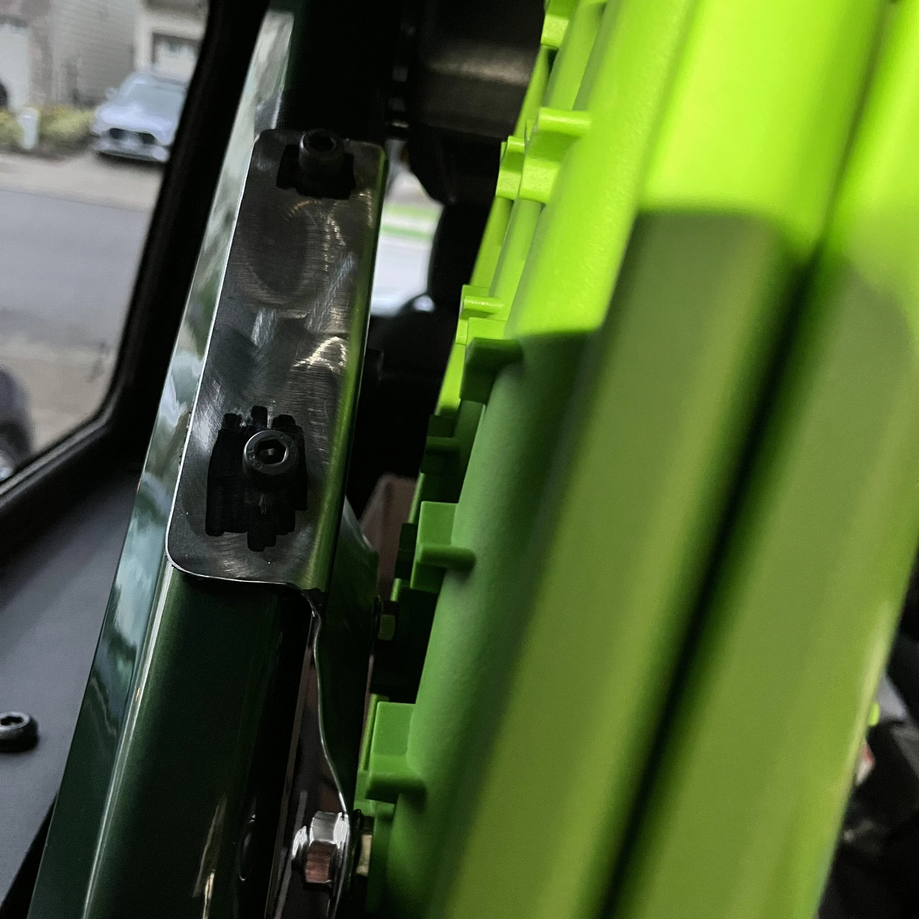

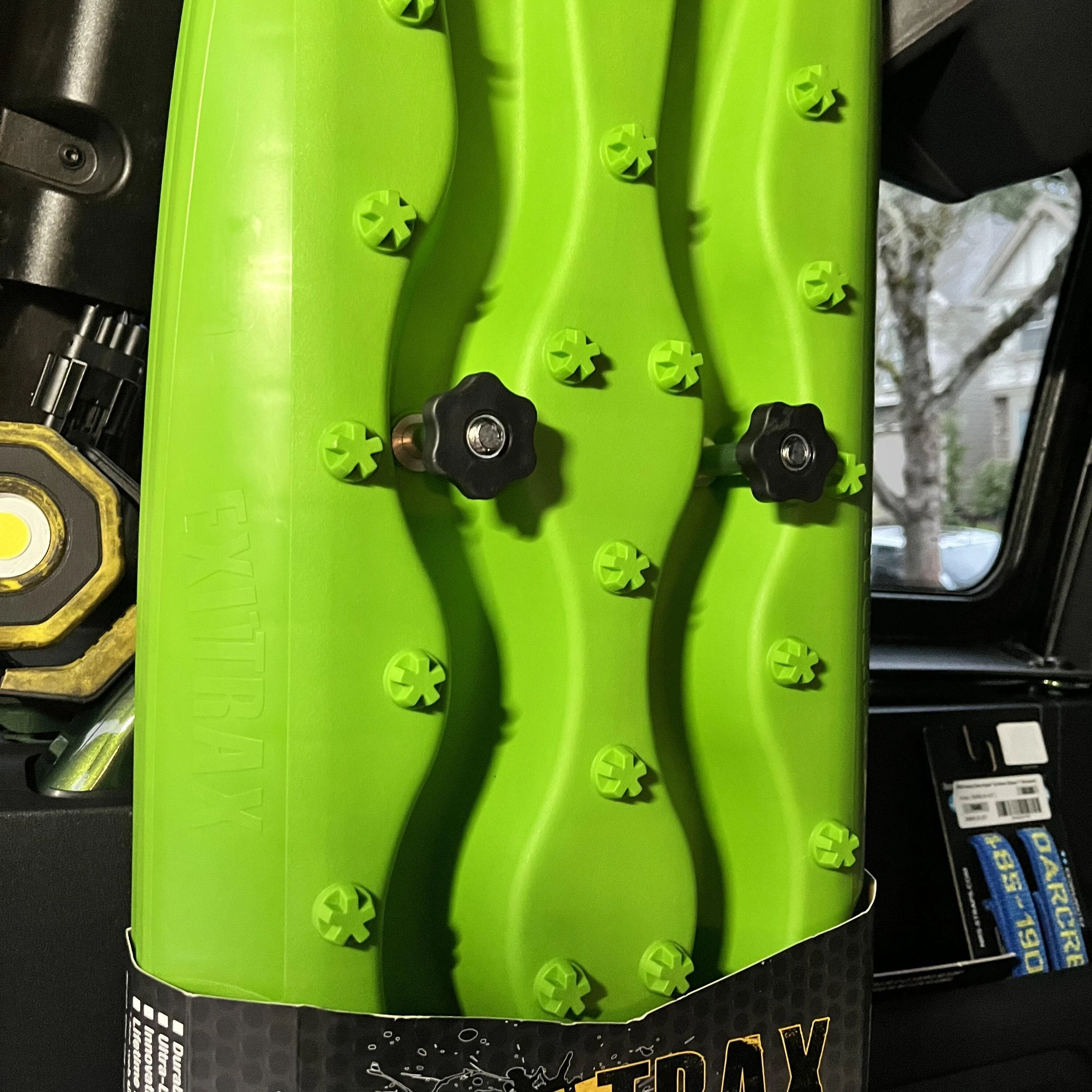

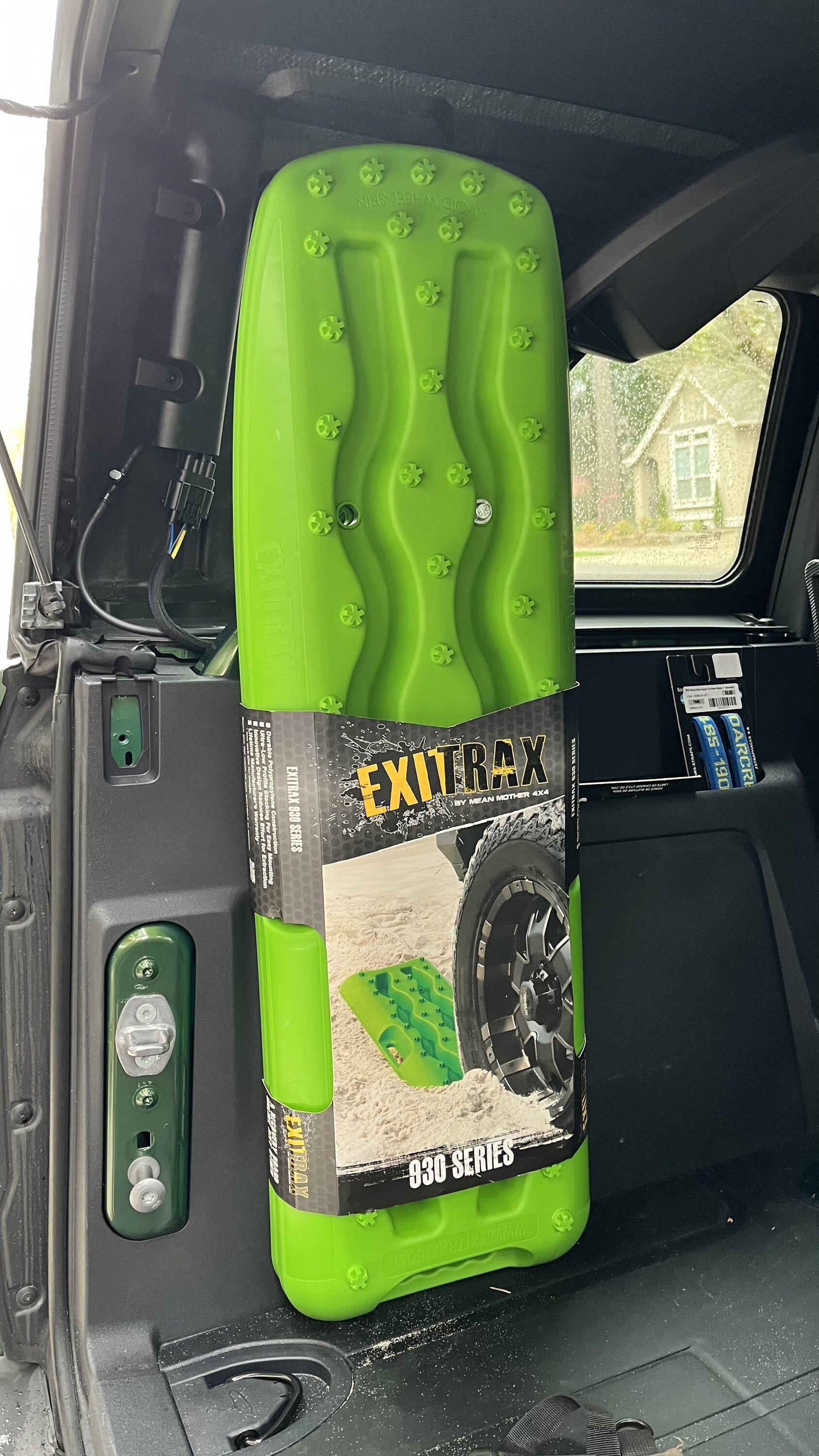

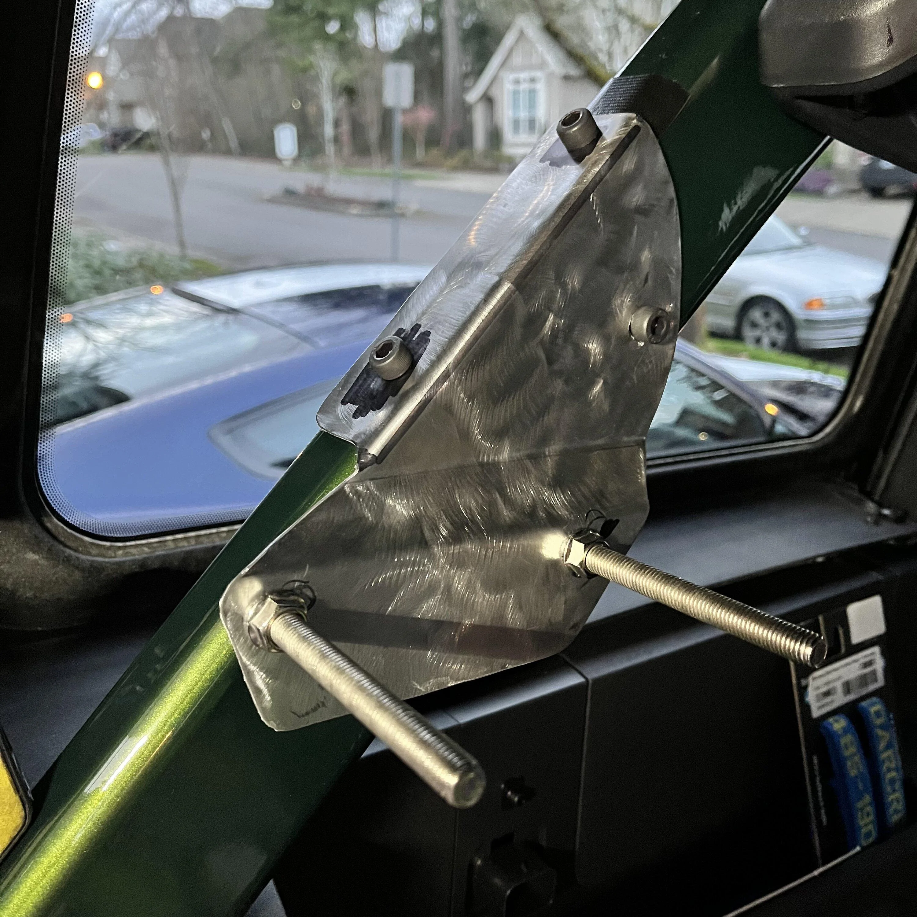

I’m trying to keep the external attachment to a minimum so I opted for the Exitrax 930, which are their shortest boards. From what I can tell the Exitrax are very well made Australian boards, not some cheap stuff off eBay. I’m sure someone will correct me on this.
I’m going to have a fridge on the passenger side so I looked at how to mount the boards to the opposite side.
I’d call this of a prototype as there are some things I’d change. I might make the bracket wider and use both mounting holes on the board. I need to see how much they rattle. I’m also using 22 gauge steel which is about as much as my power shears can handle.
I believe the Exitrax use the same mounting as Maxtrax so I may look at that solution. Right now I just have a bolt and some spacers.
I’d love your feedback.

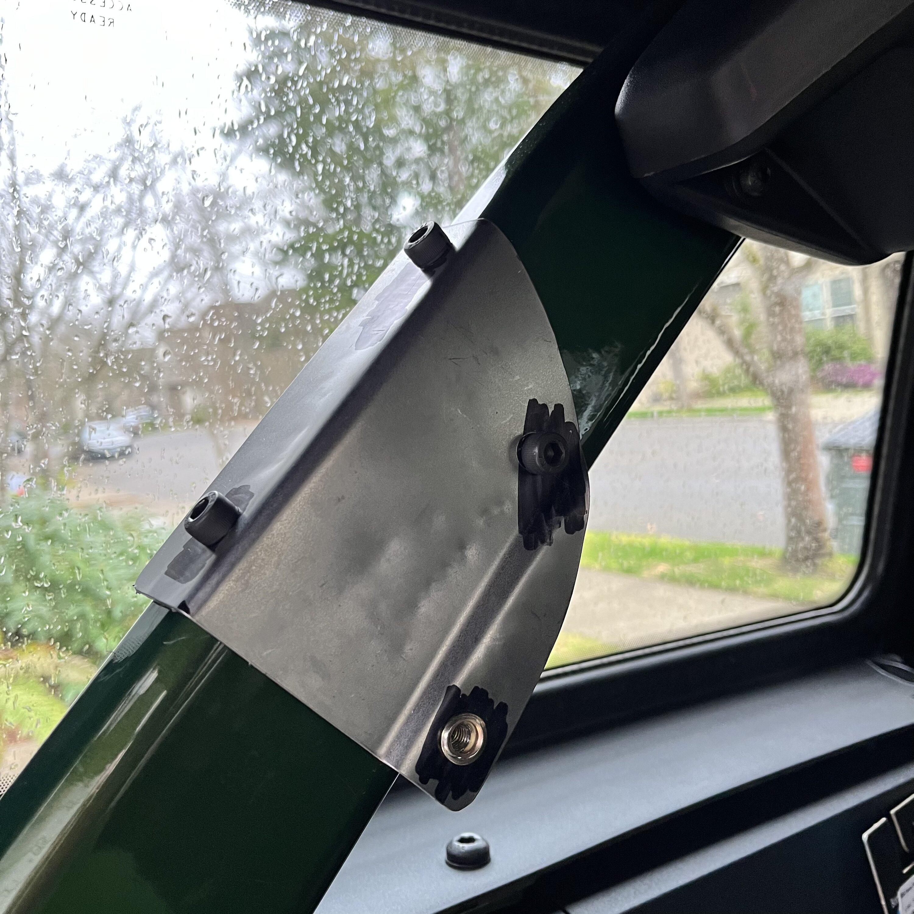

Version 2. Bought some mounting screws for Maxtrax. They don’t really work well with the Exitrax but I made them work. The single bolt was probably plenty sturdy enough. I never heard the boards even rattle. I think the last change I’d make is to the spacer on the bolts. And maybe paint the bracket black.
