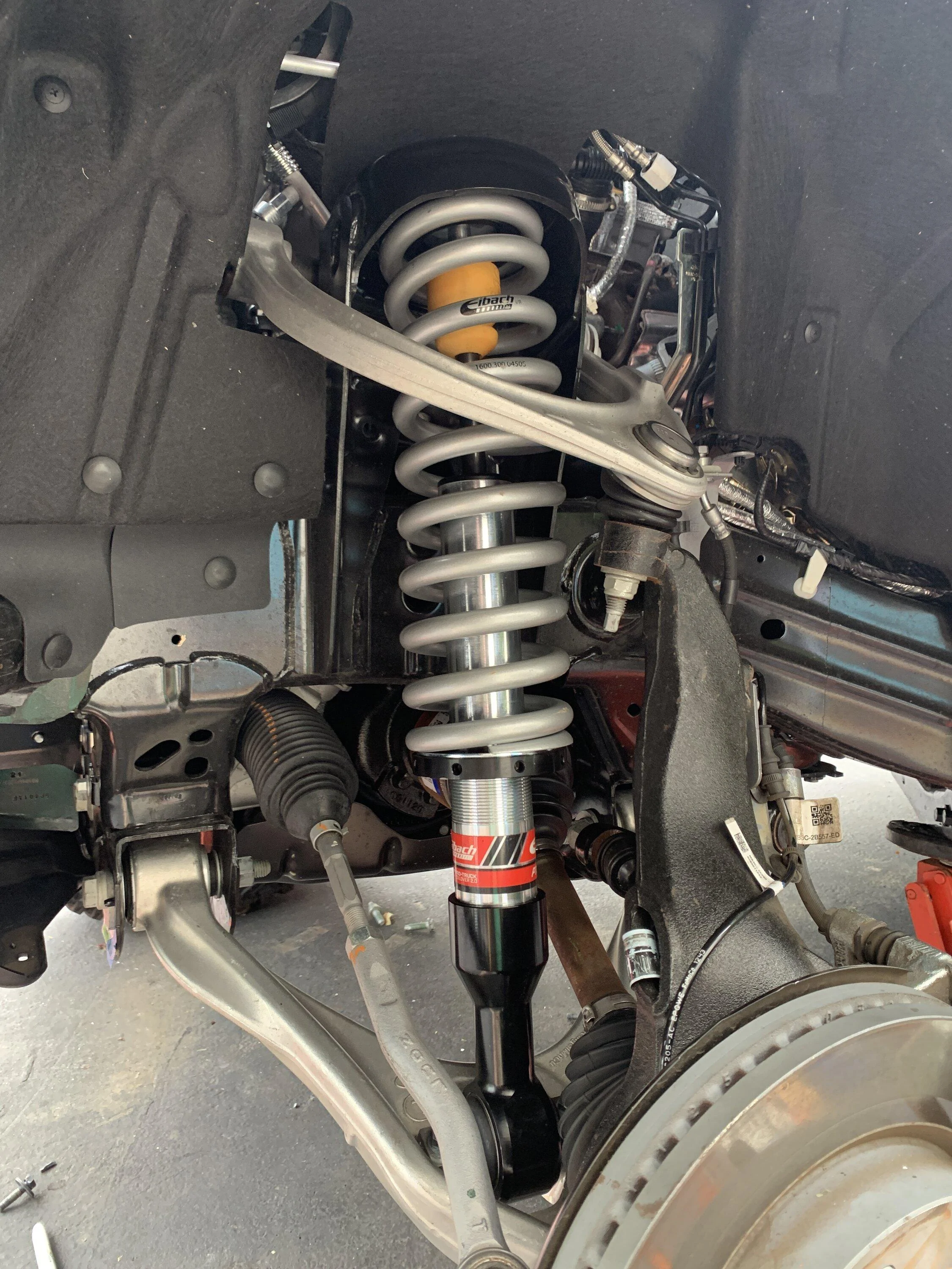

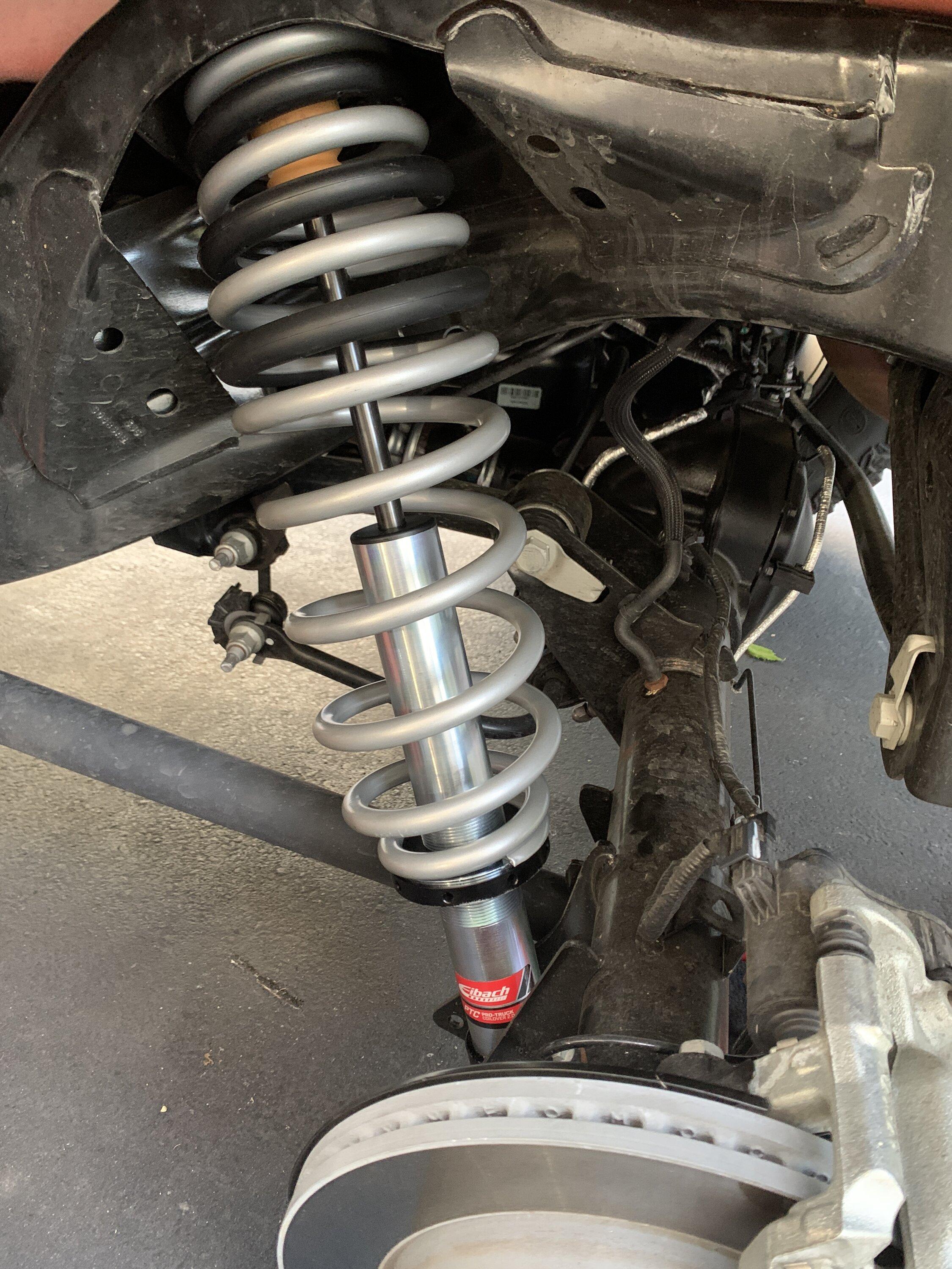

Has anyone installed or reviewed these coilovers as compared to the stock SAS suspension?
I installed them last weekend. They ride a bit softer than the Sasquatch shocks. They also have a bit more bounce to them. Feels like the spring rebound is stronger. On road it is just as comfortable, but different - bumps are less pronounced, with less rear axle hop in rough corners.

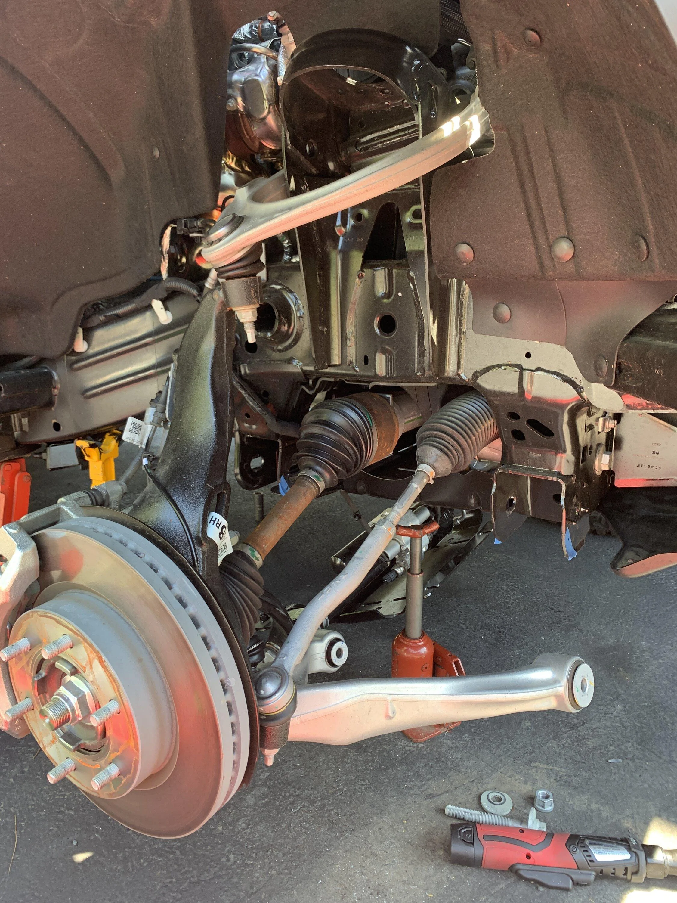

When the shocks arrived I didn’t know what to do with respect to the collar height. So I installed them the way they were adjusted in the box. Without changing the spring perch height, the truck was lifted about an inch and 3/8. I adjusted the perches so that there was exactly 1 1/2 inches of threads below the collars. With that many threads exposed, the bronco was raised exactly 2 inches over the height of the standard Sasquatch shocks that were in it. Looks like they’re still another inch or so left to raise it if needed, but for now it should clear the 37’s (KO2s) I’m going to install next week.
I found the easiest way to install them was just to remove the stabilizer bar assembly and then the two bolts for the lower control arm at the frame. Be careful of the wires on your stabilizer bar, I had mine supported with jackstands but when moving the arms I wound up knocking it off. Foolishly I didn’t unplug the harnesses first, and I wound up tearing one of the harnesses out of the Molex connector. It’s been a major struggle to find which connector with a pigtail on it I can use for a simple repair.
