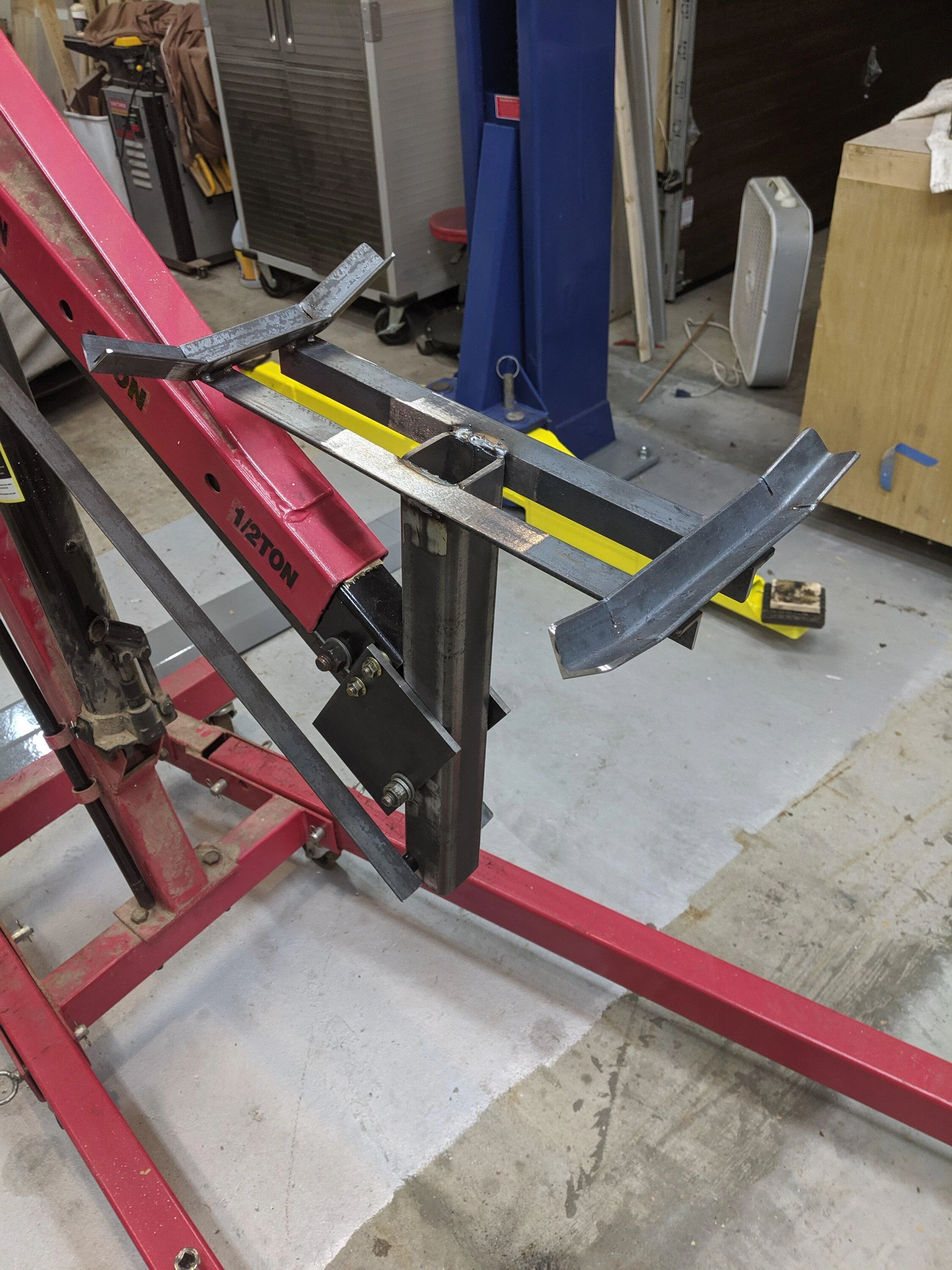

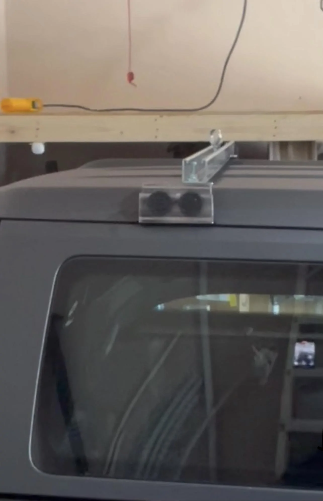

I built a roof lift with a pice of electrical strut and some angle iron it bolts on in a min and I left my top off.
Do you have any pics of the angle iron piece that goes into the hardtop slot? Is it 90 degrees? I’d love to make a setup like this.

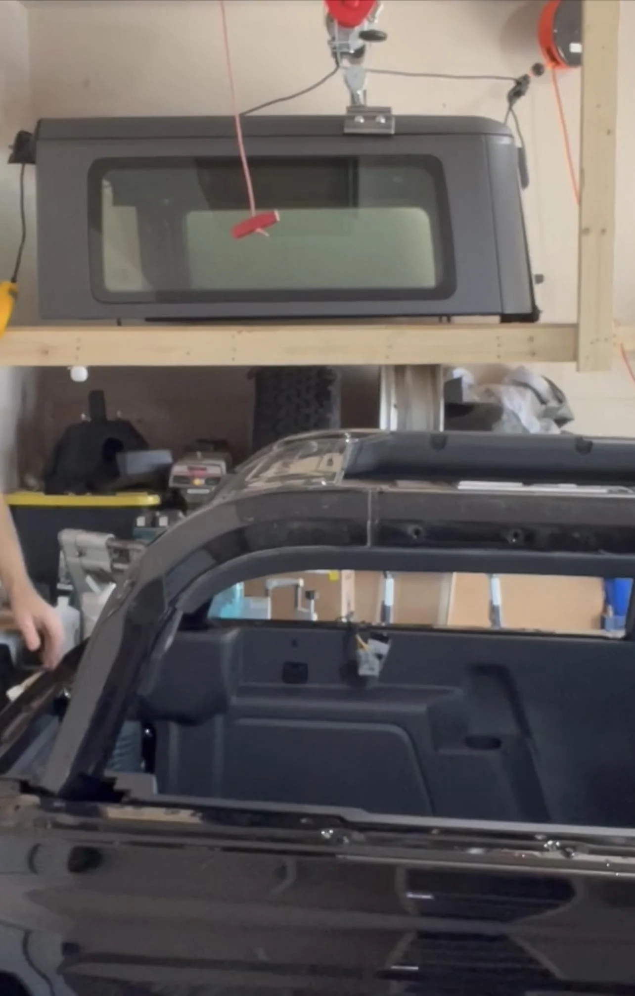

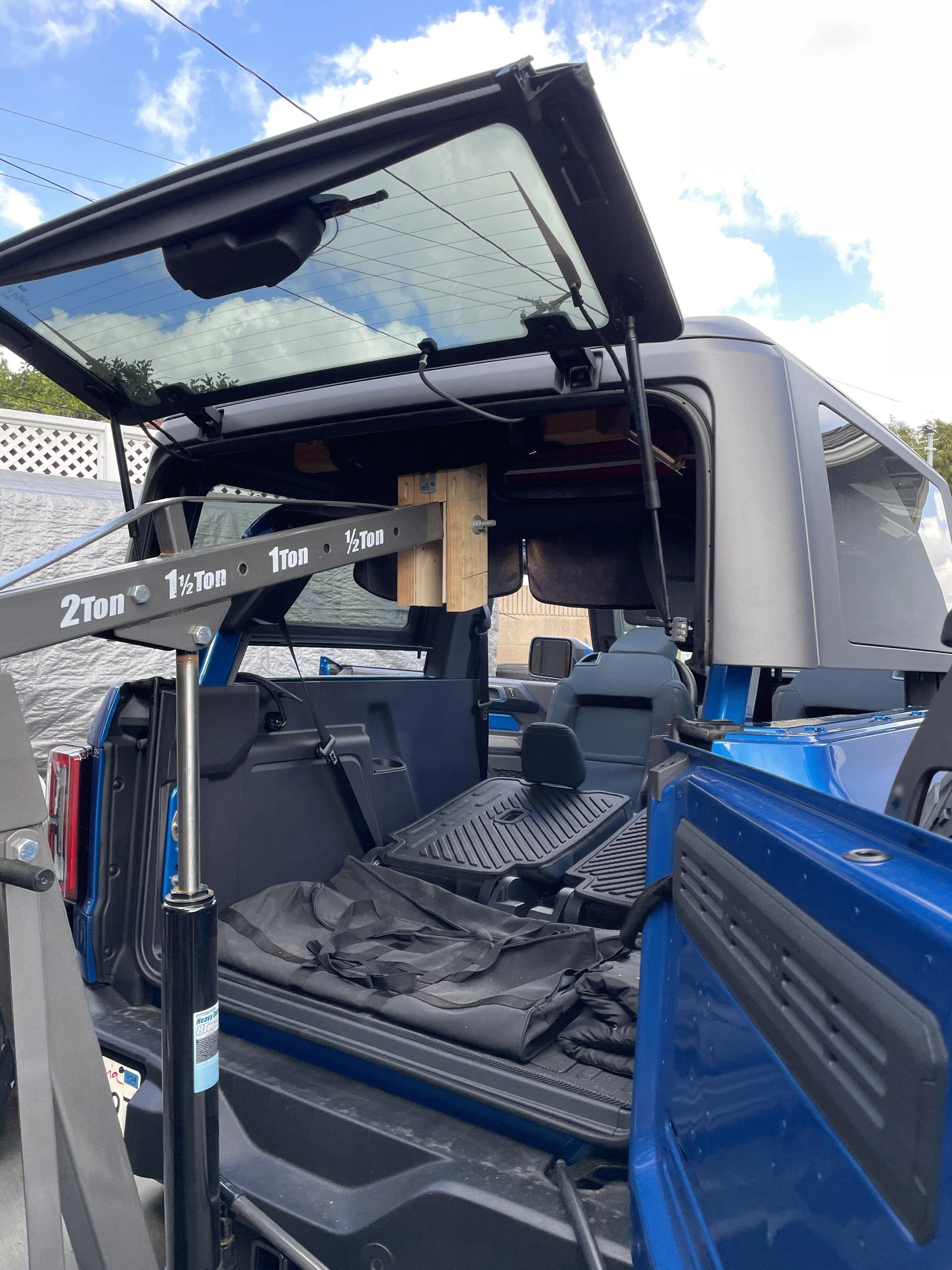

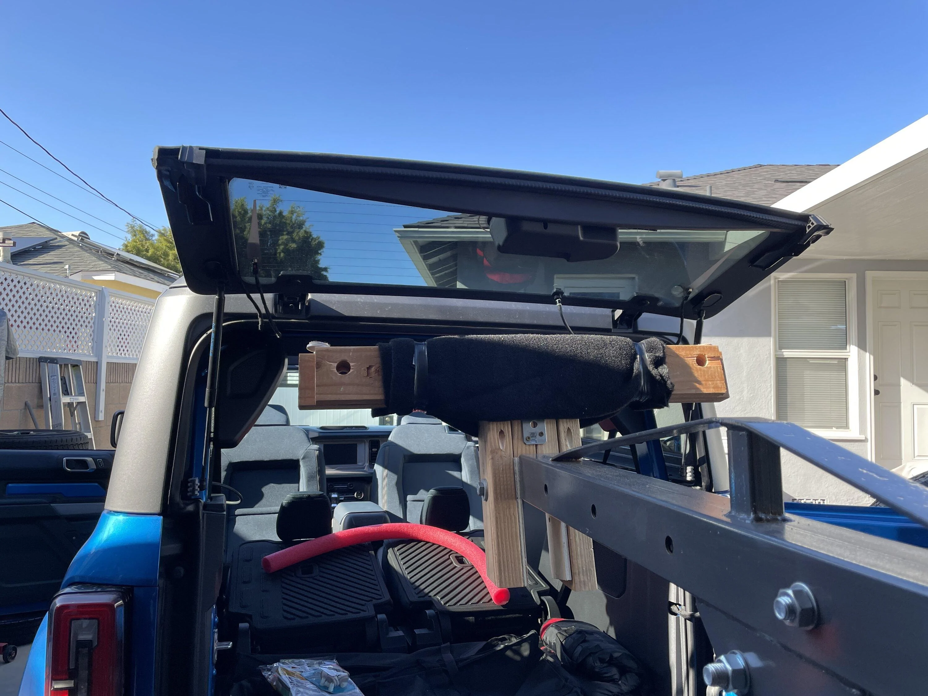

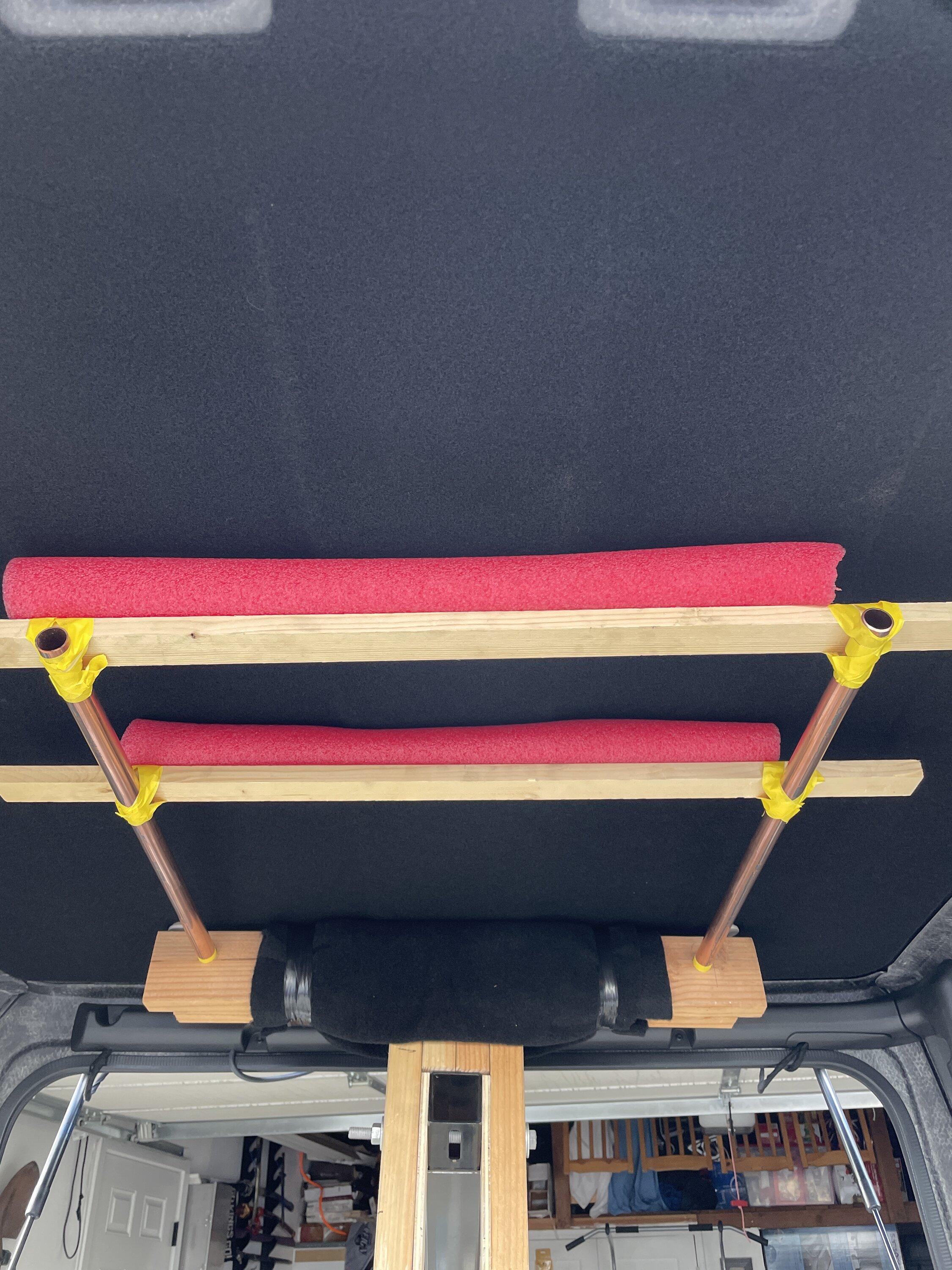

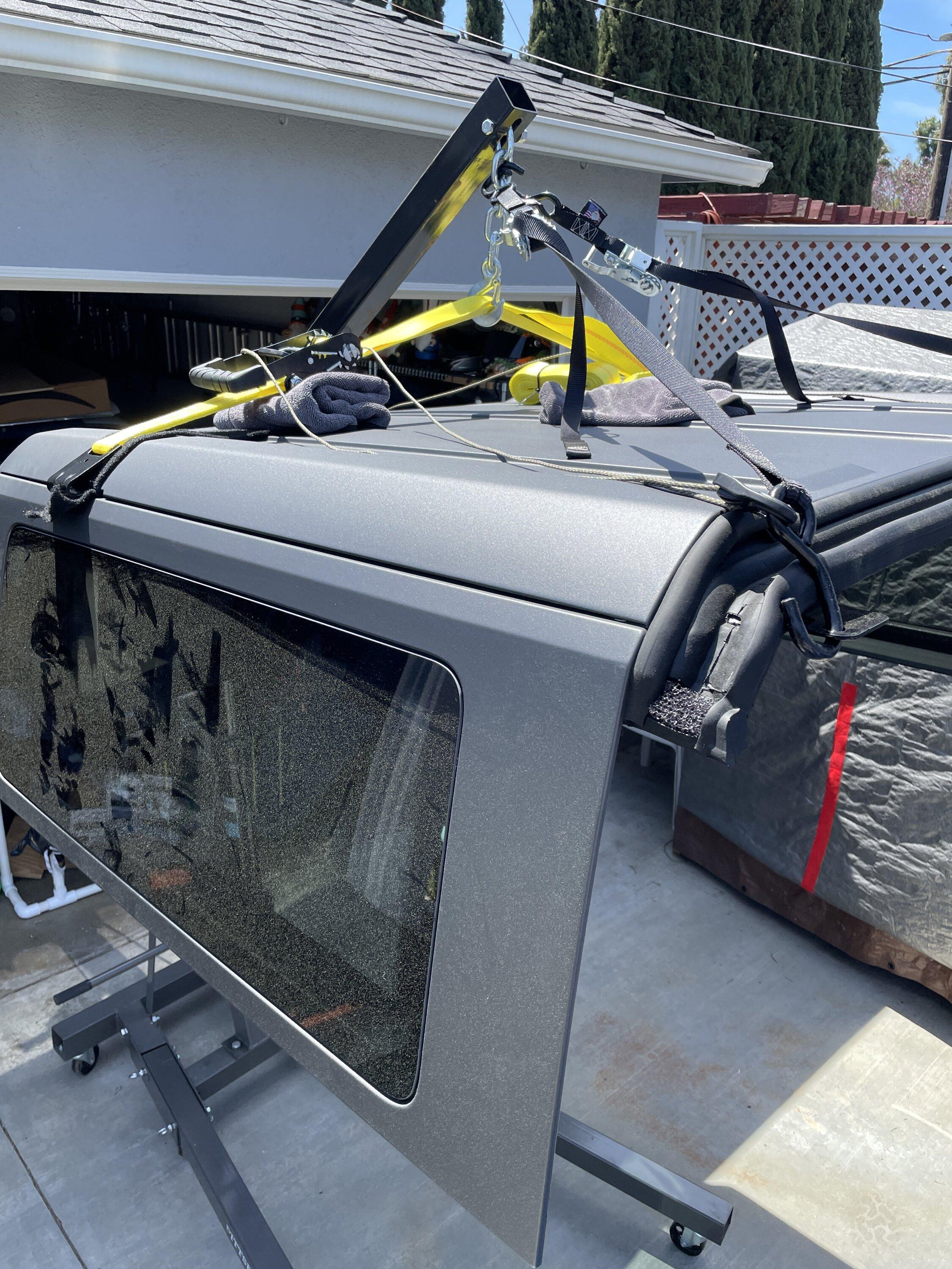

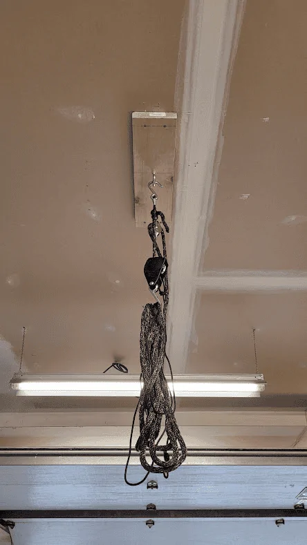

Change of plans With the addition of Jtops Bimini I could not easily use supports under the roof top, so I used some straps to hoist the roof from above...
Ford Bronco Dumb or brilliant idea for help removing top?? 06E712AE-2DDC-409D-8570-2D4FAF7E6EC9
Ford Bronco Dumb or brilliant idea for help removing top?? F2823D5F-0EAD-4962-AC92-38179EAC304B

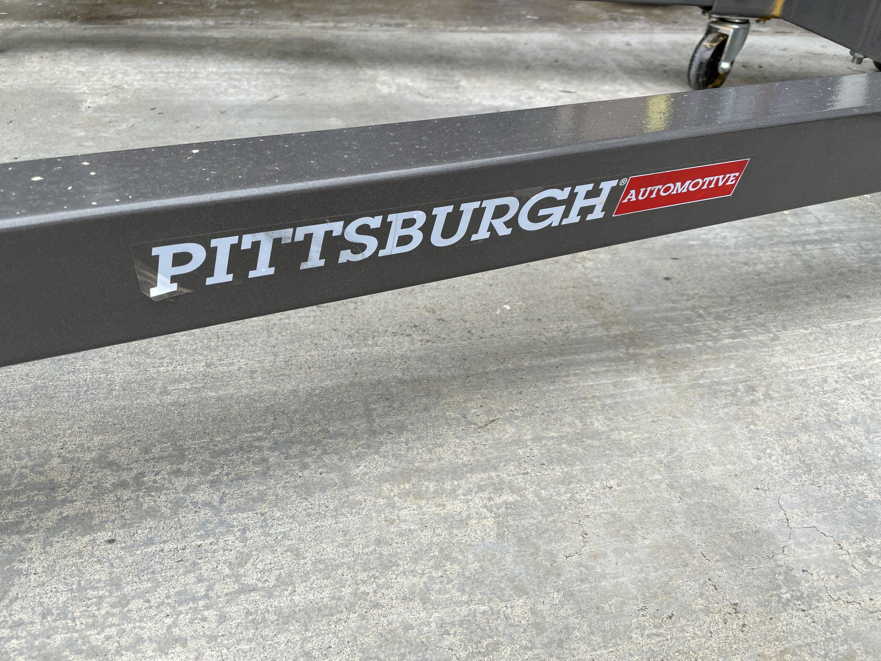

I was wondering if an engine hoist would work
what hoist are you using?

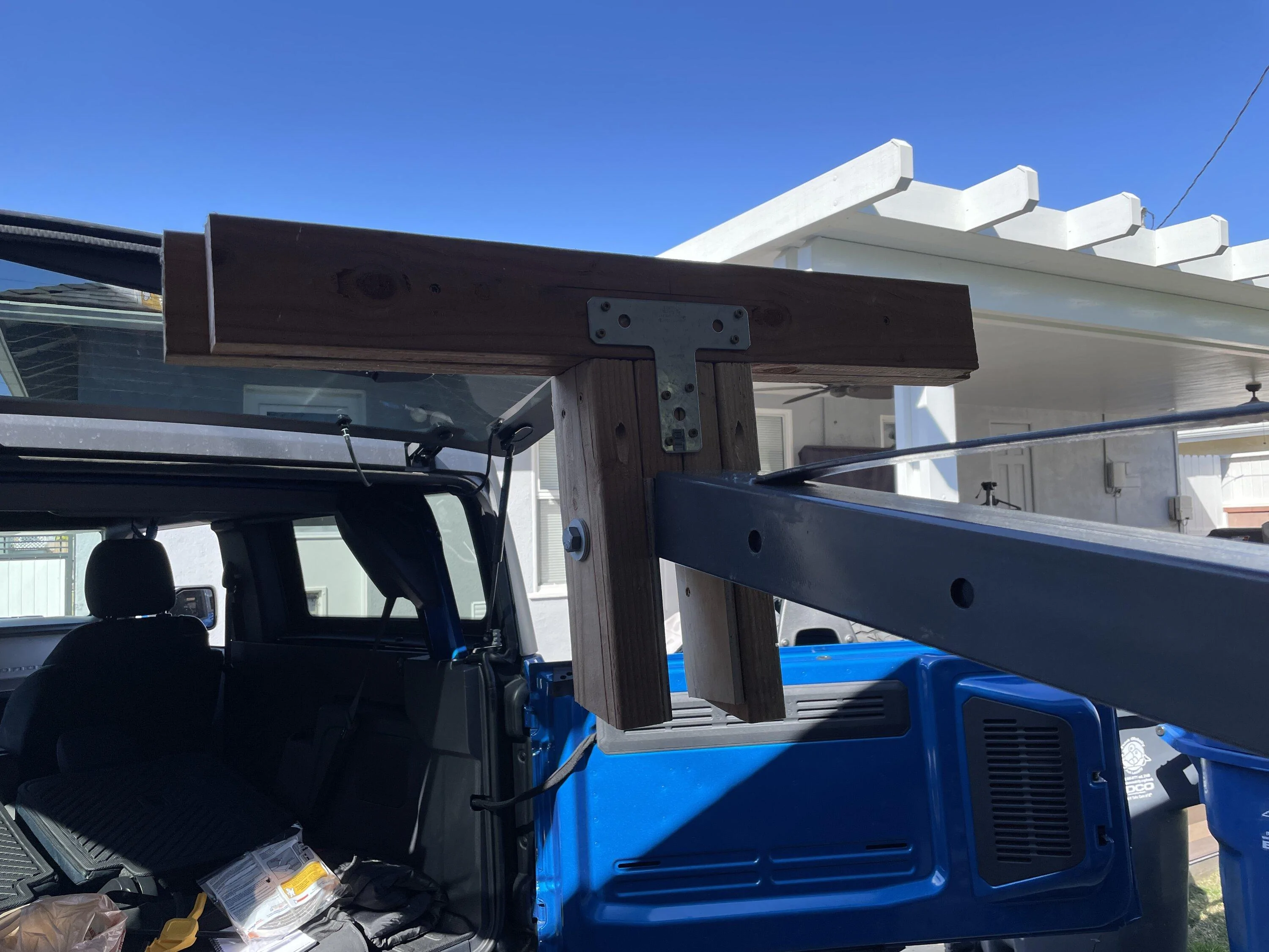

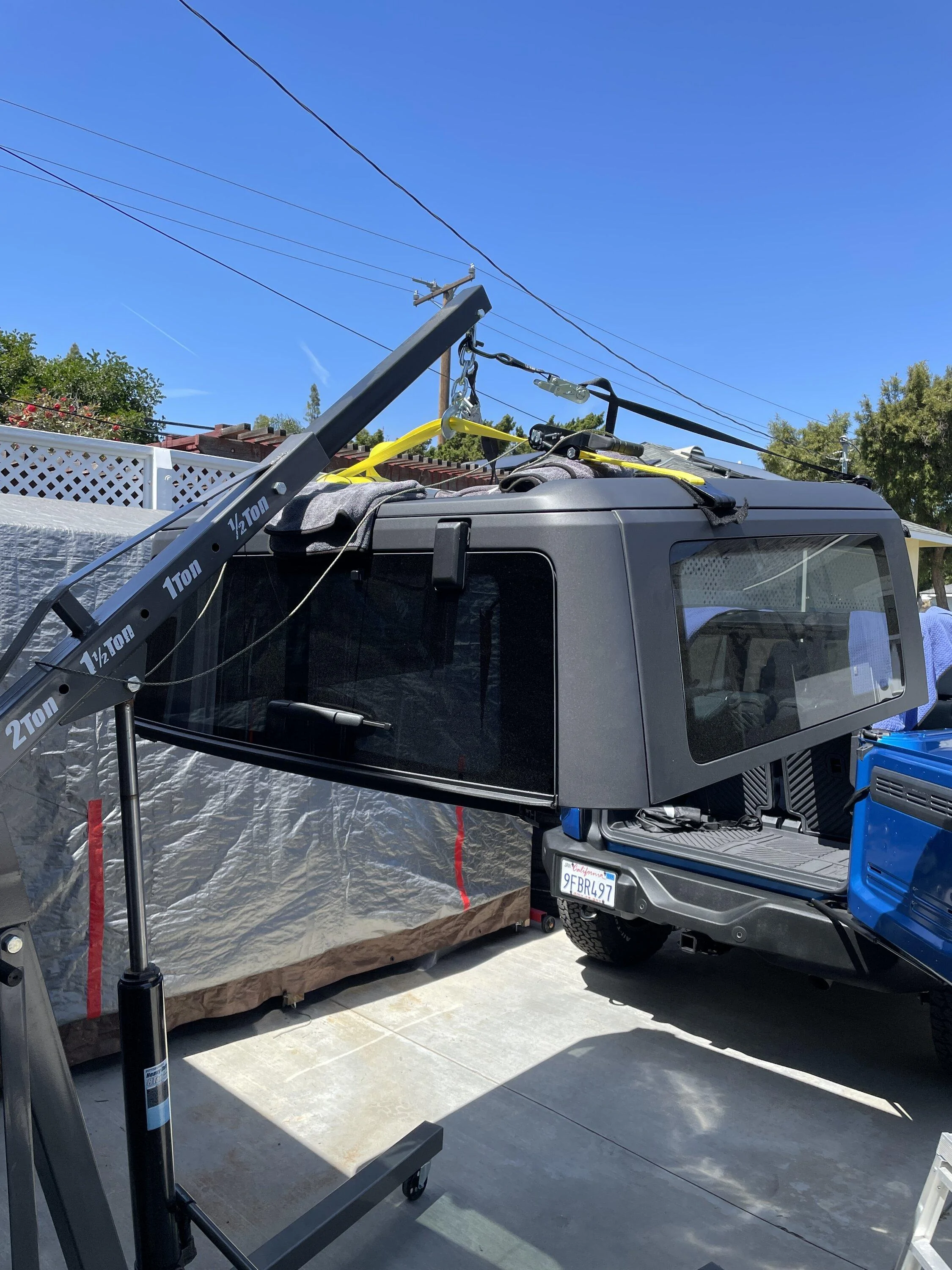

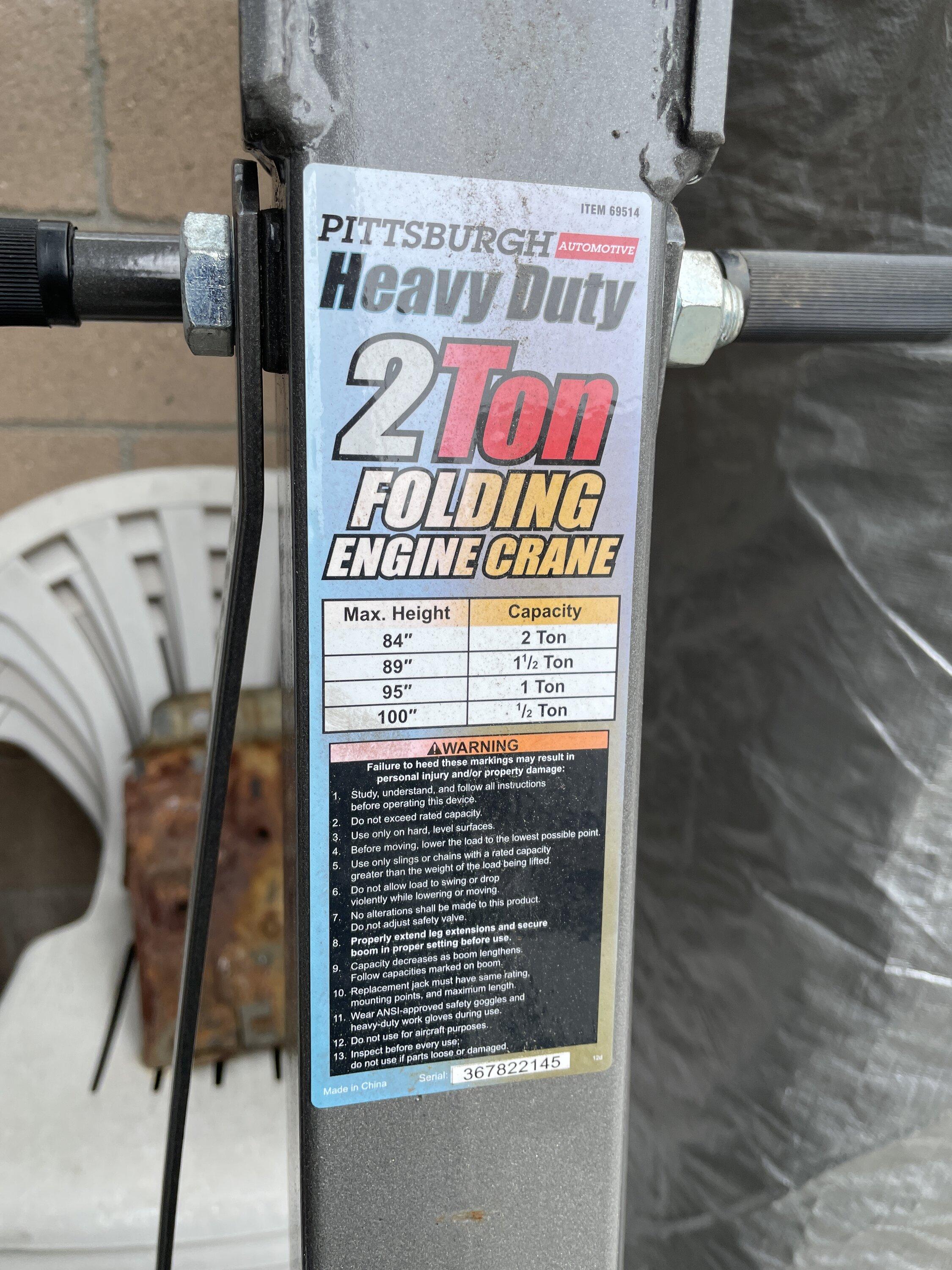

It's a Pittsburg automotive 2ton crane from harbor freight
Ford Bronco Dumb or brilliant idea for help removing top?? 53A82D97-5F3E-4C5C-A16C-780C30614C35
Ford Bronco Dumb or brilliant idea for help removing top?? 651ABA16-082A-4E61-8EC9-8C43A94F8F72

Thanks! So glad to hear that cuz that is exactly what I was looking to buy

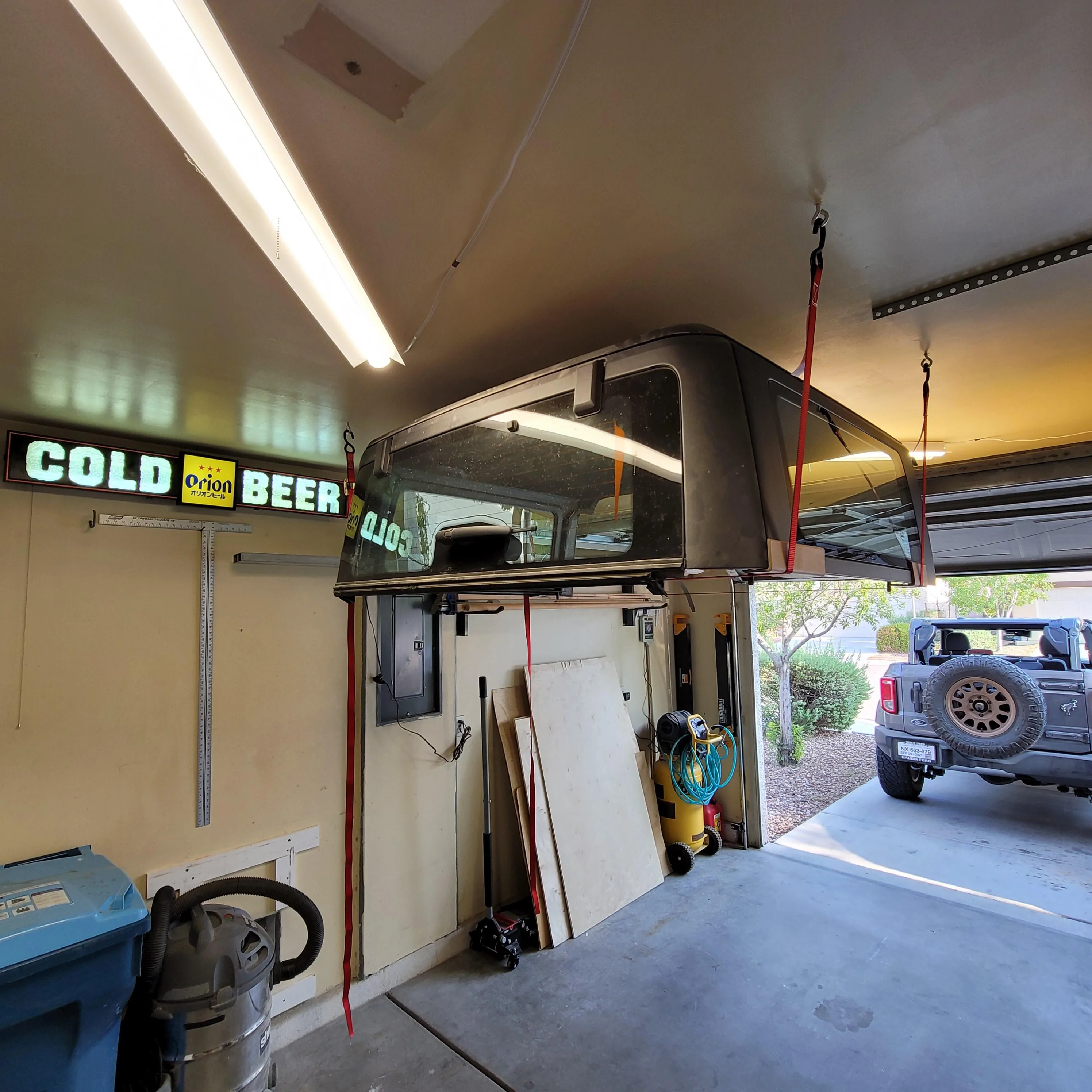

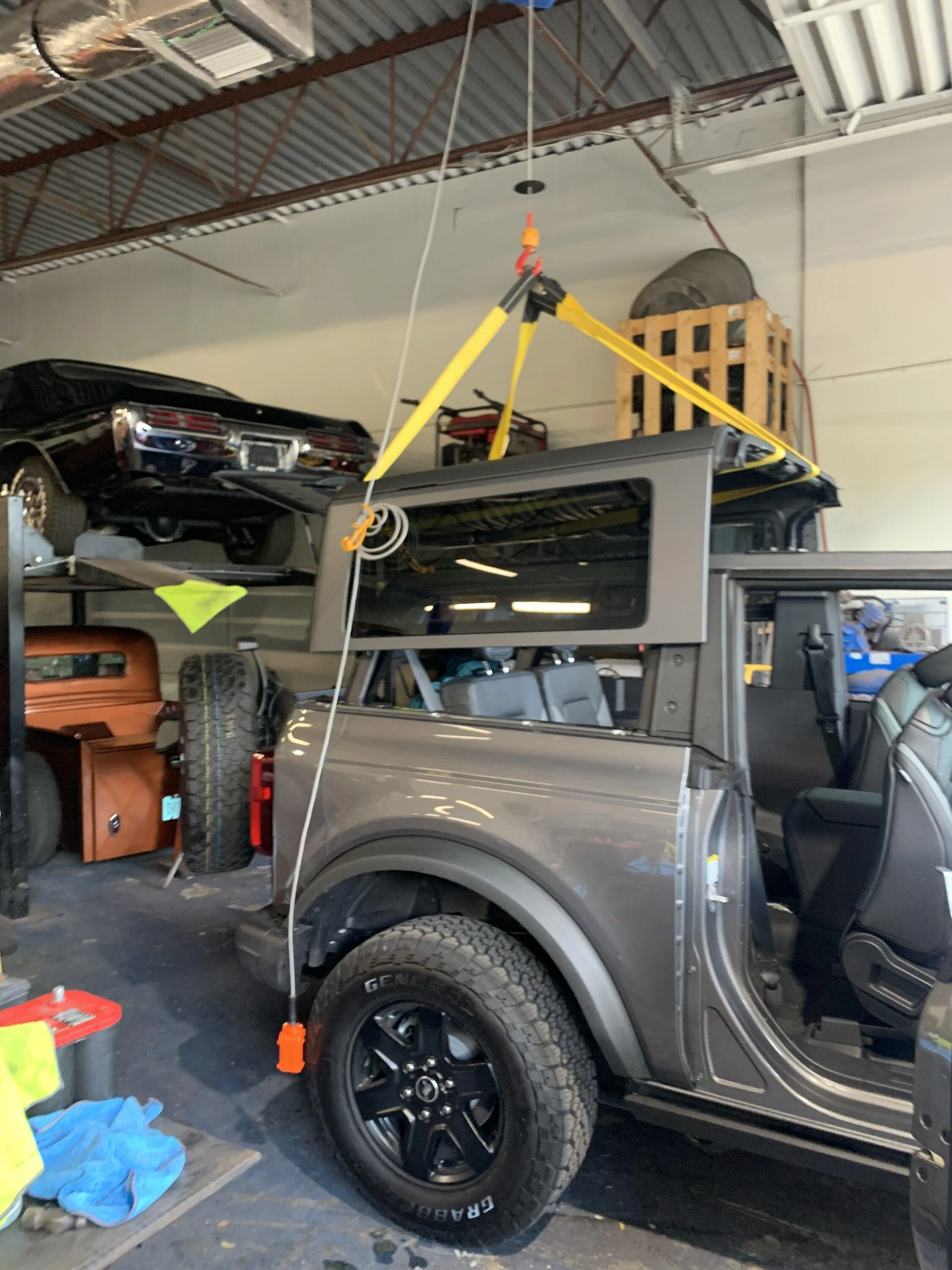

Just saw that the top lift pro for the 2 door is delayed a bit.... so I thought what else can I try. Using an engine hoist? Rig something up to mount to the top of the hoist to go under the top and lift it up?? 🤔

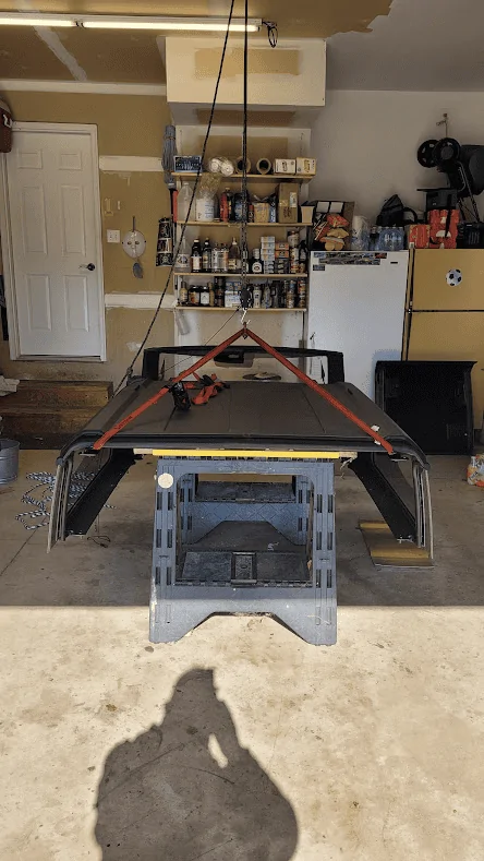

4 eye bolts, 4 stubs of 2x4 (temporary spacers between clamshell and body), 4 of those little hardboard angle pieces they put around sharp angles in packaging sometimes (to protect the bottom edges where the straps have to slide), and 2 cam lever straps.
Practice. Carefully. <15min
Ford Bronco Dumb or brilliant idea for help removing top?? 20210815_173240

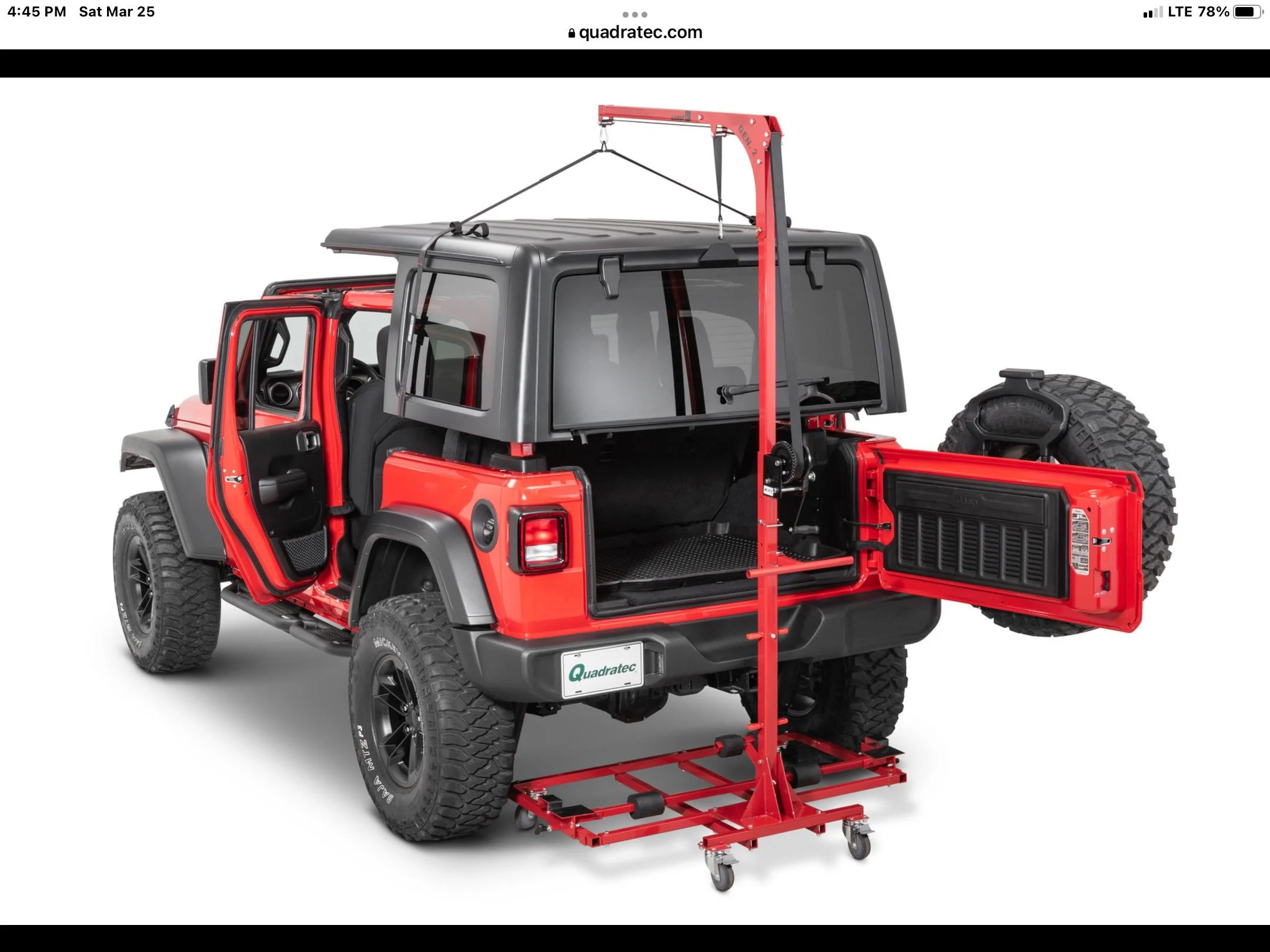

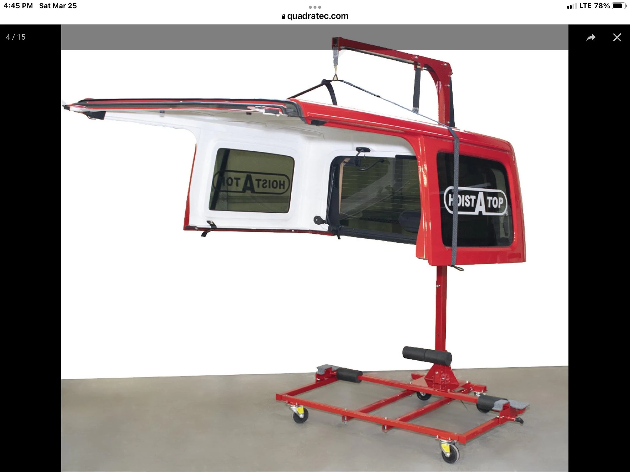

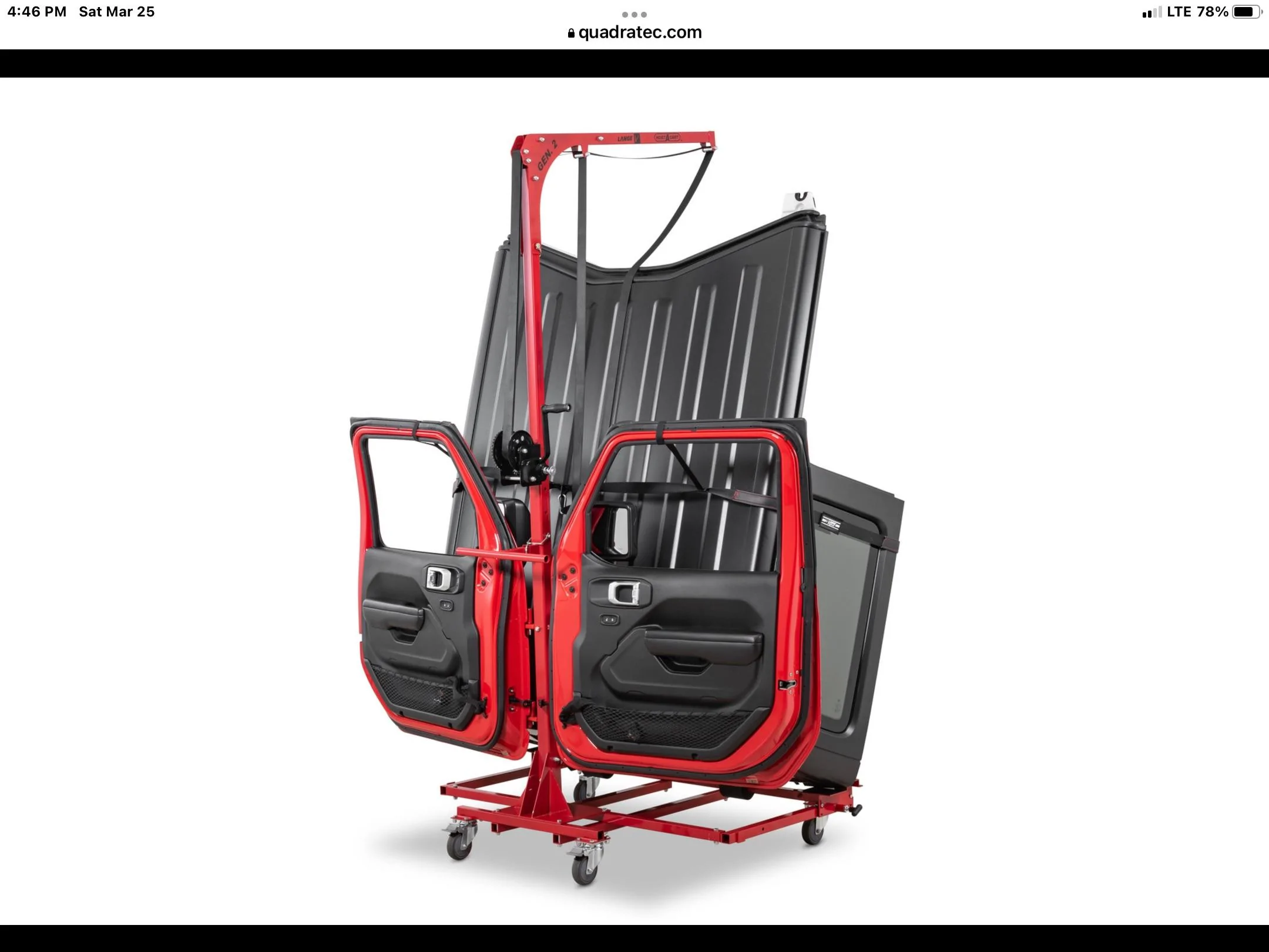

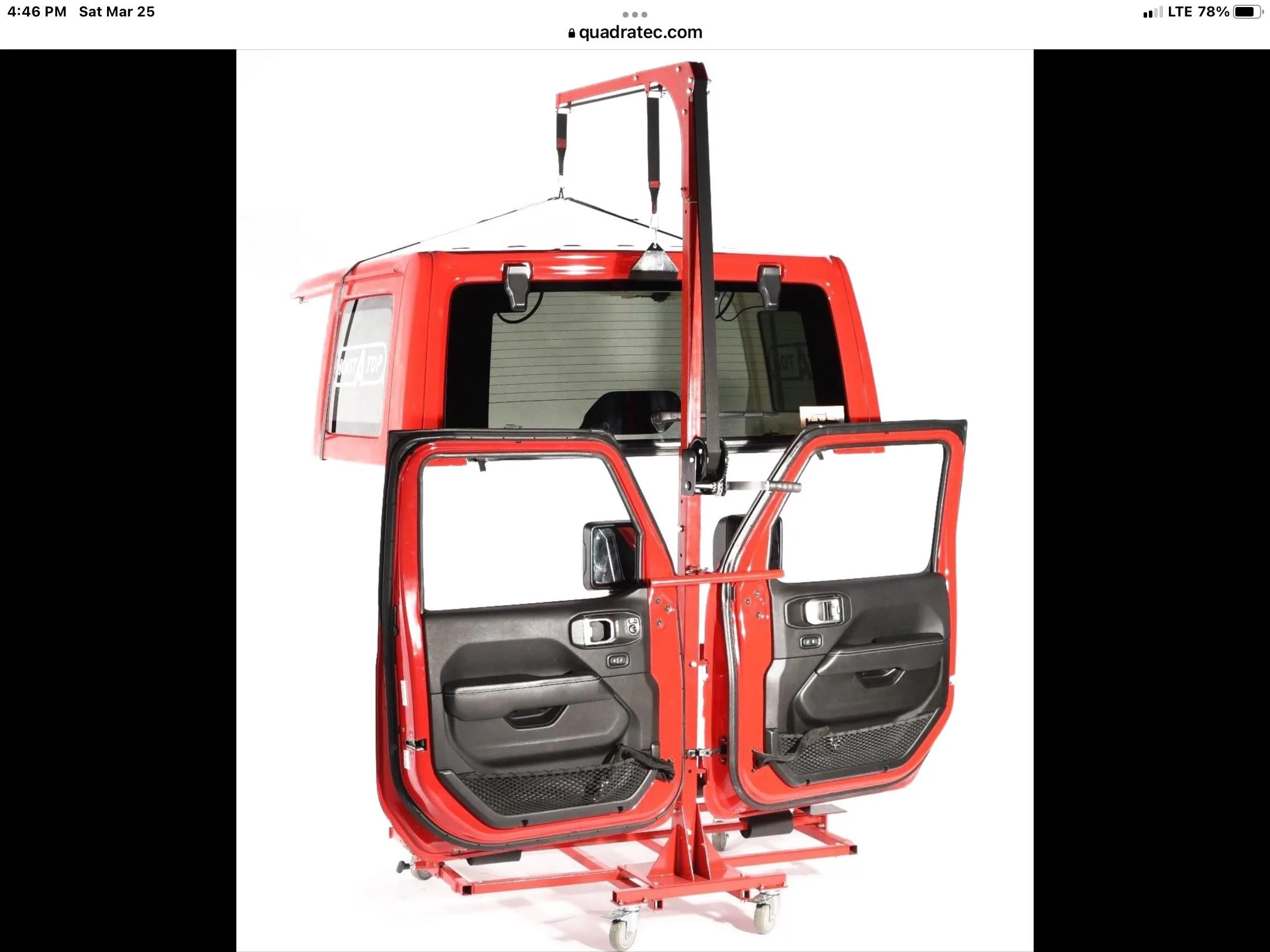

I have this Lange original Gen2 lift left over from my Jeep sale. Hoping to be able to adapt to to lift my 4door Heritage top if it ever gets built. I would also like to store the doors on the bottom somehow. Any ideas would be appreciated.
Thanks
