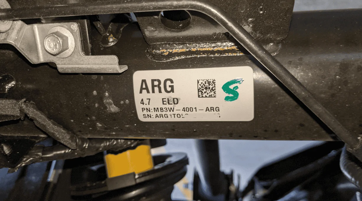

There's a sticker on mine indicating 4.7.
Any other year I'd agree. Not sure I'd trust a sticker with the other sticker mistakes taking place... Just sayin'.
Found the sticker, it says 4.7. So at the very minimum they did adhere the correct sticker. That's something.
