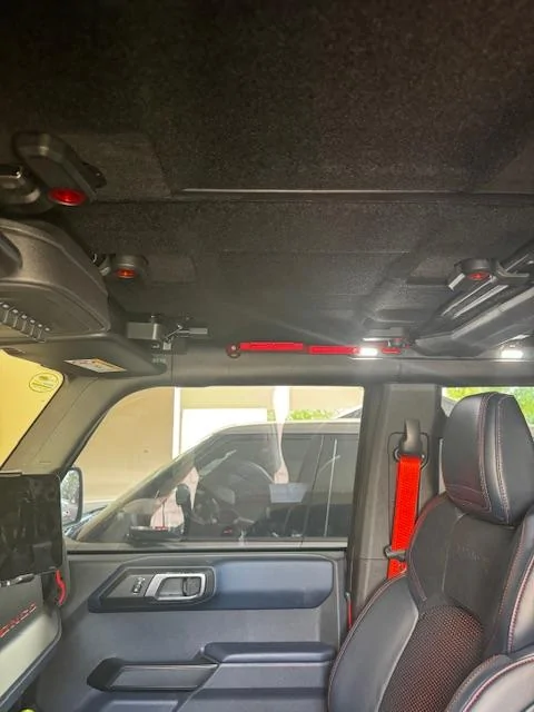

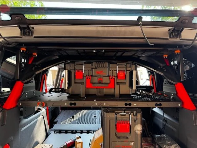

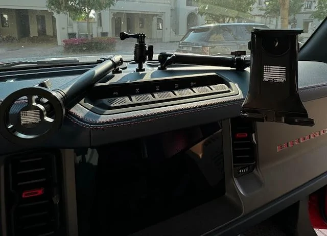

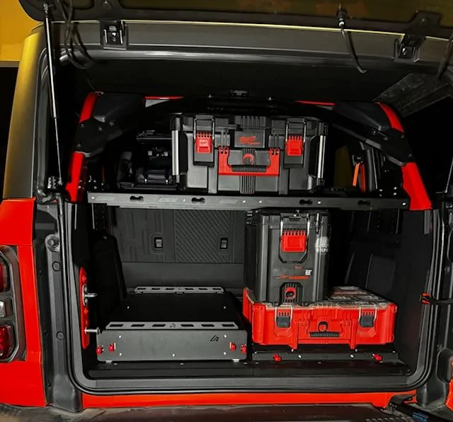

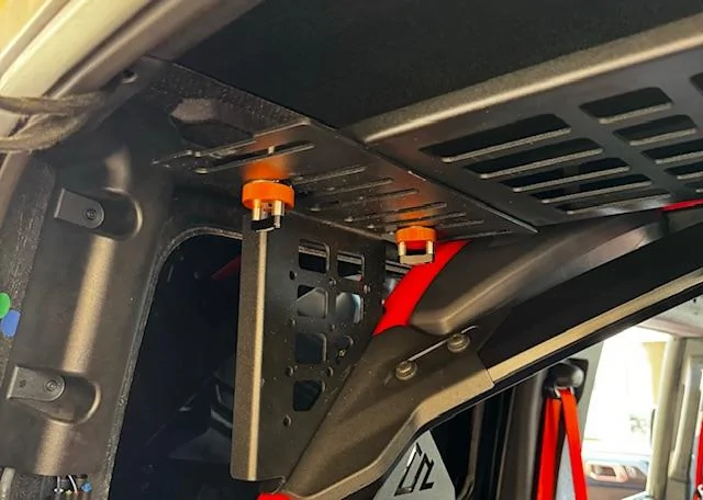

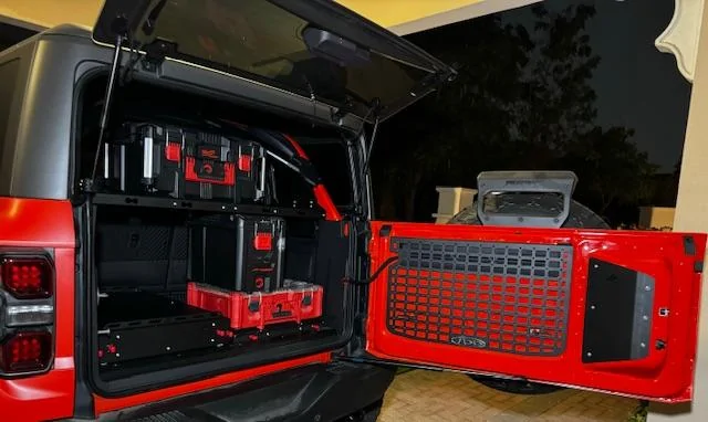

Here's the last 24 hours of work on the build. AAL gear installed, more on that separately though pending resolution from them. Puravida shelf in. Packouts done. Bulletpoint mount. Mabett lights. Note on that raptor crossbar needs to come out to remove airbag covers. I just dremeled a cut out to slide it behind the screw.

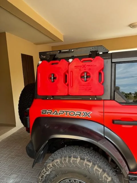

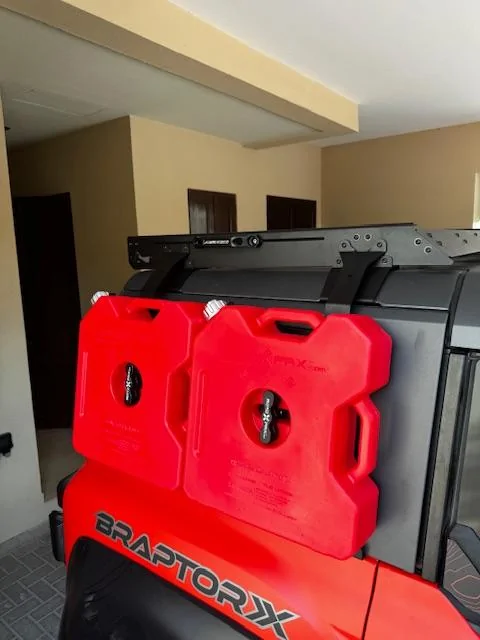

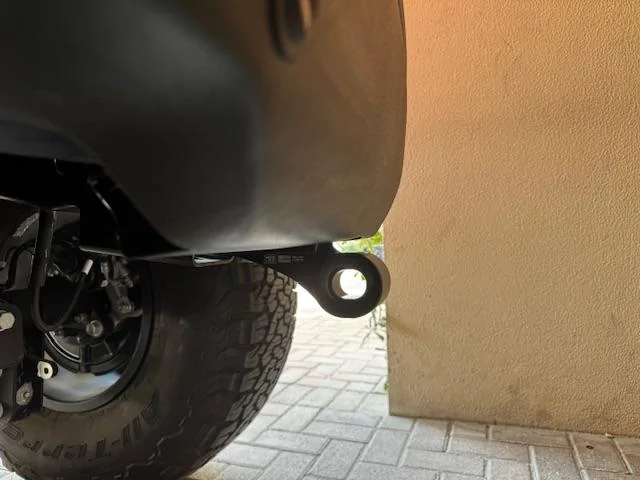

Monster hooks and trailrax done. We only use soft shackles on our recoveries so these are perfect. Trailrax was tough I think the foam for the clamps is a bit too thick. I folded it right in but struggled. Agency 6 grab handles.

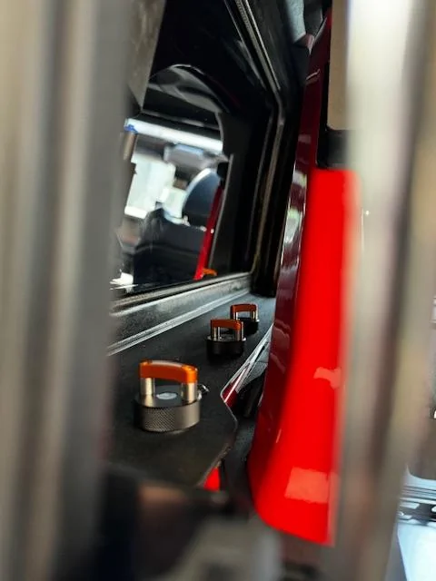

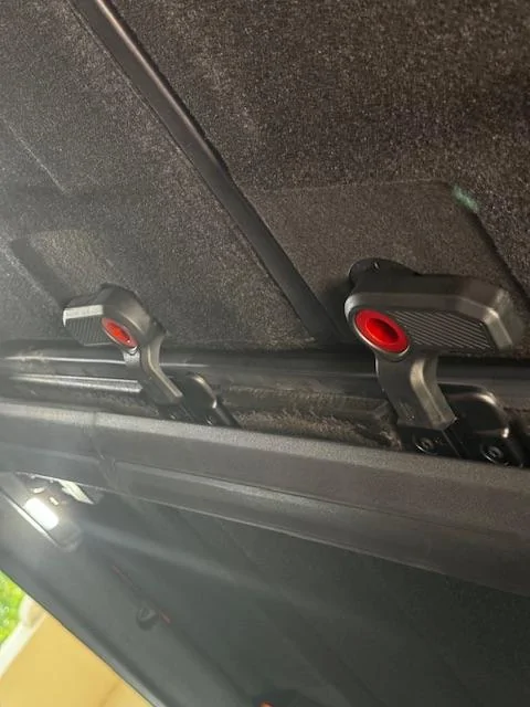

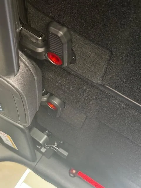

Mabett lights, grab handles and the modcrate thingies. Don't seem to be having any light issues, was concerned having read other posts about odd behaviour.

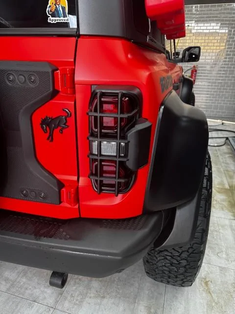

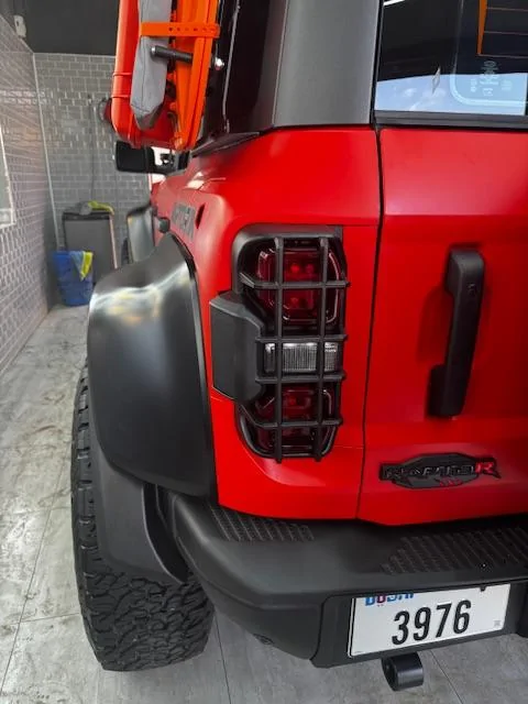

Some random light guards from Amazon. Good fit and plastic is well matched.

Hi Sami, Jacob sent me a message as well. I did the aal gear myself at home and the trmr. I don't notice any additional noise. I use an ecoflow delta 2 and have installed a victron 12 to 36v booster to charge at 400w. Works well. Battery on an AAL slide. Shipping was a lot. Nearly 3k usd air freight. But the drawer and slide and shelf are worth it. No rattles. I use the packout boxes to store gear so it works for me. All the electrical work was done by Torc and modern century. They are the best in dubai for this. They have also done aal installs for others but it's quite straightforward. I did notice a droop in the back when loaded up so I changed my springs for hyperco 2 inch HD. and it is now back to where it should be. I guess there will be a slight drop in performance with the extra weight but I don't notice it. I have 6 gallons of fuel and all the gear and a fridge. I also put sound deadening on the trunk floor which has helped as well. I don't think it is recommended to put a tent in the half rack but that was never my plan. I have a Ln overlandish pop up tent I put on the aal sleeper keeper. Pm me with any other questions. Happy to meet and show you everything too. Maybe at torc as they have some performance mods coming as well.
