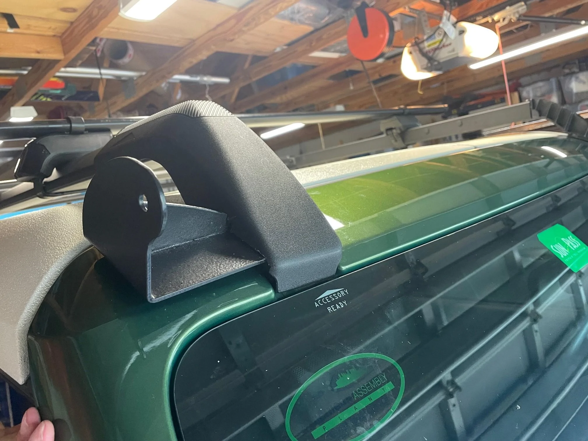

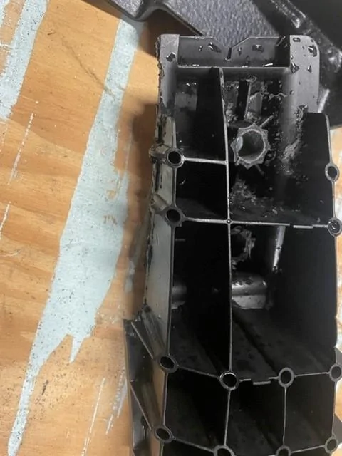

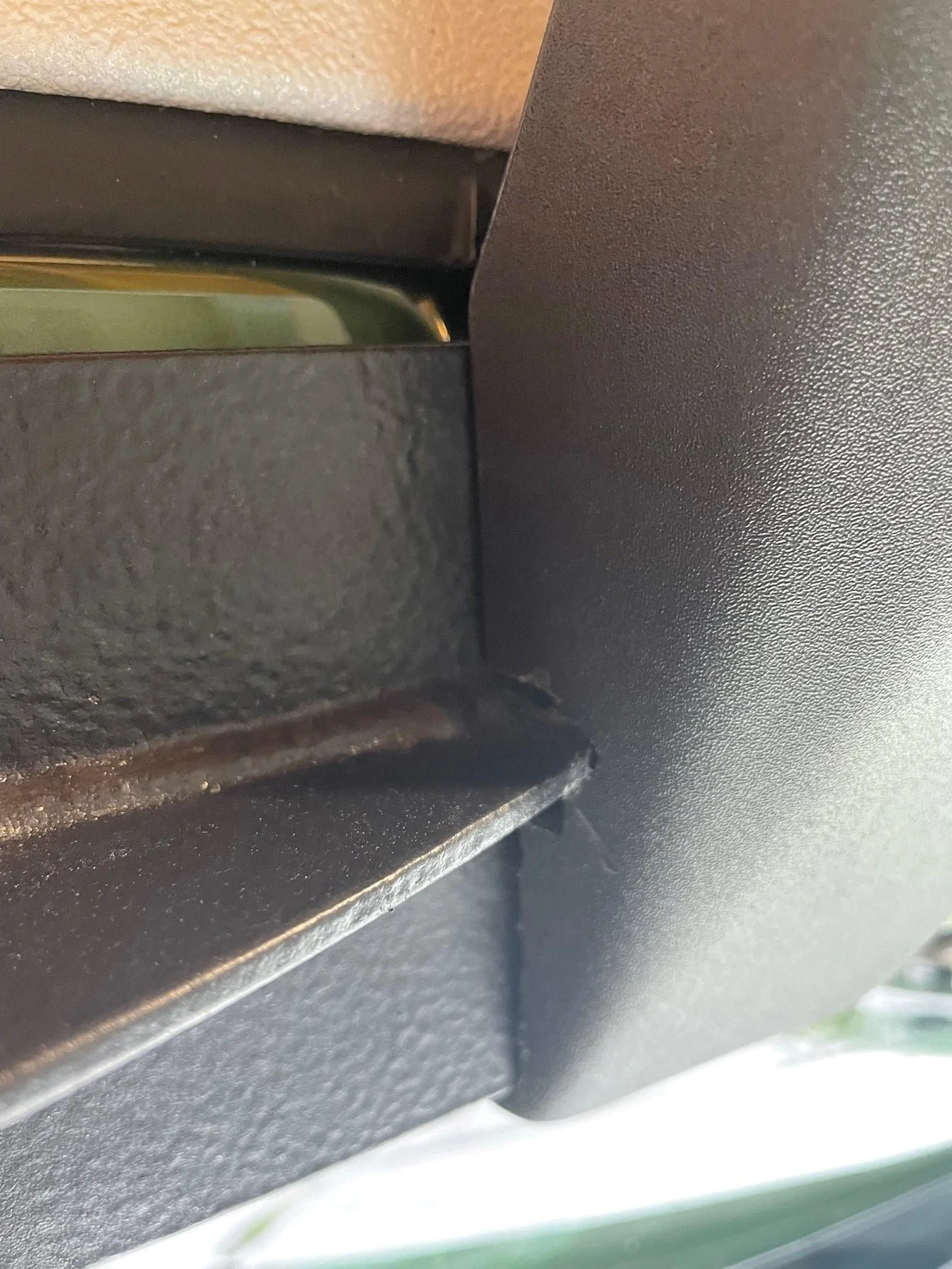

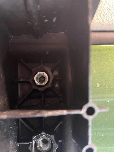

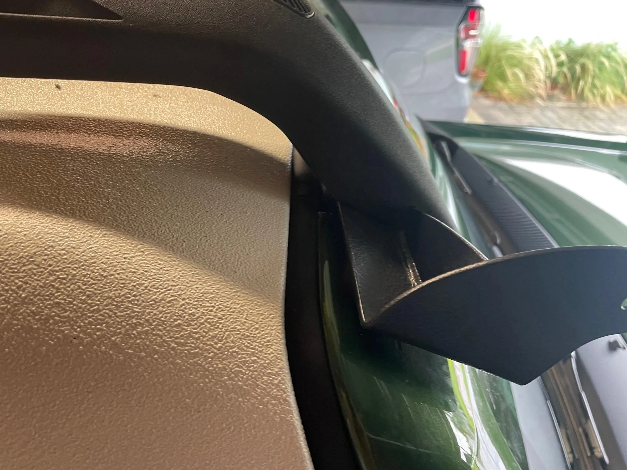

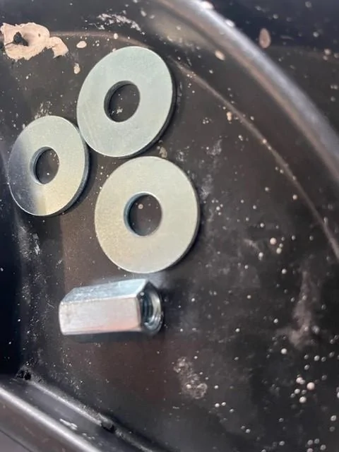

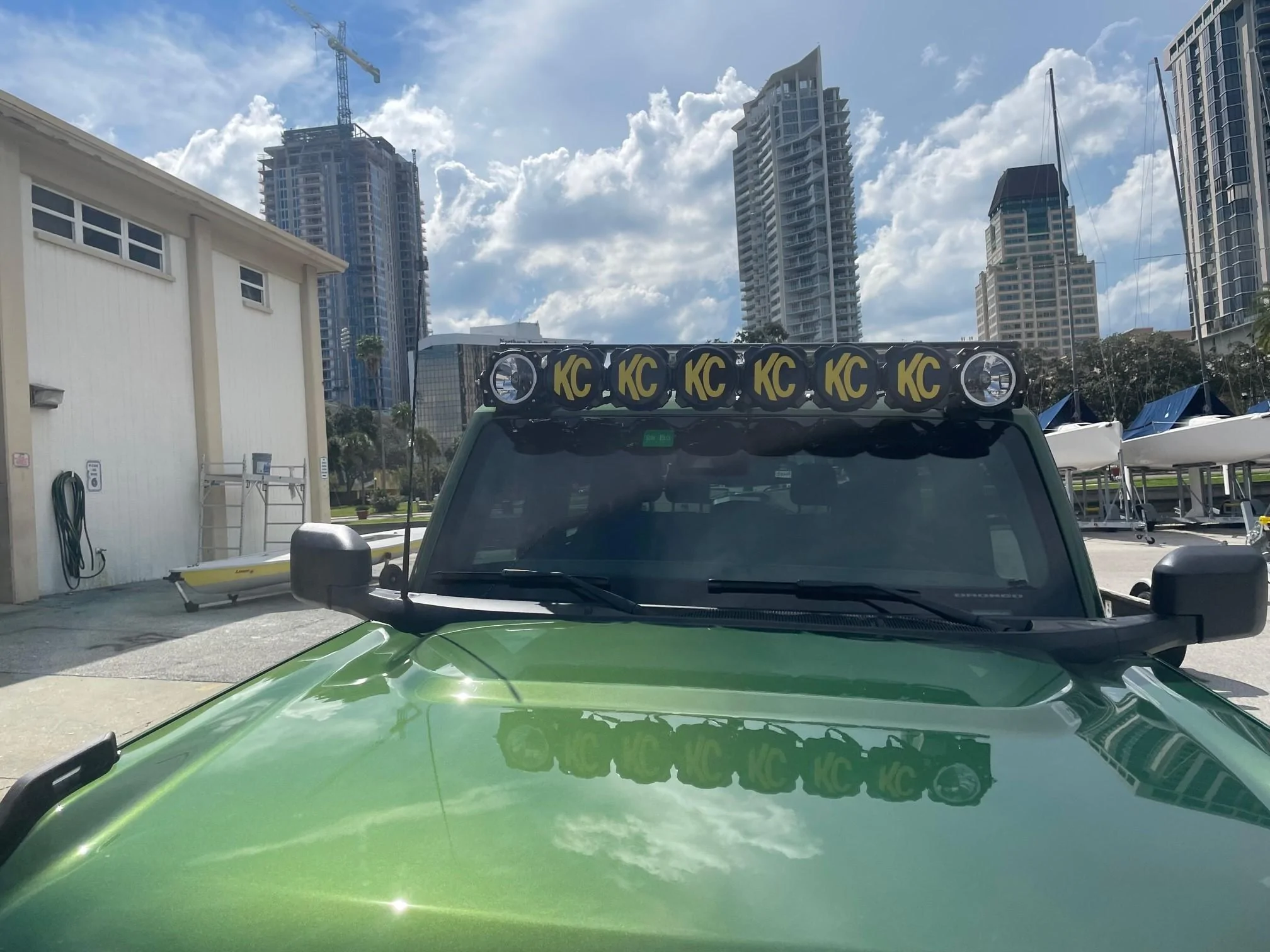

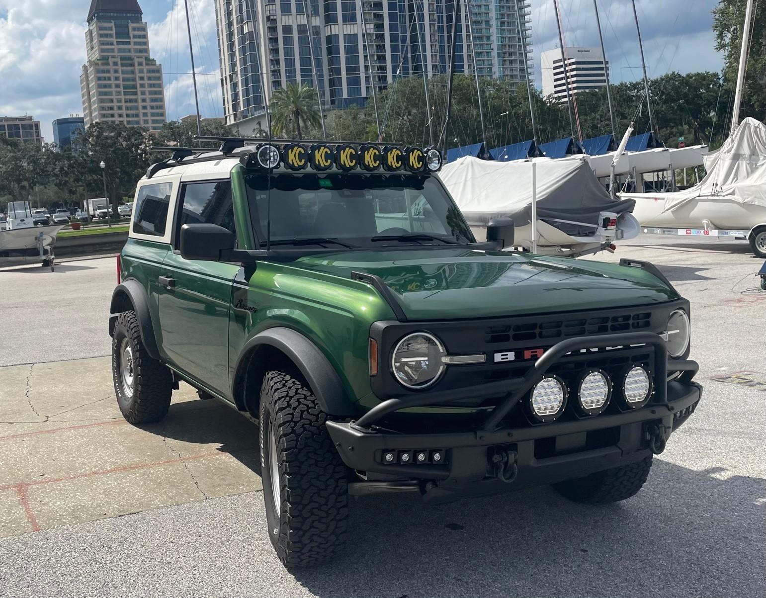

9/10/22 Update

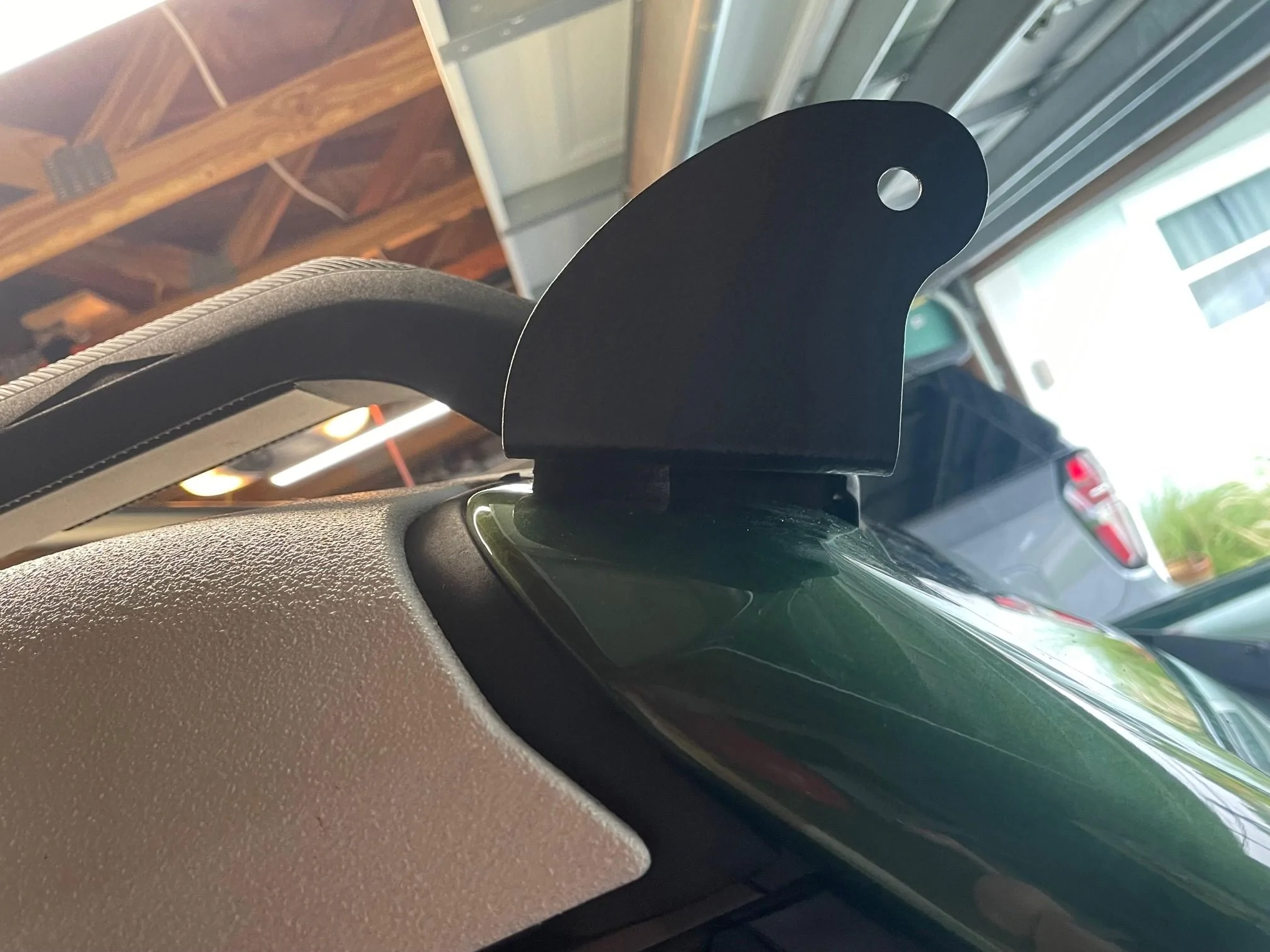

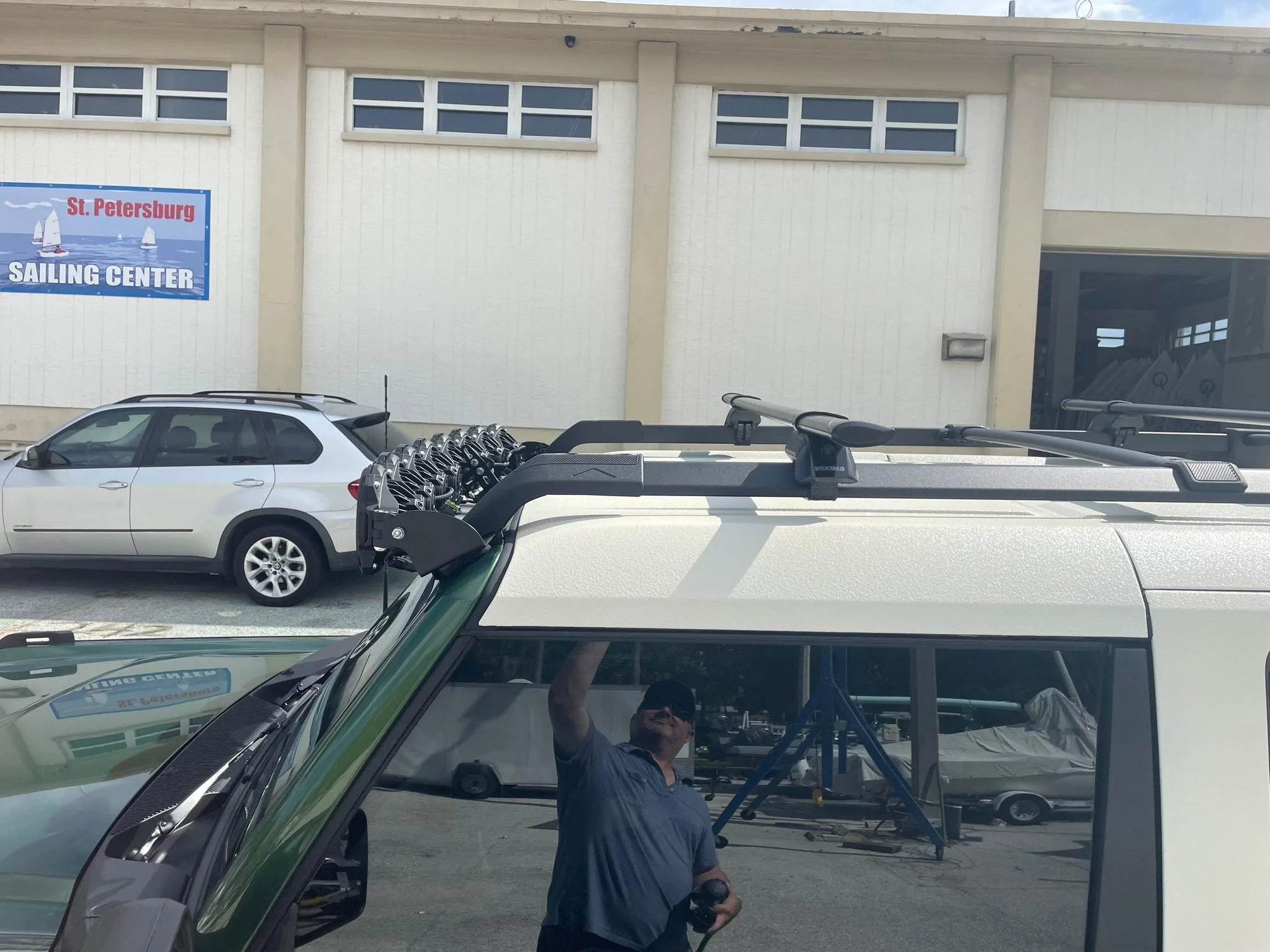

Light Bar Mount WITH factory rack in place:
I have been searching high and low trying to find a solution to keep the factory rack in place and install a lightbar. I don't like the rectangular lightbar look and I want round lights. There just isn't any plug and play solutions that exist. So I had to go custom.

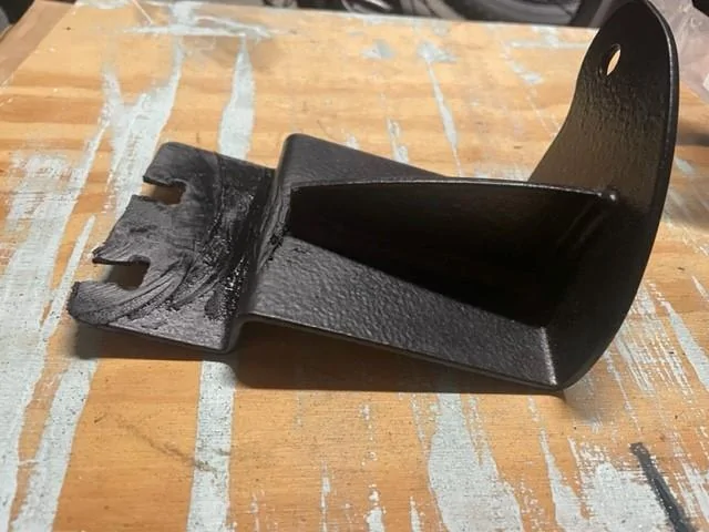

I ordered the 50" Pro6 Mounting brackets from Bay Area Metal Fab. https://www.bayareametalfab.com/202...-Gravity®-LED--8-Mounting-brackets_p_174.html
These are only made to work without the factory rack. I reached out to BAMF and they said it would not work with the rack. It adds too much thickness for the rack mounts to reach the bolts on the roof to screw it back in. Also the plastic covers would not clear. I figured a little bit of mod and I'd see if it would work.
The mounts come with a full gusseted piece across that would not allow the rack feet to drop into place. A few minutes with the angle grinder the the lower gusseted part was removed. The removed a lot of the paint so a little touch up rustoleum worked fine. It would all be covered, but just wanted to cover the exposed metal. I also had to notch the bolt area out a bit to get it to slide in. Shouldn't be any problem as it's really sandwiched in from the rack anyway.

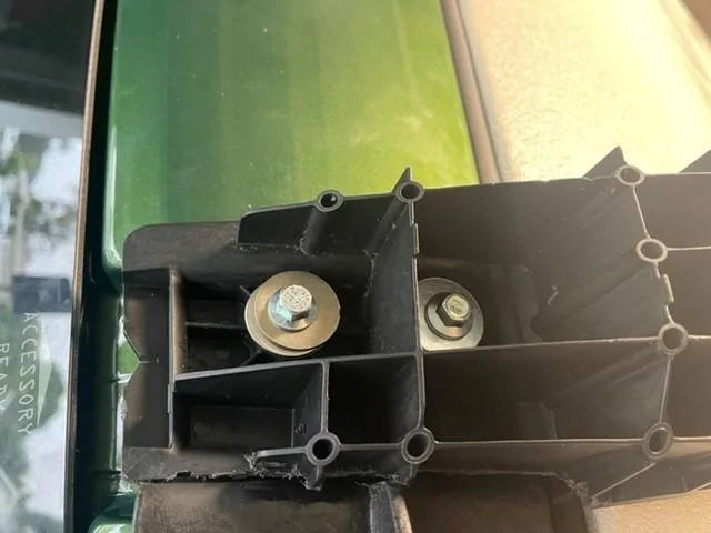

I still had the problem of the roof bolts "being too short" with the added thickness of the mounts in there. Local Ace Hardware had sleeves that had 2 female ends that basically extended the bolts. They screwed to the Bronco bolt and then a new bolt with screw inside it. I had to slightly bore out the plastic rack feet so it would fit with a larger drill bit. There is a lot of thick plastic around the "bolt holes" so its not a problem. I had to trim the outer side of the plastic a touch too to clear the bracket. Couple minutes with a Dremel. The new bolts I had were a touch to long to tighten down, so I had to stack a couple spacers in to get a tight fit. Plenty of clearance above.

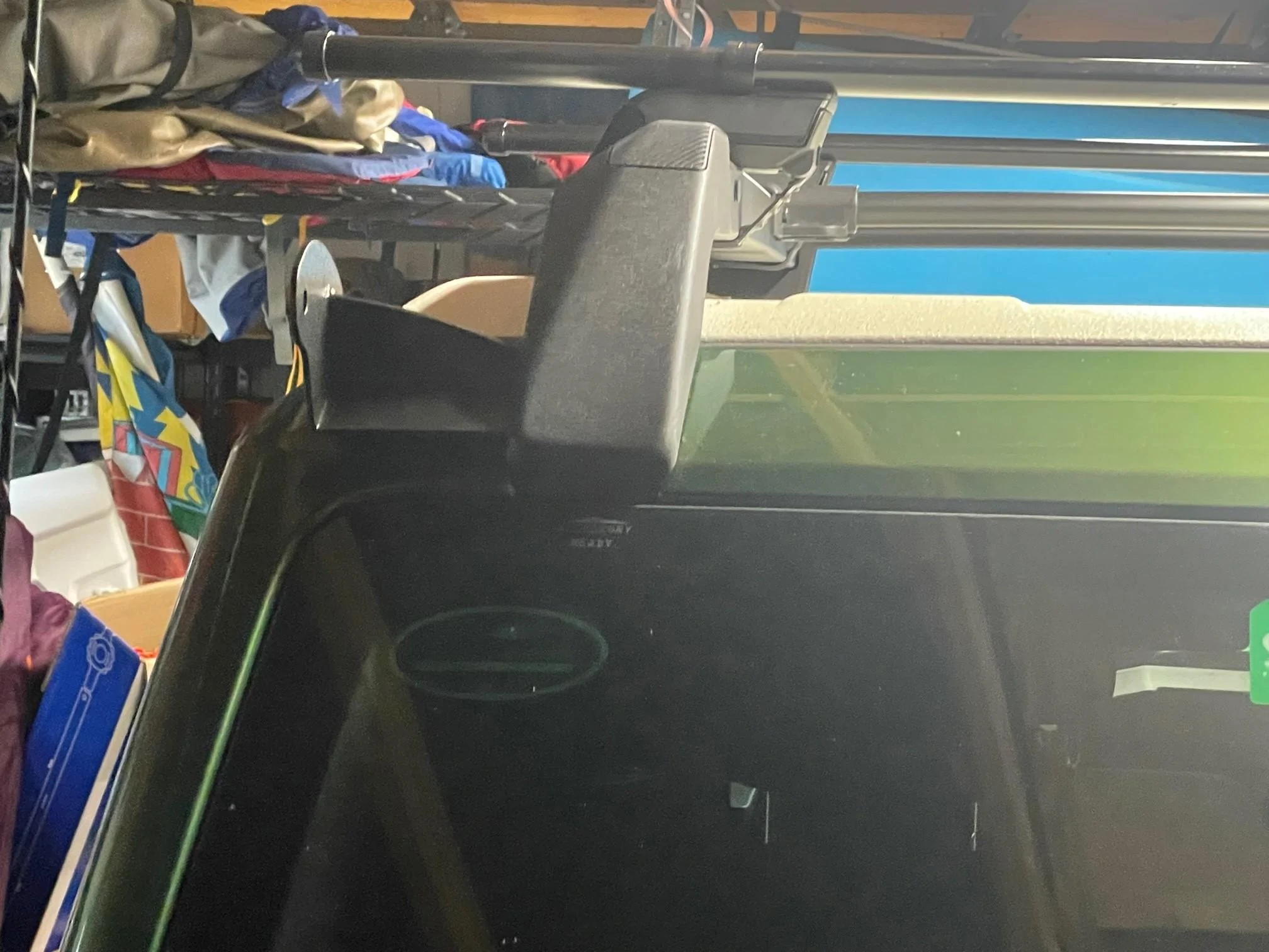

Next issue was the trim cover for the racks. They didn't fit over, so back to the Dremel. Just had to trim about 1/4 " from the bottom and make a notch for the upper gusset to clear. Little trial and error, but trimmed up well. Not 100% perfect, just glad I'm not a dentist. But it works. I also put a little sicky soft pad (for furniture feet) stuck under to the bracket. Just in case it would shake and touch the paint. I don't think it would, I can shake the entire car off the brackets. But better safe than sorry.
So next I need to purchase the lightbar. Leaning towards the KC Gravity Pro6 50" or KC also makes a 50" Xross bar that you can add your own lights to.
USASAIL
USASAIL
219
623
St Petersburg, FL
Volvo S90, Chevy Suburban, Base 2Dr
UPDATE 9/16
Added the KC Gravity Pro LED 6 50" with 8 lights. Simple to bolt on, but a 2 person job just to get the bolt in the far side. I haven't wired it yet. I'm going to do the windshield channel instead of the pre-wire. It seems like the pre-wire in the car is a smaller gauge than is needed. I'm getting the windshield re-caulked next week (Ford Recall) and will wire it after that. I like that the lights are still low enough for me to put boats on the roof and not be a light issue. Only Issue I have is the right side KC light, won't accept the KC cover, it's just too loose. Doesn't matter what cover I use, It seems to be on the light being out of spec.

9/23/22 Update:
Added limb risers from Gear shade. I didn't use the included roof attachment because of the lightbar already in place. I drilled through the lightbar bracket from BAMF instead for the upper connection. The distance between the upper bracket and the trail site brackets seemed shorter so the wire was very long. I found a video on Youtube that 1Five1 Garage installed the same ones and just turned the brackets backwards vs the designed way.
I didn't like the silver look of the brackets, so I painted them black to match and bend into the trail sites better.
I did have to drill out the holes, pretty aggressively because the pins would not fit. At first I thought it was maybe the paint, but i really had to take a lot of metal out.
I also got some rubber washers to put in on the top in case it rattled some, blended in well.
