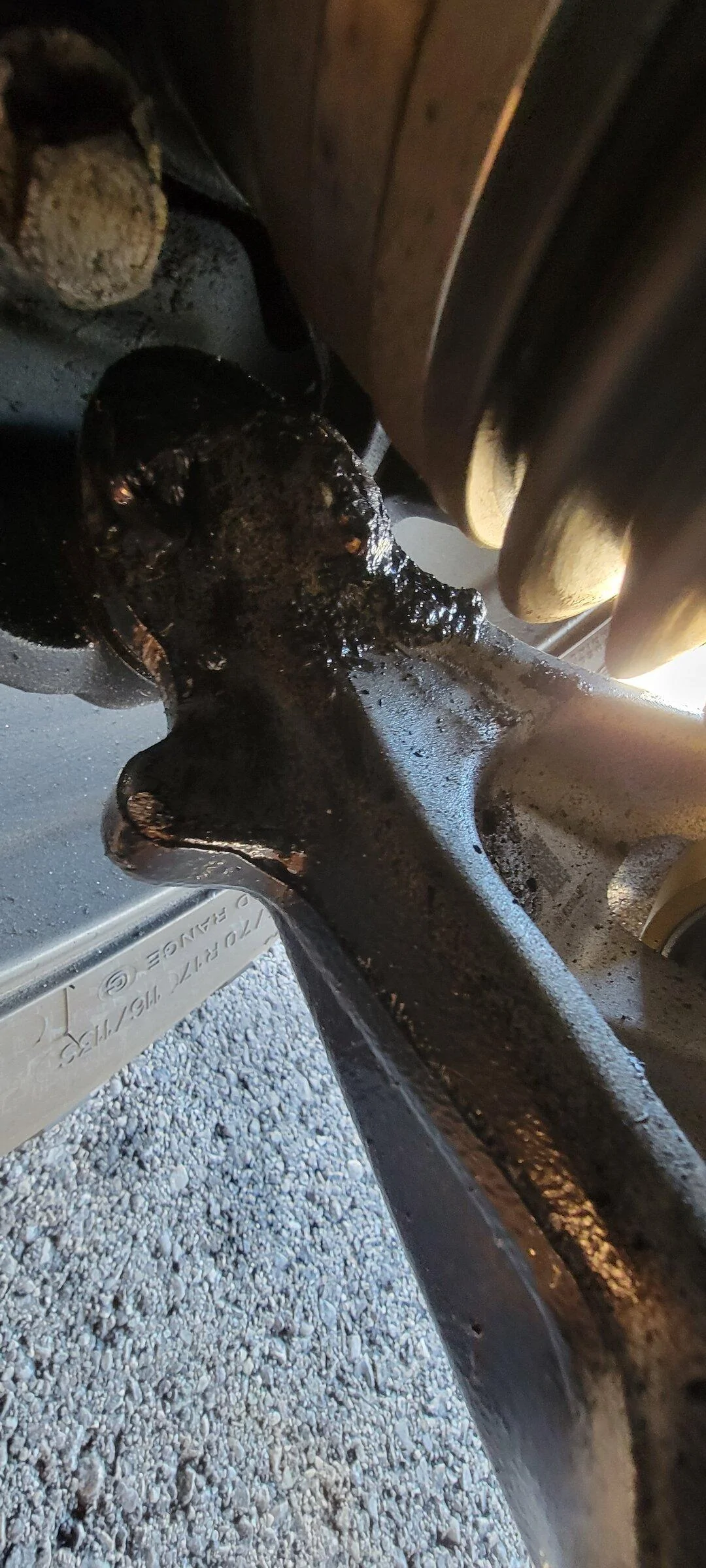

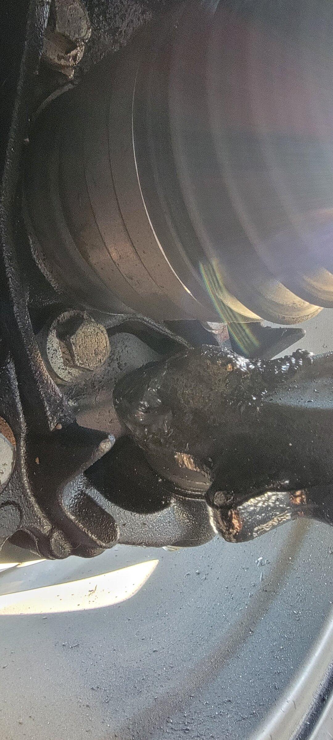

Took my 4dr Badlands in for a rust inhibitor undercoating and I found a large amount of grease all over front driver side tire and axel area. Also had a slight grinding sound that I didn't think much of prior to the discpvery but has since grown worse.
Ford dealerships backed up for weeks out here in Utah so it took forever to get it in to get checked out. Finally did and today they confirmed the grease issue and stated there must be a small hole in my cv boot. They have to order and replace entire driver side axel per the mechanic. They weren't able to replicate the grinding but my video is proof enough it's there and I am sure related.
No clue how there is a torn/hole in the boot. So far only Highway and City driving no off roading yet.

Dam, that sucks man. No doubt the grinding is related, she running dry more or less. Guessing the boot was damaged during installation. Glad your dealer is on board for a correct repair.

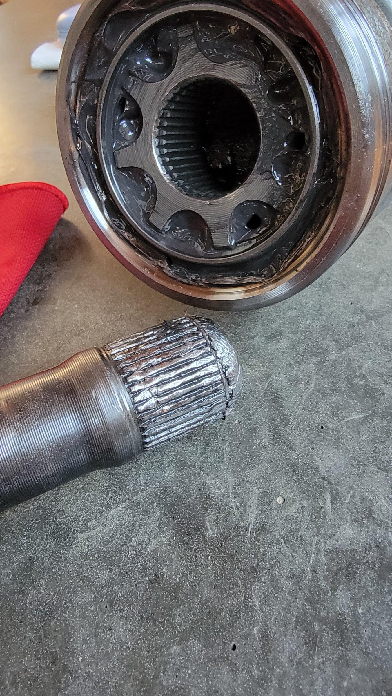

I was going to ask if you saw the other post about no 4x4 where a guy's axle wasn't fully seated from the factory, was leaking and ended up grinding a bunch of splines off.
That looks like yours is already been fixed, except for that terrible noise which I have no idea...sorry.
Yes, that is what happed to us. They Local dealer denied claim because of 35" tires and the 2" spacer lift from Rough Country. I'm going to do a post on what I found. In the meantime this is what it looks like.
