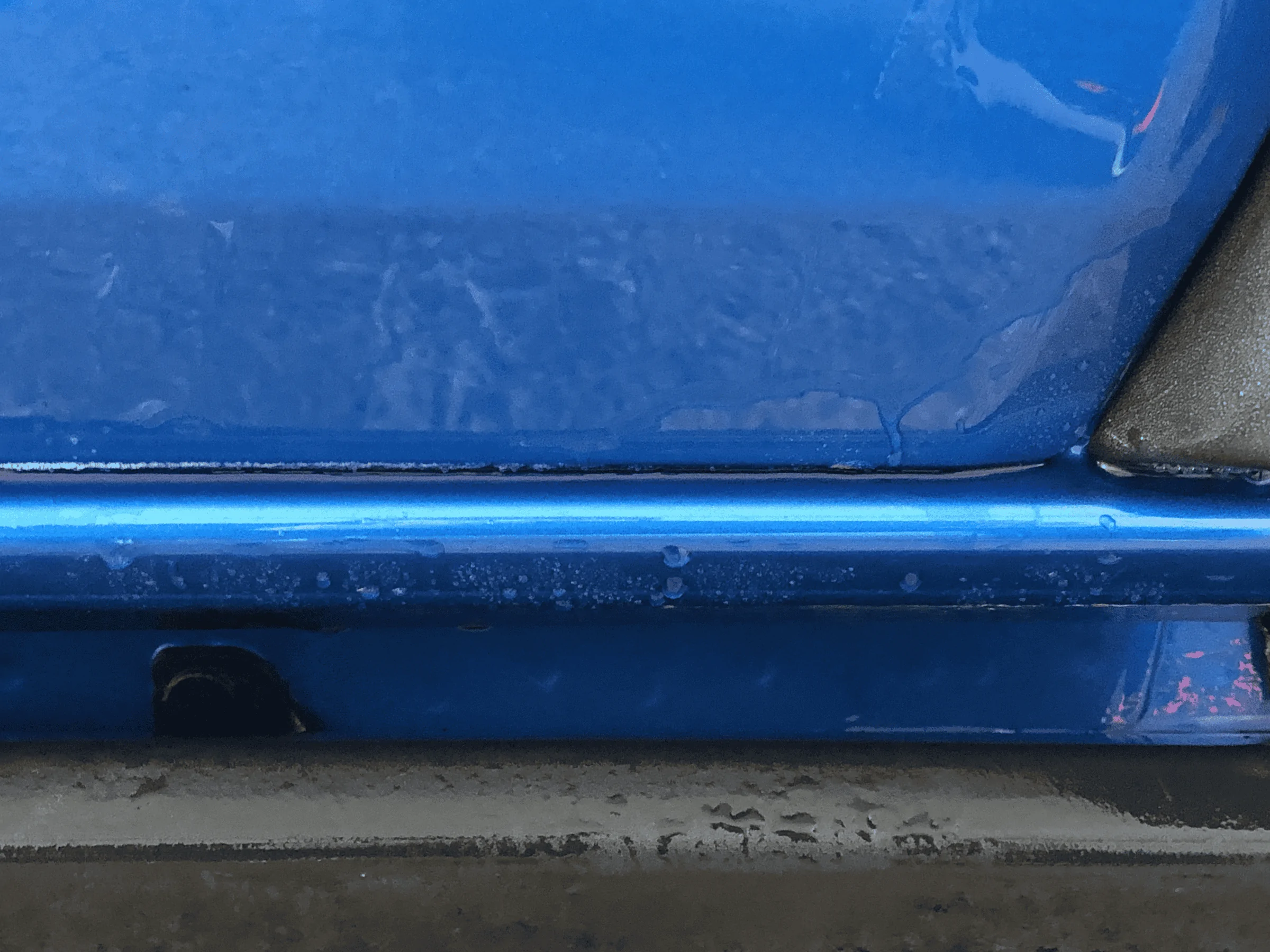

First attempt at fixing. 4 Days in the shop 02-21 to 02-24. Body shop said they moved it as much as the adjustments would allow. Door is further away from fender, which is good. Still way too close to the rocker. Water is still not draining. They also did not fix all the paint issues. Door is starting to bubble the paint. Apparently they need to see what Ford says now. Good times. Documenting my adventures.

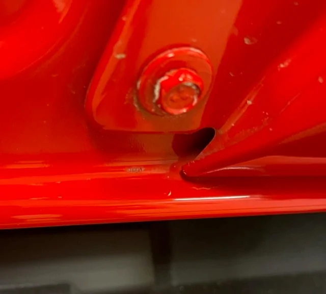

I checked the driver's side rear door on the Bronco that I drove at the Austin Off-Roadeo and it also had the same issue. This Bronco had 700 miles on it, give or take, and I think they said they put on about 10 miles per day. It would be real nice if Ford would issue a TSB for this issue.

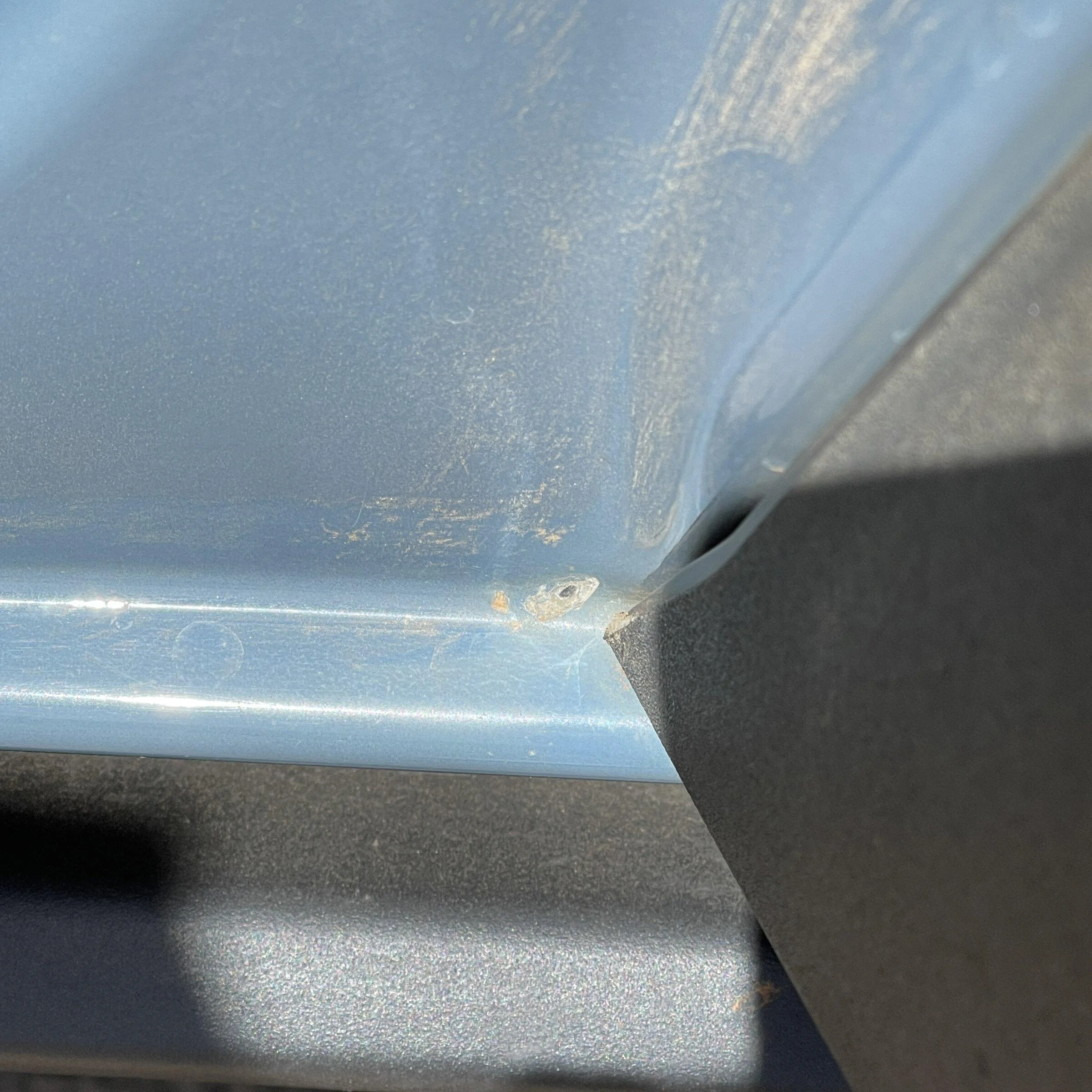

After an email from one of our valued customers experiencing this issue, I can confirm, Dearborn, we have a problem. Both of the low to no mileage 2Ds in our showroom have signs of this starting. At rest they both have clearance and ASSume this is a result of vertical movement in the door while driving. Our body shop is going to adjust around on these but will add this to the "fix it" list along with the 2.7 cooler hose and other post manufacture inspections.
To be fair, body lines on both of these are no worse than any others that come in so no Mr. Obvious show here. Our FE has just a little, maybe, on the RR door and brother's 4D has nothing. We're going to try a couple things on these to see what gives us enough clearance without creating an issue with panel gap or body lines.
Note to body panel engineering team. Door skins and be about 3/16" shorter since the gap is not visible unless you're looking at it from rocker rail height.

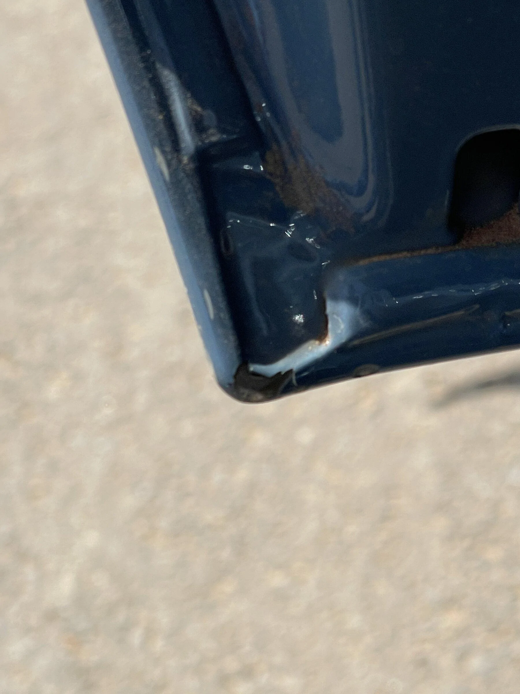

Same issue with my two door. Took it to the dealer three weeks ago and I’m still waiting to hear back on when the arrangements are set with their body shop for a fix.
I never took the doors off. Fortunately I noticed the damage was noticed at receipt of the Bronco.
Got lucky that I noticed the scratch and misalignment on the drivers door. Definitely something for other 2 door owners to keep an eye on.

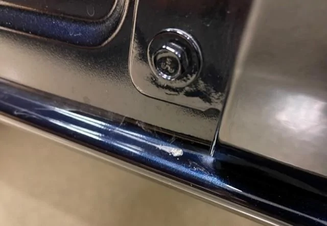

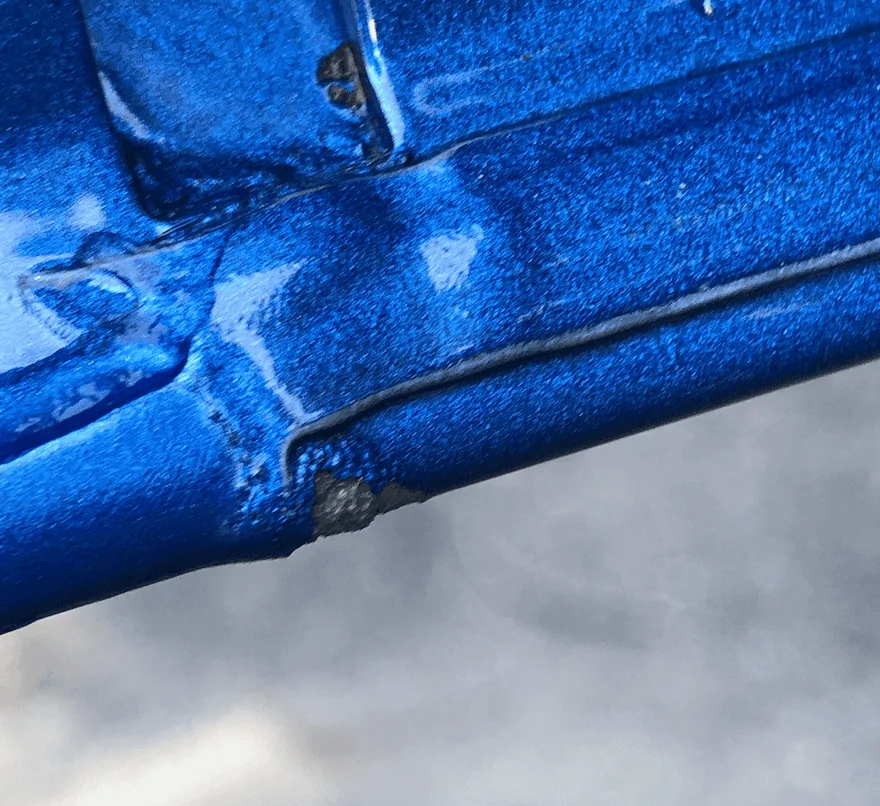

I was with a bunch of 4 door Broncos this weekend, they all had it to some degree. Mine has it on both back doors, one worse then the other. Both door and body have paint chipped.
