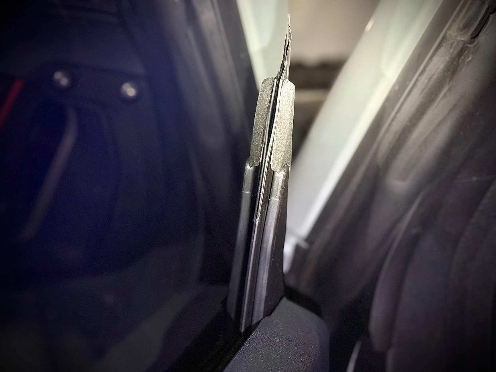

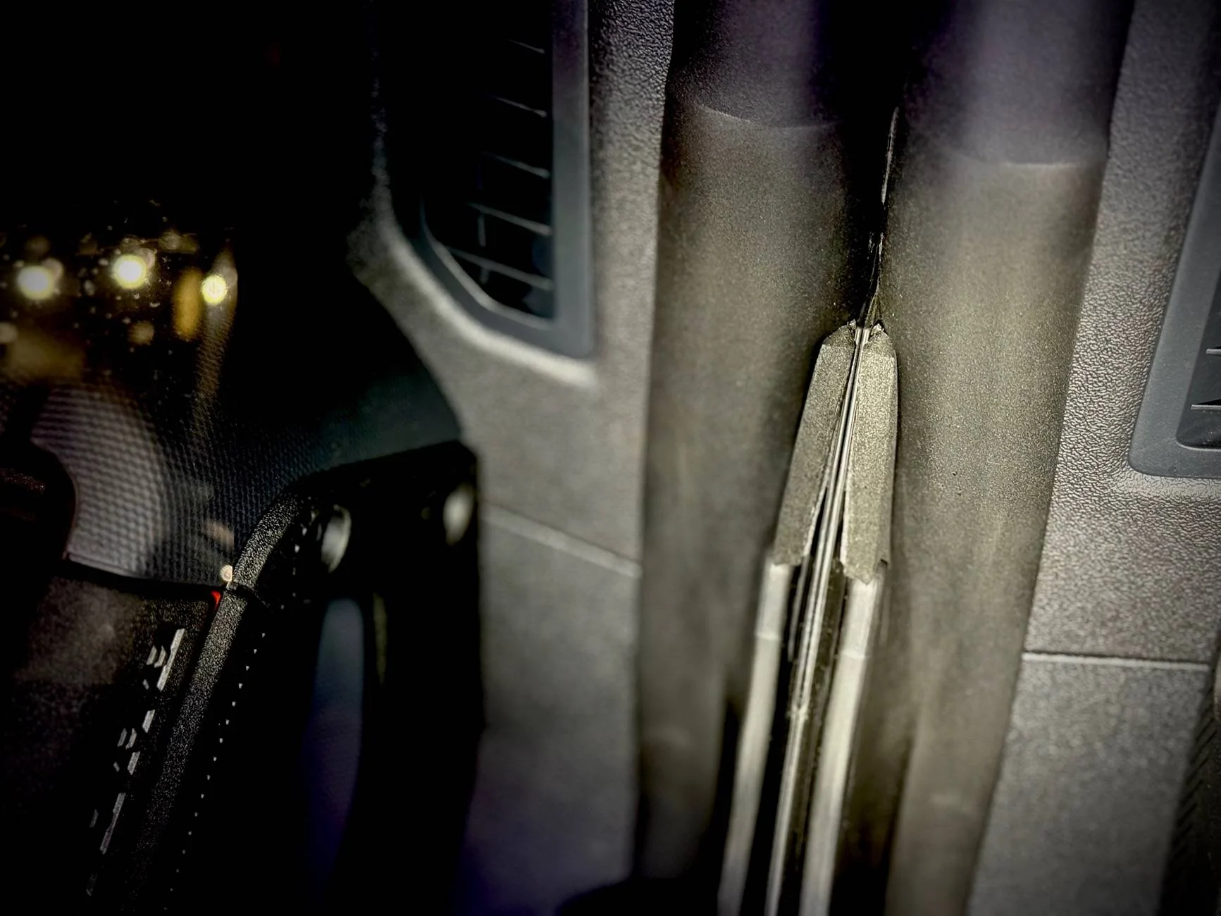

I haven’t replaced it. I got a quote from the dealership with the part number, but I never swapped it. I believe it was something like $155 if I’m not mistaken. I bought a sheet of neoprene-like gasket material with adhesive backing, cut a piece to size, and adhered that to the gasket on the door side. When I close the door it forces the small warp to flatten out and took care of the wind intrusion. I can confirm it is watertight as well. The idea was to create flexible compression against the a-pillar when I close the door that would also be rigid enough to brace the warp. My wind noise issue went away. Quick, easy and cheap fix that you will likely not notice is there unless you looked for it. It’s worked for me for six months so far.
First pic shows my jerry rigged insert. Second one shows what I needed to achieve: compression to press the “bubble” against the driver door glass and stop the wind/water intrusion (window glare on the left, but you get the idea). The material I used is linked below.

Do you happen to know what the part number is or what what that triangle window guide piece on the door is called. I cant find a picture or anything to figure out how it's installed. There's definitely something off with mine in how it's installed or manufactured.

‘8L2Z-7820531-A, Description: Weather Strip A’ is what I got from the dealer. The triangle is part of the gasket that runs the entire perimeter of the door panel. It’s not a standalone part. About eight months ago list price was $181.04.

Under that bubbled up rubber/plastic on the interior (just under the triangle on the door side) is a bolt. If you loosen it, the whole triangle can be moved. Not to a large degree but I was able to stop the triangle from rubbing on the body side trim when I closed the door. Unfortunately some damage had been done before I caught this, but thought it was worth noting.

How is this holding up? Curious if the foam would create any additional wear. I'm considering adding as well because my driver window wobbles when I close the door and thinking this might help get a little more compression on the glass when shutting the door.
