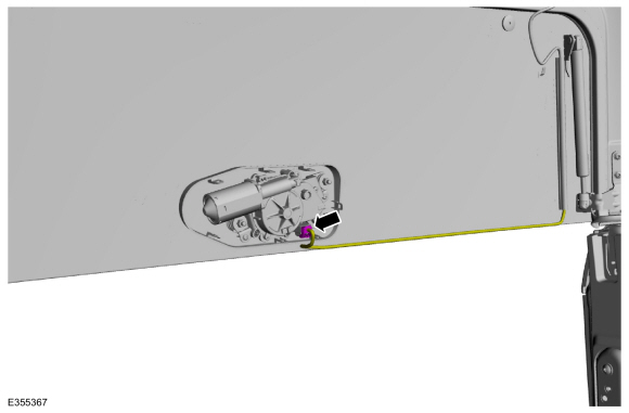

Ok, so far so good, but I can’t seem to liberate the wiper arm from the motor assembly. Took the cover off, removed the bolt underneath, but arm won’t budge.
Anyone have any guidance here?
Update: It comes off straight off, you just need to wiggle it out a bit.
