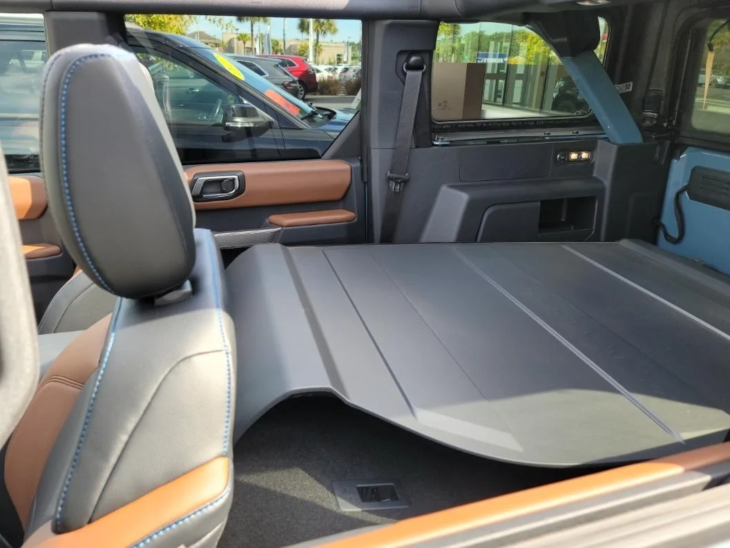

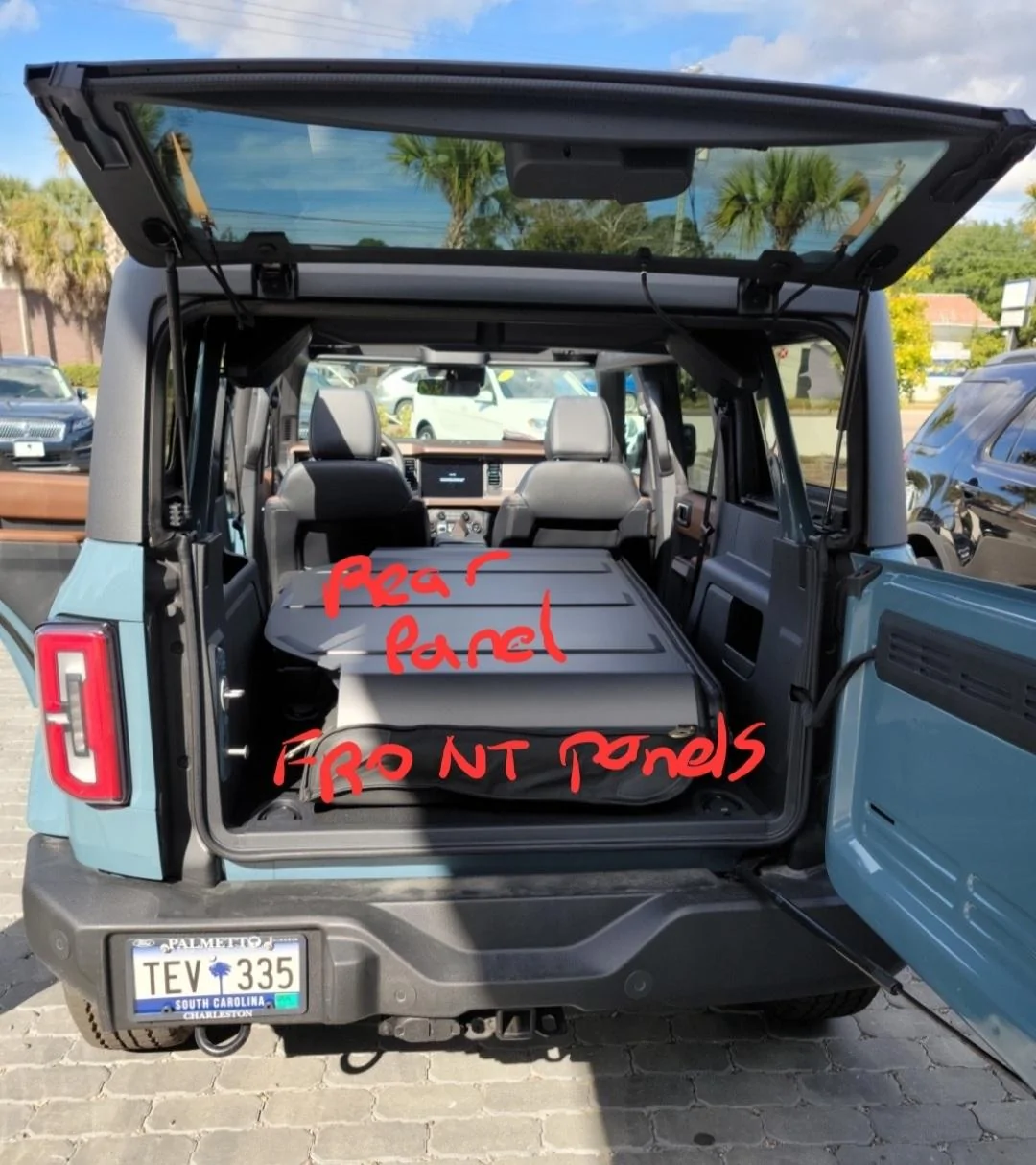

This could be another good way to eliminate the factory inner liner flocking from falling on you. Of course you would first have to remove it. I don't know how healthy the factory roof sound deadner /liner is after looking at it in a mannequin sitting at the dealership. We happened to catch it falling inside after brushing it with our hand, when the sun was behind us looking into the driver side. This is going to be a very dusty environment of which we will be breathing in. Just a thought to be concerned with for some.
I've had my MIC II OBX since October 21, have taken 2 or 3 panels off 3-5 days a week. The free factory headliner has been a non-issue, no shedding or flocking. No peeling or coming off. Its just there, quietly (!). MIC top has No rattles or shakes, no leaks in the rain. There used to be a whistle above 50-60mph, with top on or off, but that has mostly gone away. It is noisier than other cars above 60mph, general road, wind & tire noise, and I have the quieter OBX tires.
The first two panels unclip easily by 1 taller person, and store behind the front seat, in the back, or 1 of each, or in the garage. The 3rd panel is a 2 person job, and stores over the back seat of there's not much luggage or rear passengers, or in the garage.
