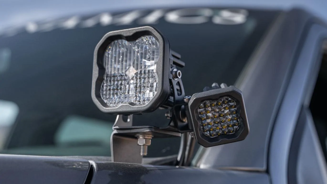

If you haven't seen it, this is one of the most popular ditch light upgrades trending online using our products!
Due to the design of our SS3 universal bracket, you can bolt our SSC1 LED pod directly to the side of the bracket for additional output.

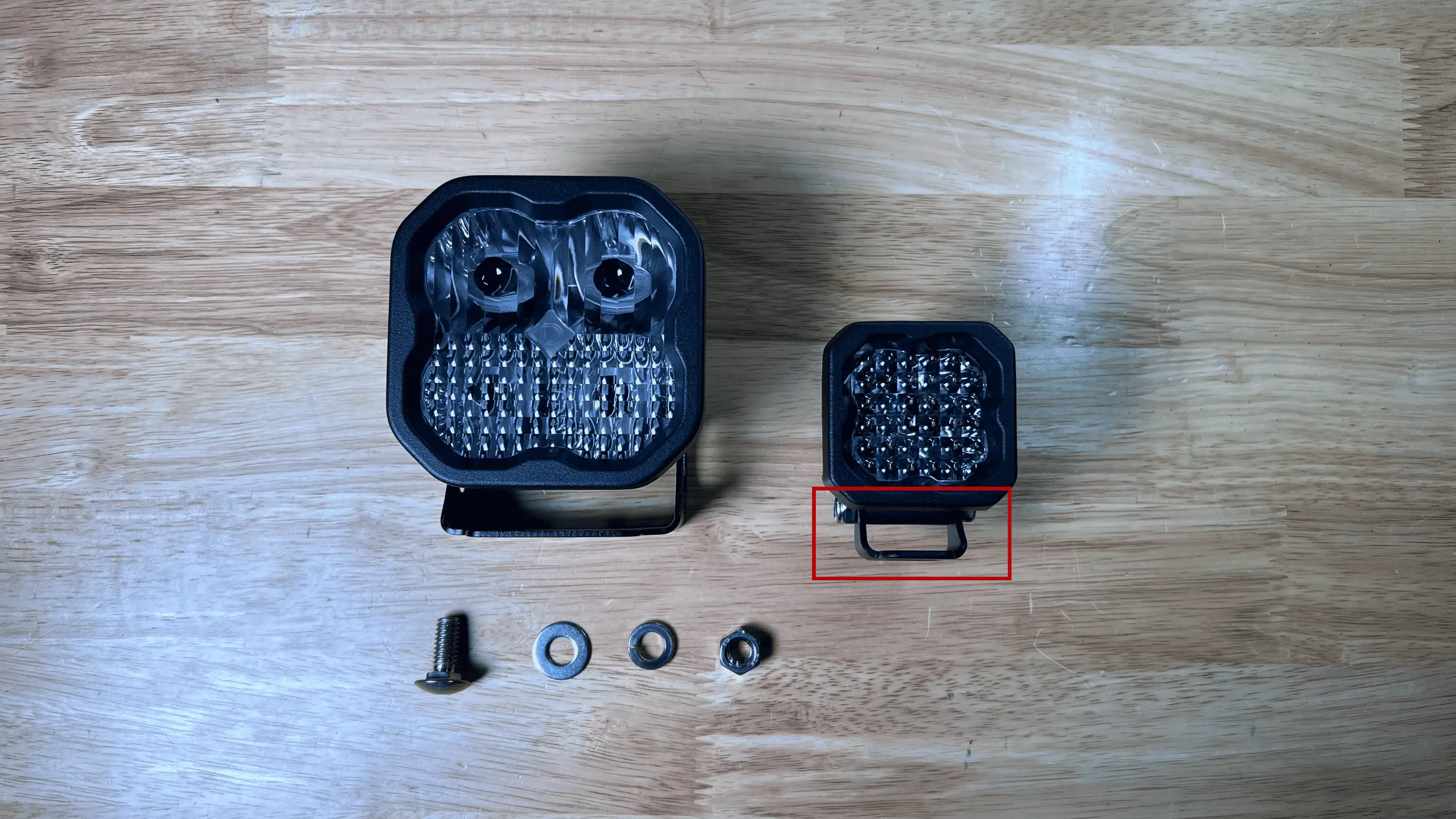

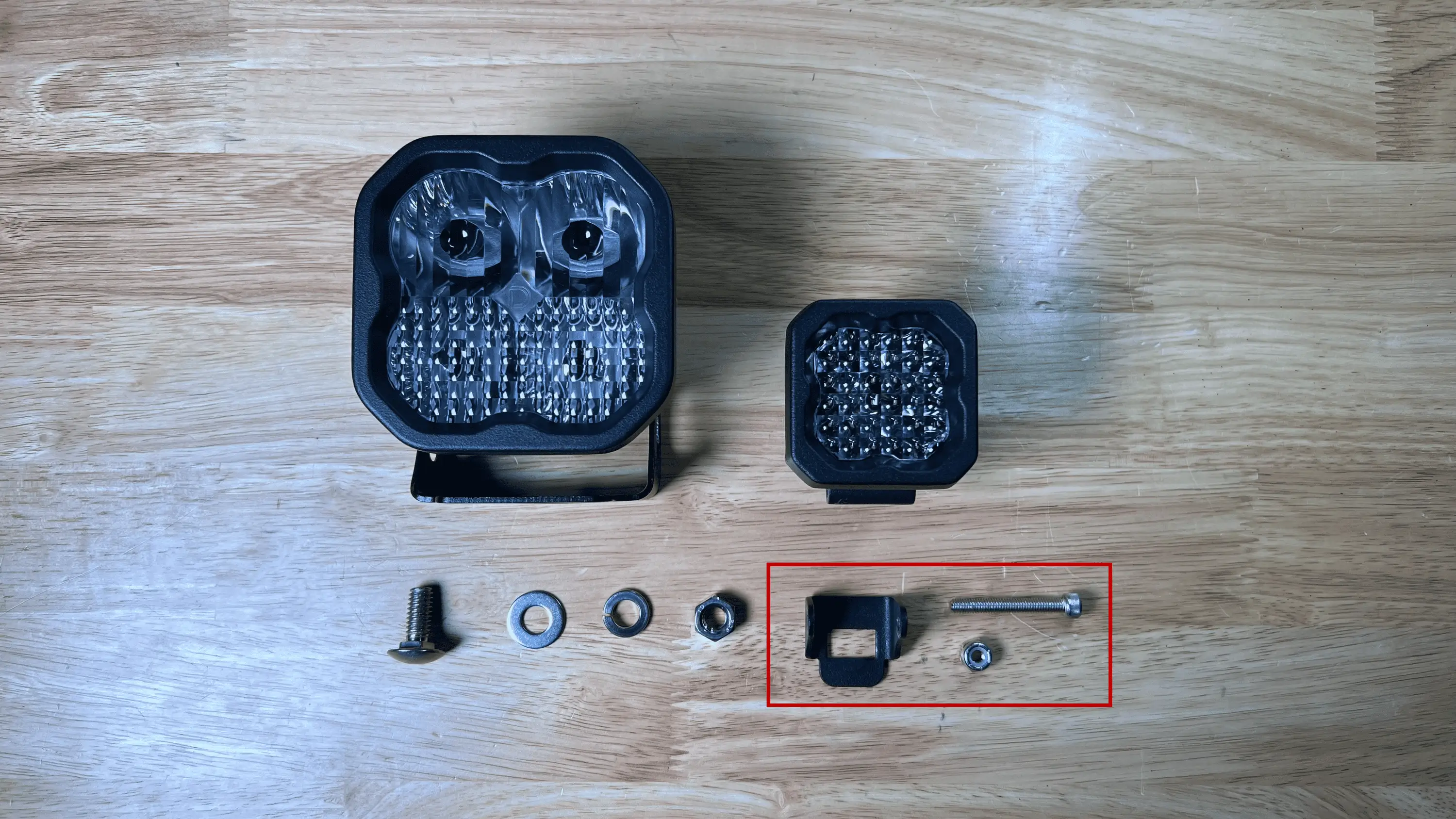

Ford Bronco Ditch Light Hack | SS3 + SSC1 LED Pods | Diode Dynamics Step 1 (Overlay)
Attach Universal SSC1 U-Bracket to SSC1 LED Pod

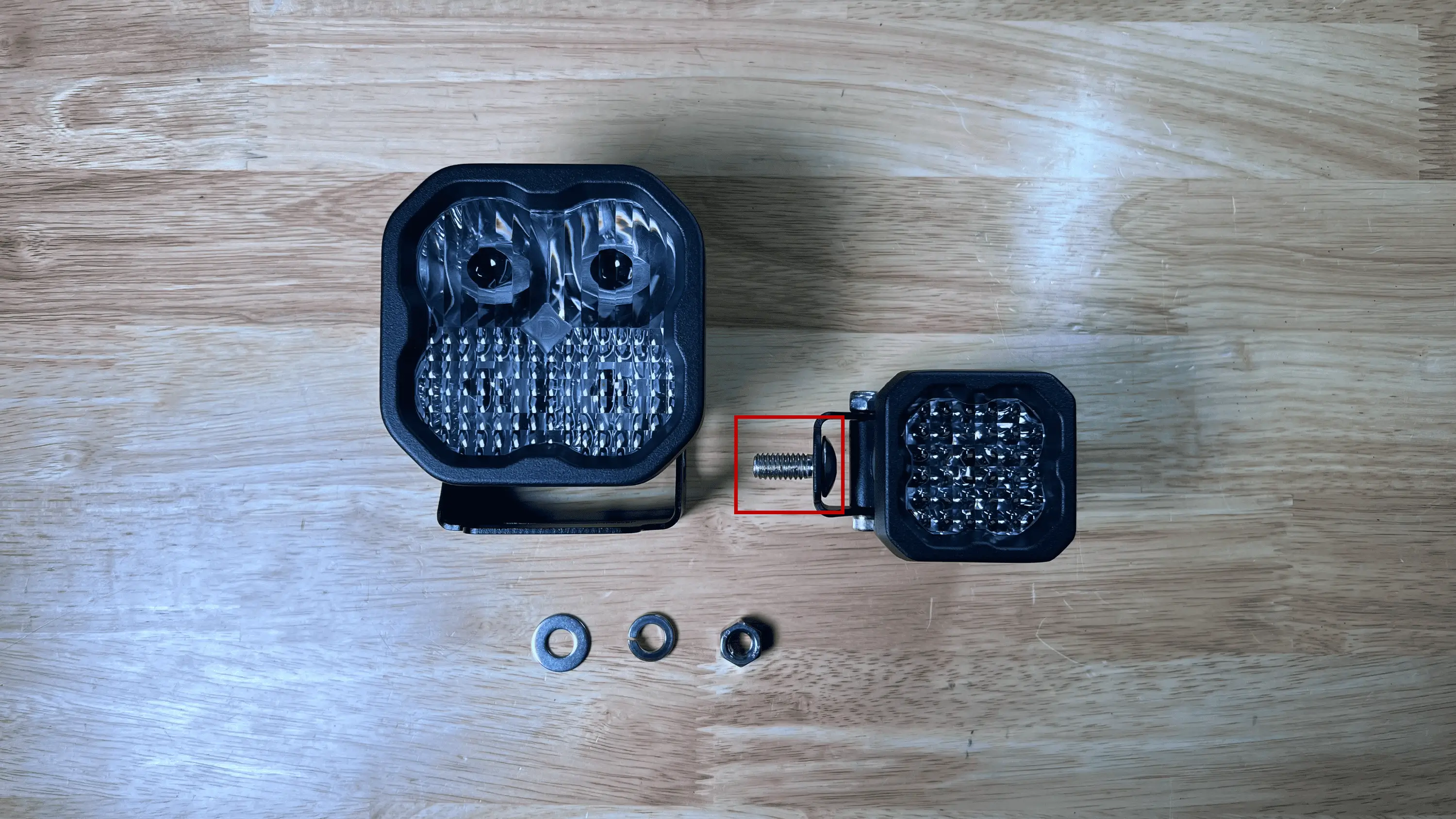

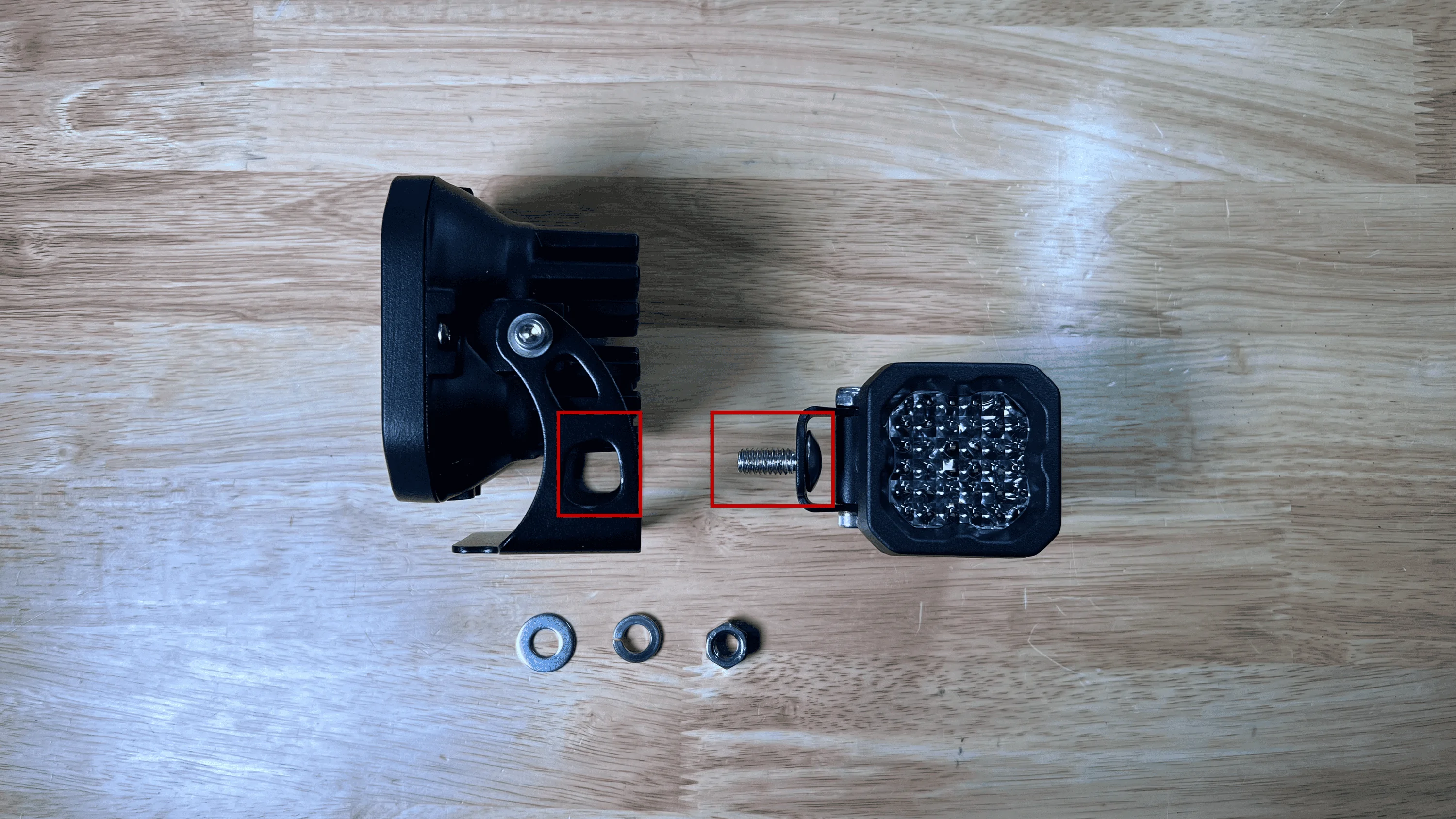

Ford Bronco Ditch Light Hack | SS3 + SSC1 LED Pods | Diode Dynamics Step 3 (Overlay)
Slide the included carriage bolt through the SSC1 U-Bracket

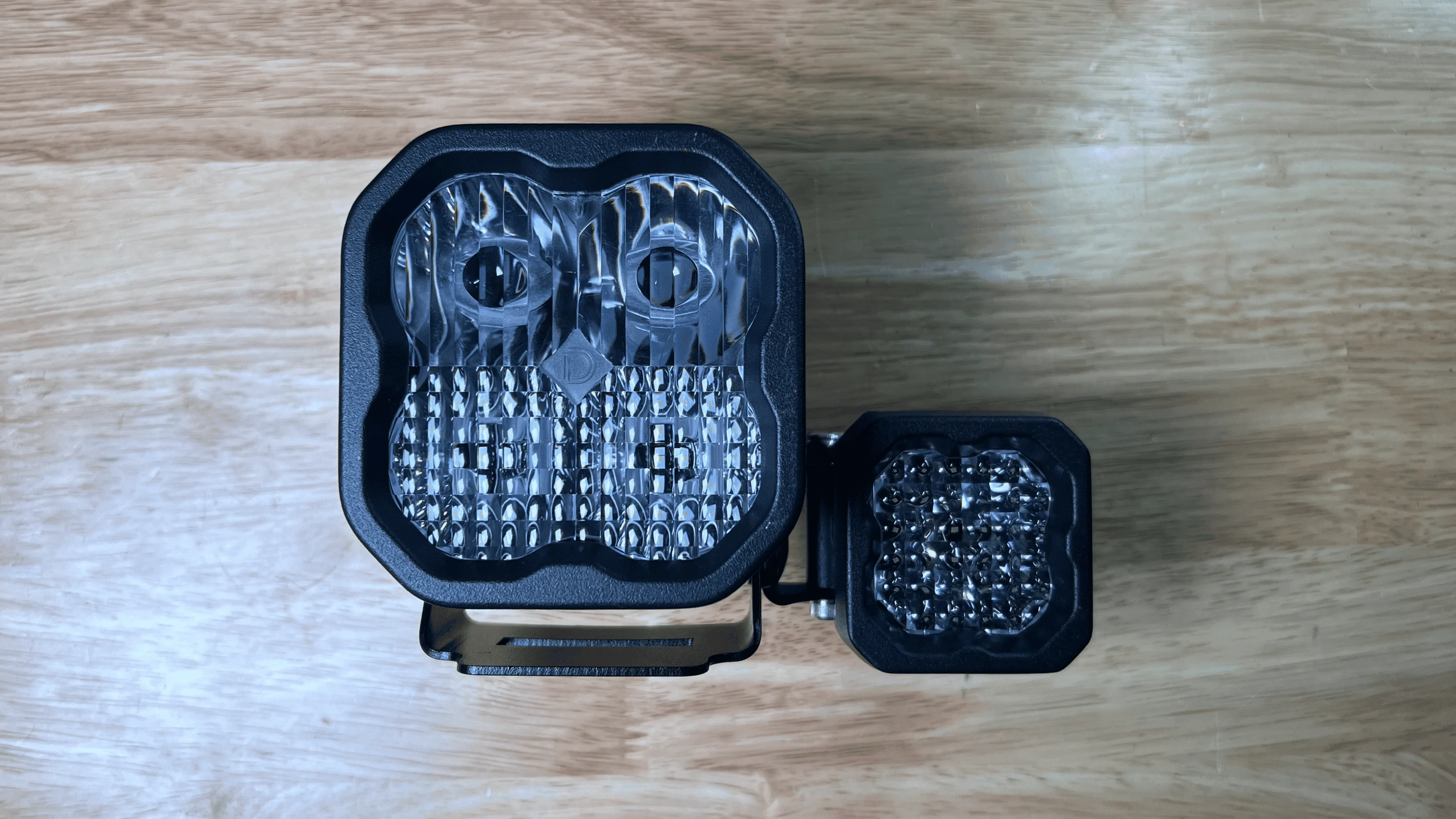

Ford Bronco Ditch Light Hack | SS3 + SSC1 LED Pods | Diode Dynamics Step 4 (Overlay)
Slide the SCC1 LED Pod with carriage bolt through the side of the SS3 U-Bracket
Ford Bronco Ditch Light Hack | SS3 + SSC1 LED Pods | Diode Dynamics Step 5 (Overlay)
SSC1 LED Pod with included carriage bolt through the side of our SS3 U-Bracket

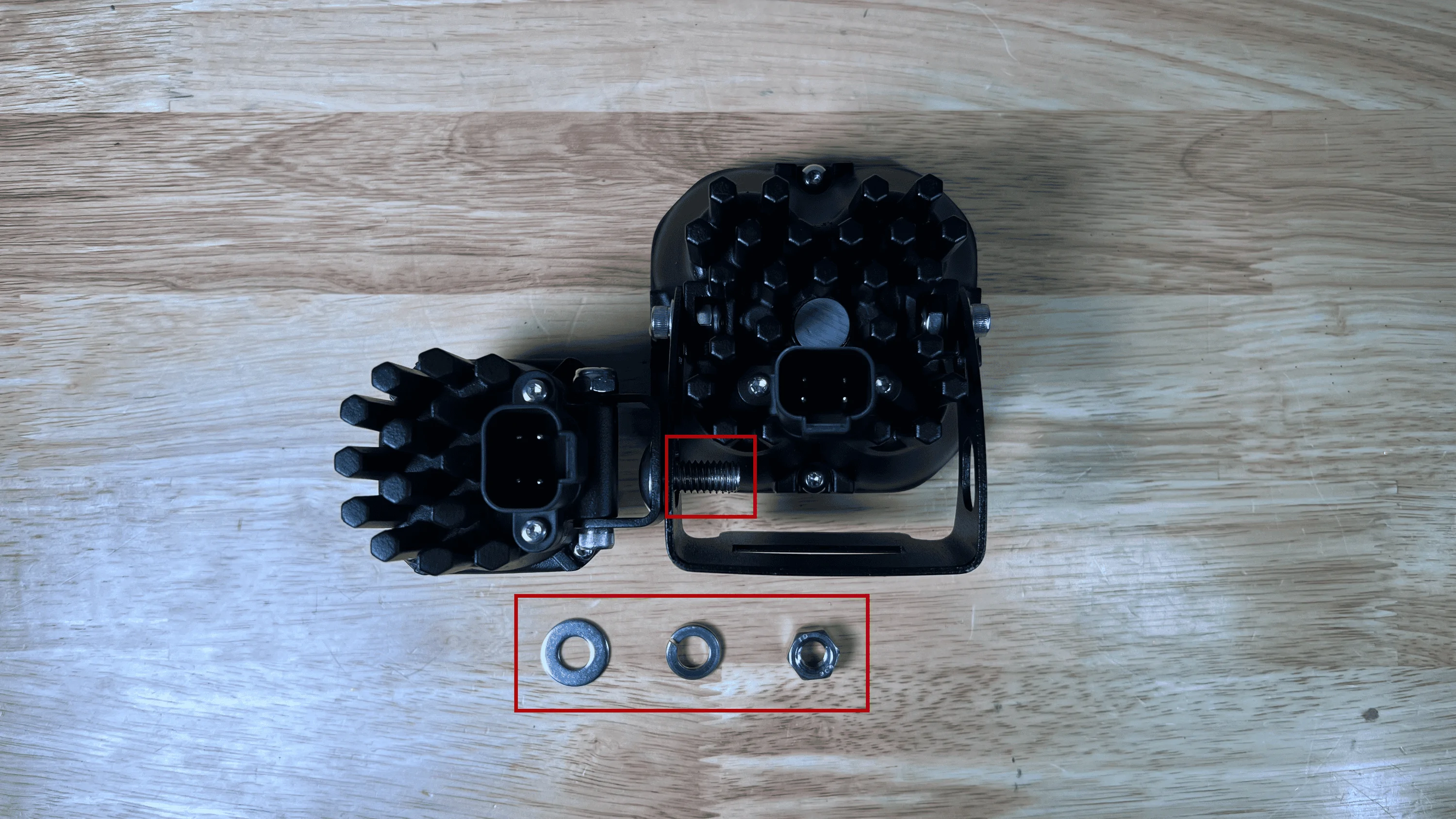

Ford Bronco Ditch Light Hack | SS3 + SSC1 LED Pods | Diode Dynamics Step 6 (Overlay)
Thread on the included washer, lock washer, and nut to secure the SSC1 LED Pod to the side of our SS3 U-Bracket

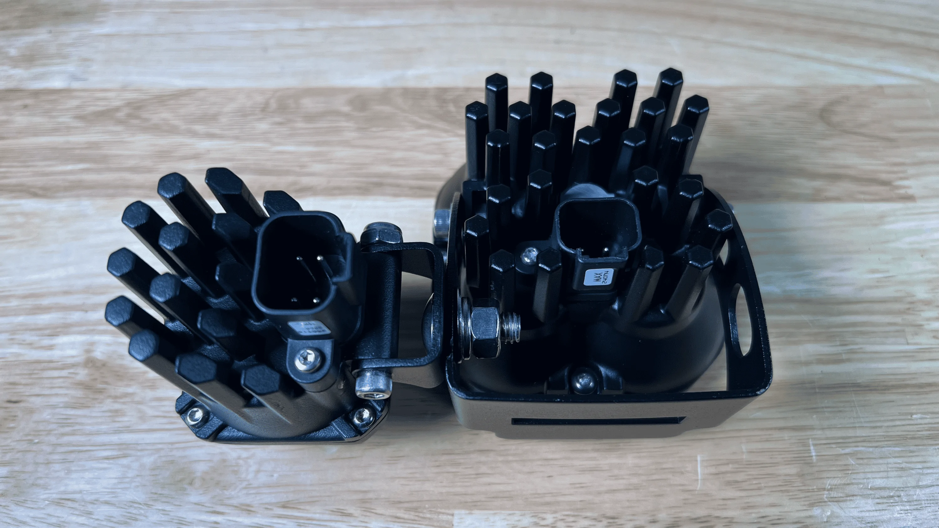

Ford Bronco Ditch Light Hack | SS3 + SSC1 LED Pods | Diode Dynamics Step 7
SSC1 LED Pod attached to our SS3 LED Pod

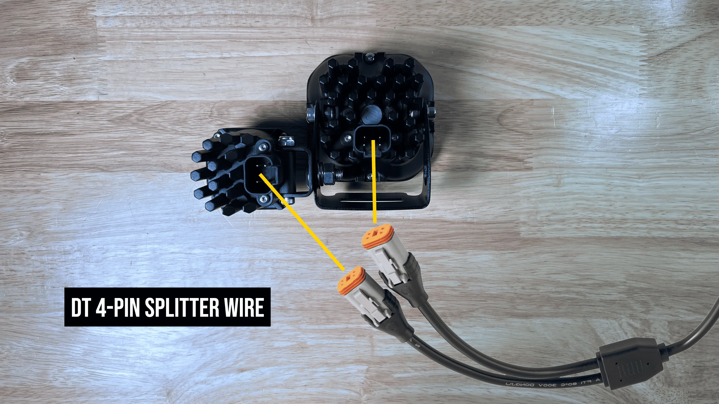

Ford Bronco Ditch Light Hack | SS3 + SSC1 LED Pods | Diode Dynamics Step 8.2 (overlay)

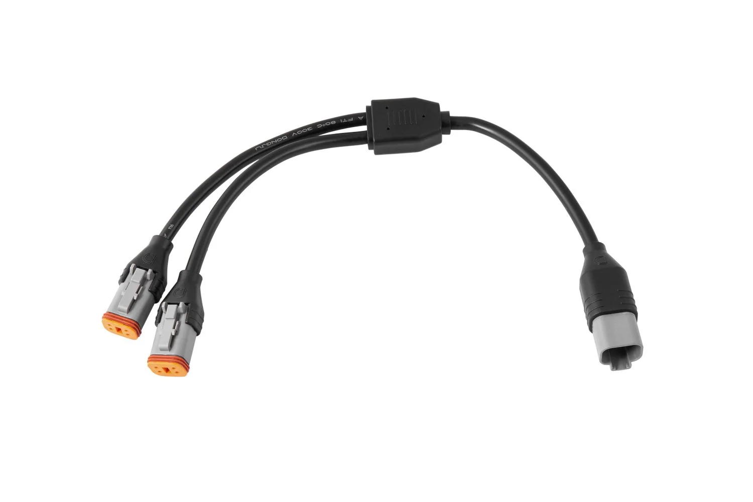

If you plan to have your SS3 and SSC1 LED pods backlight and main beam operate together, you'll need our DT 4-Pin Splitter Wire.
Click HERE to shop our 4-Pin DT Splitter Wire!

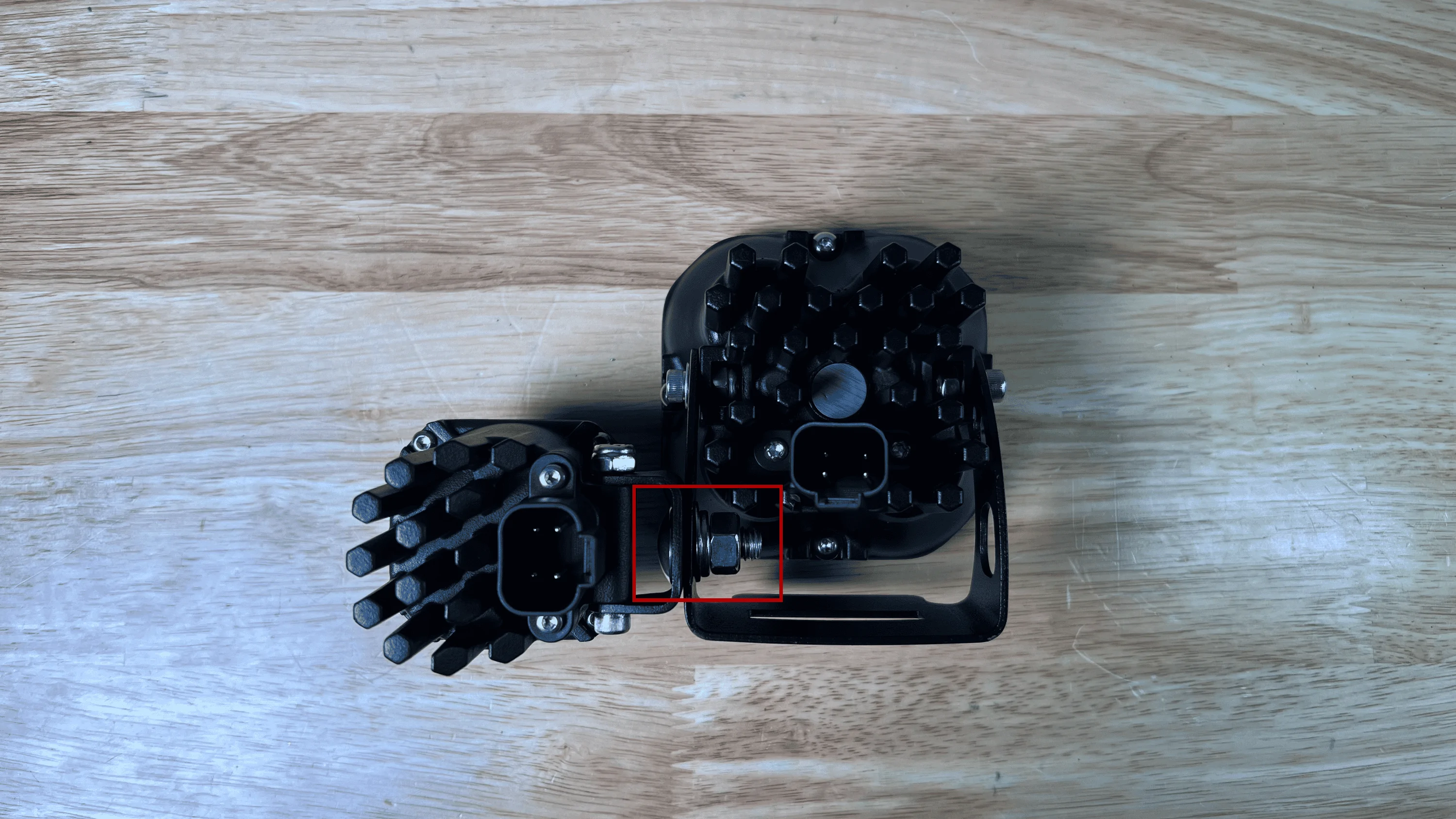

Ford Bronco Ditch Light Hack | SS3 + SSC1 LED Pods | Diode Dynamics Step 8 (Overlay)

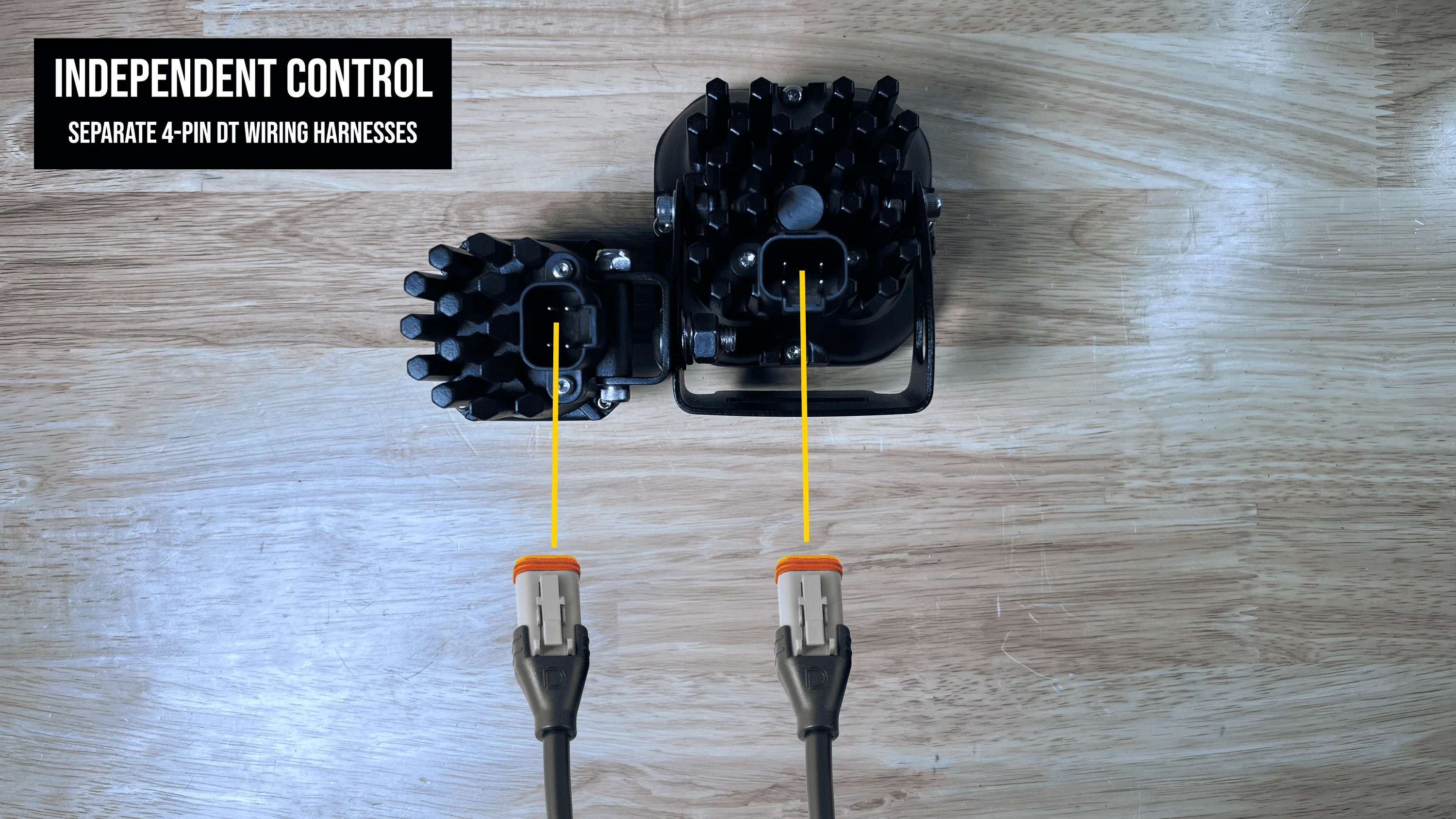

If you prefer to have independent control over your SS3 and SSC1 LED pods, you'll need to wire them using separate 4-Pin Wiring Harnesses.
Click HERE to shop 4-Pin DT Wiring Harnesses!
Ford Bronco Ditch Light Hack | SS3 + SSC1 LED Pods | Diode Dynamics Step 12
SS3 + SSC1 Ditch Light
