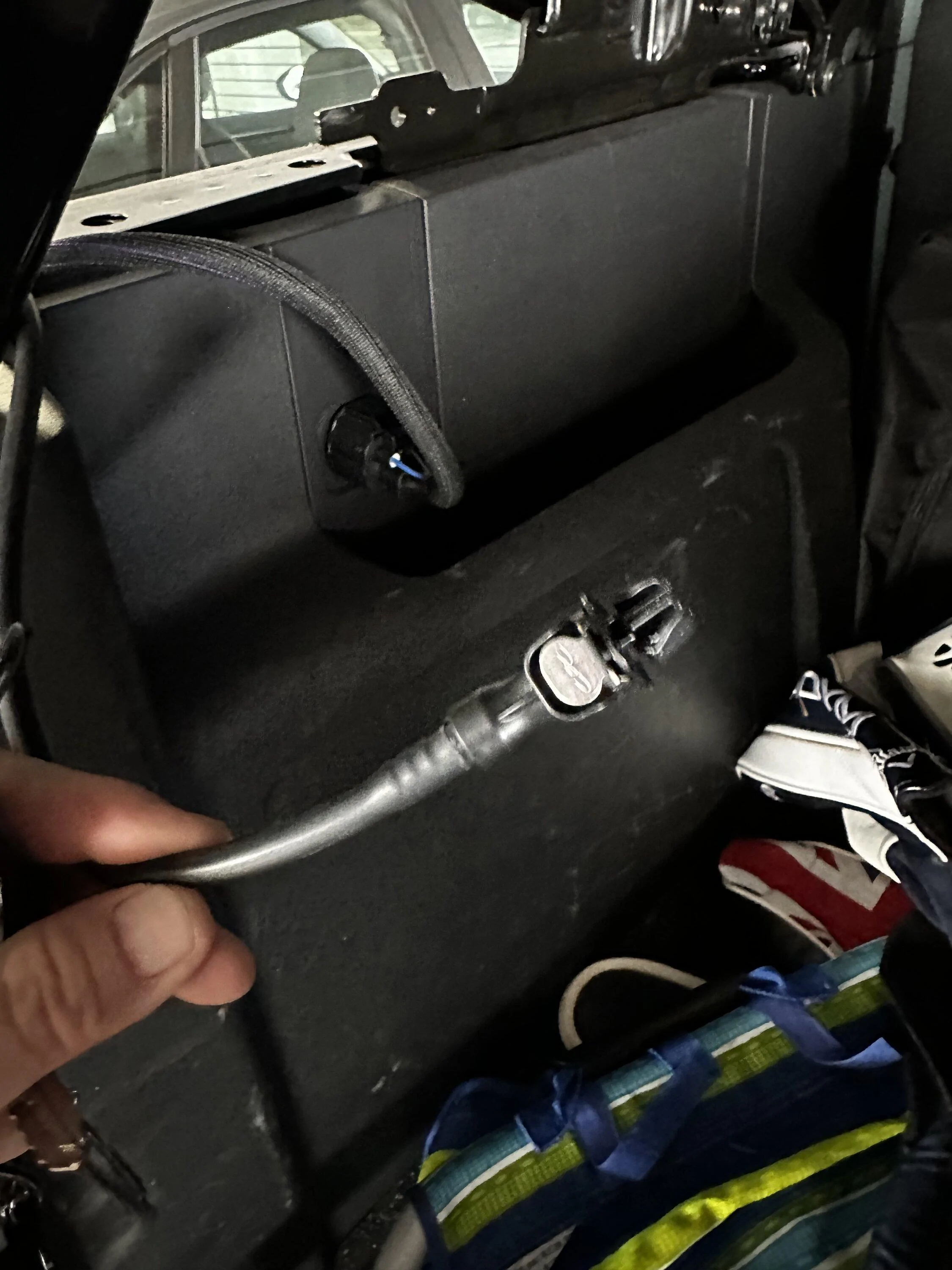

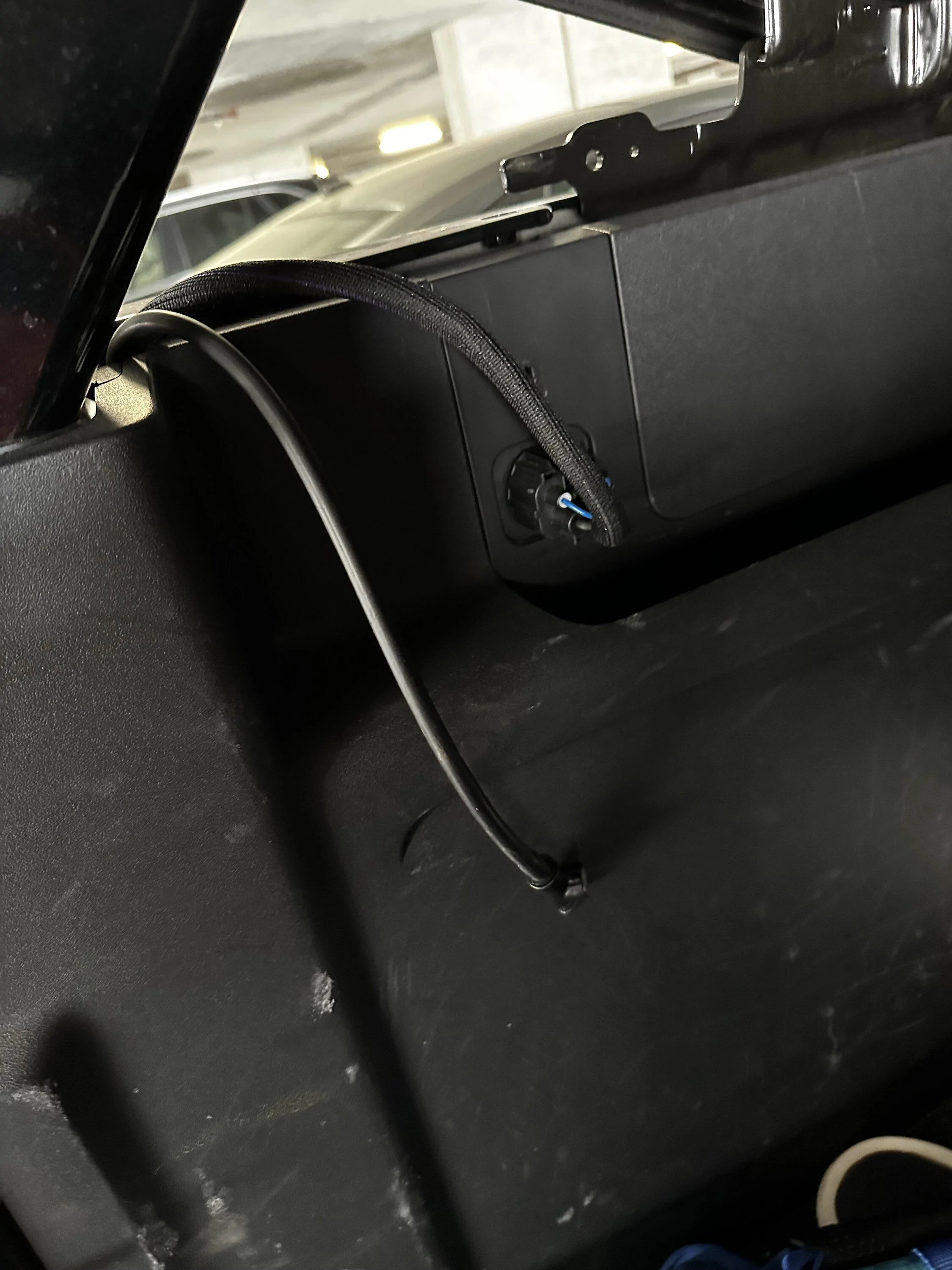

I dislodged the wire by accident in the trunk of my Bronco 2023 badlands soft top and I have no idea what it is for and where it goes - I have not the first idea of where to go to see it online
any help would be much appreciated
thanks

It's the washer fluid line for a hard top.
Plugs it right above the wiring harness in the photos you snapped. (That wiring harness is for the rear window defroster and wiper, if you had the hard top.)
