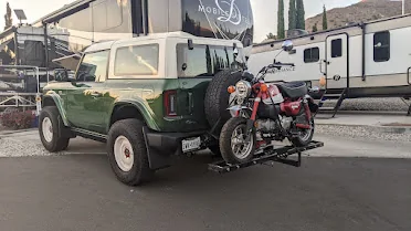

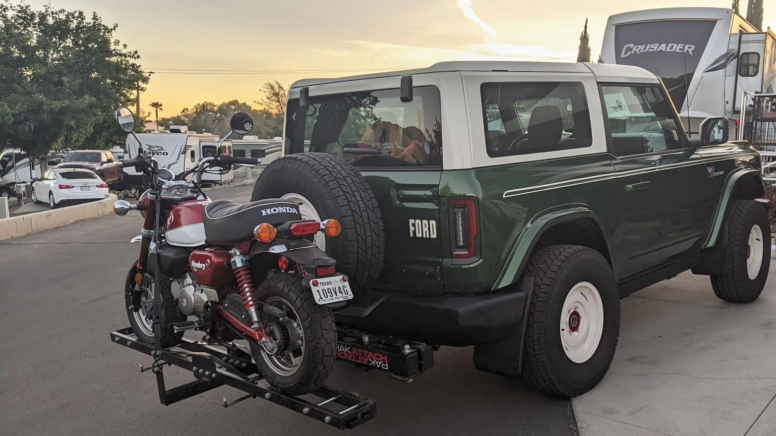

This is a 225 pound Honda Monkey on a heavy steel rack connected to a heavy steel hinged hitch extension (so you can swing the bike out of the way to open the tailgate. It's a lot of cantilevered weight and is fine for short trips, but if I were going far, I think I'd so something different.
The Monkey is a cool bike.

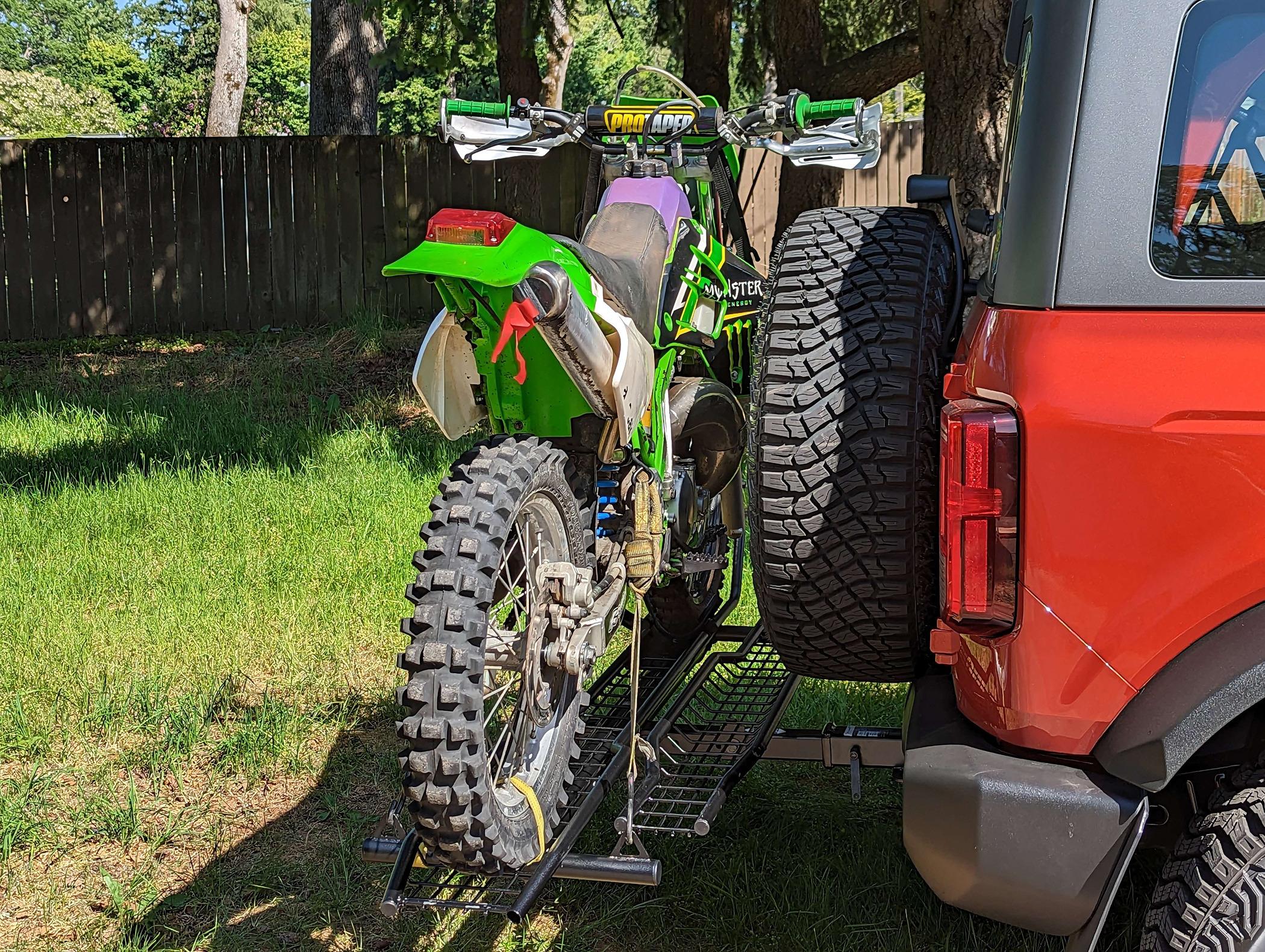

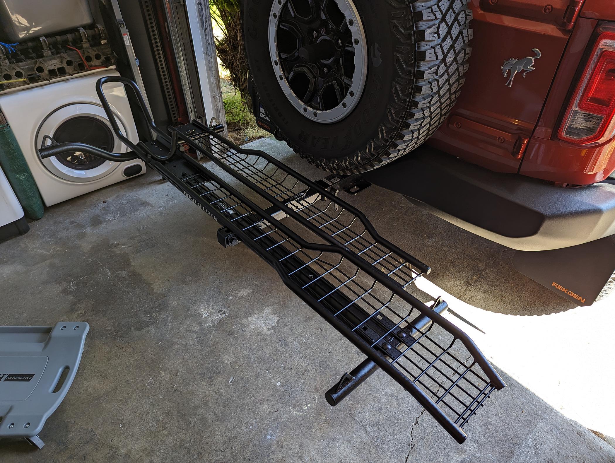

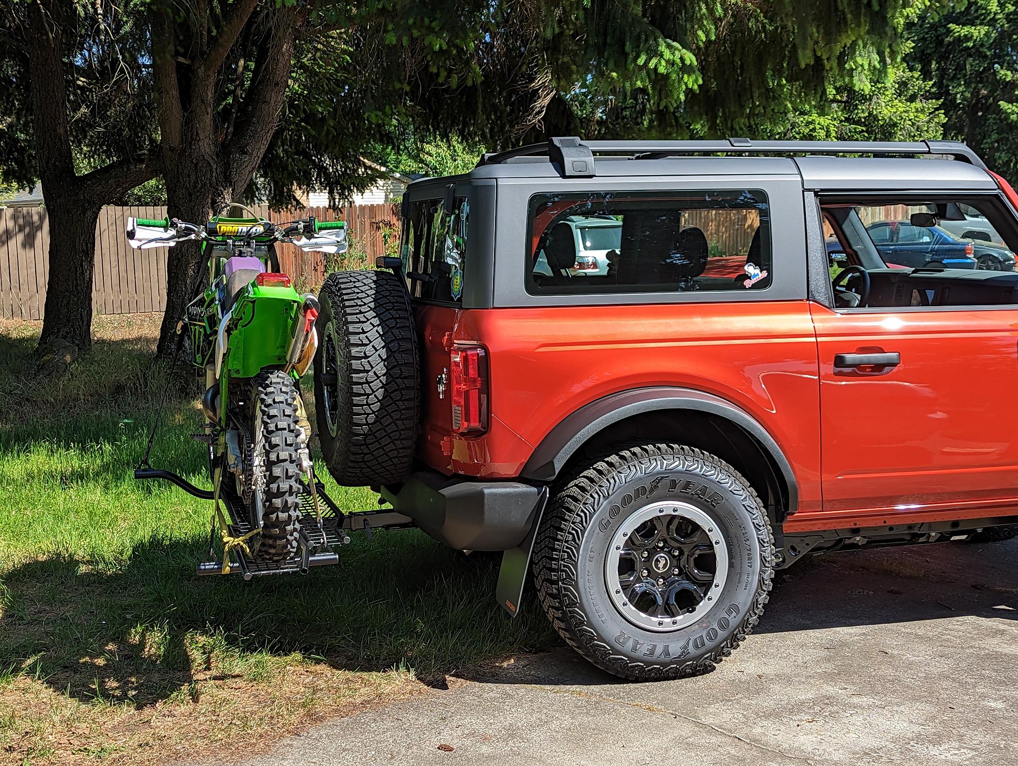

I use a mototote and an extended draw-tite hitch rated to 675 lbs tongue weight, most bronco hitches are rated lower. The carrier itself is rated to 600 lbs, and I intend to carry my adventure bike on this. This dirt bike only weighs about 220 lbs and I've driven it for hours, very solid compared to any hitch carrier setup I've tried before.
They will always sway and rock but it's expected in the design, I will be running extra straps from the carrier to the bronco for a little assistance in stabilizing the heavier bikes.
Yes it loses departure angle, but bikes are quite important to me and are why I ended up shopping for a bronco in the first place. (wanted a 4x4 suv capable of carrying an adv bike on the hitch to replace my pickup truck)
Ford Bronco Dirt bike carrier PXL_20230602_224658892
Ford Bronco Dirt bike carrier PXL_20230602_230410480
I understand there are concerns about the amount of weight and leverage on this part of the frame in general, so far it hasn't been a concern and I'm keeping an eye on it. Draw-tite went through the trouble to engineer and rate it as they did, I see no reason to argue it. Even though that last picture does look like its bending downward that's just sort of how the hitch sits. I don't have a muffler in that area anymore and may end up fabricating a brace on my own, still undecided on what I might put in that space though. A rear winch is likely and the mount for that could also act as a brace!

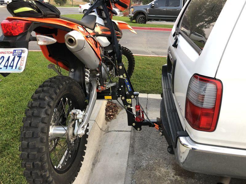

Seeing this one got me interested in this type of carrier:
