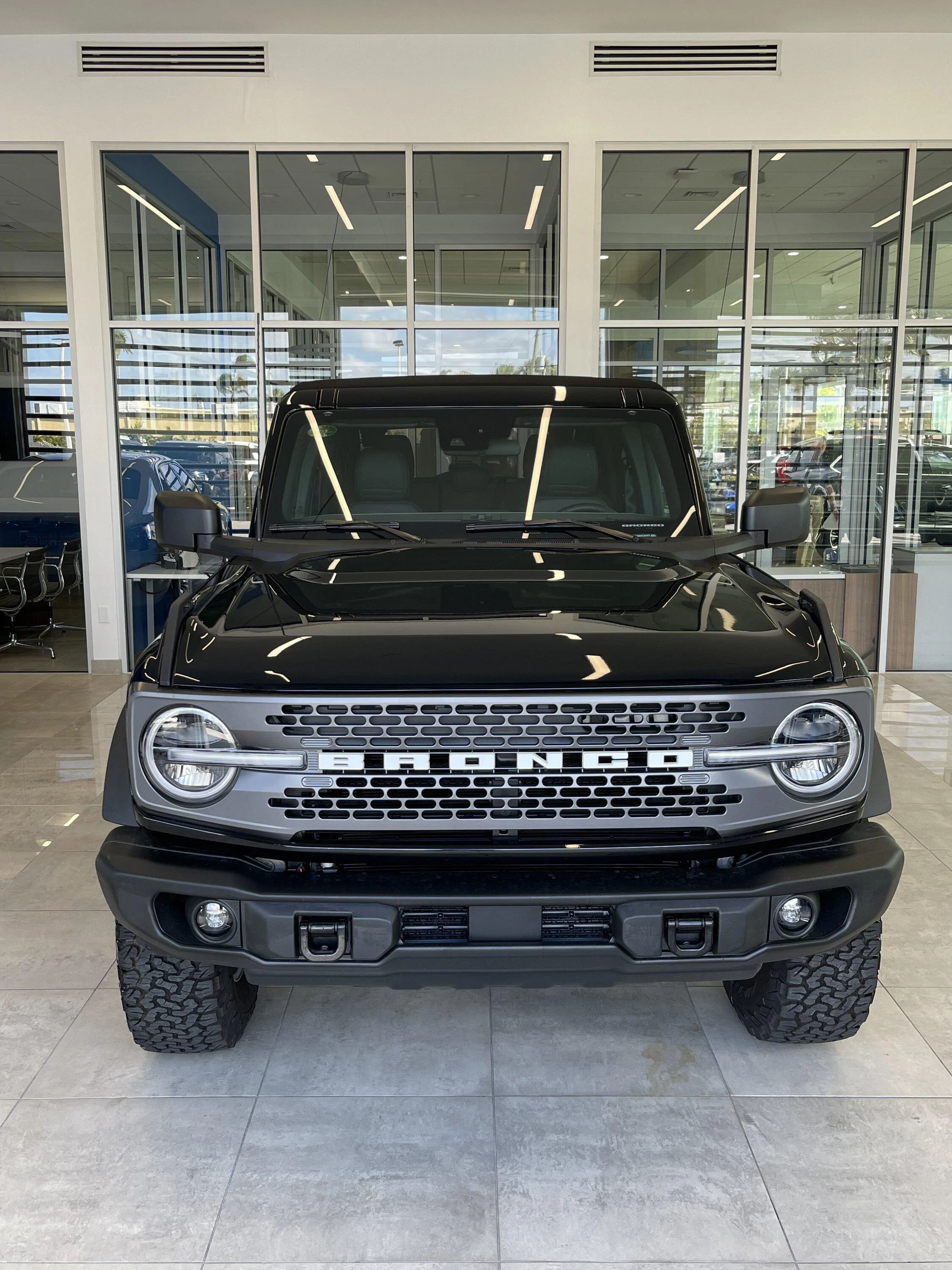

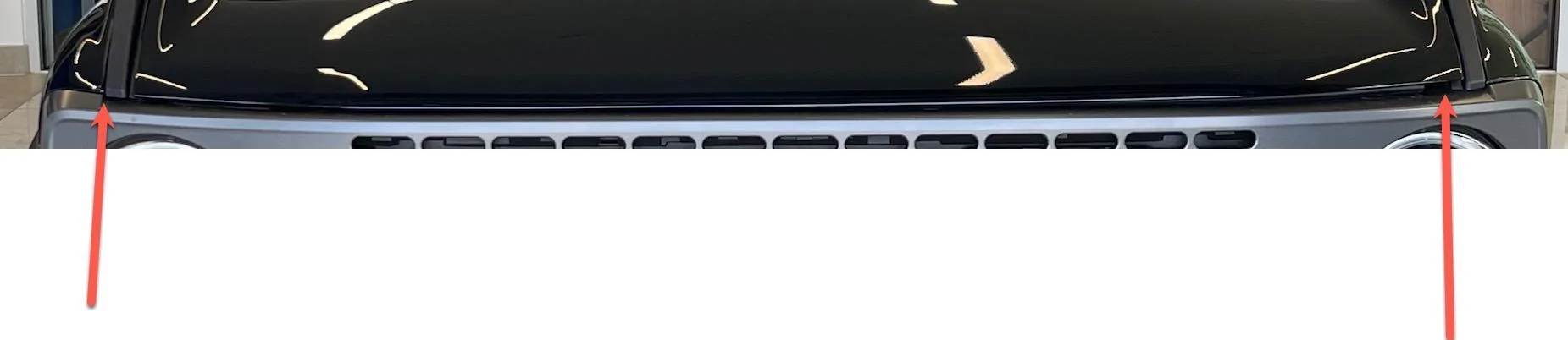

I took delivery of a new 2023 Ford bronco Badlands and realized after I drove it a day or so that the hood on one side wasn’t fitting properly and flapped a little at high speed - see picture and zoom in on drivers side of the front of the hood and you can see it is slightly higher than the passenger side
I took it back to the ford dealer and they said that someone may have closed the hood with something underneath the hood and it may have caused it. But denied it was them
It certainly wasn’t me as when I looked at the pictures I took at the dealer the day I picked it up it was already there
the dealer sent a claim to ford but they denied it as it was not classed as defective
the dealer has asked me to call ford and try myself but since I didn’t cause it I am reluctant to do that
What recourse do I have - I love the car and want to keep it but it is annoying when the hood flaps at high speed or it is windy
any ideas?

Is there any visible damage on the underside of the hood? Dents or anything indicating an object was present during a closing?

Yes there was a small dent in the underside near the bump stop - it isn’t visible from the outside. That is why they think it was closed with something on the chassis underneath it

Can you post a few better pictures, so hard to tell what you are talking about with the current views.

If you zoom in on the picture and look at the left hand side edge of the hood and then scroll across to the right hand side you can see that the right hand side gap is larger
