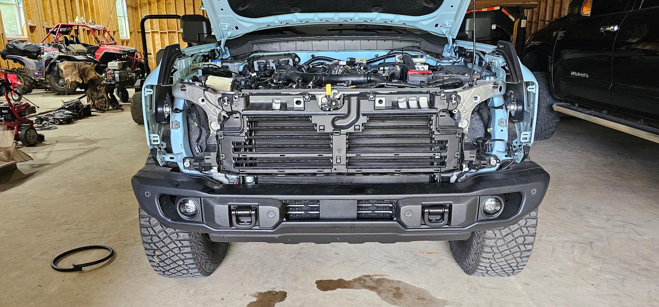

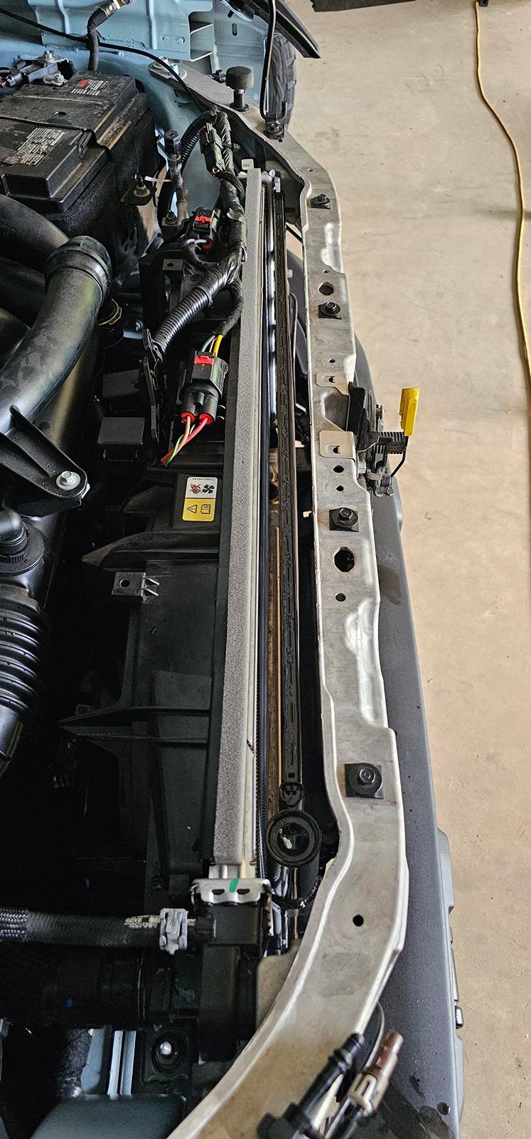

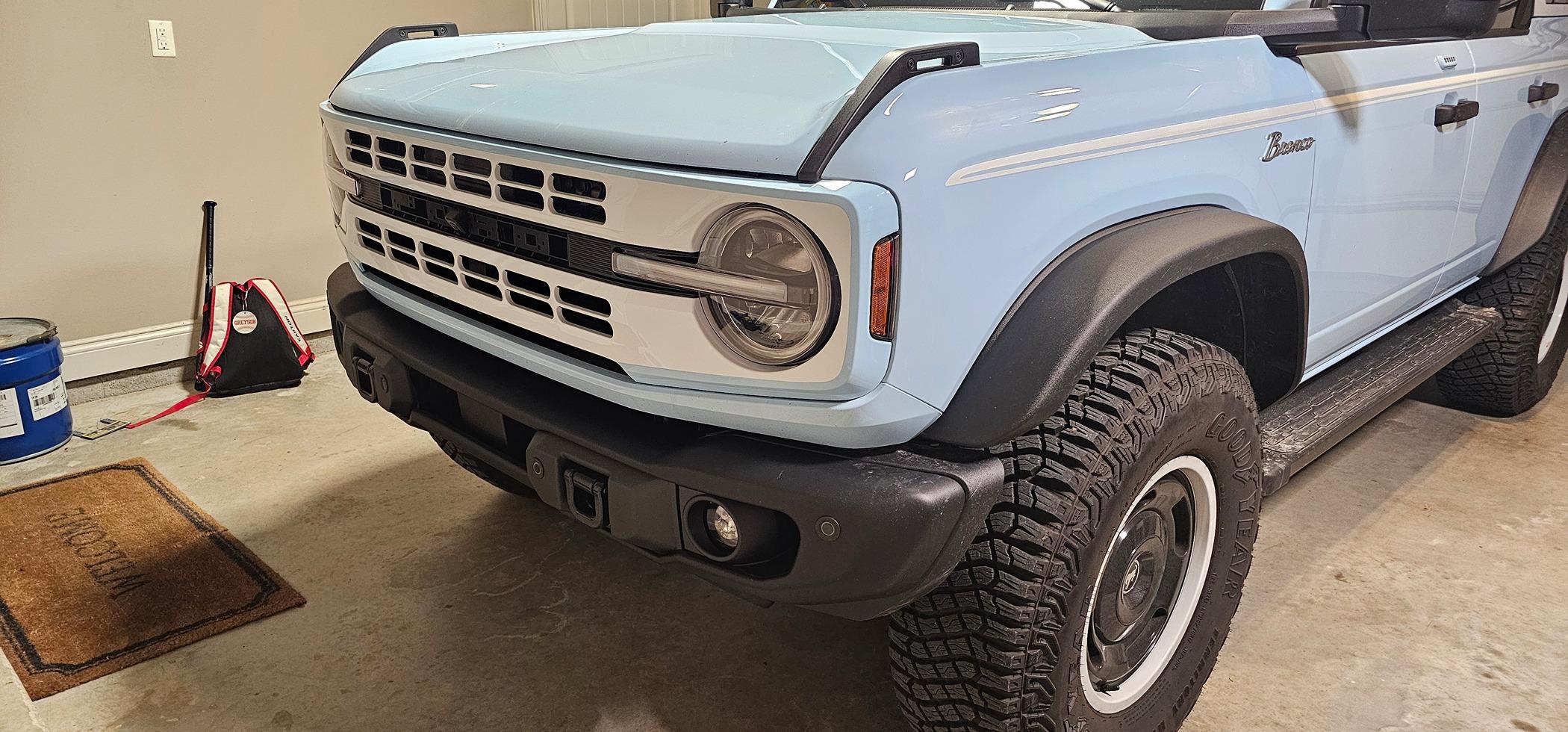

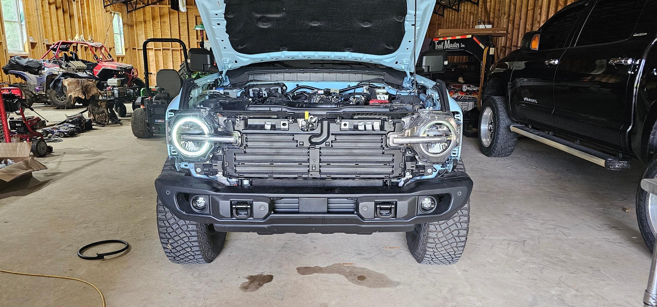

Removing and replacing parts was very simple. I only needed a few sockets, a few torx bits, a push pin removal tool, and three hose/line clamps to keep from losing all the coolant. I had a local shop pull down the AC system so I could replace the condenser and then had them recharge it. I did have to replace the headlight processor and tell the system to recognize and accept it so that the headlight would function properly. Had the edge of the new grille painted body color as I'm a fan of the look, think it blends better, and is more "heritage" than the whole thing being white. I gotta get some trim nuts to mount the FORD letters and get the front camera recalibrated and it'll be a wrap.

Wow man, you are quite talented with a wrench! Taking DIY to the next level. :)
Sorry this happened to your wife, but good thing she has you to step up and lean into these situations. Impressive work and I bet it’s now put together better than factory.
Cheers to you! 🍻
Cheers to you! 🍻
This really was easy brother. I'm a hotrod fella and wrench on old cars and trucks pretty regularly. I was kinda surprised how easy this was to do being that it is new. It seems the newer the vehicle, the harder the manufacturer's have made it for the average Joe to work on it themselves. I have to tip my hat to Ford for the Bronco so far. Seems like they've made most stuff "DIY friendly" to some extent. 🍻
