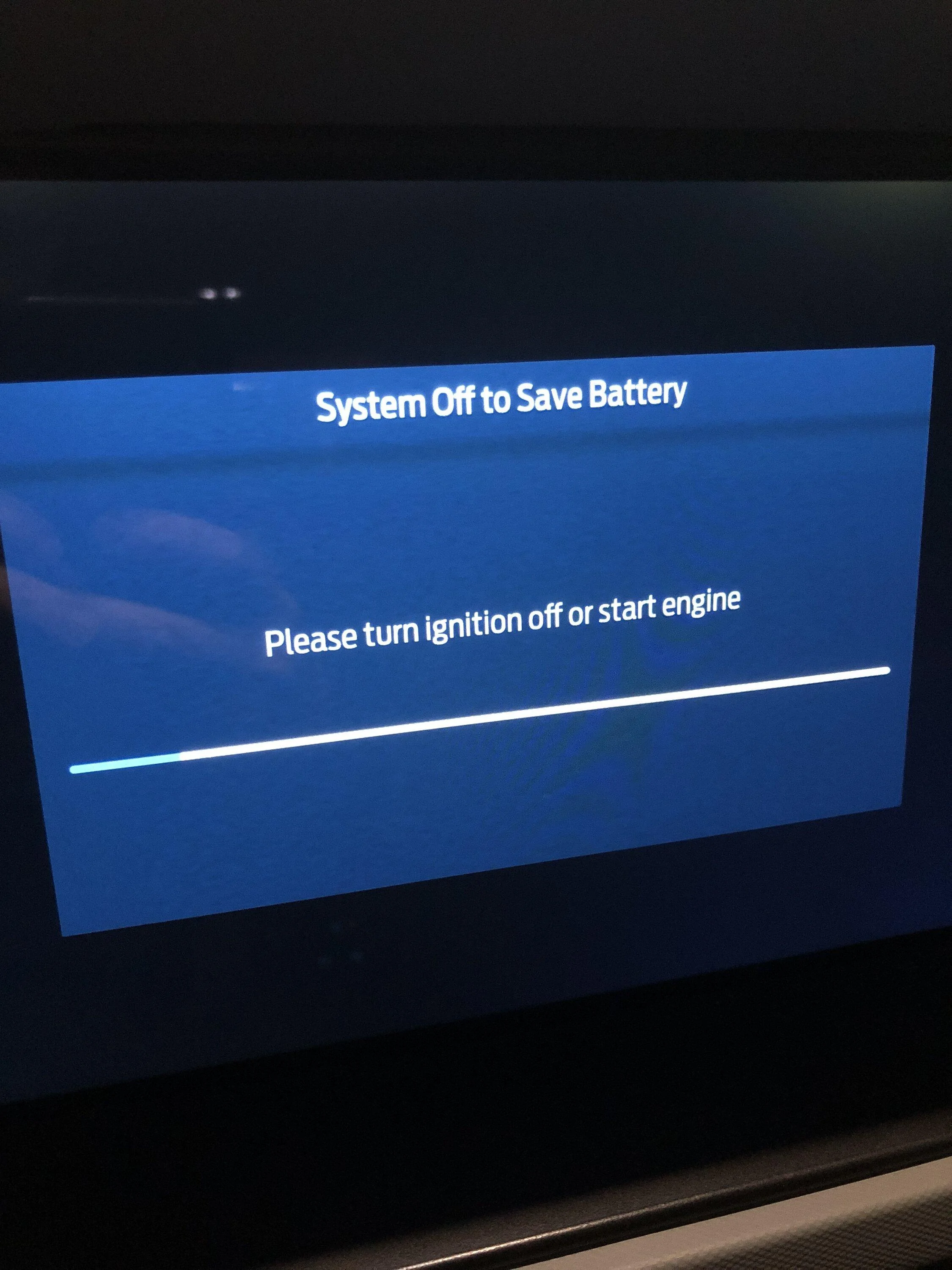

How do I get my 2021 Bronco Badlands out of Deep Sleep Mode? Every time I turn it off, I get this message. See attached.
Sounds like new battery time.....
I would have your battery tested to see if it is holding enough charge.... The batteries in these do not last as long as the batteries in cars of old even though the batteries are much improved. The drain all these electronics puts on them is tremendous.

This is constant for me. I drive it everyday🤷‍♂️ Annoying.

If you are only doing short trips - it’s possible that the Bronco isn’t on long enough to get a net positive charge.
My wife has seen this a couple of times on her Sport — most of her trips are just a mile down to the bus stop and back, and if that’s all she does for a couple of weeks straight the engine doesn’t get enough run time to overcome the electric draw from starting and all the one board electric run crap for really short trips.
The first thing I would try it out a charger on it and let the battery charge to full that way.
If that doesn’t work - either the battery is bad (most likely) or bad alternator (less likely but possible). There is a remote chance you have a wiring issue with a constant drain as well - but usually it’s just a sign of a dying battery.

Well I figured the problem out. When I deleted my phone from the phone list a few days ago, and reconnected it again, it somehow reset the Deep Sleep mode setting. I haven’t had a problem since. I’ve also checked my battery and it was good. Weird!
