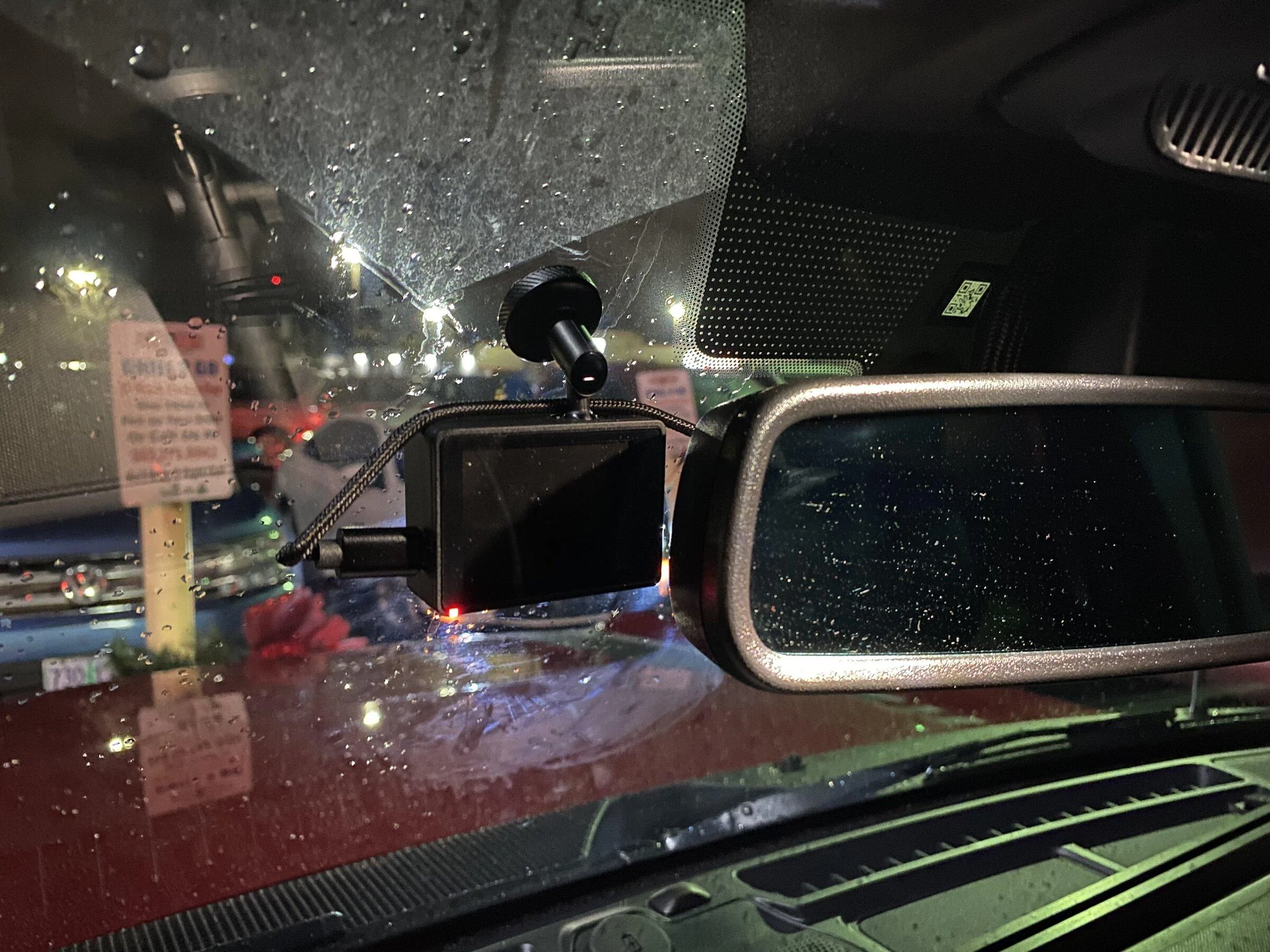

Dashcam blocks mirror sensor

I put mine on the right hand side of the mirror bracket, in front of the mirror. There’s no camera/sensor there to block.

I just off set my Garmin a bit from my mirror
We don’t have the same thing I have a big box on the right side

So adding a little chrome vinyl to the back of the dash cam reflects light back to the sensor and it solved the issue.
NICE! Good solve!
