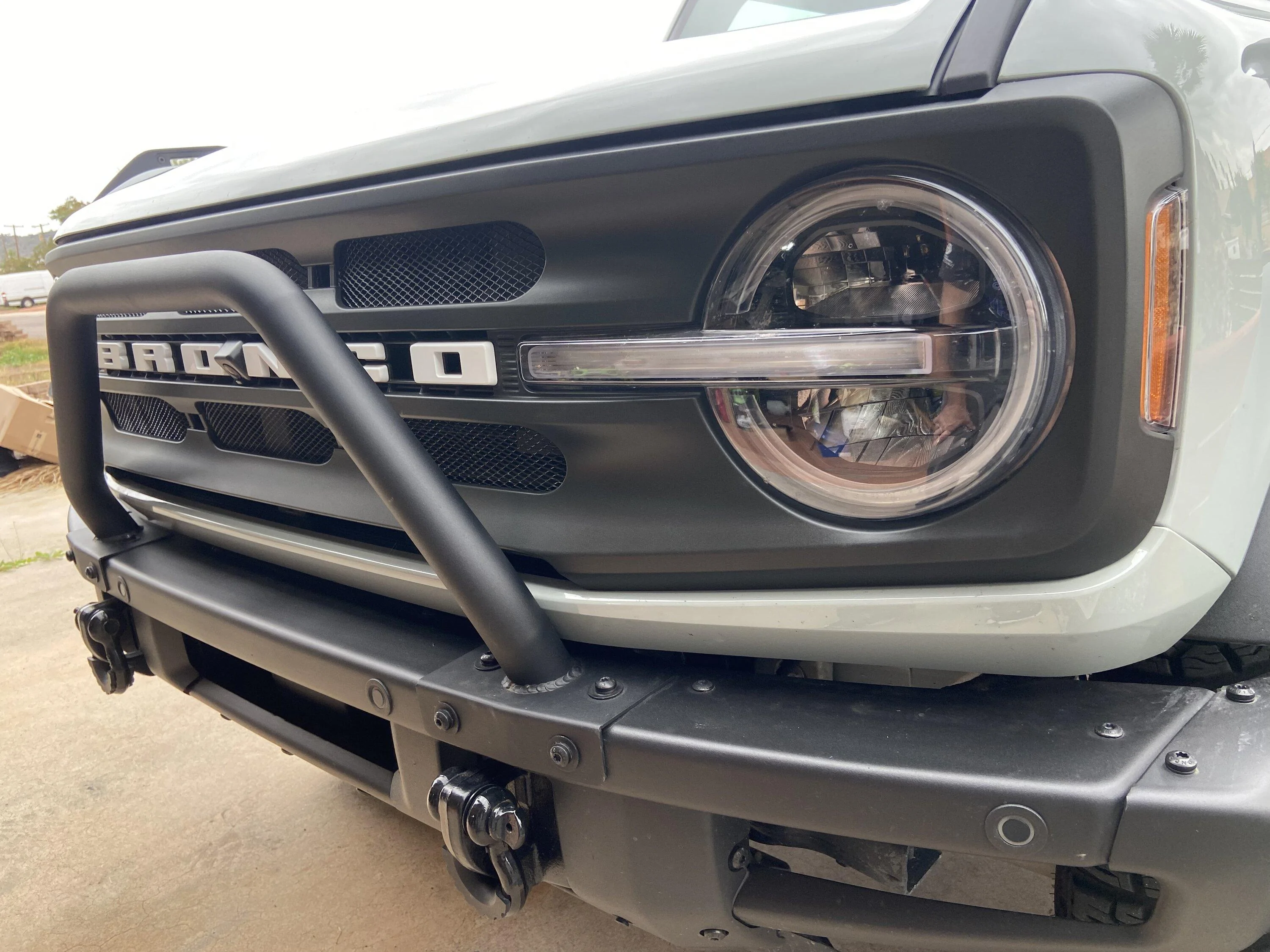

Be the looks of your disassembly, the BRONCO letters are removable from the grill. Can anyone confirm if the letters are removable on the base? I'd like to swap the letters from a base grill to my BL grill. Keeping the BL look, but have black letters. Anyone know if that would work? Maybe I'm working too hard here? I haven't poked around to see if the Base letter kit is available.
Yes, they are interchangeable. However, they have plastic posts that have been melted onto the grill So you will need to drill the melted caps off from the back to pull them off. I then epoxyed back over the post holes to get them to re-attach

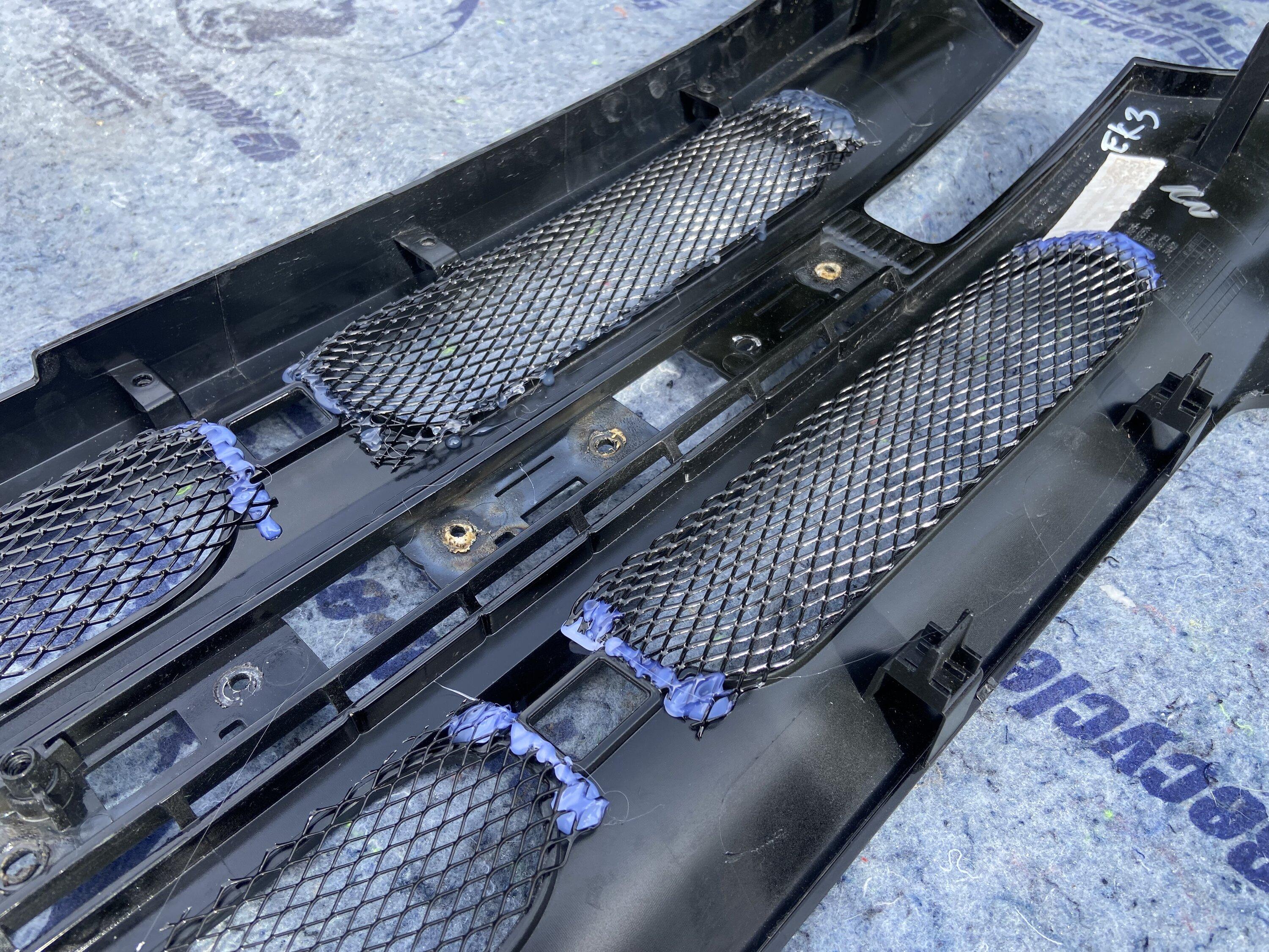

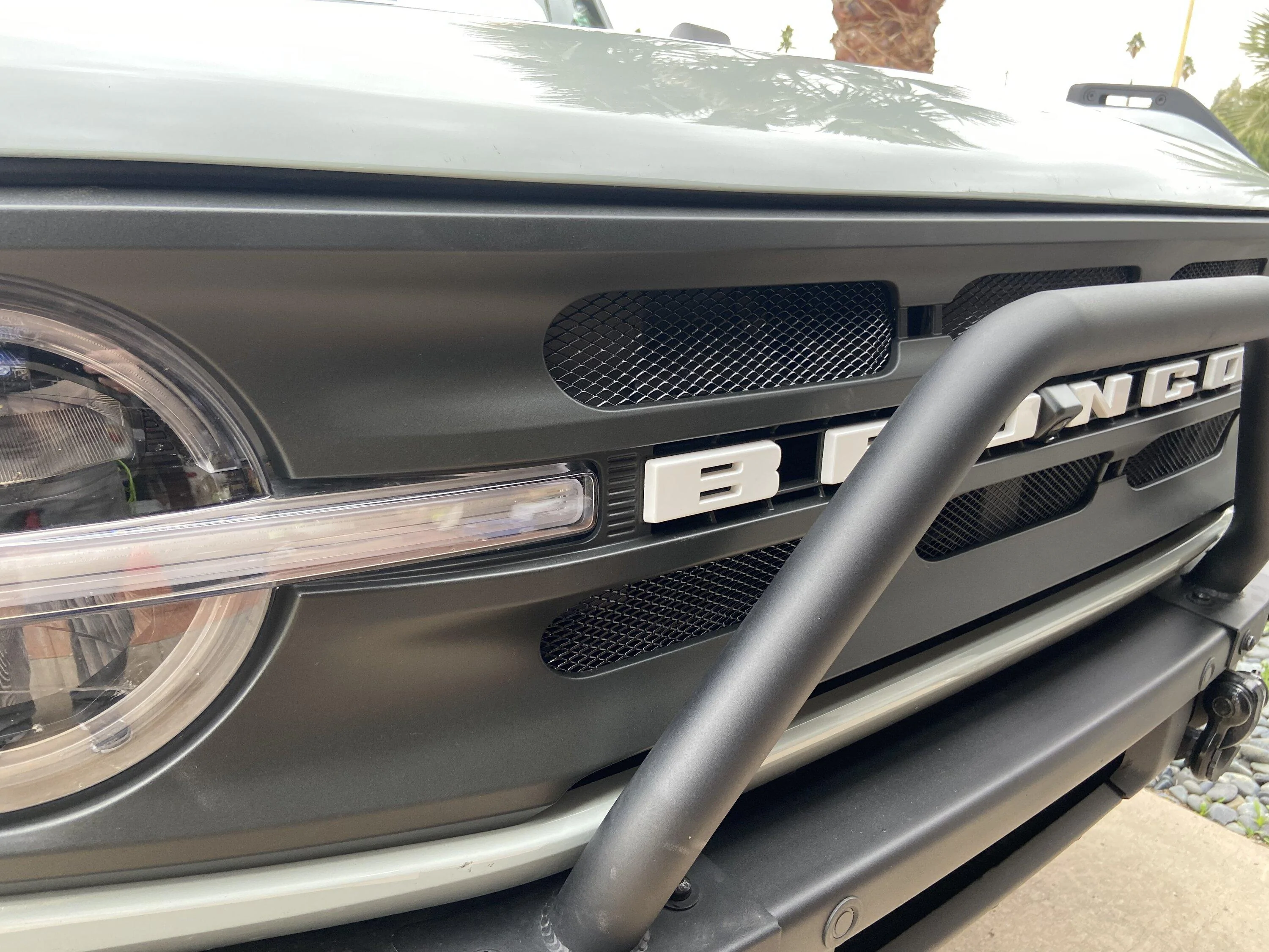

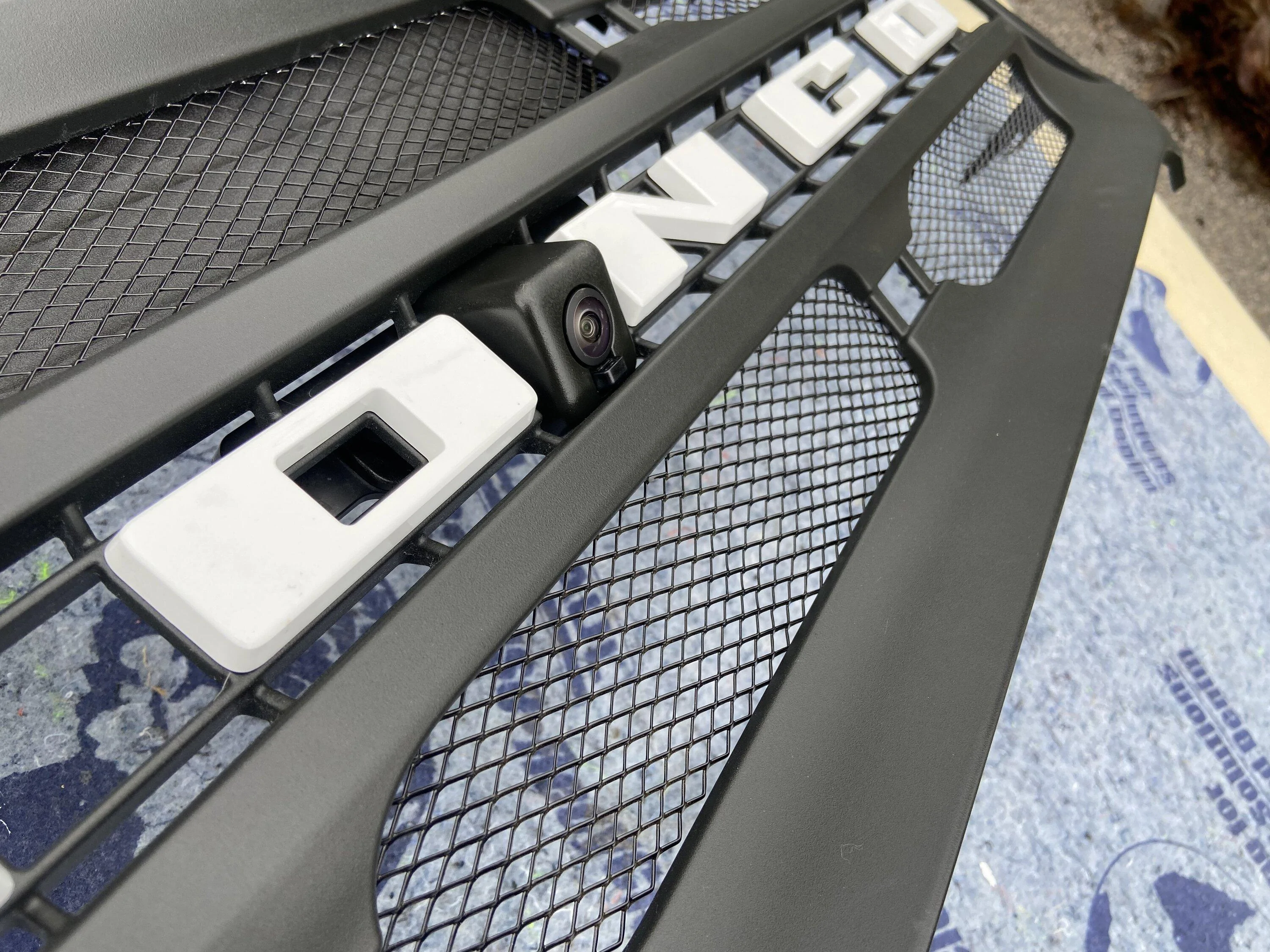

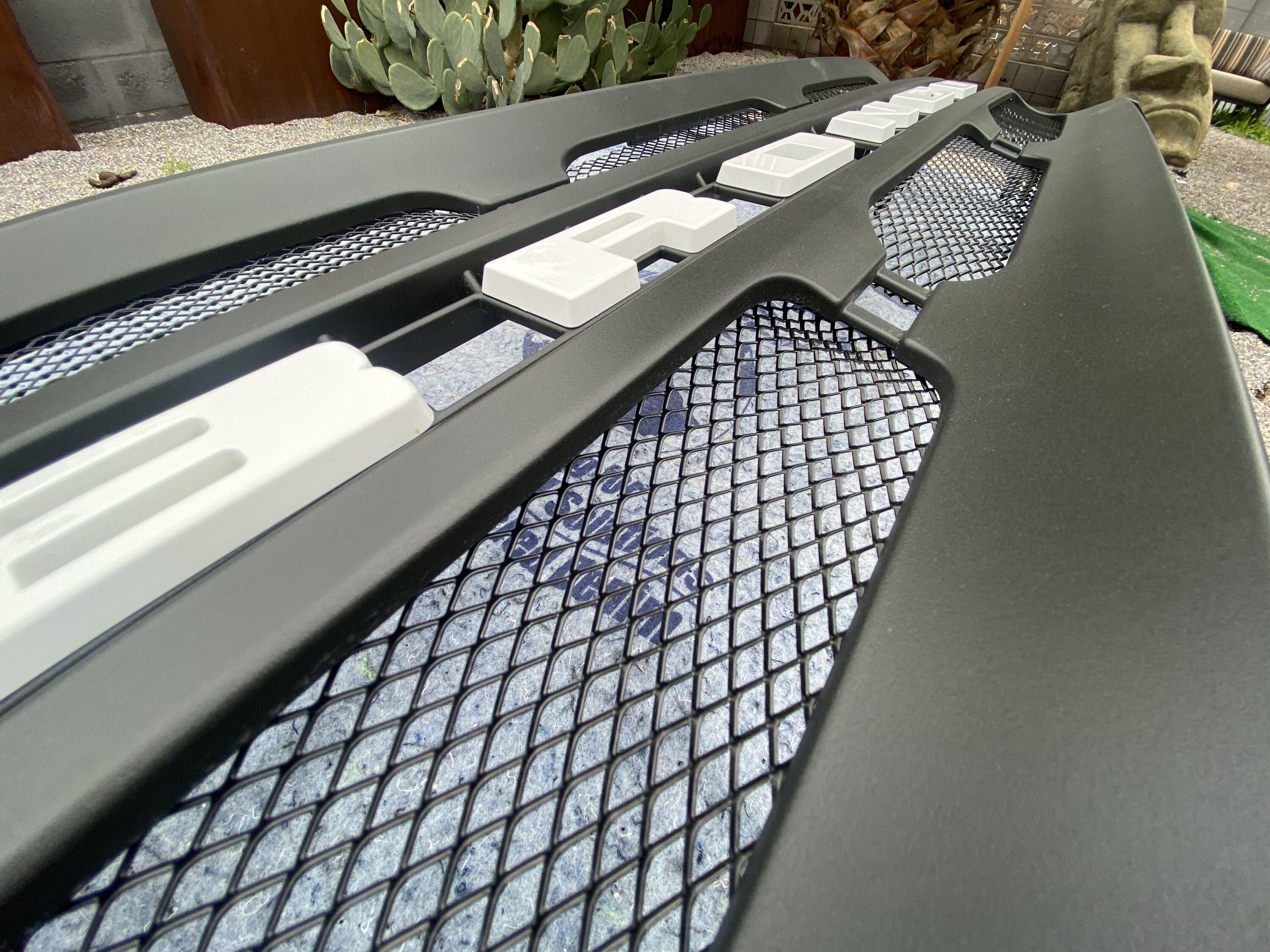

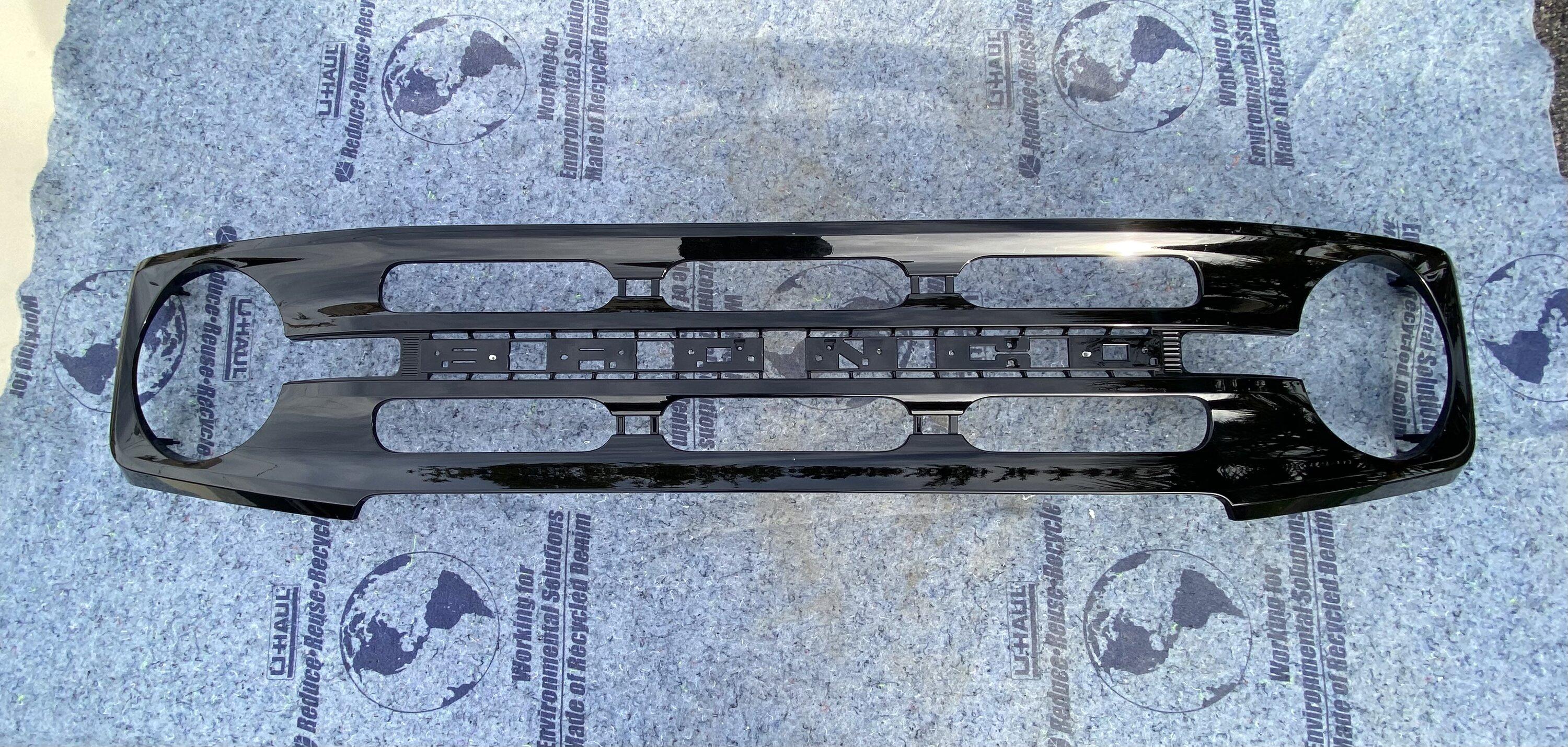

So, I addressed an oversight by Ford (in my opinion). The Outer Banks/Big Bend grill, to me, is the nicest/coolest grill on the Broncos. I’m not sure if I had been swayed by the reveal Broncos, but it just looks cool to me.
However, I always felt the Big Bend looked better than OBX, and I think that’s because the grills details get lost in gloss black. But also, nothing really matched the Big Bend carbonized grey grill color.
Same with the Badlands carbonized grey grill. With it being right next to the flares, bumper, and trailsights, it just looks peculiar (to me at least)

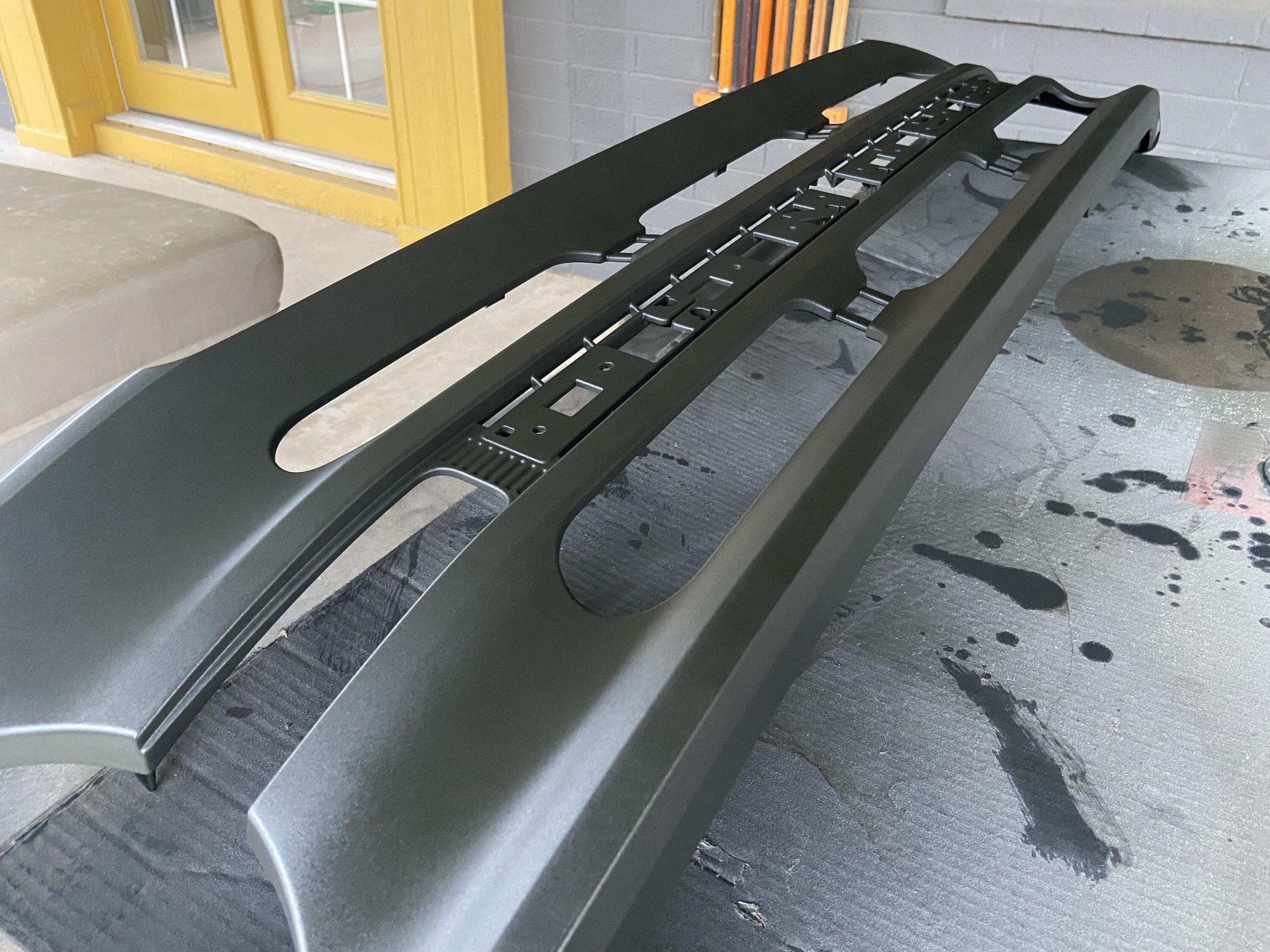

So I finally got my hands on an OBX grill, and went ahead with prepping and painting it a matte black, finishing it with a satin gloss clear coat.

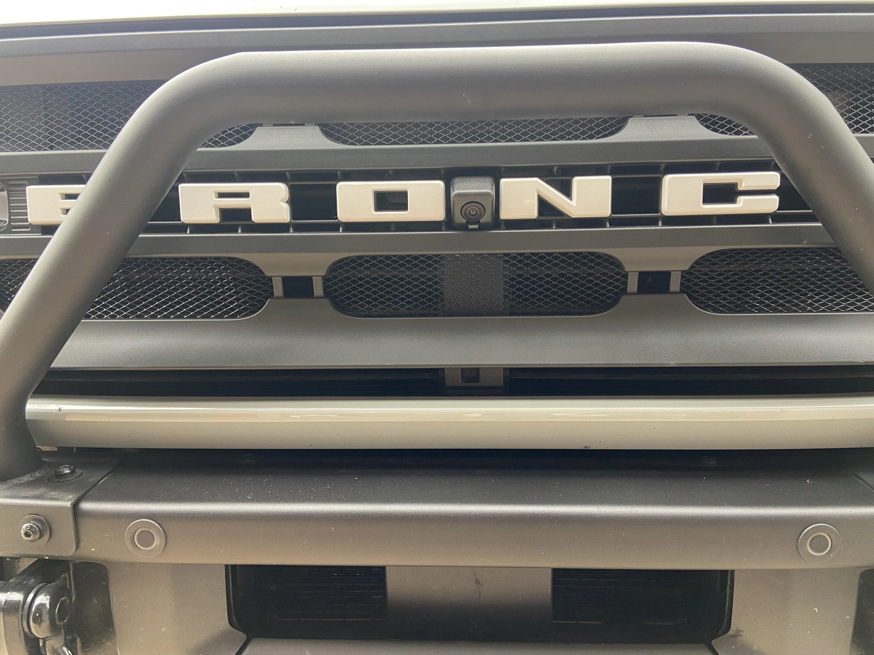

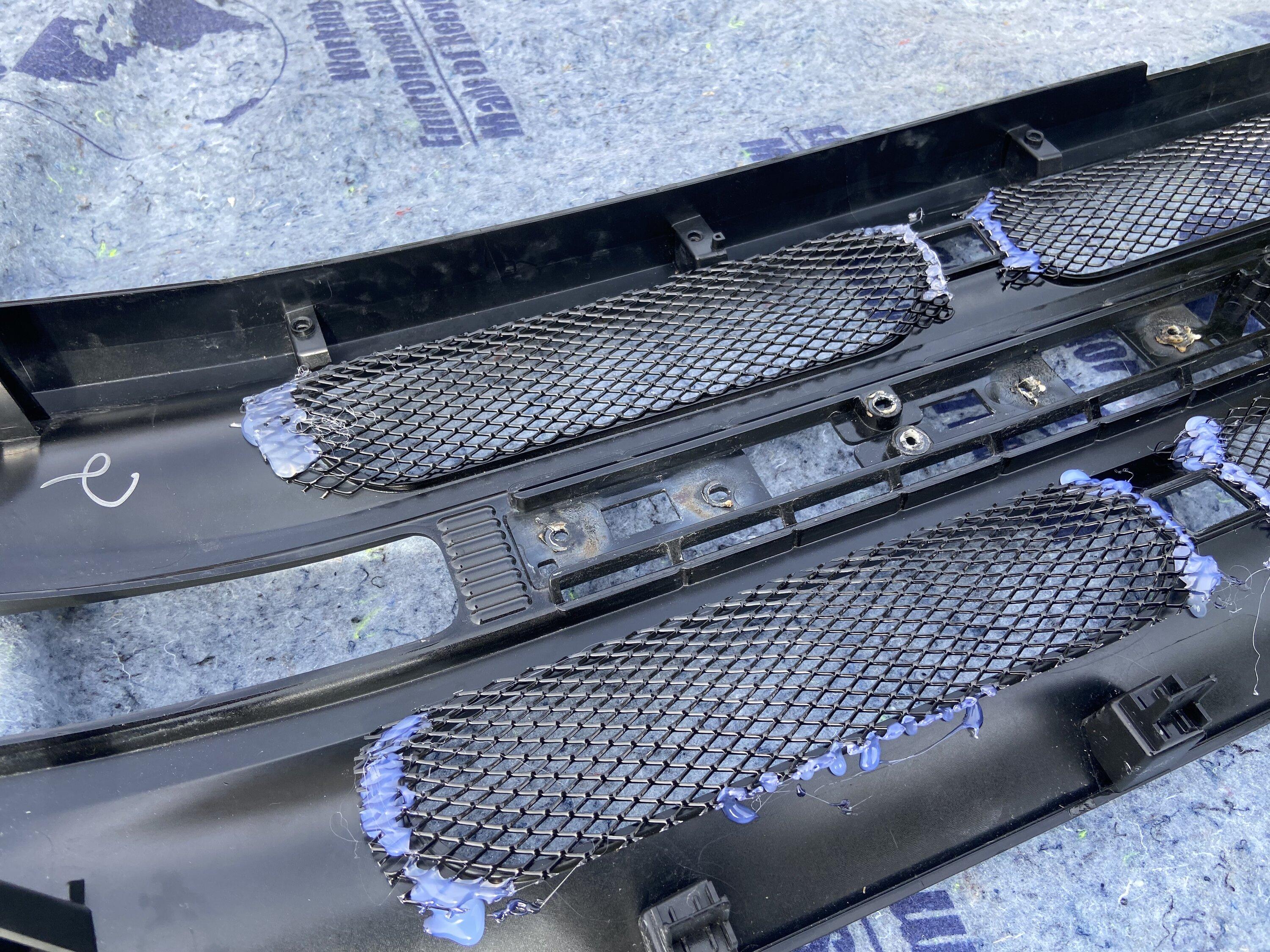

While I was at it, I decided to attached small mesh grill inserts into the pill-shaped openings. This helped camouflage the radiator openings and hood latch mechanism and cover, and also should aid in keeping debris from entering those spots.
Overall, I’m ecstatic with the results. The grill is an almost spot-on match the bumper and trailsights.
