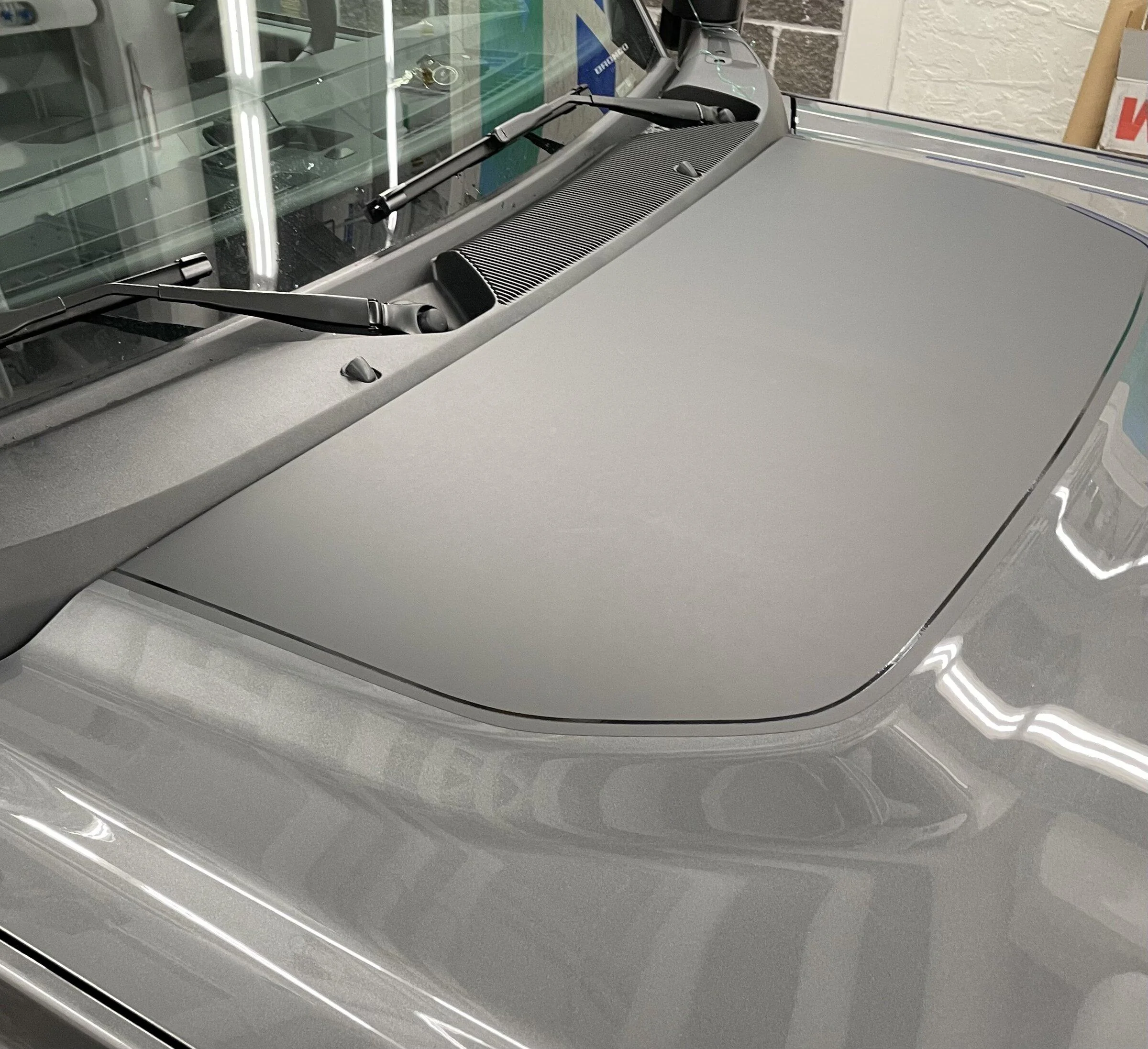

Never heard of knifeless tape but I just googled and u tubed it. That’s pretty cool stuff. Looks good I have the same color bronco and really need this the glare is killer. I’m just nervous it’ll look like poo doing it myself lol.

It's pretty easy. Just make sure your surface is clean and work from the middle out. knifeless tape was great for this because there's no allignment needed- just lay a big piece of film down and pull the string

Nice! Is knifeless tape same as vinyl wrap?
Big fan of vinyl wrap. For under $20 my son put carbon fiber wrap on the dash and a few other areas of our car. So much easier than the old days of disassembly, masking and spray painting.
No it's a tool used to cut patterns in vinyl wrap. you lay a string-embedded tape under the vinyl in the pattern you want and peel the string out once the vinyl is laid and it cuts your pattern for you. the tape itself is non-stick so it clears from under the edge of the vinyl easily. It's awesome!
