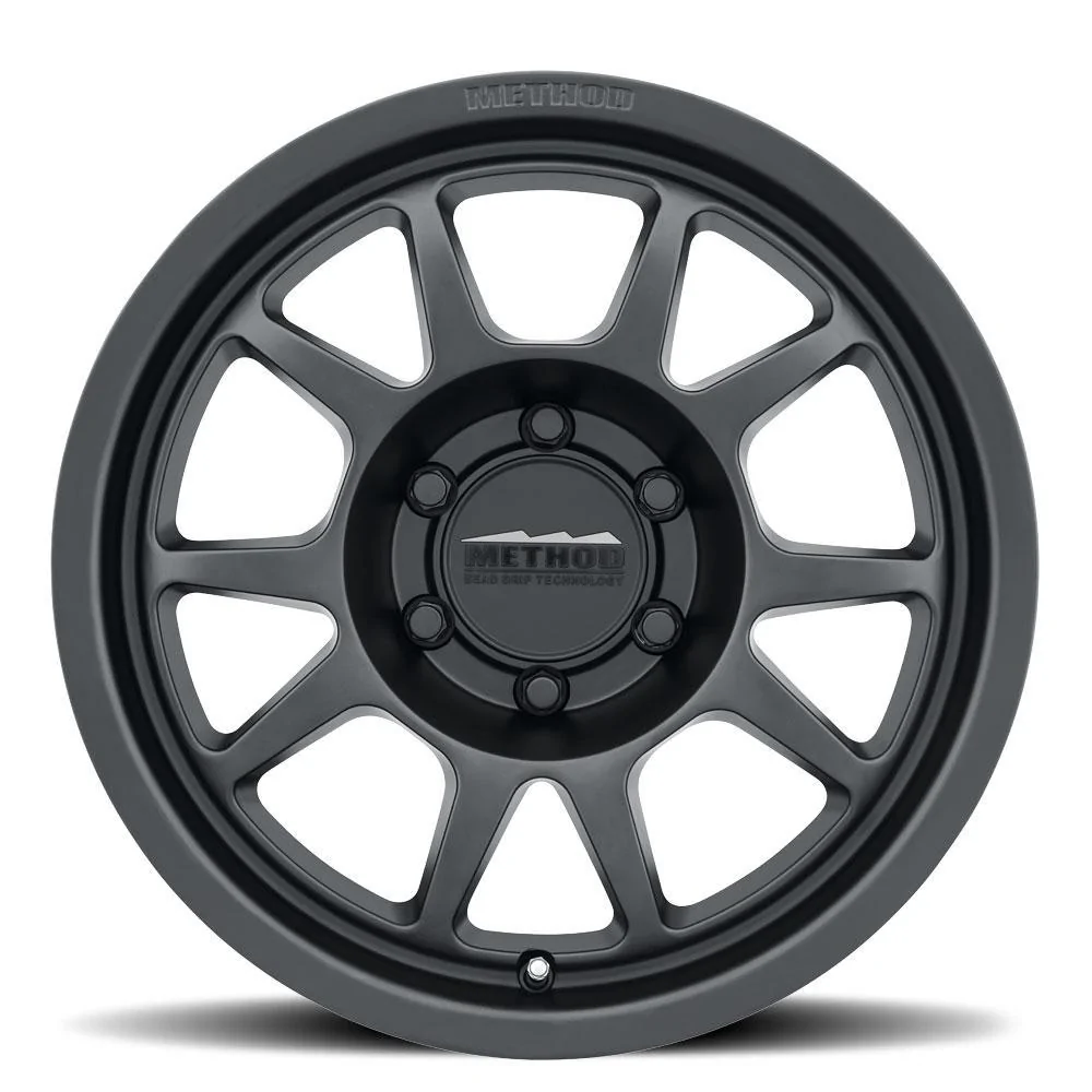

I'm still up in the air about what wheels and tires I'll move to, if it comes with M/T's and not A/T's.
I'm leaning towards Method's 702, if it comes with an offset close enough to factory, and either Nitto Grappler G2's or Falken Wildpeak A/T3W's.
It will be my daily driver and not see much trail running, but more mud, snow and sand when not on the pavement.
