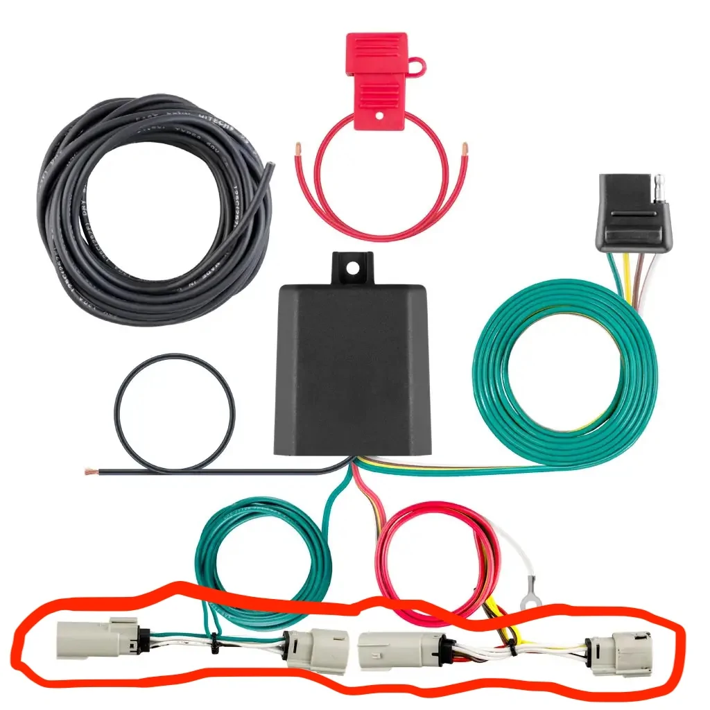

I'd like to make my own pig tails to tap in to the wiring at the tail lights on my '22 Base. I'm planning to install a factory 4-pin towing kit that I already have (but I don't want to cut and splice the factory wiring) and some other lights that I'd like to be able to use the tail light, turn, and brake signals to run.
I know there are kits, like the the Curt kit, that are plug and play with the type of connectors I"m looking for (picture below), but I already have the factory kit that calls for splicing (which I want to avoid). Does anyone know where I can buy the connectors separately to tap into the tail light, turn, and brake signals?
The connectors I'm looking for are circled in red below:
Something like THIS?
https://www.specialtyperformancepar...2&_sid=a7e511977&_ss=r&variant=43458794881256
or, buy the Curt kit and harvest the connectors from there…
