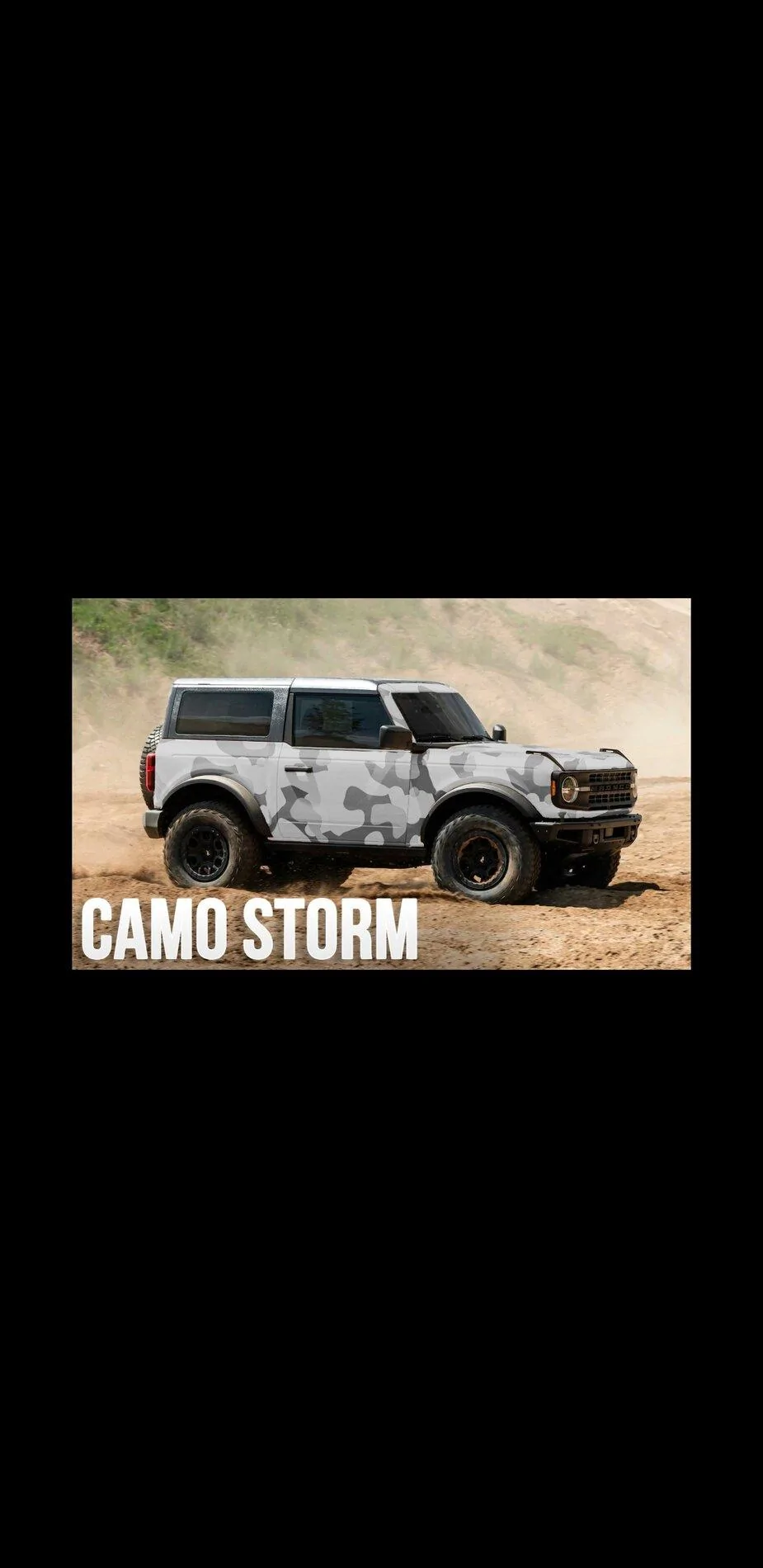

Way way back after i ordered i spoke with my wrap guy i told him i wanted something like this .
He does great work and told me around 1700.00 and any color could be done but darker was better . Never thought it would be this long a wait ,i hope the price is still the same 1700 seems like alot but not thrilled with any of the colors but carbonized grey good luck with your project👍
Ford Bronco Color Wraps Screenshot_20210824-230219_Gallery
$1,700-$2,000 is about right for a 2 door. No roof. No door jams. Plan on an extra $250 per door jam (approx).
