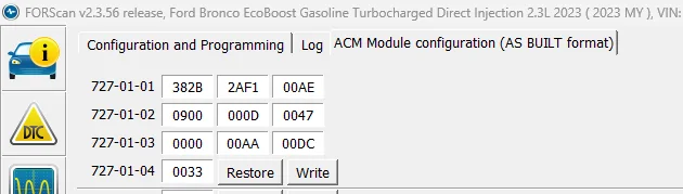

I've checked my ACM hex strings and don't think the problem lies there, but I could be wrong. This is what I'm currently running:
Ford Bronco "Circuit Open" DTC after speaker upgrade ACM
