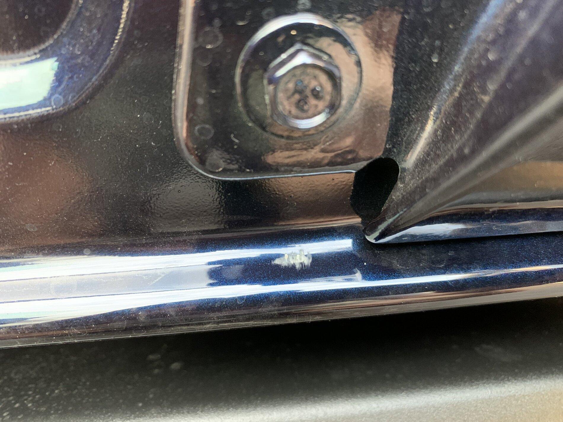

warranty issue - dealer can touch up the problem area when they fix the fender alignment. No reason to be mad. I understand the feeling, but you just have to teach your child, if you hear something "off" then don't repeat it. Kids have different priorities and thoughts than we do, which we learned by experience.

Have you taken the doors off? Make sure that top hinge is fully seated before you bolt it back otherwise youll get that awful noise (personal experience)

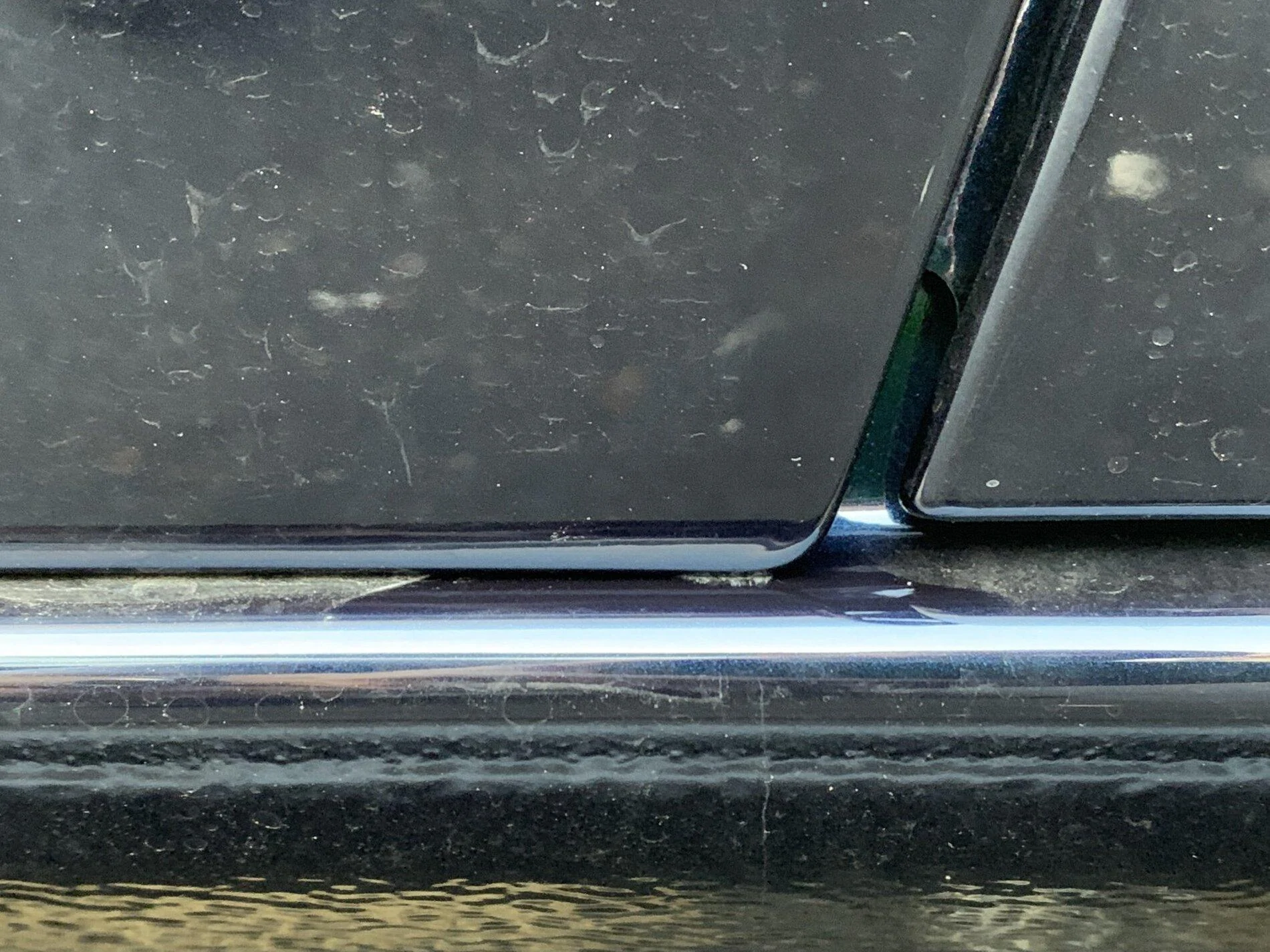

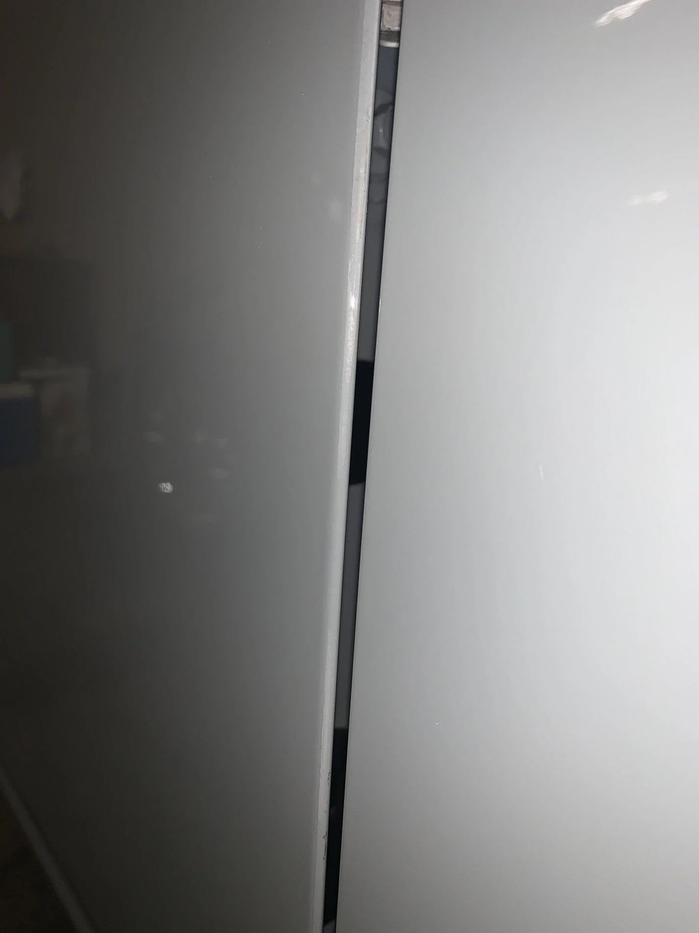

BTDT, easy enough to fix it myself but was annoying. The driver's door shut weird the first few days of ownership and I couldn't put my finger on it. Then it rained and the door got quiet so I know it was hitting somewhere.
Required hinge adjustment and striker adjustment. All better now after some touch up paint.

Happened after replacing the doors?

I am missing something, can you explain what happened?
Ford Bronco Check your door to fender alignment key-and-peele-messed-up[1]
(Paint is chipped on fender from contact with the door during opening as the gap isn't sufficient for the full travel of the door movement)

What are we looking at here?

But I really want to know. Is this before or after something? The issue or after resolution? Maybe an arrow or two plus descriptions?
