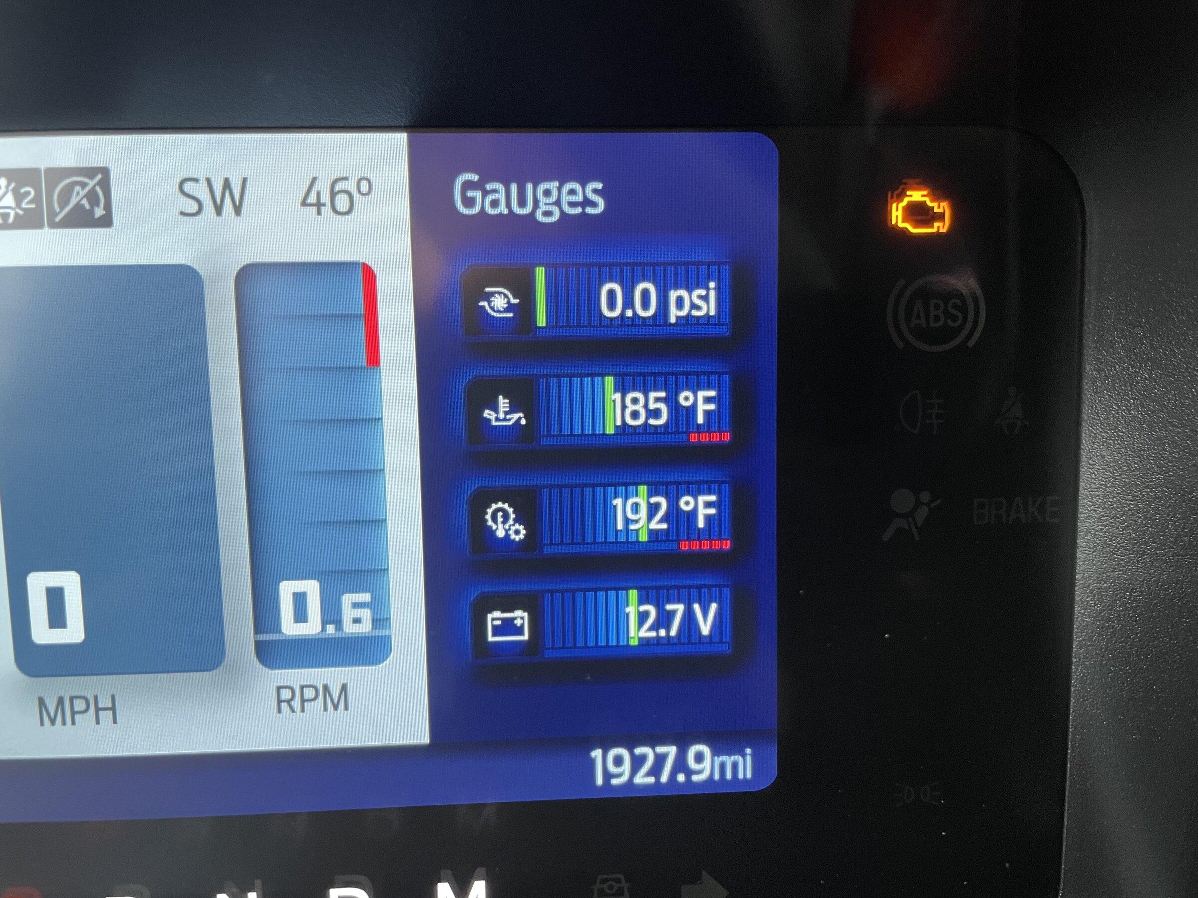

Wanted to post this for tracking/advise purposes.
I am at 1900 miles on my 2021 Ford Bronco Badlands 2.7! Was on the highway and pushed the pedal down to pass someone and my dash popped up saying bring vehicle in for service. At that time it was just a service wrench. Got to my destination turned off the bronco and when I got back and started it now the wrench and the check engine lights were both on. I used a code reader to check what the issue was and it gave me P0299 “Turbo A Under Boost Condition”. Now the wrench has gone away and I just have the check engine light. Vehicle still seems to be running fine. Has anyone heard of this issue? Thank you! My Ford dealership can’t schedule me for two weeks!!!

P0299 is the turbo... I've seen the error code before on the Ranger and F-150.
In my case all it took was swapping out the air filter, but these were worksite trucks that are not taking care of and are sucking in dust and other junk all day every day. Obviously at 1900 miles you shouldn't have air filter issues.
Ping @flip your VIN if you haven't already... he can pull up the vehicle health report since he works for a dealer.

I thought there was someone else who had an underboost error and it turned out the intake hoses were loose.

Ended up being the hose clamps were loose! All good!
