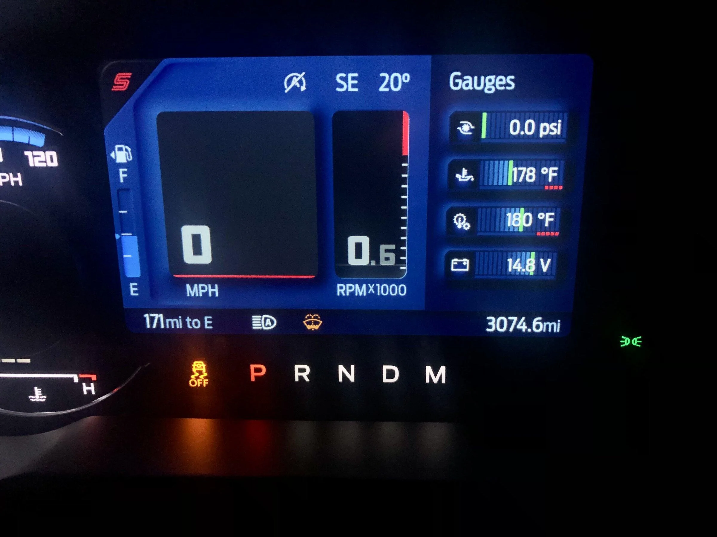

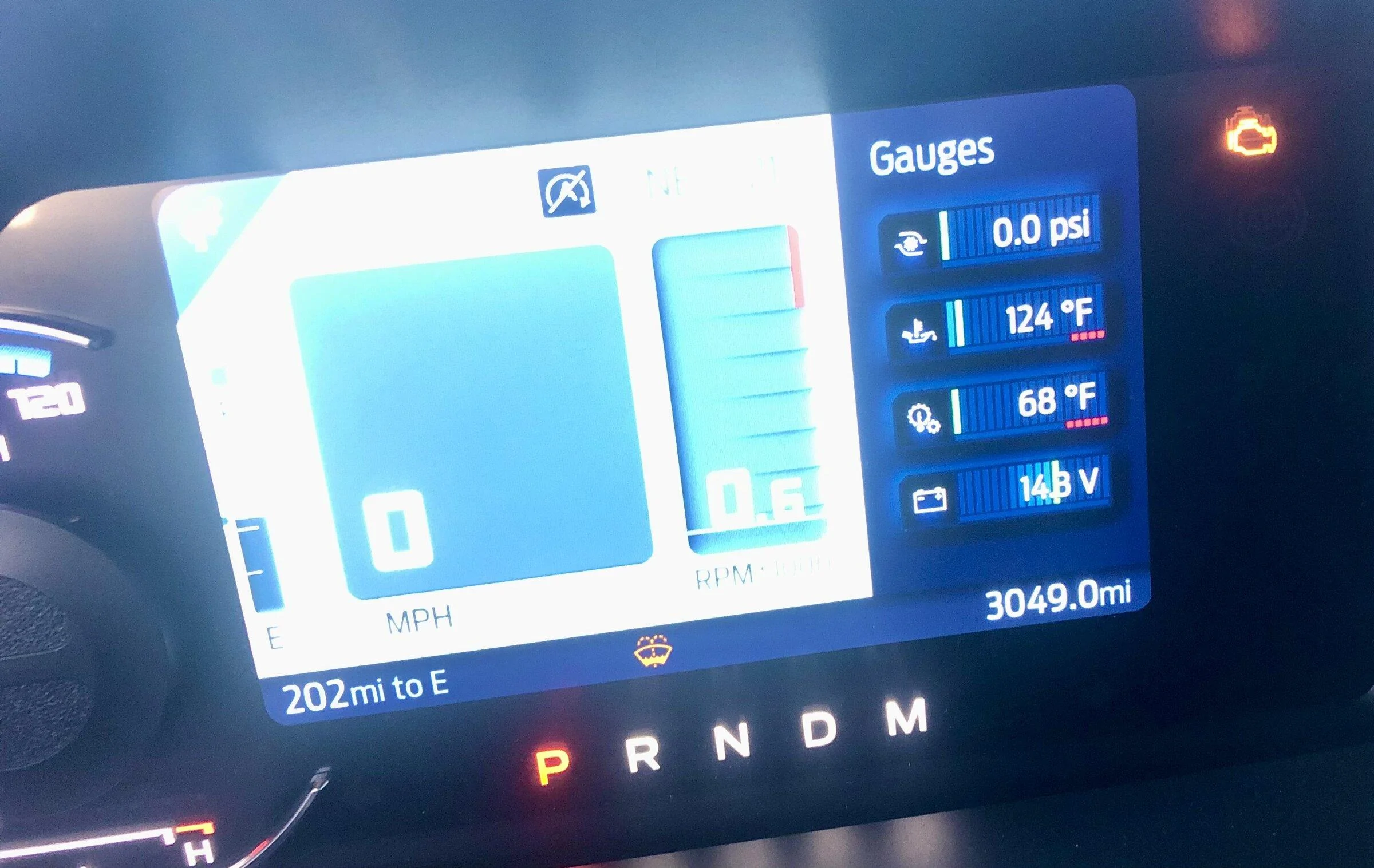

App remote start 16:45 10min due to outside temp being 2 deg entered Bronco noticed check eng light after I hit started button . Then drove through touch less car wash to remove salt at the same time scheduled ford service for Monday at dealer. Wasn’t sure what it was drove 30+miles home from work no engine issues. Thought possible a hose to TT? But had plenty of power/boost.

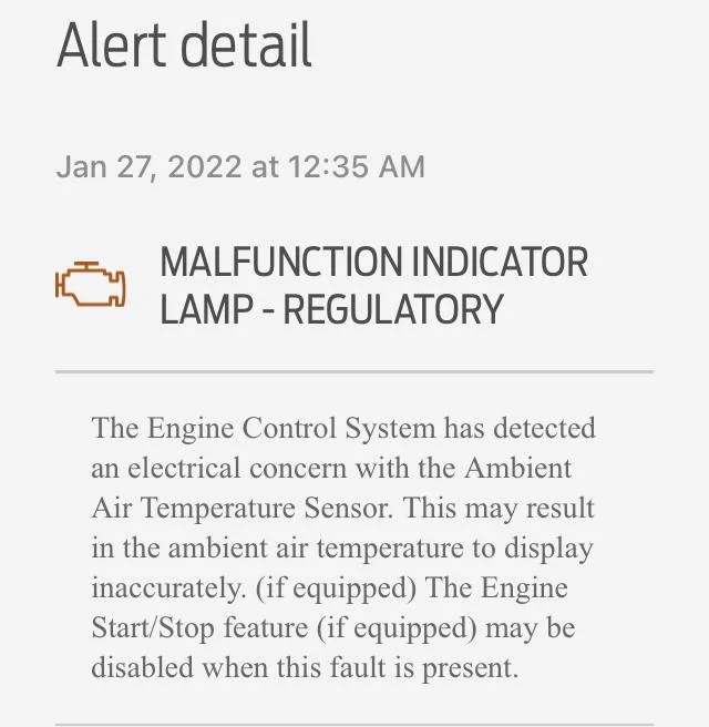

Got home popped hood checked hose/pipe connections no issues tight. Removed negative battery cable to reset. Then put back on. Fired up no check eng. Drove acouple miles no light. Several hrs later received ford App alert. After receiving notification fired her up again, no check eng. So it seems I’ll be freezing or Hot.

Hold on, let me get this straight. The check engine light came on, which is normally means stop and don't drive your vehicle? And then hours later you get a message that tells you it's about a stupid temperatures sensor?
