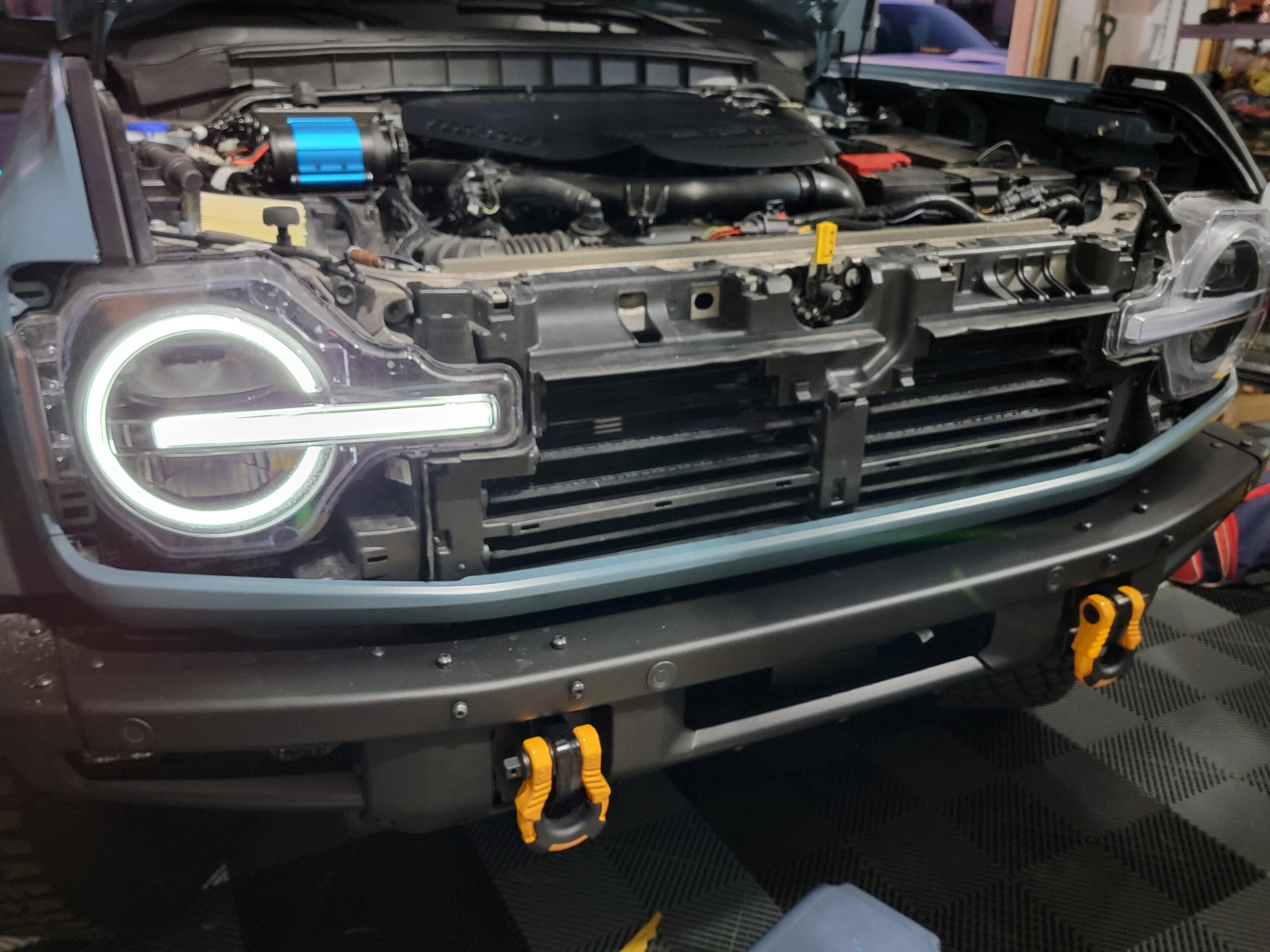

The wiring harness for the light runs on the engine side of the bracket that attaches to the grill?
Strykerwsu
Oct 30, 2020
440
709
Wichita
Holden Commodores
It is underneath it against the new grill, the new bracket covers it from my recollection.
Not sure what model you are coming from, but on an OBX like I have, you do have to trim some of the weather gasket as new bracket won't fit nicely. I believe Badlands doesn't have such an issue. In the pic you can see it by both lights and runs to the center.
Ford Bronco Changed Badlands to Raptor Grille 20221210_173458

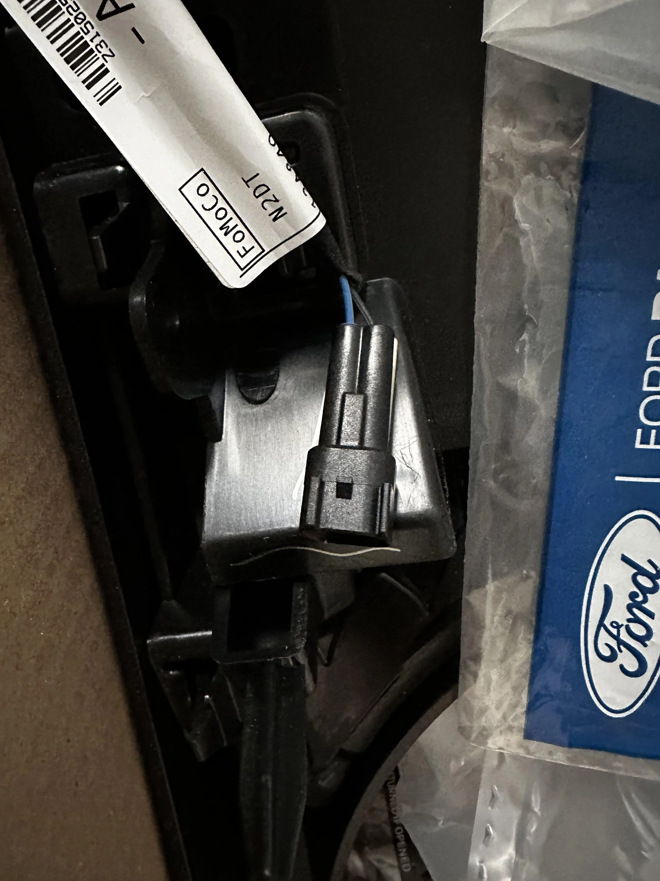

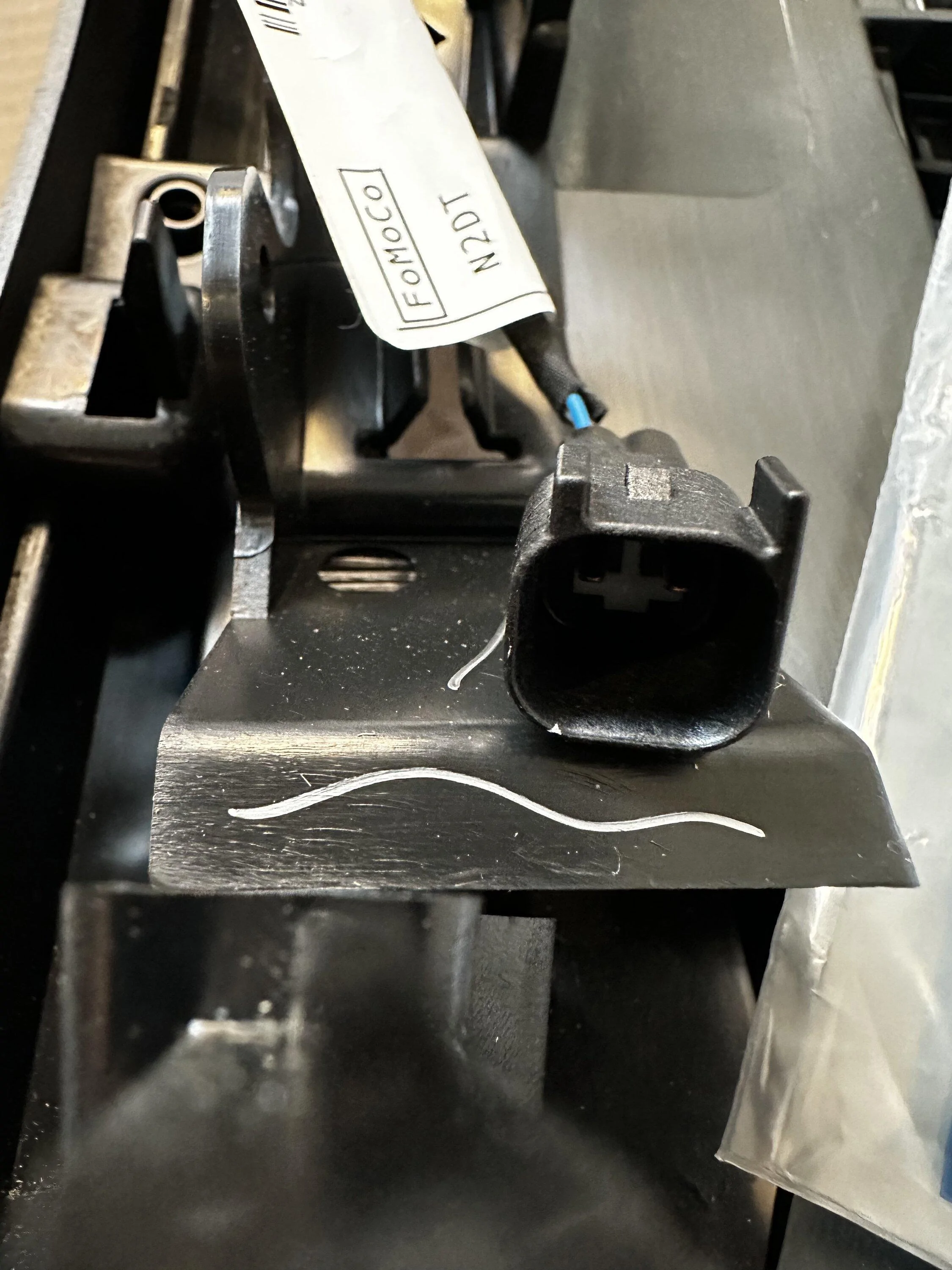

Did you use another adapter to go from the harness to the OEM plug pictured here.
Ford Bronco Changed Badlands to Raptor Grille 8E4D684E-C4C4-4D4D-8336-0BABF98F217B
Ford Bronco Changed Badlands to Raptor Grille 9869AA52-7BB9-450A-A9FD-E9F2500F71E8

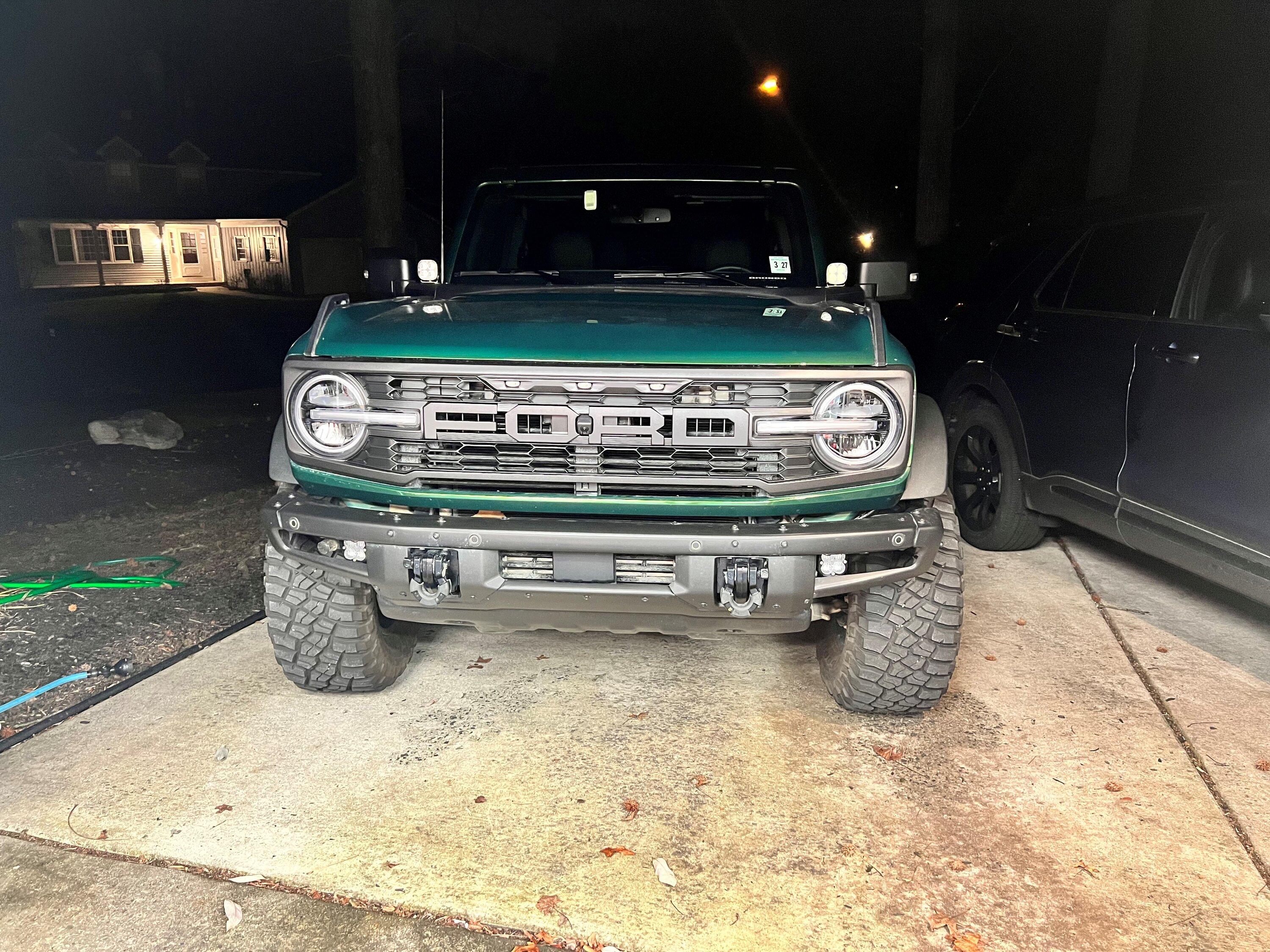

Thank you to all who gave me tips. SPV wired up an adapter to allow me to plug into the OEM harness
