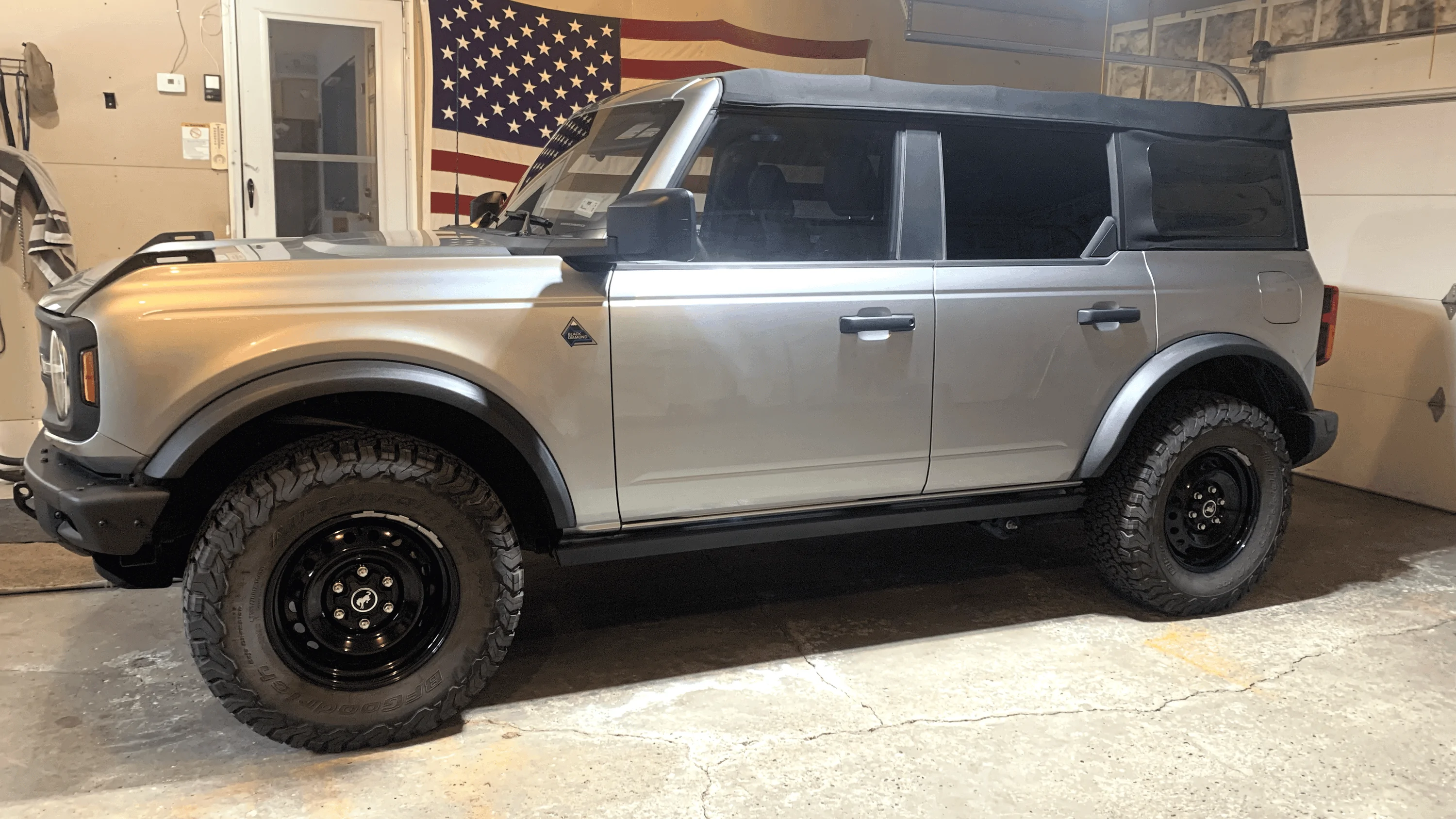

Please delete or move if in wrong Place. Any Members here from Northeastern Wisconsin? Wondering if you had your Bronco Ceramic Coated and what I should expect to Pay? Thank you in advance. My 2022 Black diamond Staying Stock, just like it as is.

Okay, thanks.thats why I haven't considered doing it my self. at the least mine needs to be Prepped before I waste any money

I think mine needs to be Clay Barred and Polished before I do this

Okay Thank you, I'll probably end up doing it myself.

No car is perfect from the factory but I didn't claybar or polish my new Elantra N before applying a wax. It was almost perfect, though. If you really want to be nit picky then yeah you should be prepping the paint but honestly it's not a requirement if the paint is in good condition.
As long as you see water beading and rolling off your car after applying a wax then you're golden. That's the only point of paint protection....to make your paint hydrophobic so stuff doesn't stick to it as easily.
When you touch your clean paint does it feel pretty smooth? If it does I think you can just put some wax on and maybe in a couple years look into doing a whole paint correction if you think you need it.
Sadly, the paint on the Bronco is pretty thin so the less you polish the clearcoat the better since there's not much on it. Below is a video showing a reading of the paint

Clay barring will need to be done beforehand to get rid of any contaminants, but you're probably fine to skip polishing especially because your car is silver and won't show swirl marks and stuff anyway, which is what the polishing is mostly for.
However, I will say you probably want to make sure the car hasn't been waxed for a while before you ceramic coat it or else it won't stick as well.
The hybrid ceramic waxes like Turtle Wax or Meguiars are also incredibly user friendly and provide great coverage/protection as well, especially for the low amount of effort/cost needed for them.

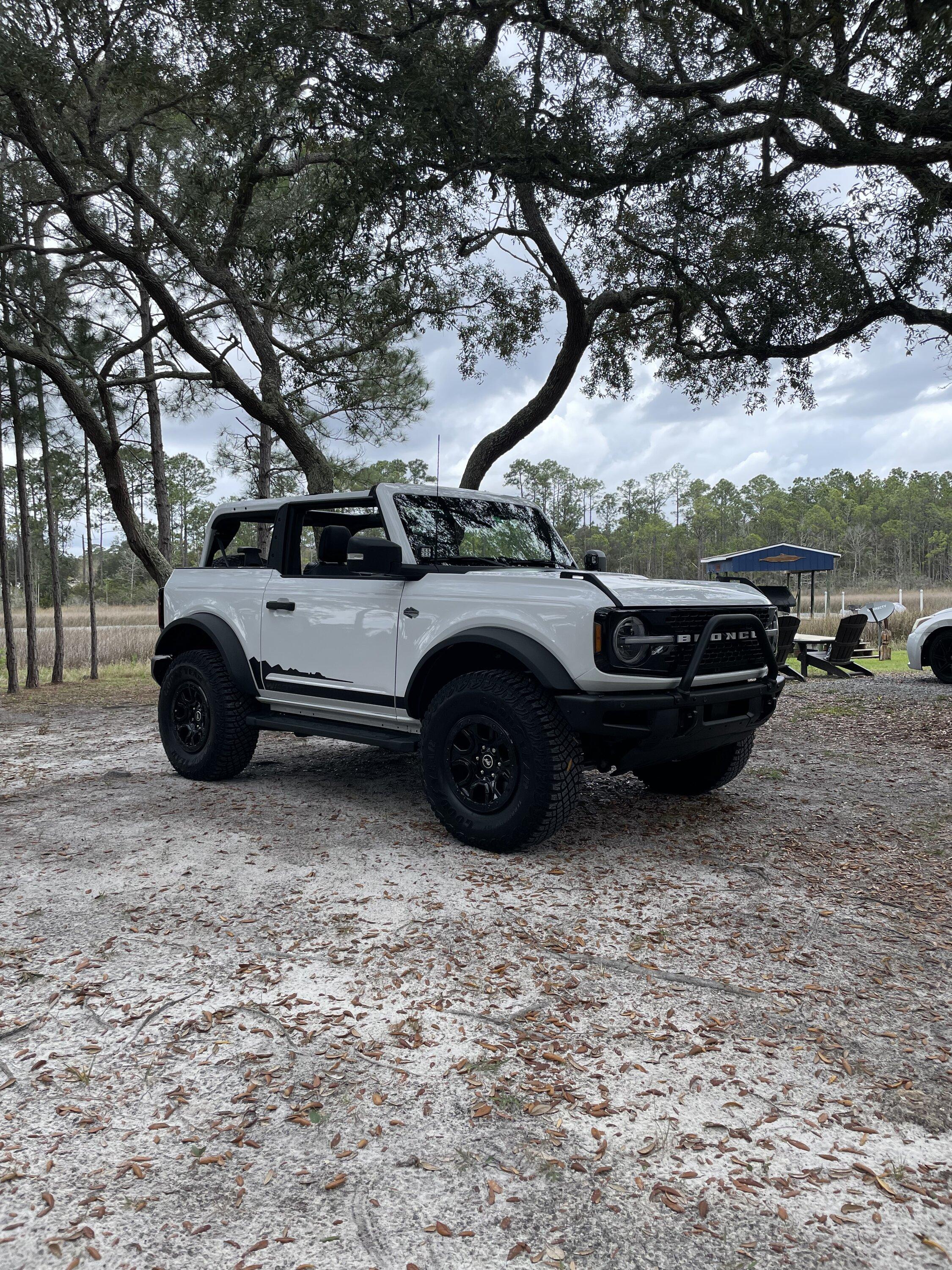

Just had mine done in FL. Paid 1100 including all 5 wheels. I researched the process and decided it was best to let the pros handle it. They clay bar and polish first, locking in a perfect finish. They used the best quality ceramic (no turtle wax bs) then cure it under infrared for 12 hours. So far, I’m very impressed and feel it was worth it.
