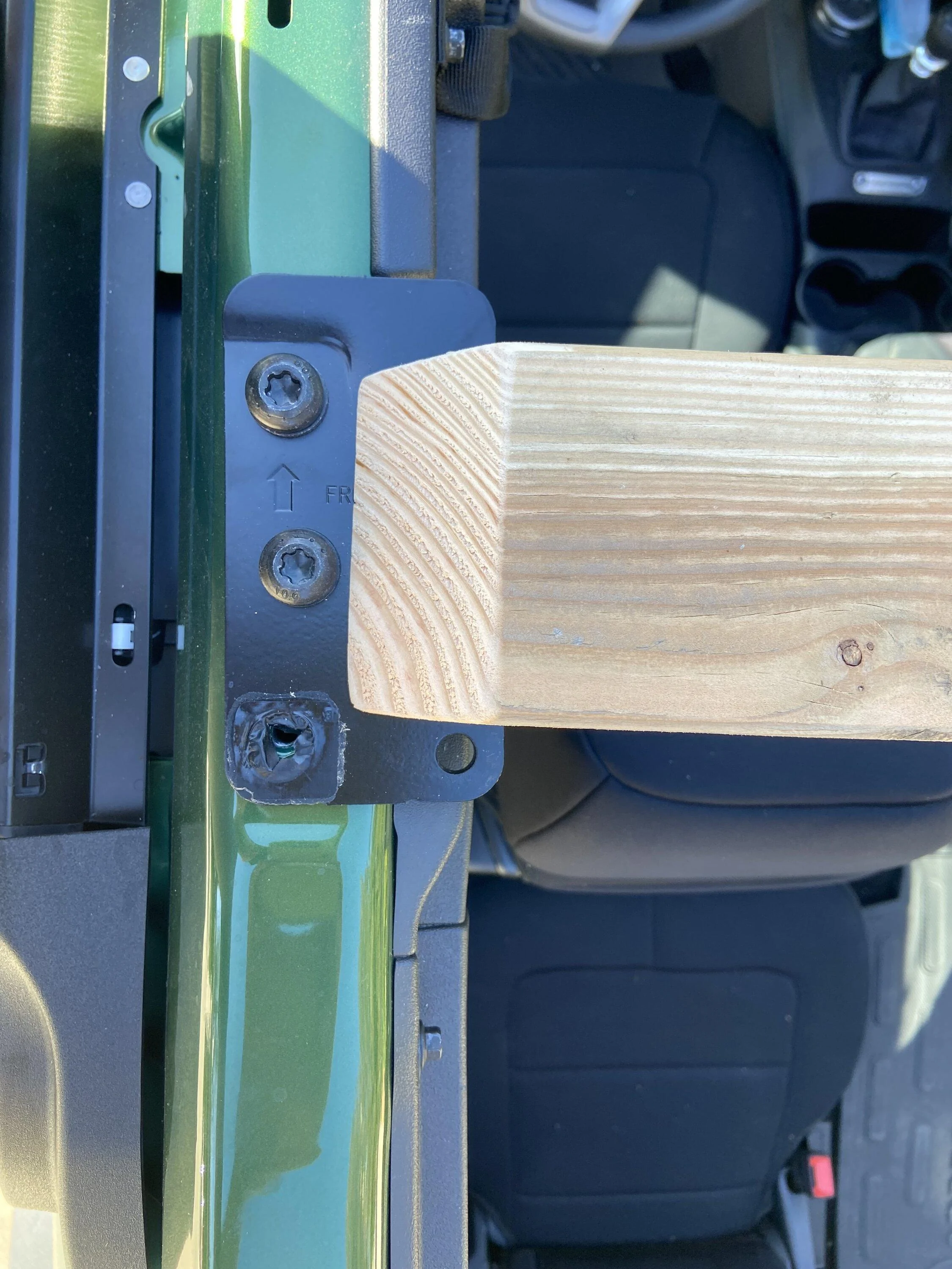

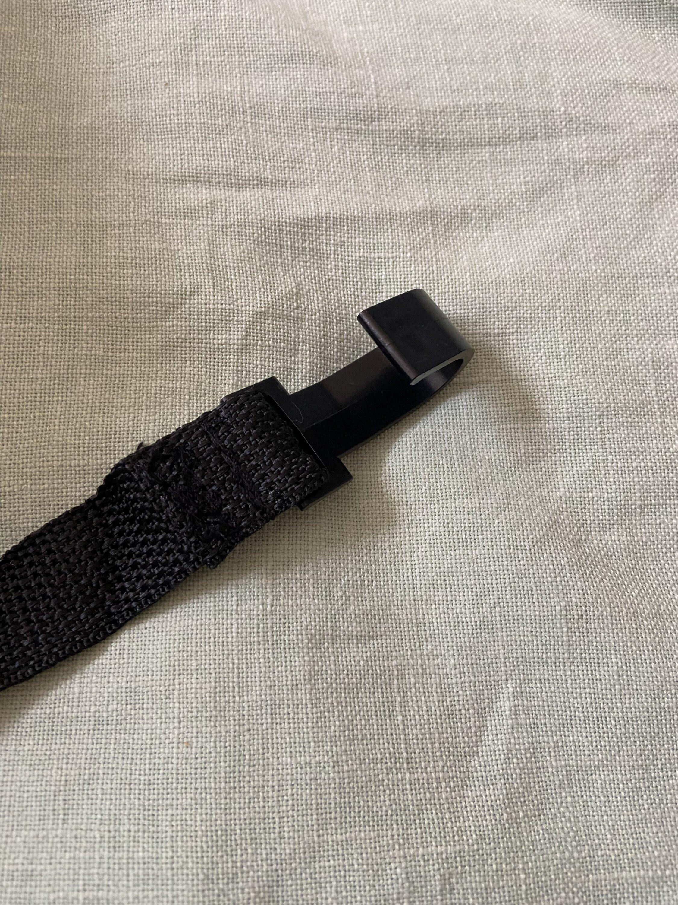

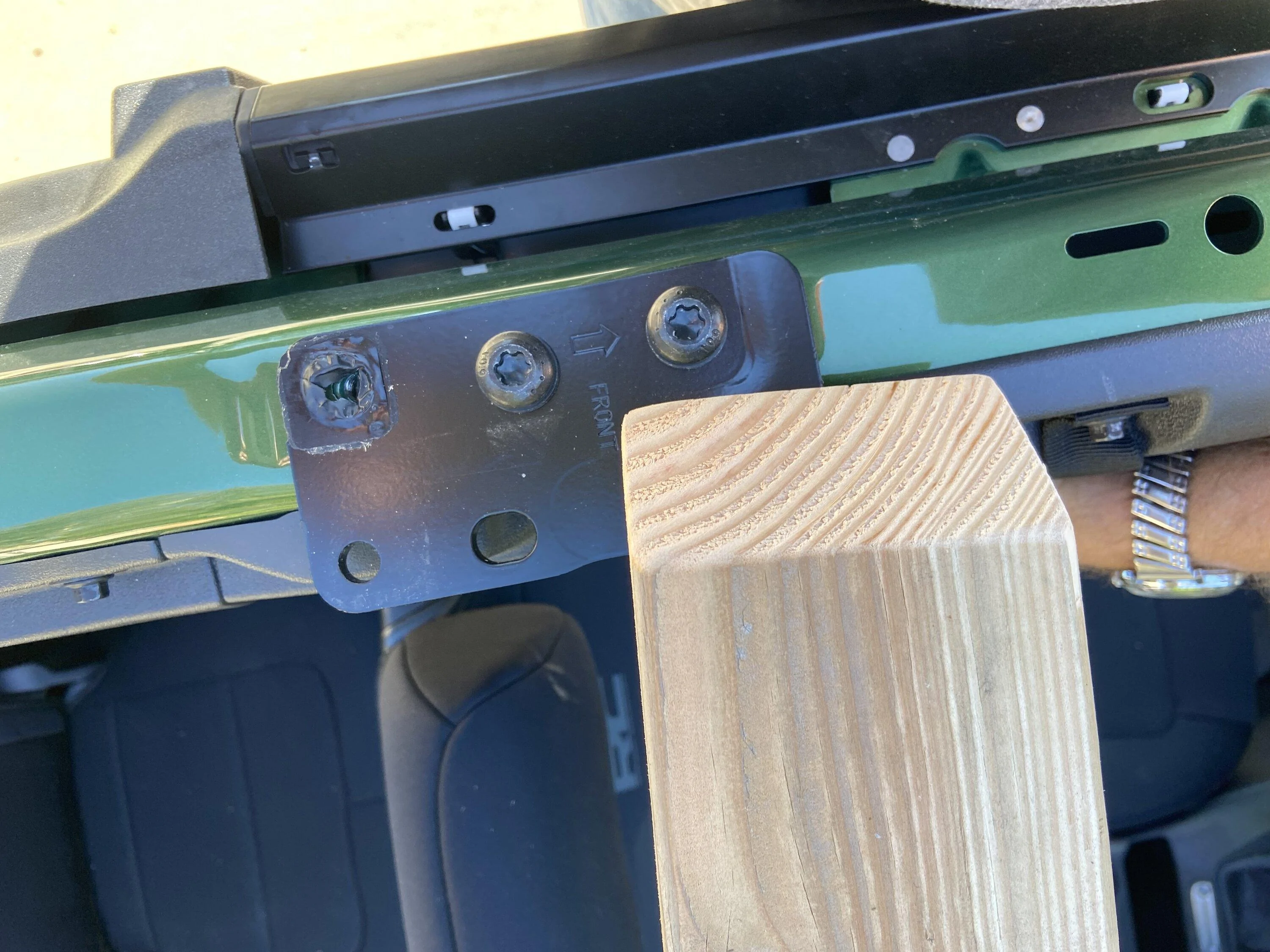

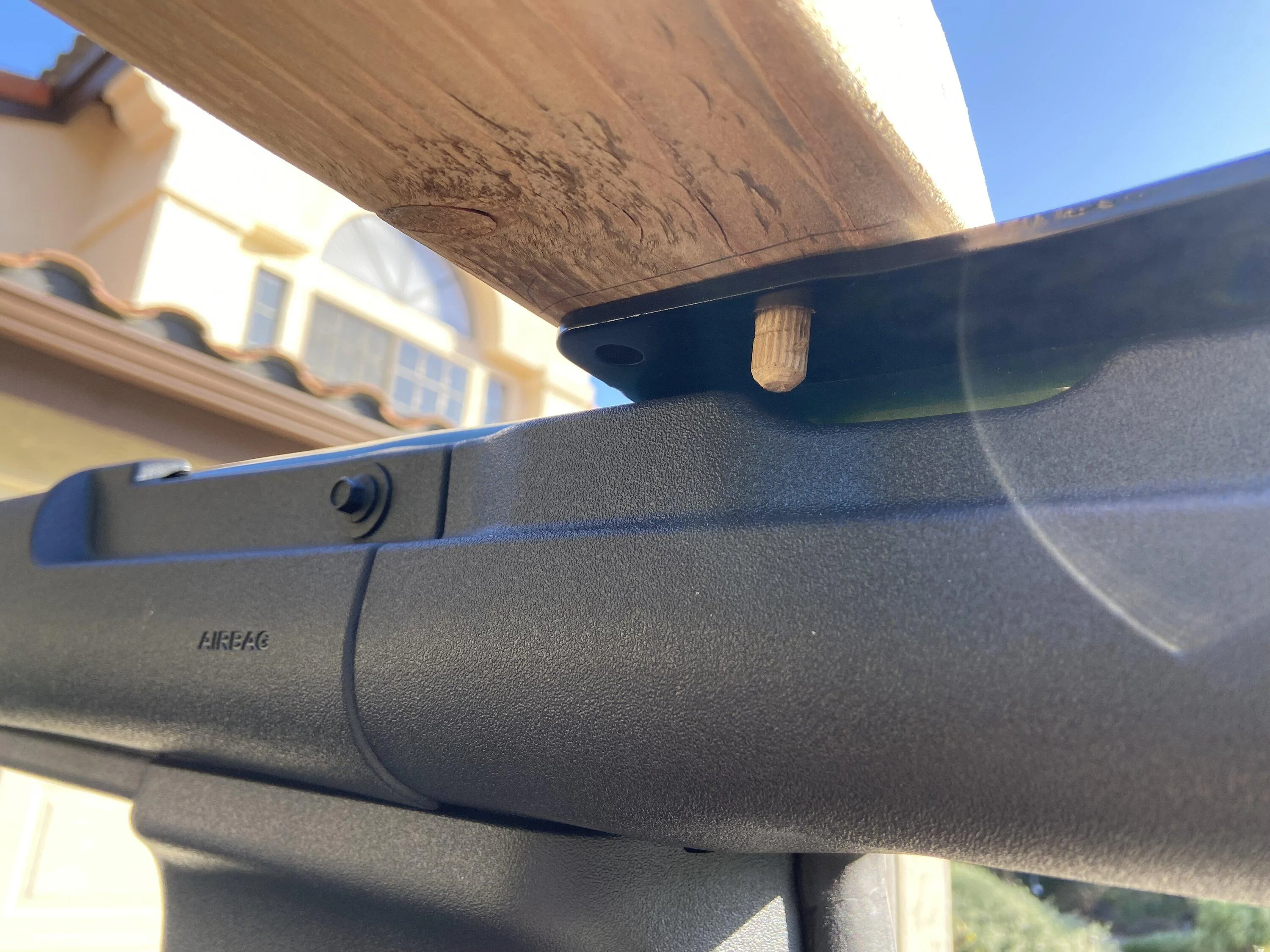

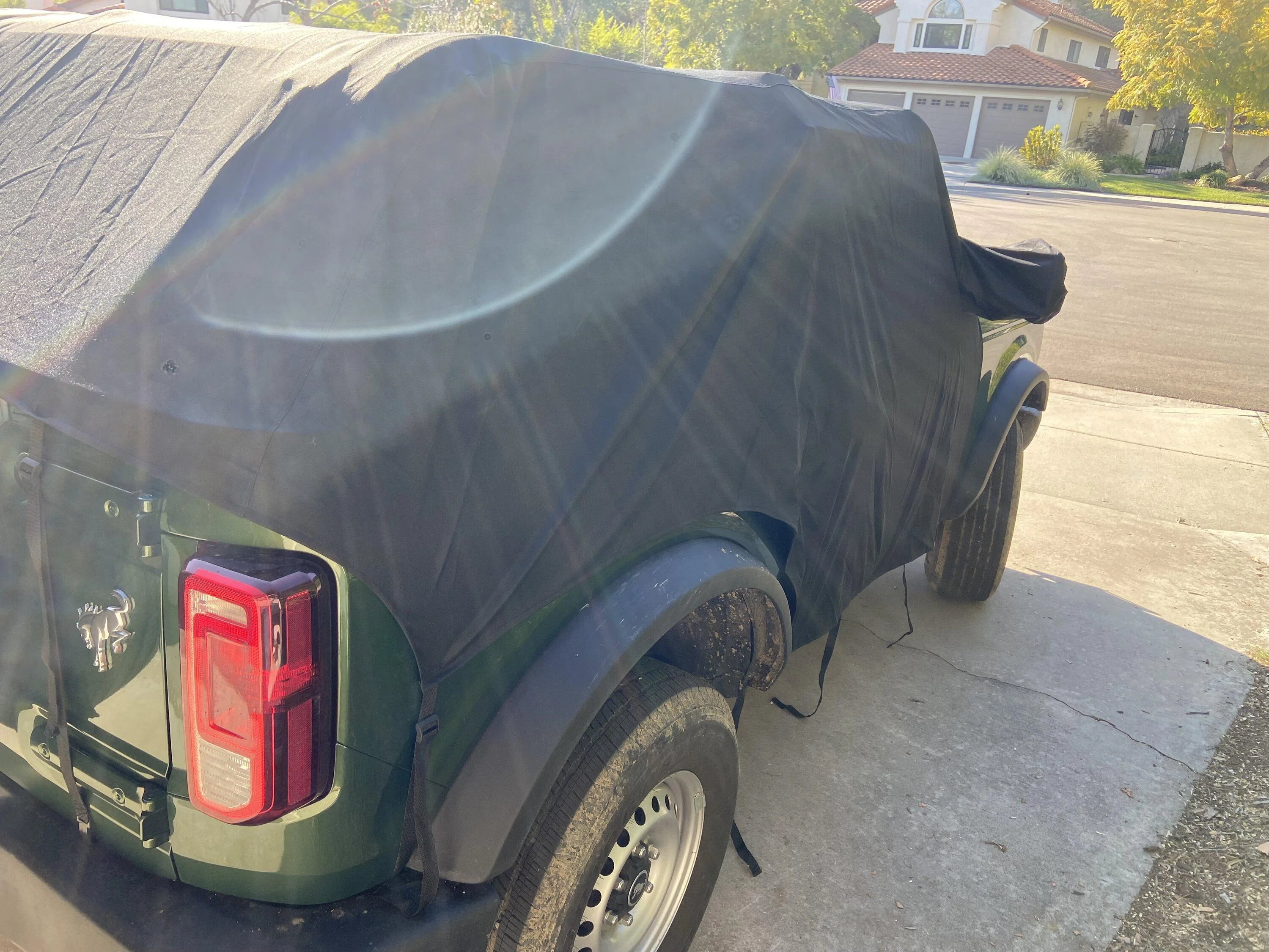

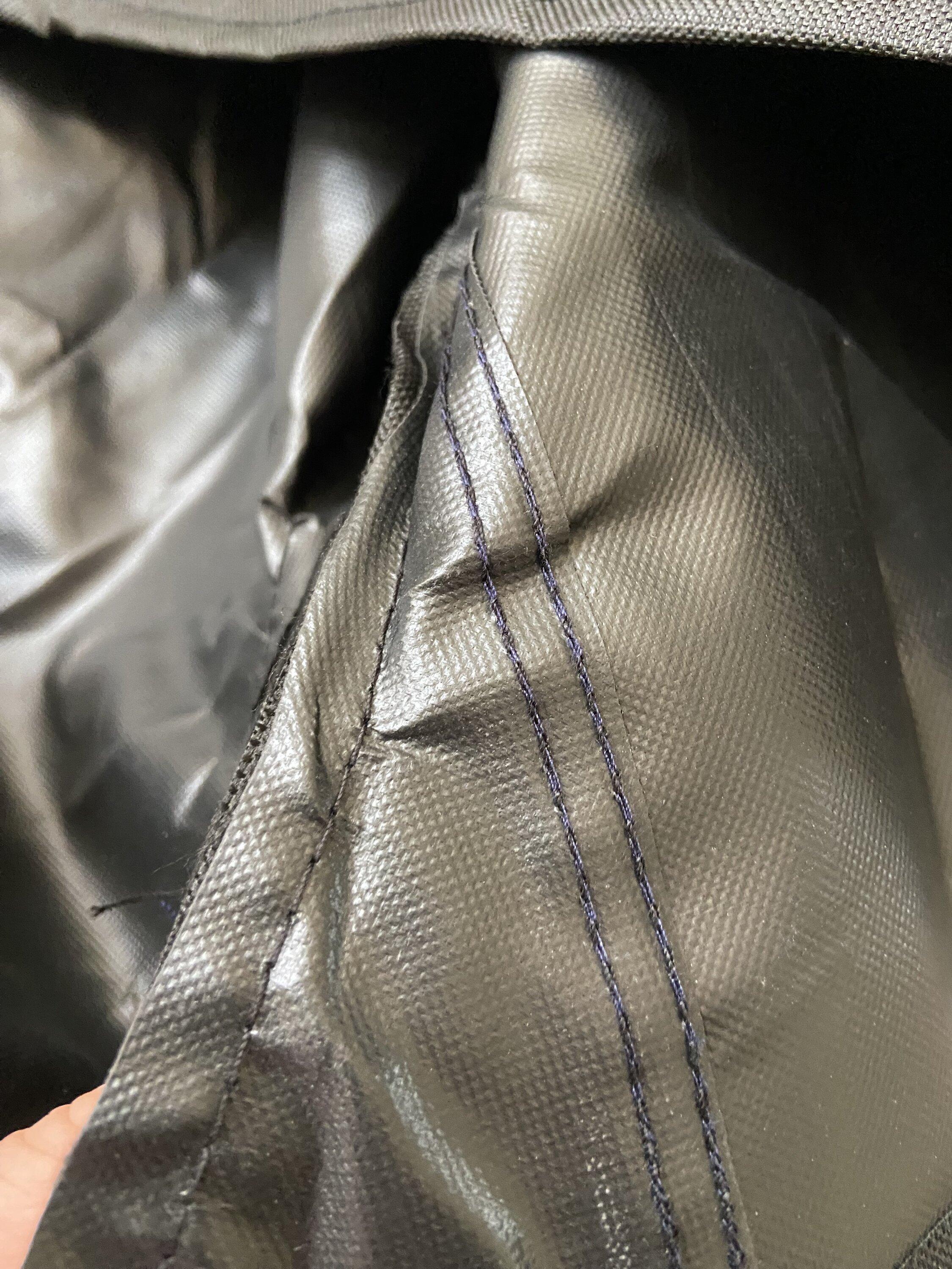

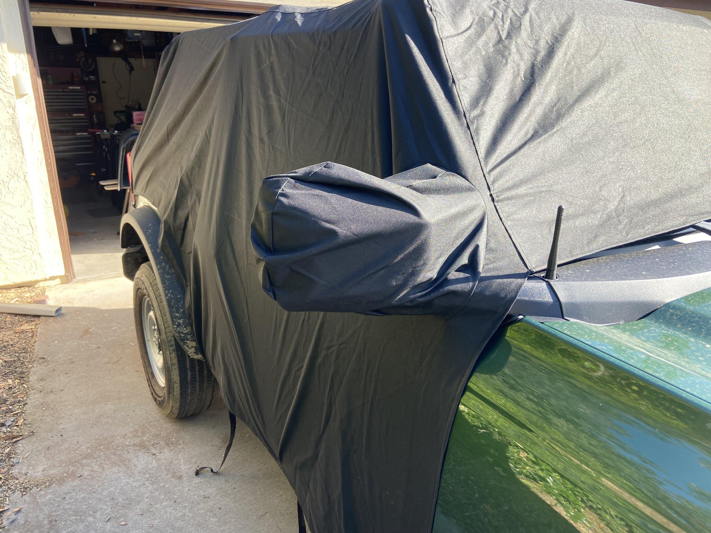

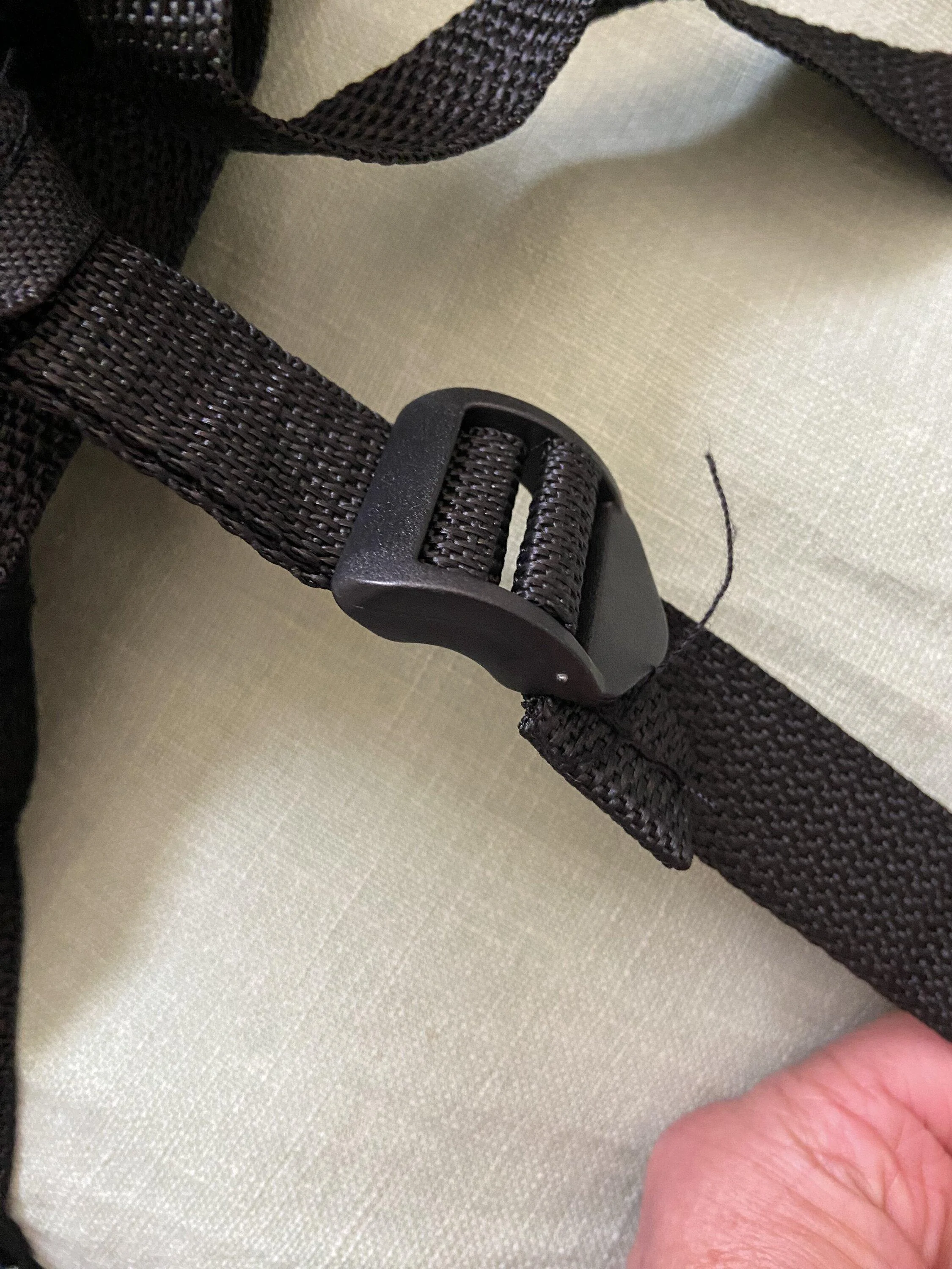

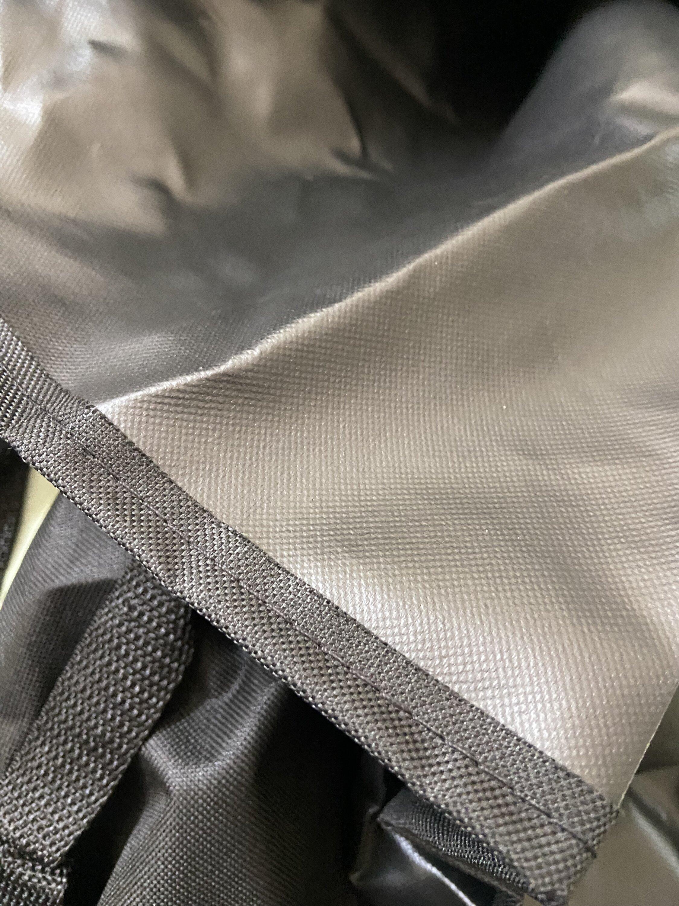

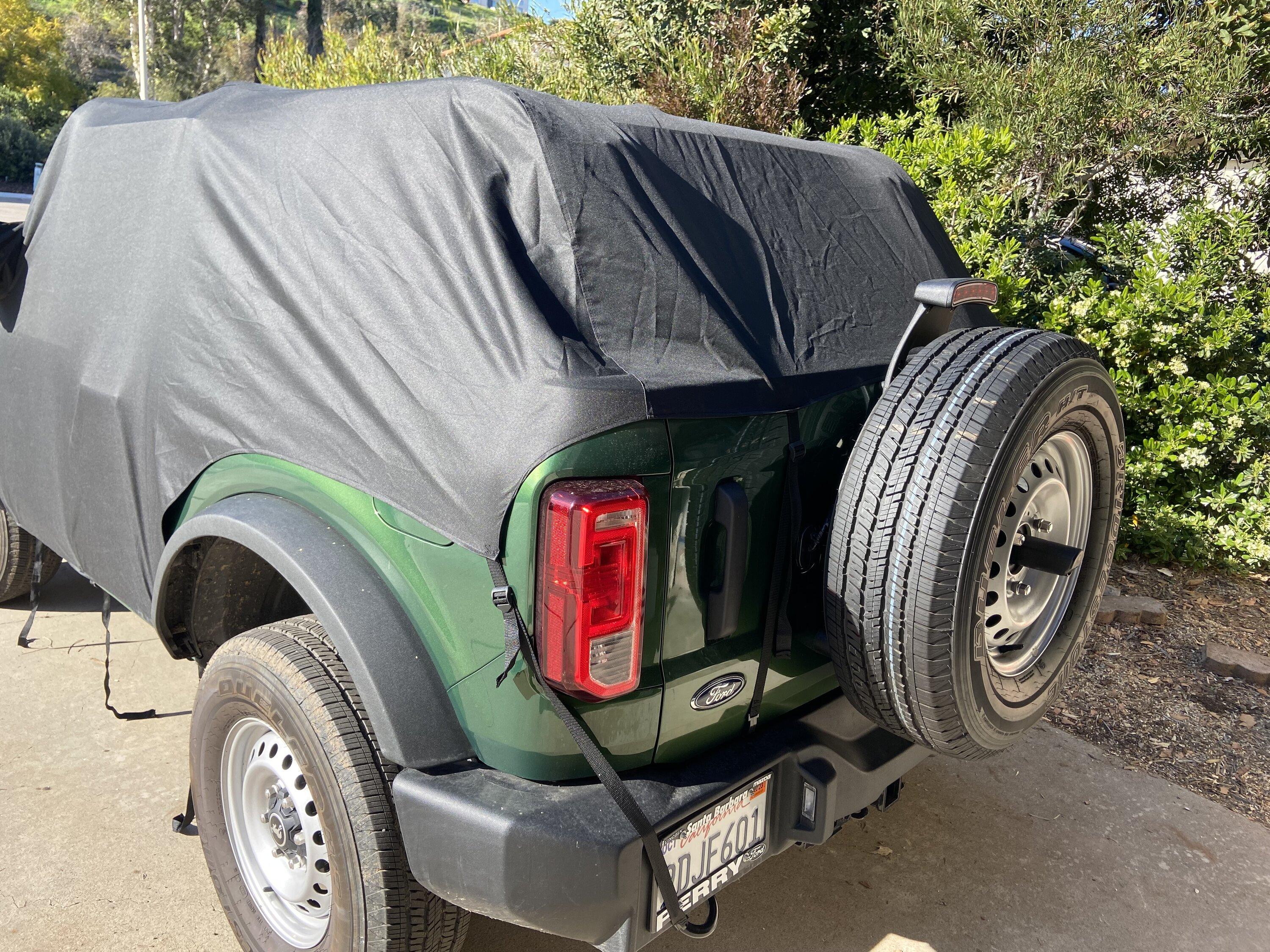

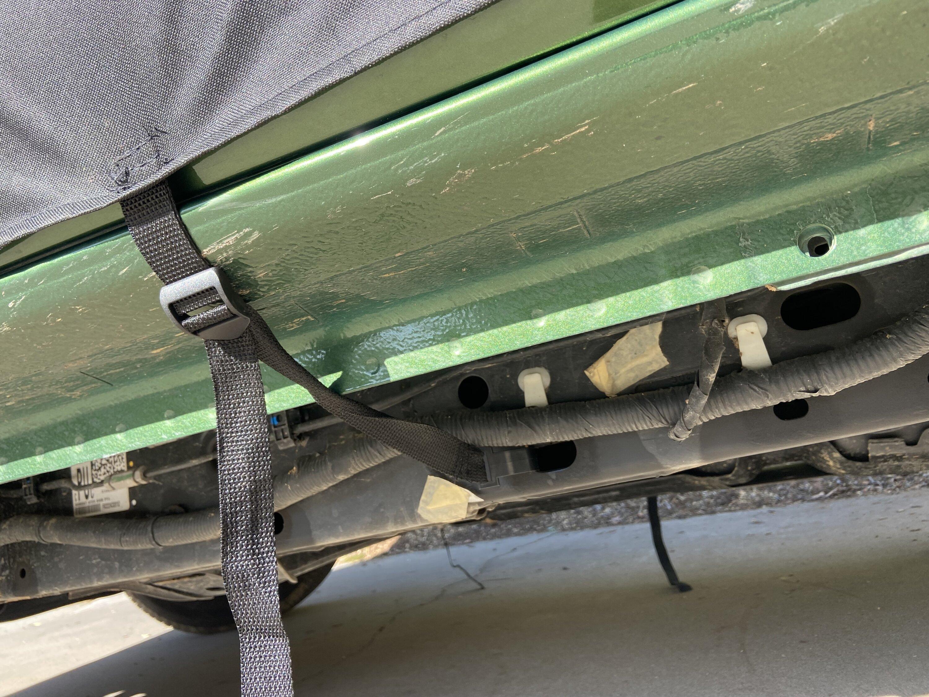

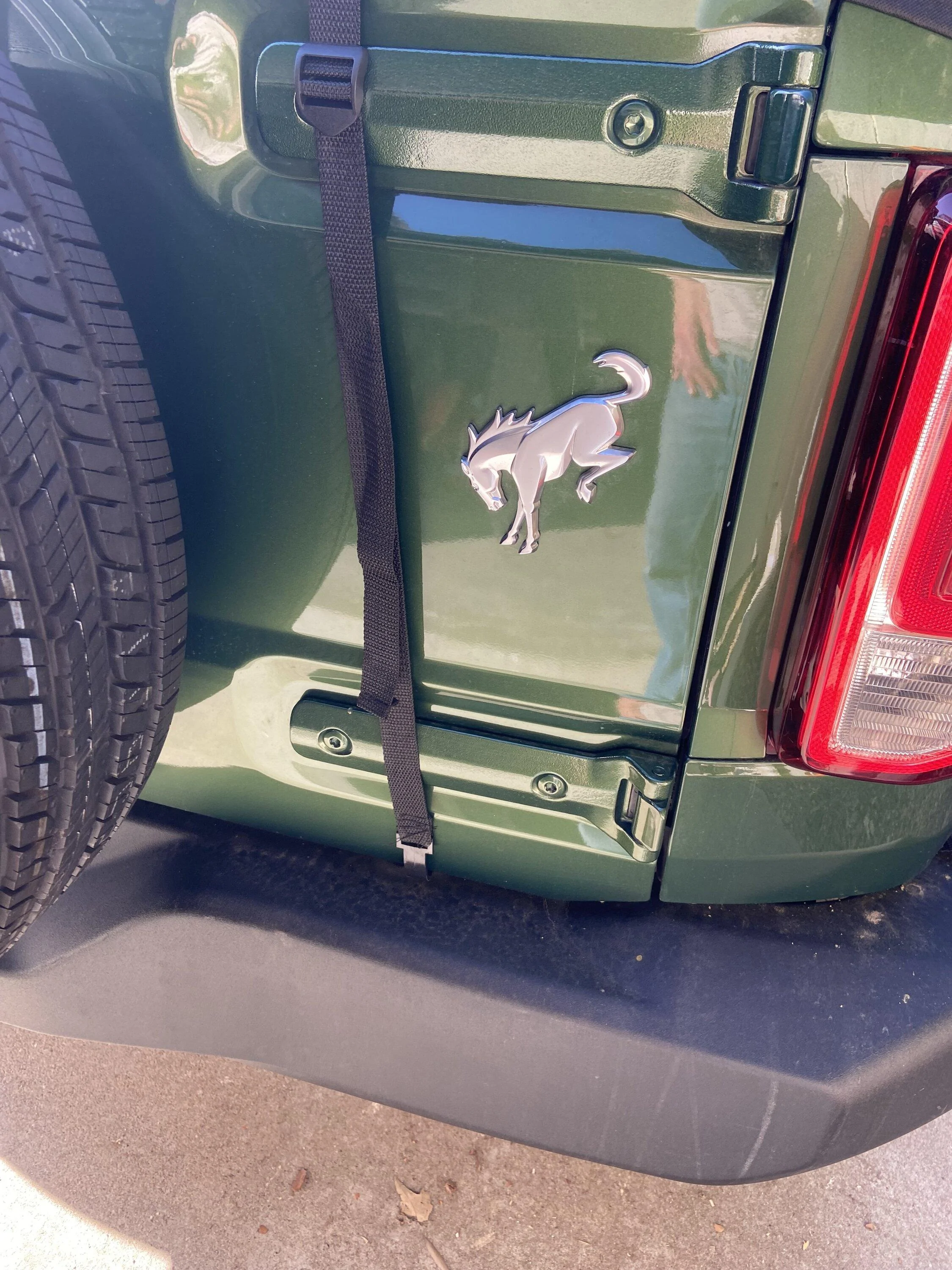

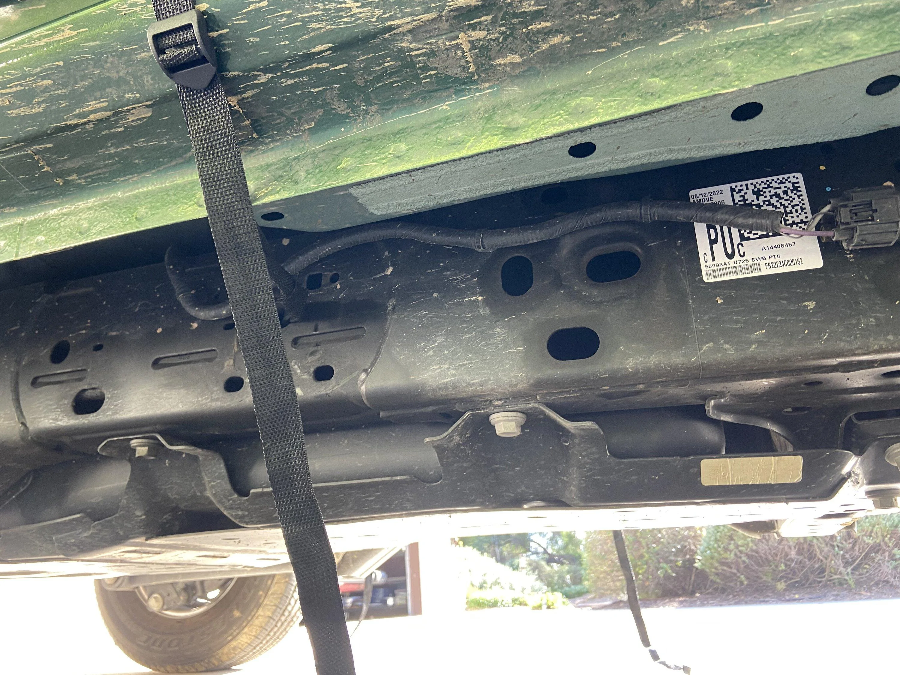

Following up on my Amazon purchase. I installed it and had it on overnight but did not have it on for rain due to needing to drive in said rain. 2 main issues. very tight to get on over the side mirrors. i had to fold one in and still wrestle with it to get it on. As you can see from the photos the seams on the mirrors just don't seem quite right. Still once on it's not going anywhere. Second issue is that there is very little overlap on the rear door. Probably not going to be an issue but if there was a lot of sitting water on the top it might pull the back end up. I have some close ups of the seams and the hardware (all plastic fyi). The straps can be attached just under the doors but that means tightening them up all most all the way. I opted to secure them under the body a bit more. Feels very secure when attached.

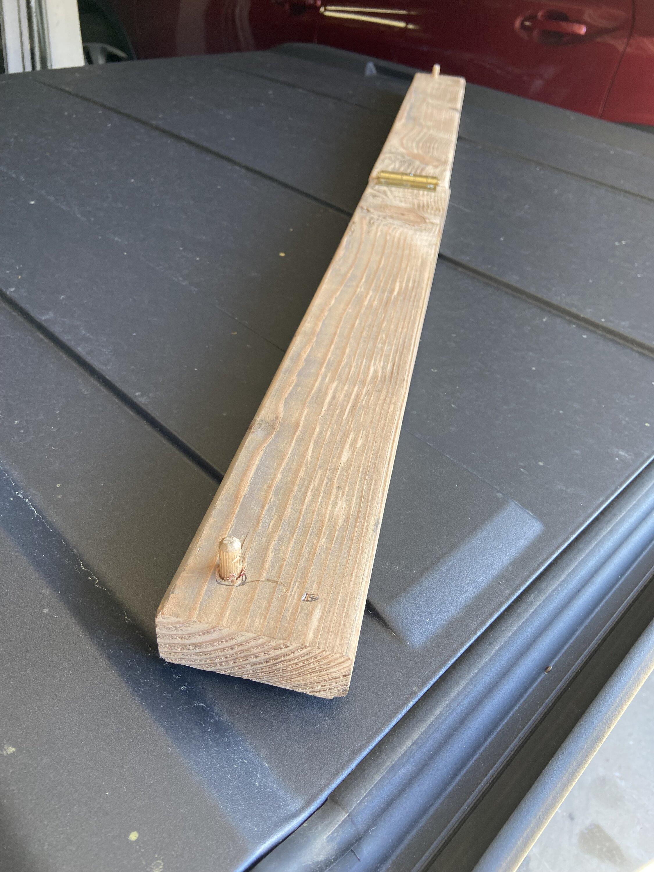

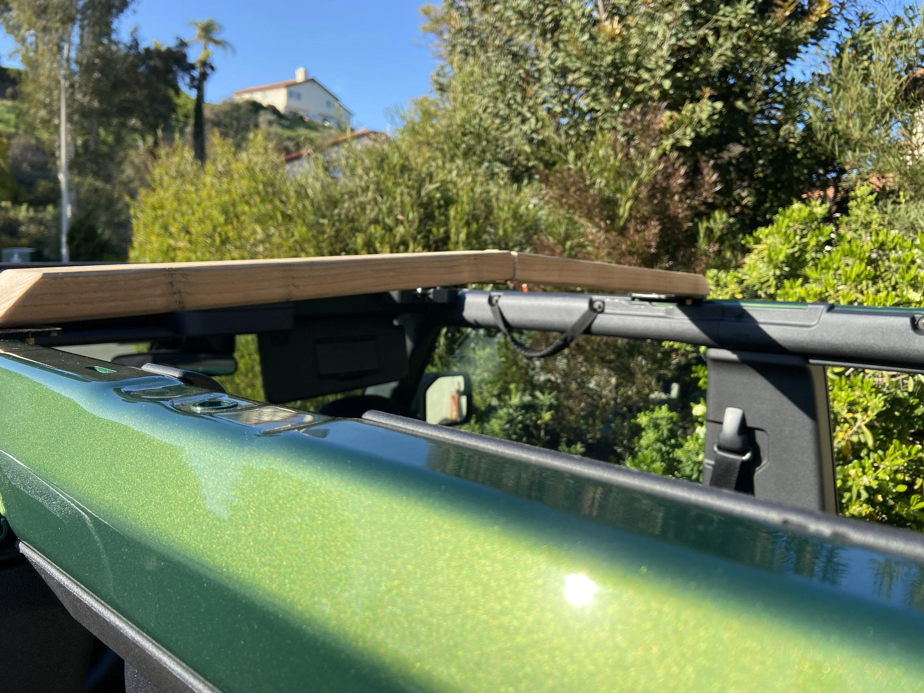

For this next part no laughter or rude comments. My carpentry skills are pretty sad and this was more of a proof of concept build than a final solution. When you remove the top there are 2 holes on the roll cage just behind the driver and passenger seat. I took a 2x4 cut it to length, cut it in half then added a hinge. Once that was done I 45'd the ends and added a dowel to line up with one of the holes. I then added a small shim in between the boards to create a small pitch to the assembly. The piece is installed in all pictures except for the 11th one just for contrast. The plan is to do this with 1" aluminum pipe with maybe a 3rd arm extending to the back of the roof.
Annnyyywho, just an idea you can bang out in 30 min for a couple bucks.
Cheers!

Looks like some fine woodworking to me. :) Thanks for the review, I'm not too worried about rain, I live in the desert - I need mostly to keep the dust out... a cheap way to keep the dust out. I may turn the mirror pockets inside out and just tuck under the cover, don;t think the mirrors need protecting.

Hey, you are too self-critical on your carpentry skills! Very creative. The fabrics looks to be much better than the Ford option. It is still winter weather in the NE where I am and I do not anticipate taking my hardtop off fully until May, but I am going to give this cover a shot and will post any improvements I make to the installation in the coming months. Maybe another cover option will arise in that time that is affordable. Thank you for sharing!
