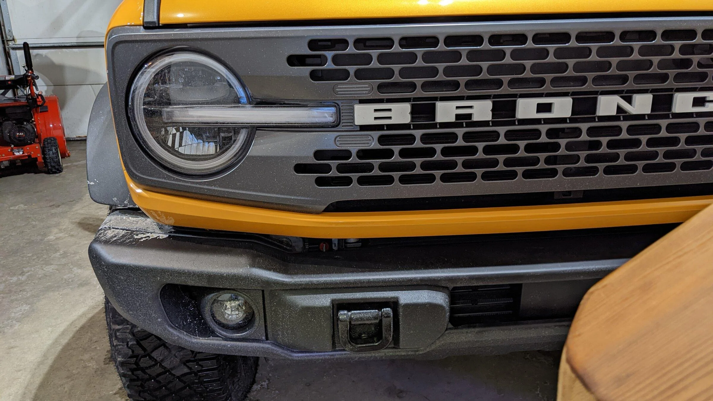

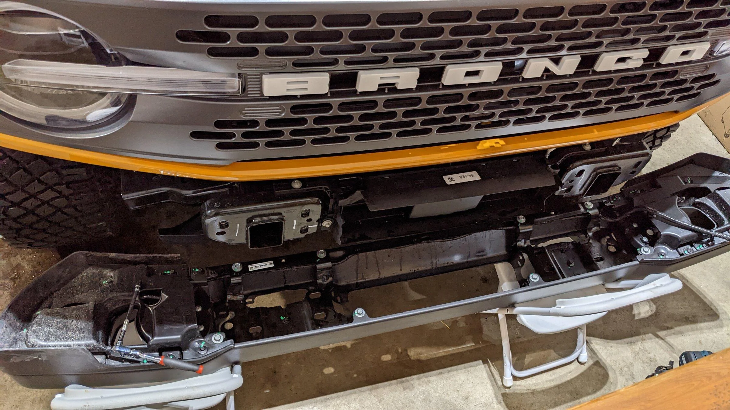

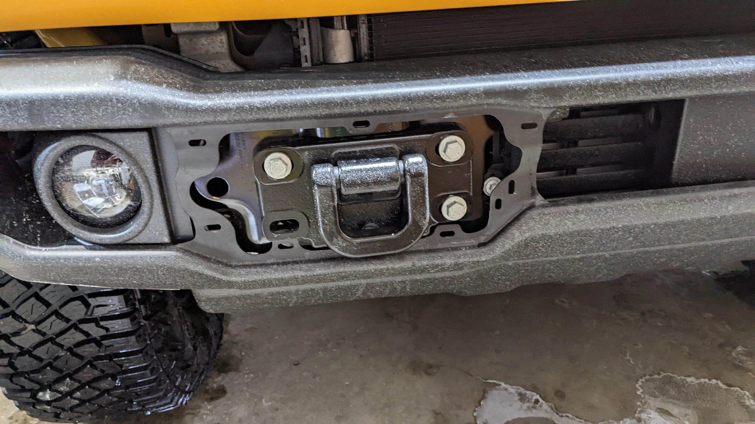

I tried to take mine out and they seem to be welded to the bumper reinforcement. (Took out the three screws in the picture but they did not budge). The whole bumper came loose from that side. I also took a good peek inside the bumper and I do not see too many wires. Seems like it would be possible to drill and put a reinforcement on the back to mount accessories. However, to make it easier to work with, you probably have to take out the hole bumper.

Not really too bad now that I think about it, it should be simple to make a bracket coming off those three bolts that reaches thru the cover.

You have to remove the bumper as well and there's apparently a bolt behind it that holds the entire shackle mount.
