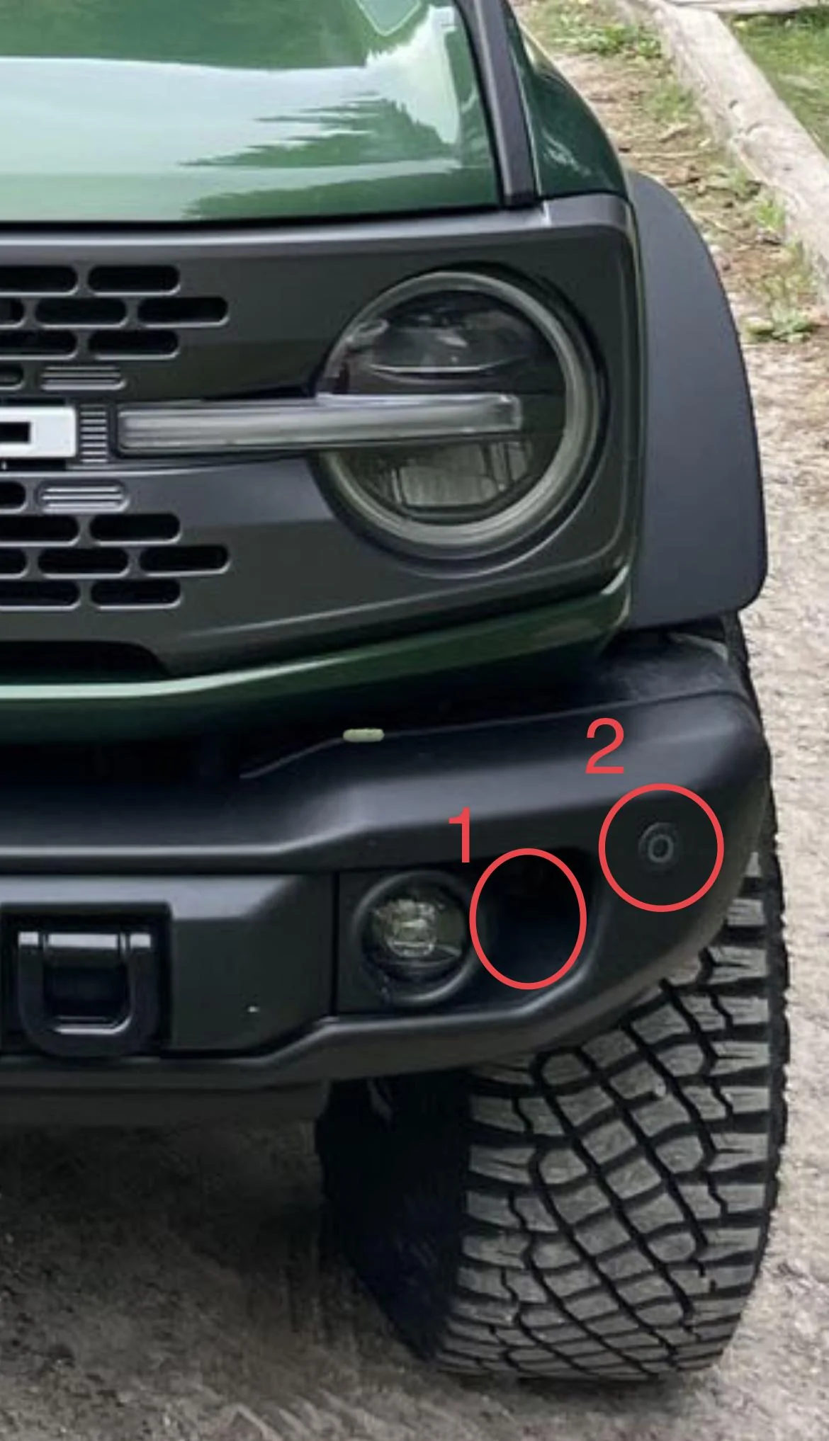

1. Has anyone seen an aftermarket fog light installed here (next to the factory fog)?
2. What is this? (Camera? Proximity Sensor?)

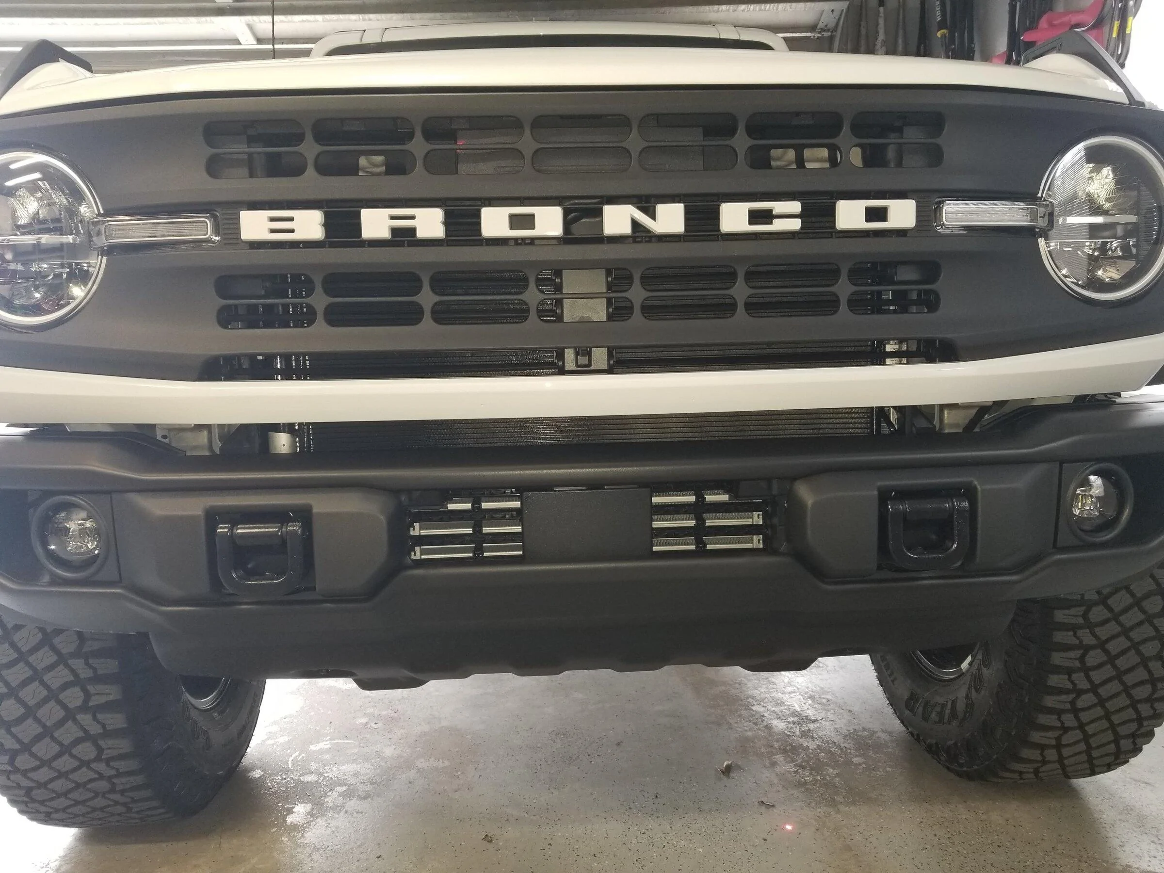

For those wishing to put a light bar between bumper and body molding, I just measured my 2022 Black Diamond with capable bumper. The height of the opening is 1 & 9/16" (bottom of the white facia to top of bumper, pretty consistent height gap). I used a a couple pieces of wood to measure the entire length, 1 & 9/16" is the max overall height of any light bar you want to tuck in between. (There may be some adjustment to gain some height by adjusting the bumper bolts and trying to lower the bumper, but this is mine from the factory) 41" wide in between the edge areas that rise up on the bumper. 4" of depth from front of bumper to a couple of bracket spots that limit going any deeper for a 30-40" light bar.
Let me know if anybody finds anything to fit this. Not looking to spend a ton of money and don't do a lot of night offroading, just think it would look better with a light bar in that gap

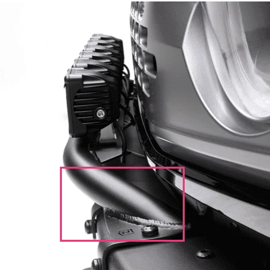

I like, and appreciate your thought process on this. I'm dealing with the same 'wish' for my capable bumper when it arrives. However, I have a very specific ZROADZ light bar in mind (already purchased) - given it's particular design. I think with some minor modifications (and a Dremmel), I could get 'er done.
Per the photo below. Instead of a typical pure vertical profile from base to top, this one actually protrudes forward immediately from its base. That, along with the available gap (that you've validated) between the bumper and body molding, I think it might work out well in the end.
Ford Bronco Capable Bumper questions Screen Shot 2022-03-03 at 2.39.18 PM
Thoughts?

Thinking it is going to be very tight on the depth, the capable bumper does not stick out very much at all. My 4" depth measurement was mostly under the body facia piece.
Yeah, I realize it doesn't stick out like the Modular bumper does. I've got an idea/plan for that... I think. :)

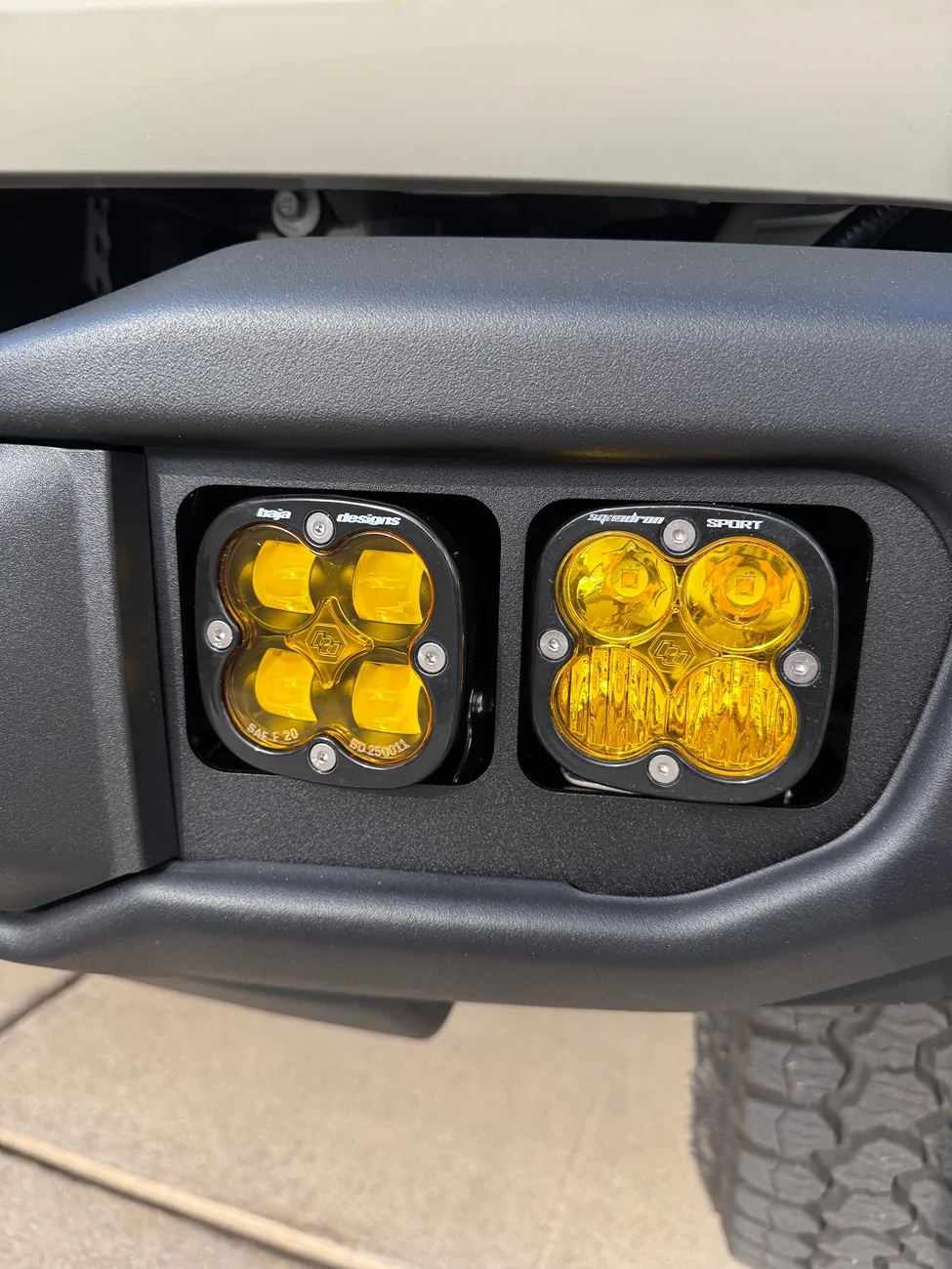

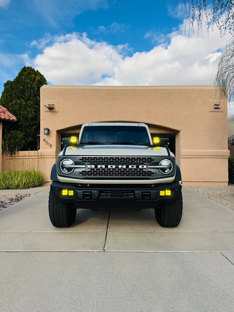

Ford Bronco Capable Bumper questions IMG_3572
Ford Bronco Capable Bumper questions IMG_3574
perfect fit for capable bumper.
Baja Designs SAE AND squadron sport
