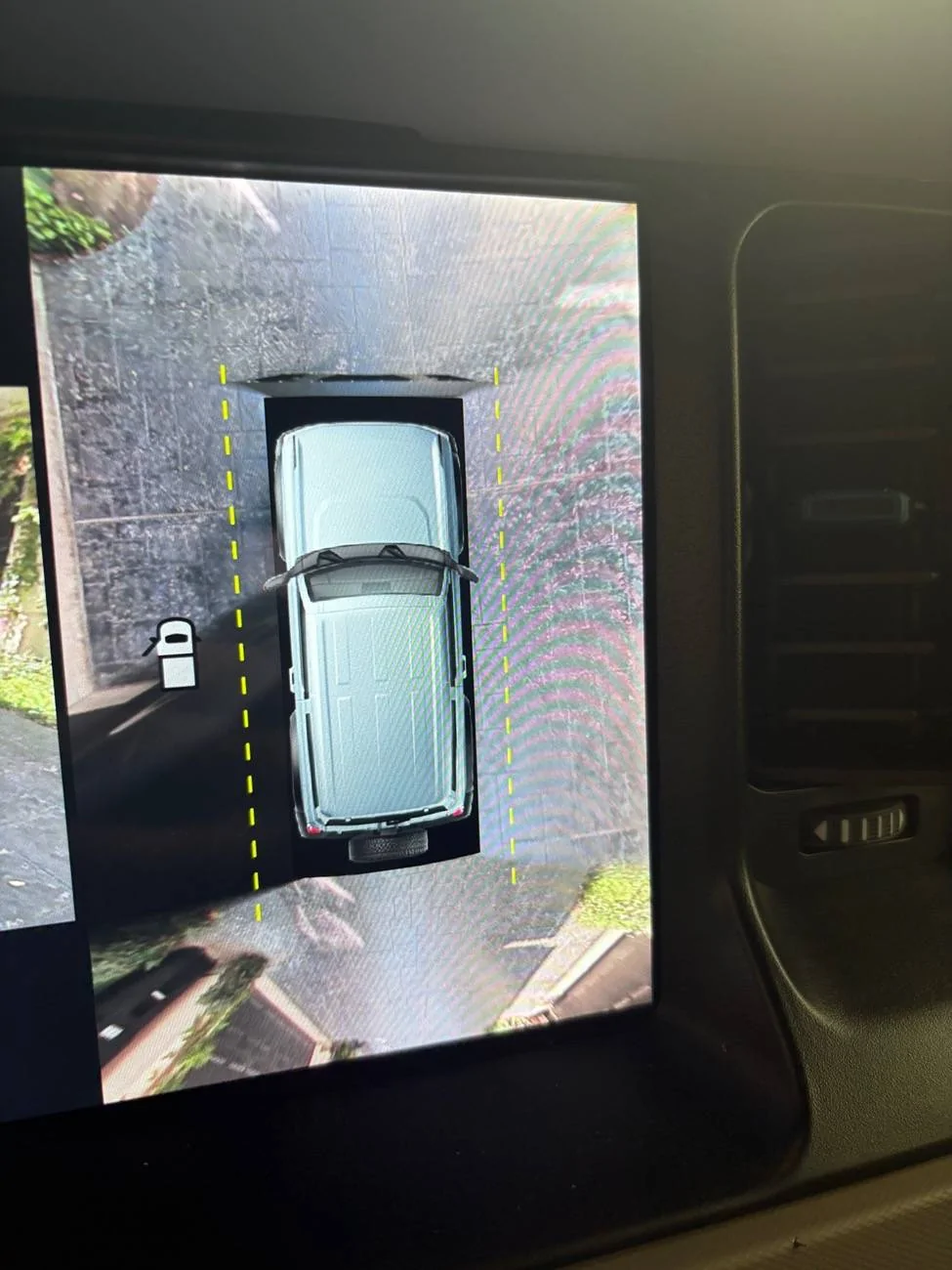

I don’t spend much time using the 360 cameras but I noticed this blackout recently when in Trailer Mode - see pic - does that mean a camera is out? If so where is this one located?

What is the blackout, you appear to have the left door open which is skewing/ showing a shadow on the left side.
Is that what you're talking about?

Try it with the door closed.

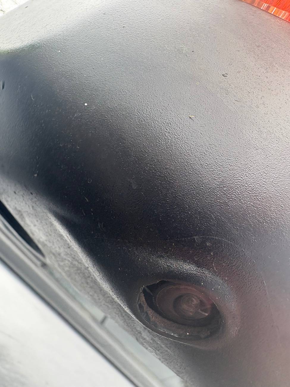

Thanks it wasn’t the door but looked like it was; turns out the mirror camera lens is crooked, didn’t re-seat correctly when I opened the housing to do a repair
Ford Bronco Camera out? IMG_0887
