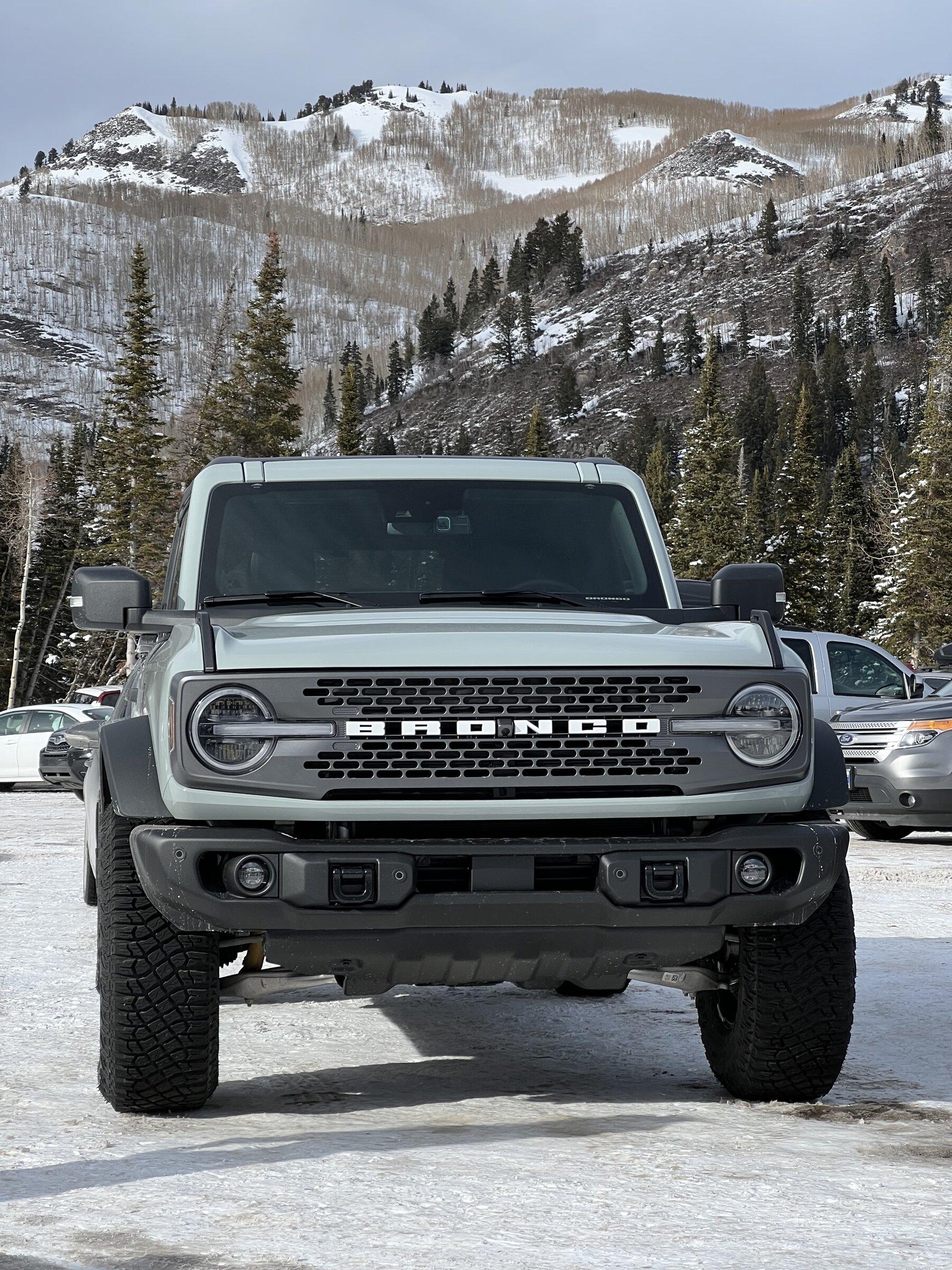

The gap between my front capable bumper and the body is a full 1in taller on the driver side versus passenger side.
After measuring from the ground, it appears that the bumper is leveled, so it’s probably the body that is crooked.
My buddy who took delivery of his Badlands with same bumper and built the same day and doesn’t have this issue.
This drives me crazy when looking at the bronco.
Anyone got the same issue and what can be done?

Mines slightly off ever since i reattached my bumper the second time. It bothers me but not enough to fix it in the cold. But either way, on the mod bumper it's easy to adjust. Remove two covers, loosen 6 bolts, align, tighten down, install covers.
I don't know how the capable attaches, but if it's similar or the same then it may be a quick fix to realign the bumper.
