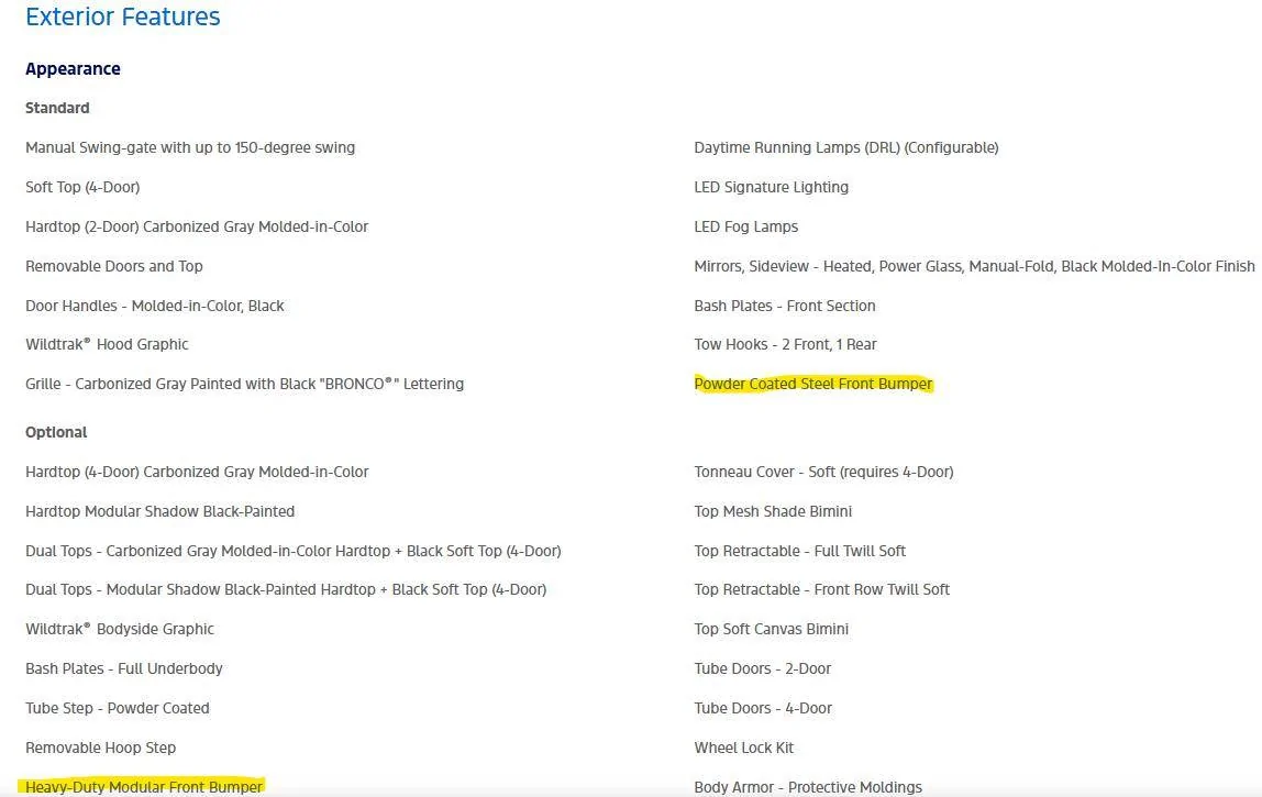

B&P shows a '24 WT with the performance modular bumper (not capable).
B&P shows the standard package with 'Powder coated steel bumper' Optional has the 'Heavy-duty modular front bumper'
Ok, here's what I see though ...
Ford Bronco Bull bar and off road light recommendations Screenshot_20250126-130306
I guess the OP can speak up to which he has. Capable definitely has fewer choices and hopefully your release gives some options for those looking. Doesn't IAG offer a bull bar for mod bumper as well?

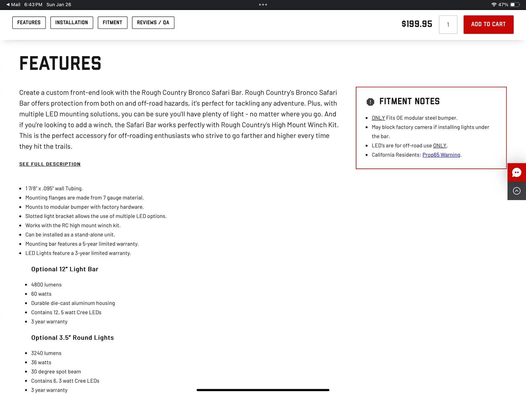

Wouldn’t this work?
Ford Bronco Bull bar and off road light recommendations IMG_0047
Ford Bronco Bull bar and off road light recommendations IMG_0048

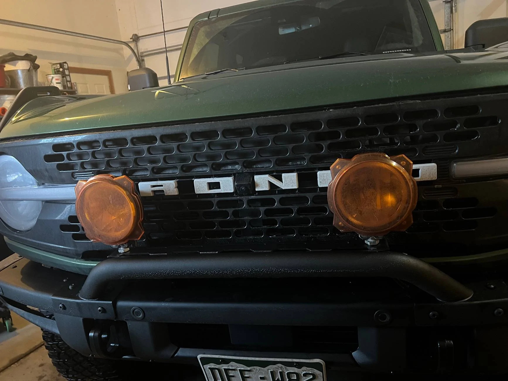

I went with the IAG mini bull bar and the KC pro6 lights. Initially I thought the mini bull bar didn’t give enough clearance for the wiring coming off the back of the lights and the grill. Tried the direct bumper mounts by mountains to metal but they were way too flimsy and the lights bounced all over with any bump. The wiring does depress the grill backwards slightly but looks great and is solid.
Ford Bronco Bull bar and off road light recommendations IMG_3036
Ford Bronco Bull bar and off road light recommendations IMG_3035
Ford Bronco Bull bar and off road light recommendations IMG_3034
