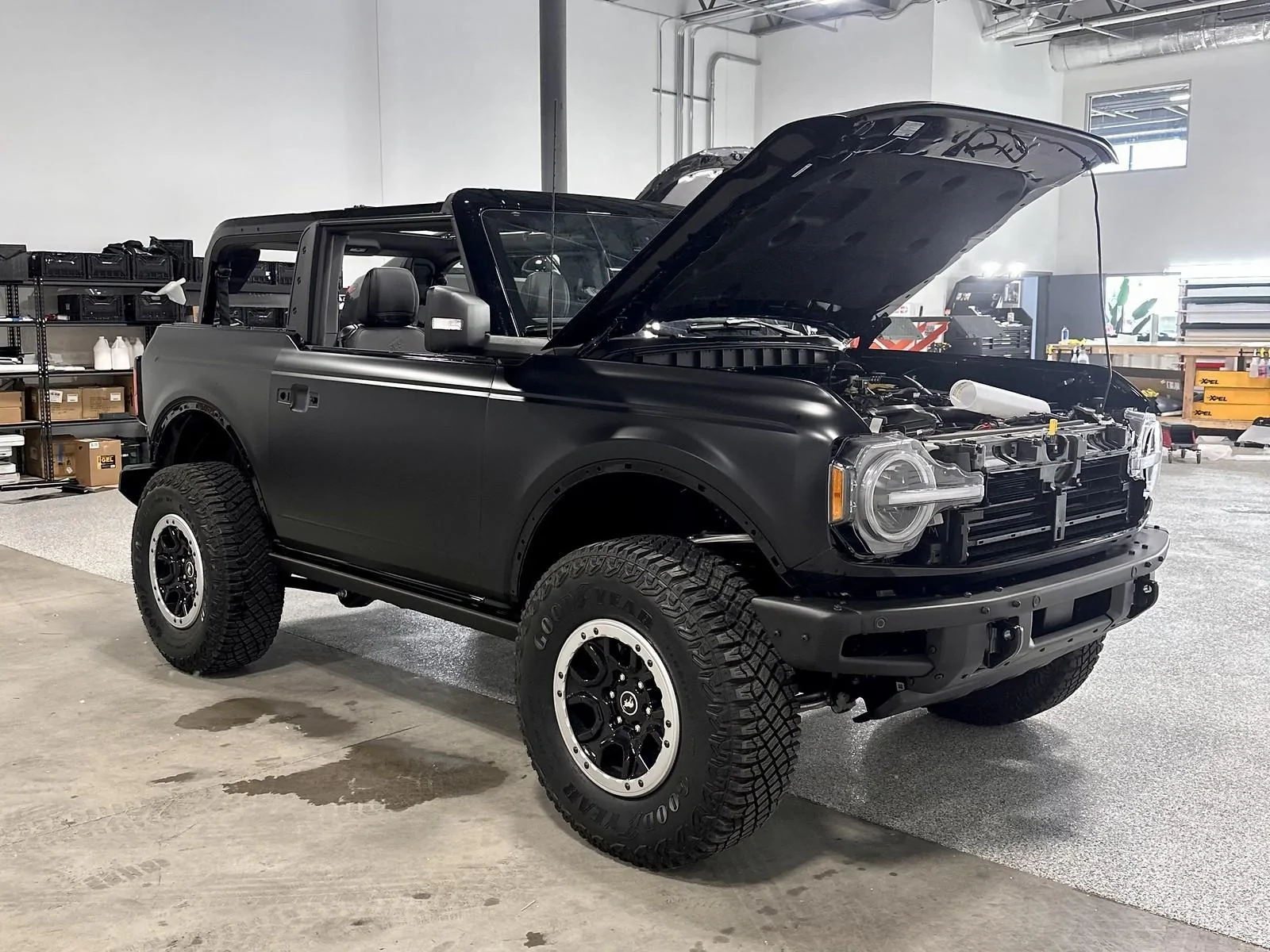

After the amount of pinstripes that my friends and I (in my Jeep) endured on a recent trip to the Ozark National Forest... I bit the bullet and went for mod number one. A full @XPEL Stealth Satin PPF wrap.
I absolutely love the satin black look and peace of mind that it'll give.

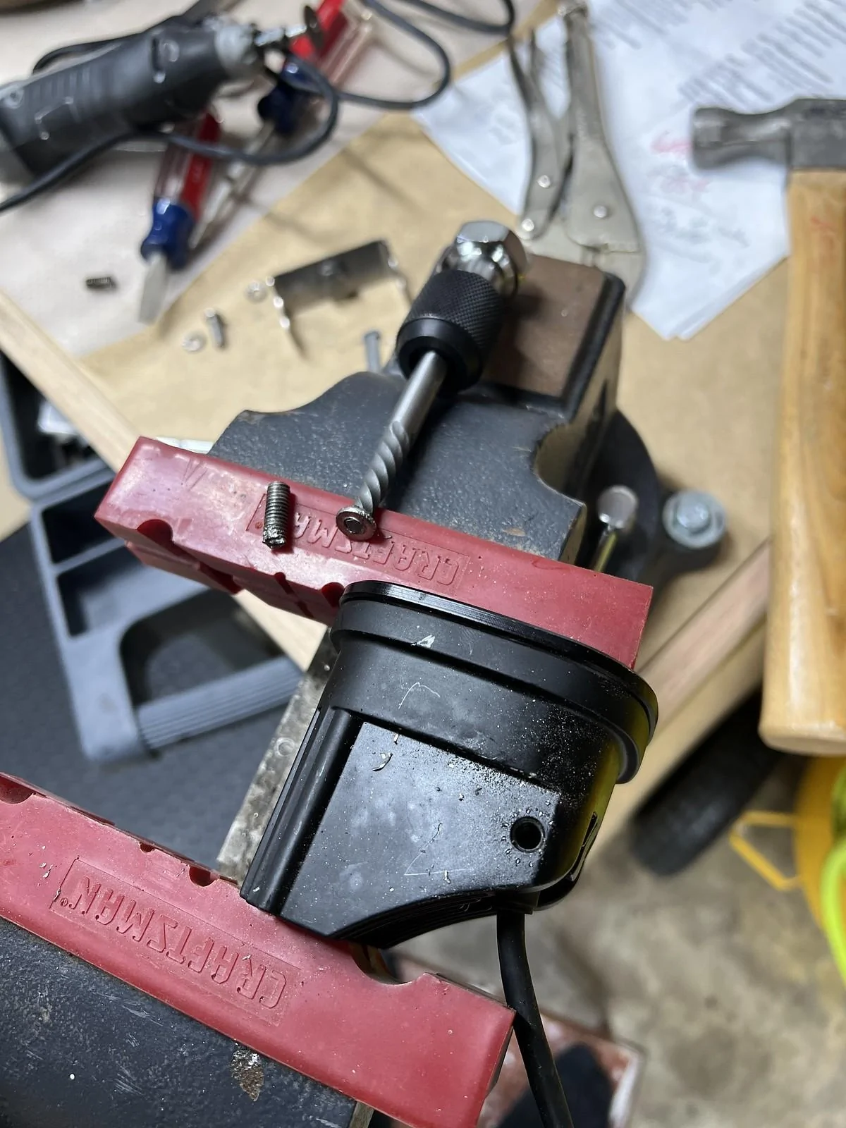

Mod #2: Moved my @Baja Designs squadron sport ditch lights over from my Jeep. I had a hell of a time removing a seized stainless screw from one of the aluminum body mounts, but eventually got it. I then cleaned the threads out with a tap, replaced all of the SS screws, and made sure to use anti-seize this time around.
Ford Bronco BROOX's 2DR Shadow Black Squatchy Boy pro-tip-use-anti-seize-when-putting-ss-screws-into

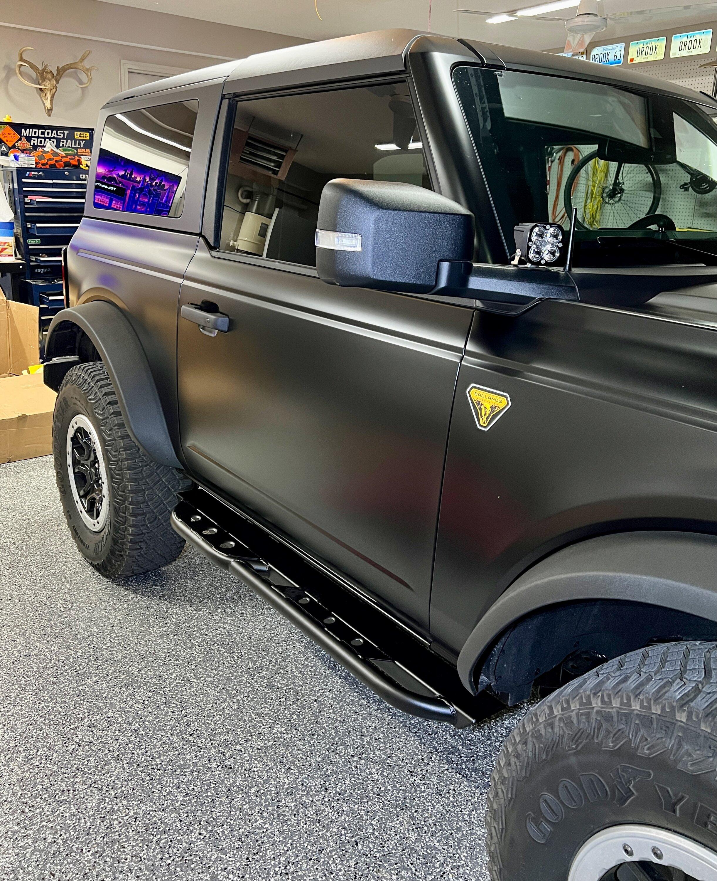

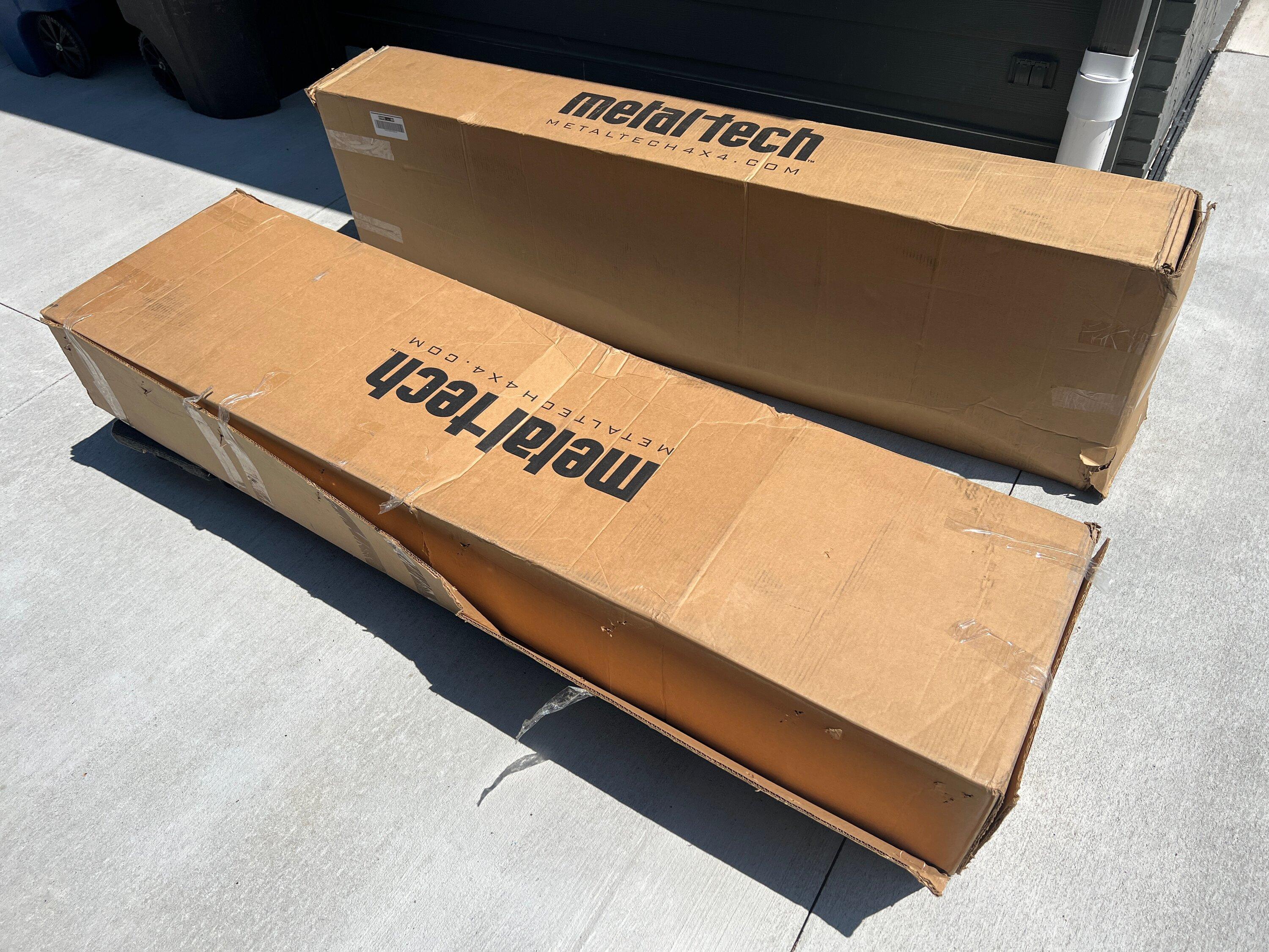

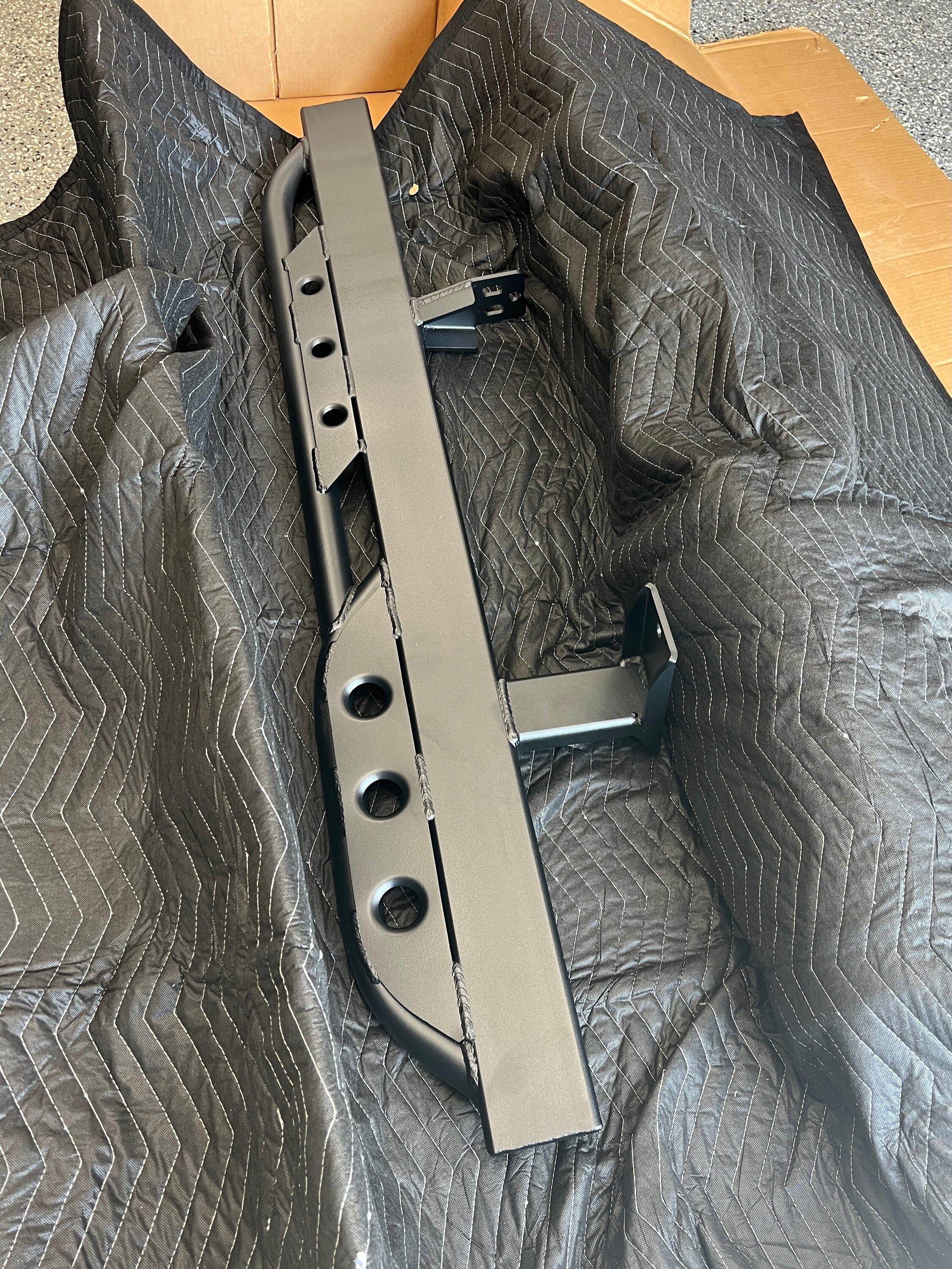

Mod #4 - Frame mounted slider steps from @Metal-tech 4x4.
They arrived in separate boxes, which were a bit beat up, but the sliders were packaged really well and survived with no scuffs. At nearly 60lbs a piece, these things are stout!
Ford Bronco BROOX's 2DR Shadow Black Squatchy Boy metaltech - 1
Ford Bronco BROOX's 2DR Shadow Black Squatchy Boy metaltech - 2
Ford Bronco BROOX's 2DR Shadow Black Squatchy Boy metaltech - 3
The design of these sliders really reveals the pinch seam, which I don't love, but that seems to be the case with most frame mounted slider steps on the Bronco platform. The pinch seam on my vehicle is like the only glossy bit of paint showing after the XPEL Stealth wrap... So, I took a rattle can of matte black spray paint to my 3 week old vehicle. 😬
Ford Bronco BROOX's 2DR Shadow Black Squatchy Boy metaltech - 5
Install was a bit tricky with only 1 person, but definitely doable with 5-gallon buckets, jack stands, and a floor jack. Getting the U-bolt in place around the gas tank was probably the trickiest part. My gas tank is pretty close to the frame, so the passenger side U-bolt is actually touching the top edge of the gas tank, which I don't love, at all... so I need to try to figure something out there.
Ford Bronco BROOX's 2DR Shadow Black Squatchy Boy metaltech - 6
Other than that, my only complaints with these are: I wish they sat up just a touch higher and I wish they had a bit more poke to protect against door dings and offer a slightly wider step. But they look nice, are super stout, provide a decent step for getting in/out, and should give some great protection on the trail.
Oh, I should also mention... I was between these and the @RCI Offroad sliders, but the lead time was much greater and they were nearly unresponsive to my calls and emails. @Metal-tech 4x4 was super quick to respond to all of my messages and had a crazy fast turnaround. So, I went with them!
Are you saying those sliders came wrapped in Styrofoam sheeting AND a moving blanket?? If so, I gotta give kuddos to @Metal-tech 4x4.
Can you post a picture of this U-bolt touching the gas tank? Your rig is looking sharp!!

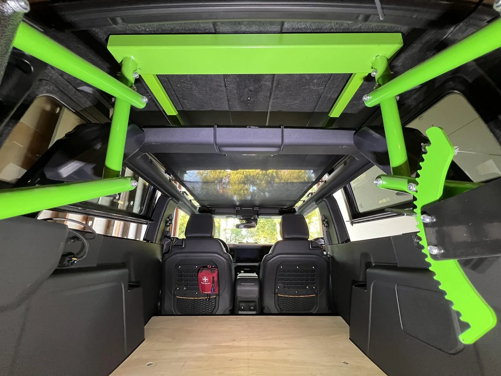

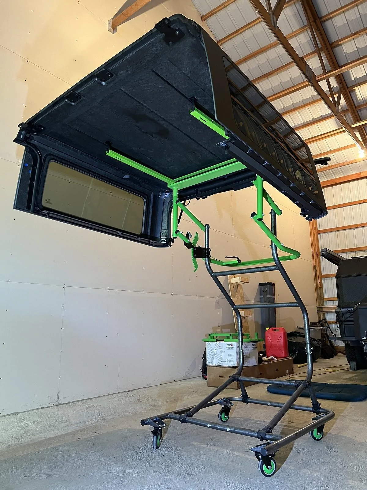

Not really a mod, but I'm glad to have my top lift pro back in action.
I loved how easy it was to remove the hardtop on my 2-door Jeep with the @TopLift Pro ... but with the bronco's crossbar sitting so close to the rear of the vehicle, the Jeep's TopLift design just didn't work. I actually scratched my rear crossbar down to the aluminum trying to make it work. 😭
Luckily, TopLift's engineering team came up with a new solution and was able to ship me the Bronco attachment for my existing TopLift a few weeks ago.
The 2-door Bronco TopLift is a bit more involved than the 4-door or Jeep models, but it's still easy enough to do alone.
Here are some photos of the update and putting it to use.
The TLP that works with everything but the 2-door bronco...
Ford Bronco BROOX's 2DR Shadow Black Squatchy Boy topift-
The 2-Door Bronco TLP attachment, in a slightly mismatching green...
Ford Bronco BROOX's 2DR Shadow Black Squatchy Boy toplift-bronco
Arms folded out to support the top
Ford Bronco BROOX's 2DR Shadow Black Squatchy Boy toplift-insid
Top coming off
Ford Bronco BROOX's 2DR Shadow Black Squatchy Boy removing the to
Hardtop supported by the Top Lift
Ford Bronco BROOX's 2DR Shadow Black Squatchy Boy toplift-off
I didn't get a photo of it, but one of the weird parts of this design is that the angle in which the 2-door topper sits makes it so that you need to raise the front of the hardtop in order to fold the arms out. TopLift suggests using a pool noodle between the roll bar and front mounting points of the hardtop... It works, but is kind of a weird requirement.
I feel like Top Lift could have replaced the upper horizontal green tubes in my last photo with some slightly longer versions to level out the angle of the hardtop supports... This theoretically would make it so that you wouldn't have to manually walk around to lift the front of the hard top. 🤷‍♂️
Either way. I'm just happy to have this thing back in action to easily go topless!

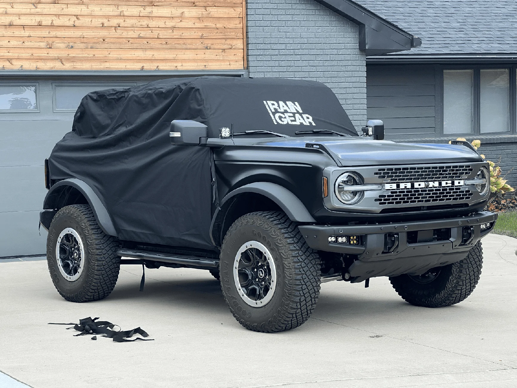

I also grabbed the Rain Gear Trail Cover for a bit of insurance while running around topless.
It came rolled up in a larger bag than I wanted, but I found that it could be re-rolled to easily tuck behind the seats.
Ford Bronco BROOX's 2DR Shadow Black Squatchy Boy raingear - 1
