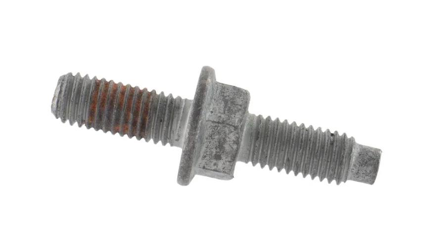

@flip anyway your can get me specs on NB3Z-4A322-A as unfortunately the Raptor (3.0) pdf doesn't display any dimensions.

All the description says is "stud". Don't have any in stock to measure but the non-raptor version of this stud says M8 X 1.25 (second pic). Shorter due to the stamped cover, probably the same diameter and pitch as the rap.

I'm thinking it's prob same pitch and diameter also

I have verified it's the exact same hardware as far as pitch/diameter - but sure about length tho. I can say that the new hardware for both the Ford Performance M220 and M235 was identical in length.
