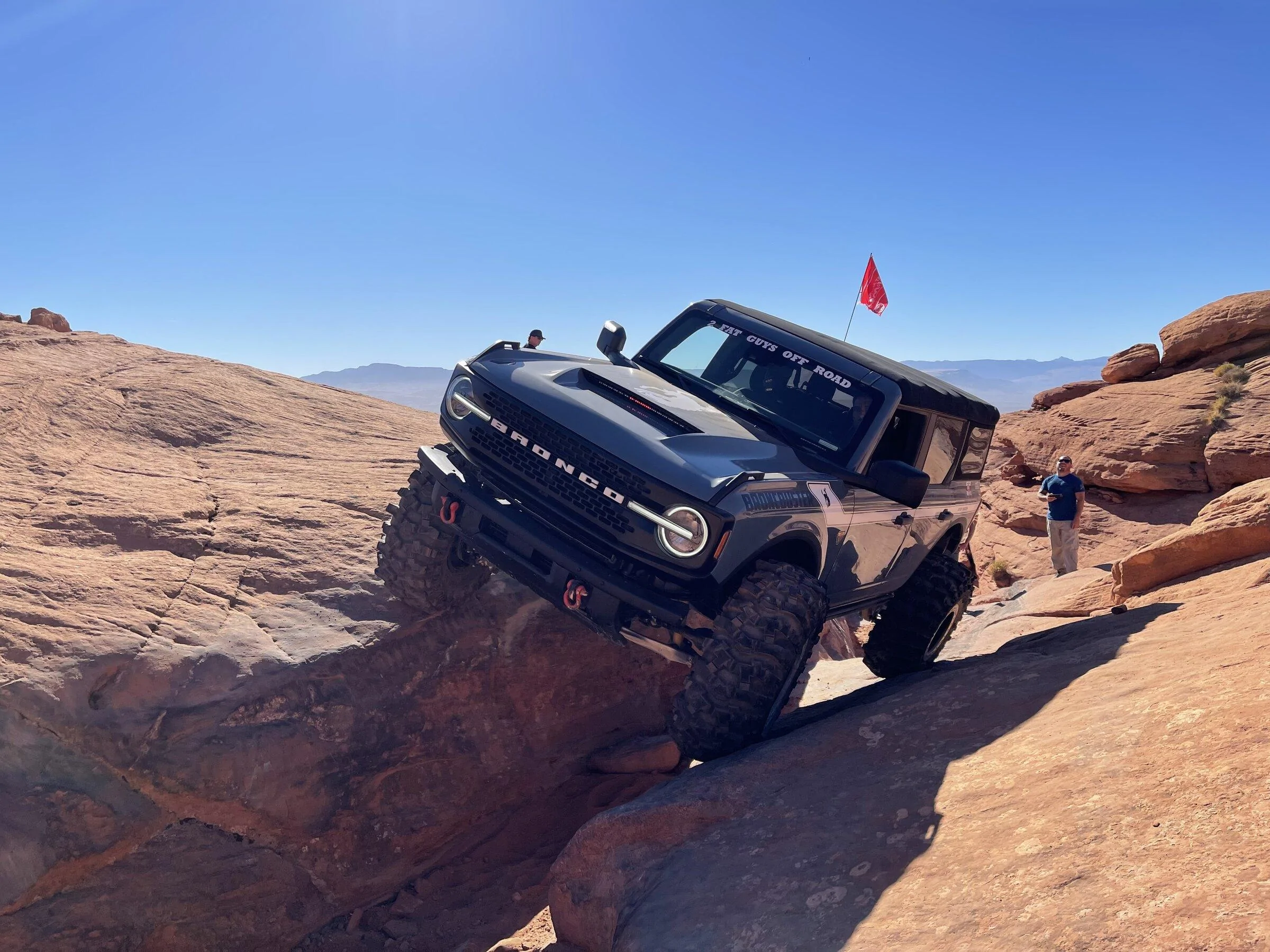

#1 What Went Wrong:
Ford Bronco Bronco steering fix after failure 8714693E-F86F-4C33-8FA6-DDADA81BB1F6
Luckily, it doesn’t look like its exclusively a Bronco thing, meaning the cause of failure is related more to any suspension lift than size of tires, brand of lift, etc. When a lift is installed, the geometry angle of the tie rods change so that the wheel acts like a fulcrum applying load on the tie rods, or in this case of failure, the lever that causes a mechanical separation between the rack and pinion, which is why in most known cases it happens while climbing with little or no steering input. Specifically, when the wheel comes up from full droop it can compress a keeper in the rack as little as 1/8” inch which we have found can cause temporary, and in some cases, complete loss of steering. Last week we encountered a new Bronco with a 3” lift and 37” tires wheeling with our group at Wolfs Caves. Although not difficult, the very first obstacle caused a disconnect between the rack and pinion gear and a complete loss of steering. Keep in mind I’m standing right there watching and nothing the driver was doing should have in any way warranted this failure-no throttle junkie and no skinny peddle- just slow crawling. When he lost steering input, I immediately knew the exact cause and had him back up until the pressure released, the rack and pinion reengaged, and steering input returned to normal. He then parked his Bronco and rode with others the rest of the day. Later that evening he decided to drive it home since steering seemed to have returned to normal. I wasn’t around or I would have advised otherwise. He made it about five miles down the highway before he lost all steering but luckily veered off the road and away from oncoming traffic. He was lucky. Again, it doesn’t matter if it’s a 2” puck lift or new coil overs with upper control arms, none of these correct geometry between the wheel and the rack. The only way you would correct that would be to lower the rack to compensate for same distance the vehicle was lifted.

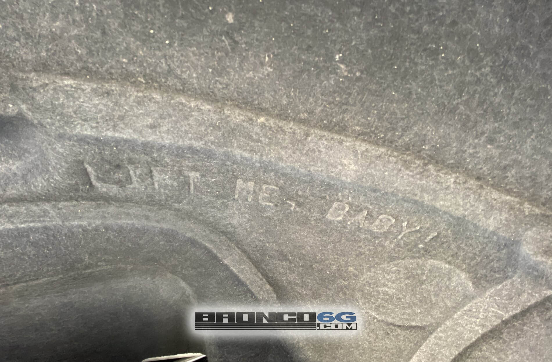

Can you tell if this is happening if by chance Ford used a stock Ranger rack and never really designed a Bronco specific one, for a vehicle intended to be lifted?
If so, I'm sure we can melt this Easter egg off the Bronco with a heat gun.
Easter egg found in Bronco wheel well - "LIFT ME BABY!"
On the other hand, the good news is Ford cannot deny a warranty claim for damage caused by lifting a Bronco since they tell you to do it right there on the Bronco.
