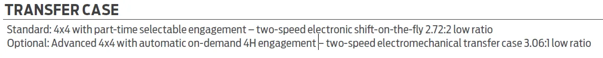

The bronco will also have AWD
I don't think Bronco has AWD. The 4A for bronco is only on-demand switching between 2H/4H. Not true full-time AWD with split front/rear torque like the 2017+ Raptor's 4A mode.

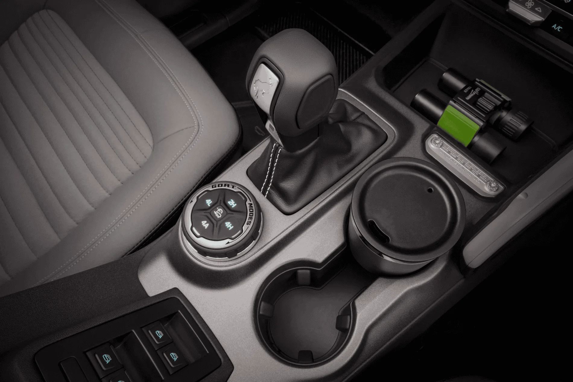

what is the 4A switch for then?
It enables the auto 4H mode. On wheel slip it switches to 4H.
For 2017+ Raptor, they reused the older dash switches and didn't change the label. On older Raptors, 4A is Auto4h. On newer Raptors it is AWD.

when you say newer raptors .. what do you mean?
I have a 2019 and I have 4A
