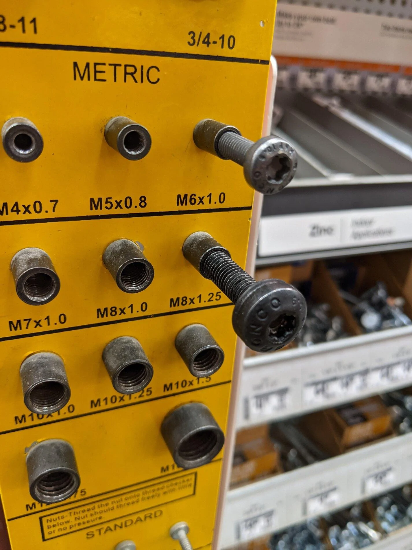

Alright, the moment you've been waiting for...
The little bolt appears to be M6x20
The bigger bolt appears to be M8x30
Looks like I nailed the size and type. 😎
Based on the photos, I’m guessing…
M8 x 30mm T40 Torx?
M6 x 20mm T40 Torx?
I would love to learn the actual sizes, if anyone can confirm them.
Any confirmation on the Torx head? :unsure:
Based on @flip’s post, I think it’s probably T30 instead of T40. I doubt the Bronco tool kit contains two different Torx wrenches?
