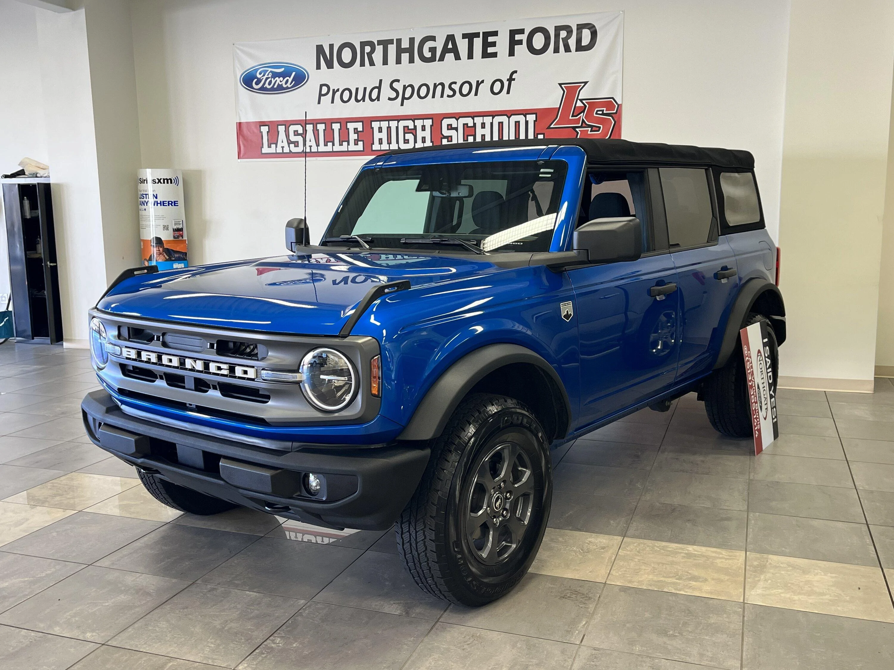

Hey all! Looks like I'm new to the club. I finally got my hands on a 4D Big Bend Velocity Blue Bronco a few weeks ago on a good deal near MSRP. Loving the Bronco so far, but like many others, I'm not exactly blown away with the audio system. With the Big Bend model, I have the base 6-speaker audio system, which is pretty lackluster to be honest.
I'm open to any suggestions as to specific speakers/subs/amp/etc. to improve this quality (I'm far from tech savvy, so likely looking to purchase these and then have them installed somewhere). I was leaning toward installing a 10" subwoofer, but starting to think the speakers might need to be replaced as well Let me know some of what you guys have done to improve the listening experience and what you purchased to do so! Happy to be a part of the Bronco family.
