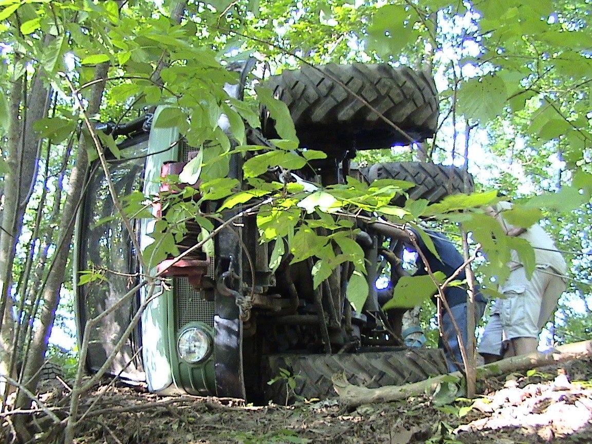

Right?? But a few years back a Unimog did roll on Old Ore Road, so I guess anything's possible....
You have to screw up pretty bad to flop over a Mog.
