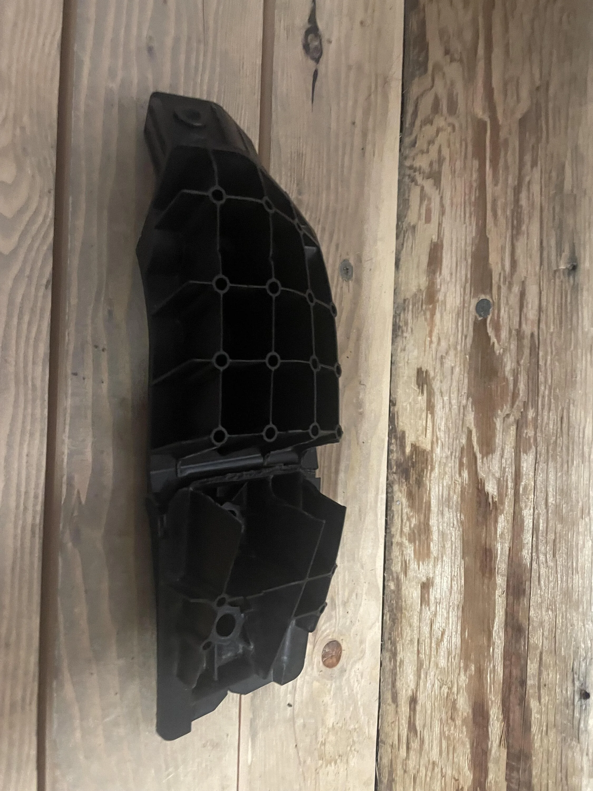

Hi,

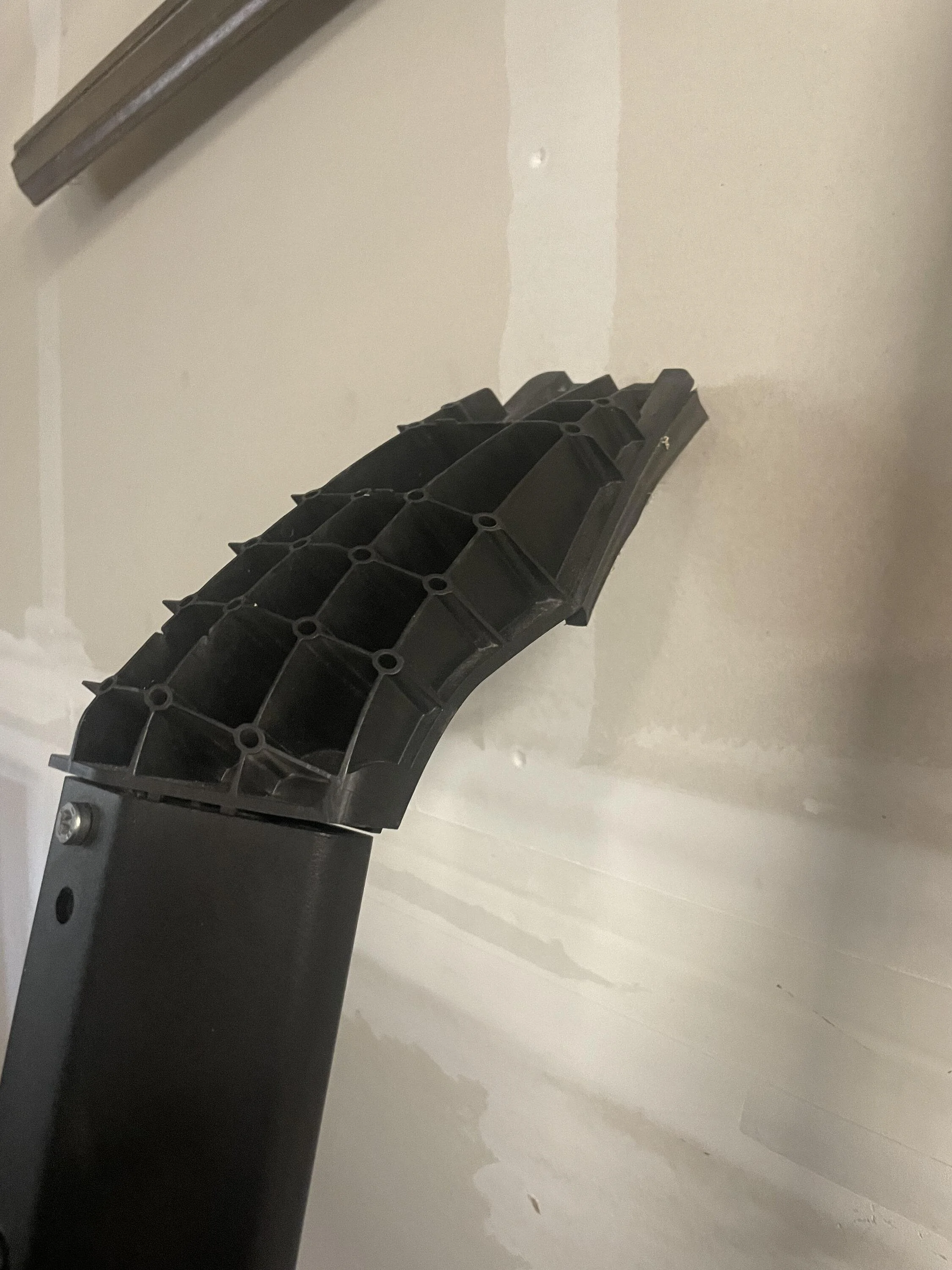

My plastic connection piece that mounts the roof rack bars to the front of the bronco cracked. (See Image below). I've reached out to Ford customer service, and the dealer, and they said I'd have to spend $1000 to buy a whole new rack.
All I need is this little plastic part, but apparently they don't replace that individual piece. Are there any 3rd party alternatives?
Thx,
Ford Bronco Broken Roof Rack Connection Claw broken_part
Ford Bronco Broken Roof Rack Connection Claw connection_piec

Honestly, short of buying a used factory rack or a aftermarket (both of which will run you $400), I might try to repair it.
JB weld is some really strong stuff. If you drill some holes in the ribs on both side (think plug welds), then take JB weld putty and smash it on both sides of each rib, making sure it goes through the holes and sticks to the puddy on the other side....it may turn out.
I mean once it hardens, you could stand on it and see if it holds. Being the entire rack is only supposed to support like 500 lbs, if that one bracket can hold an adult man... You'd probably be okay.

Stupid break on my part . Thanks for the tip, I’ll look into weld putty!

Good luck... Yeah that JB will putty hardens like steel... The only trick is to make sure that it has bite on the two halves of the broken ridges...heck, you could even put some small screws or bolts through the edges and then the putty would wrap around them like anchor studs.

Haha, I hear ya, and I don’t like dealers, but my fault , so my responsibility.
Bro addict sells the whole rack for $300, and I could swap the claw part out. I’m going to try the weld putty first though. Thx again!

Here is another thought.... cut the rear (driver to passenger) fins on the first line back from the break. then cut some 0.080 aluminum (I would think 1/8 would be overkill) and supplement the front to rear fins with the aluminum (4 fins). add a couple pop rivets or small bolts and also use the adhesive (yes I like the JB weld as well) to adhere the 4 aluminum "replacement fins" to the current plastic. 0.080 aluminum is easy to cut to shape with a jig saw or band saw. Would probably be stronger than the original.
