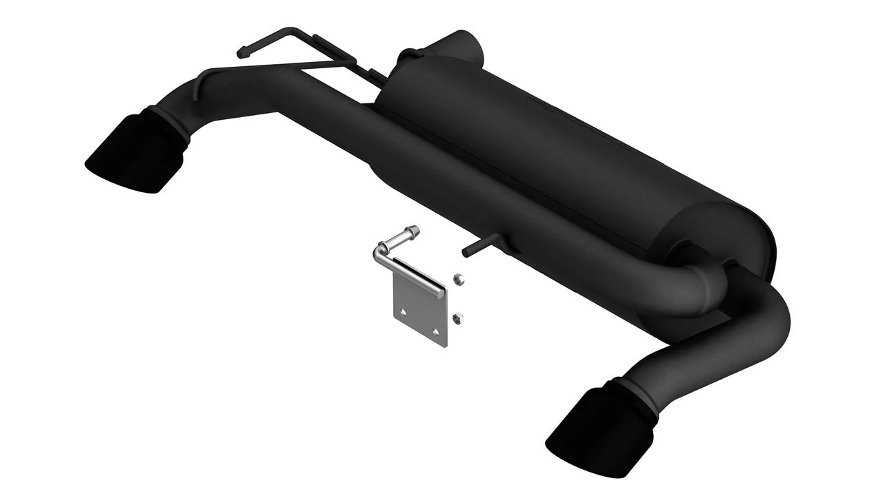

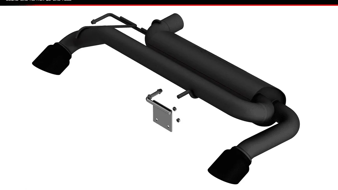

Looking at the pics on the Borla website, the 2.7 system has a larger muffler
2.3:

2.7:
