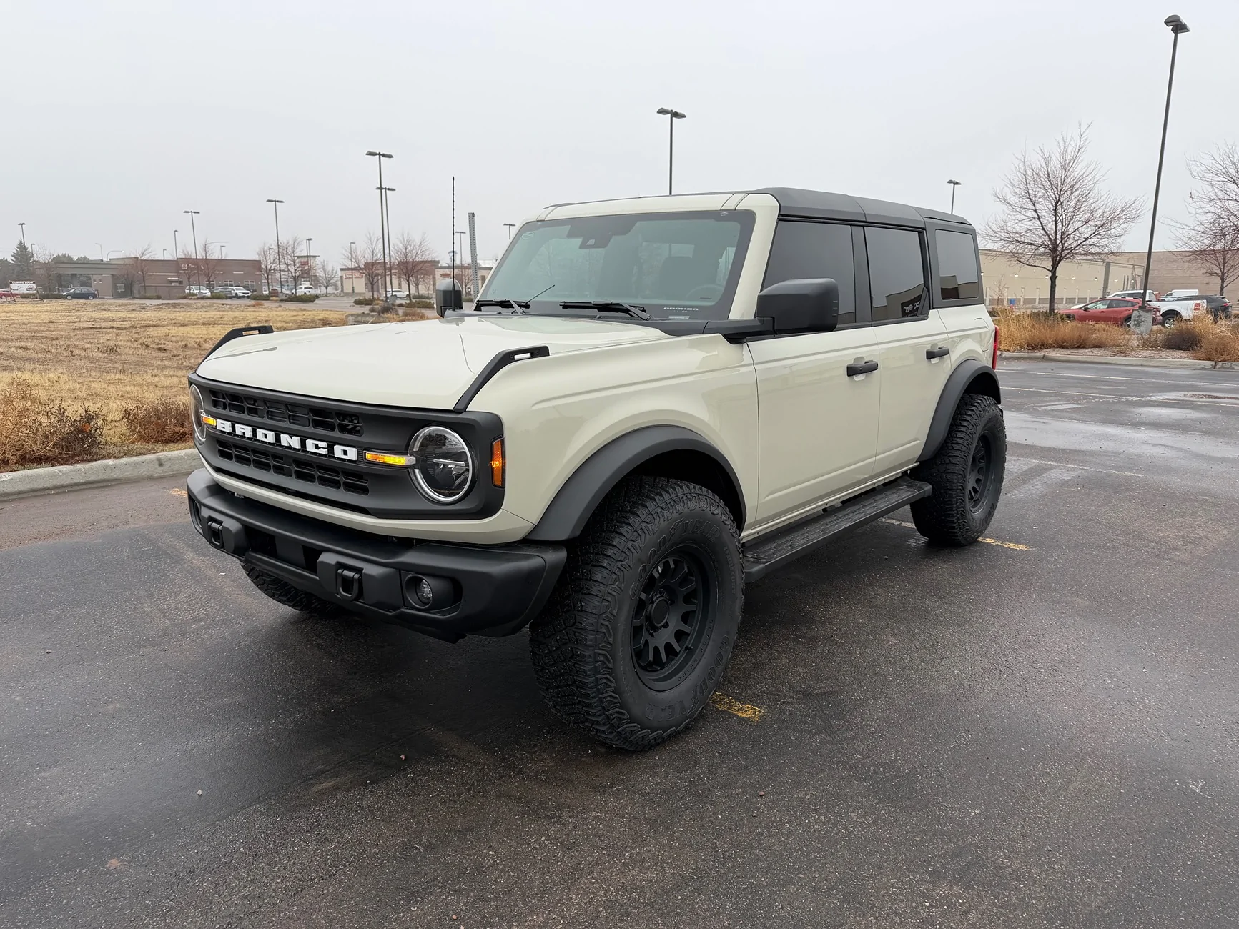

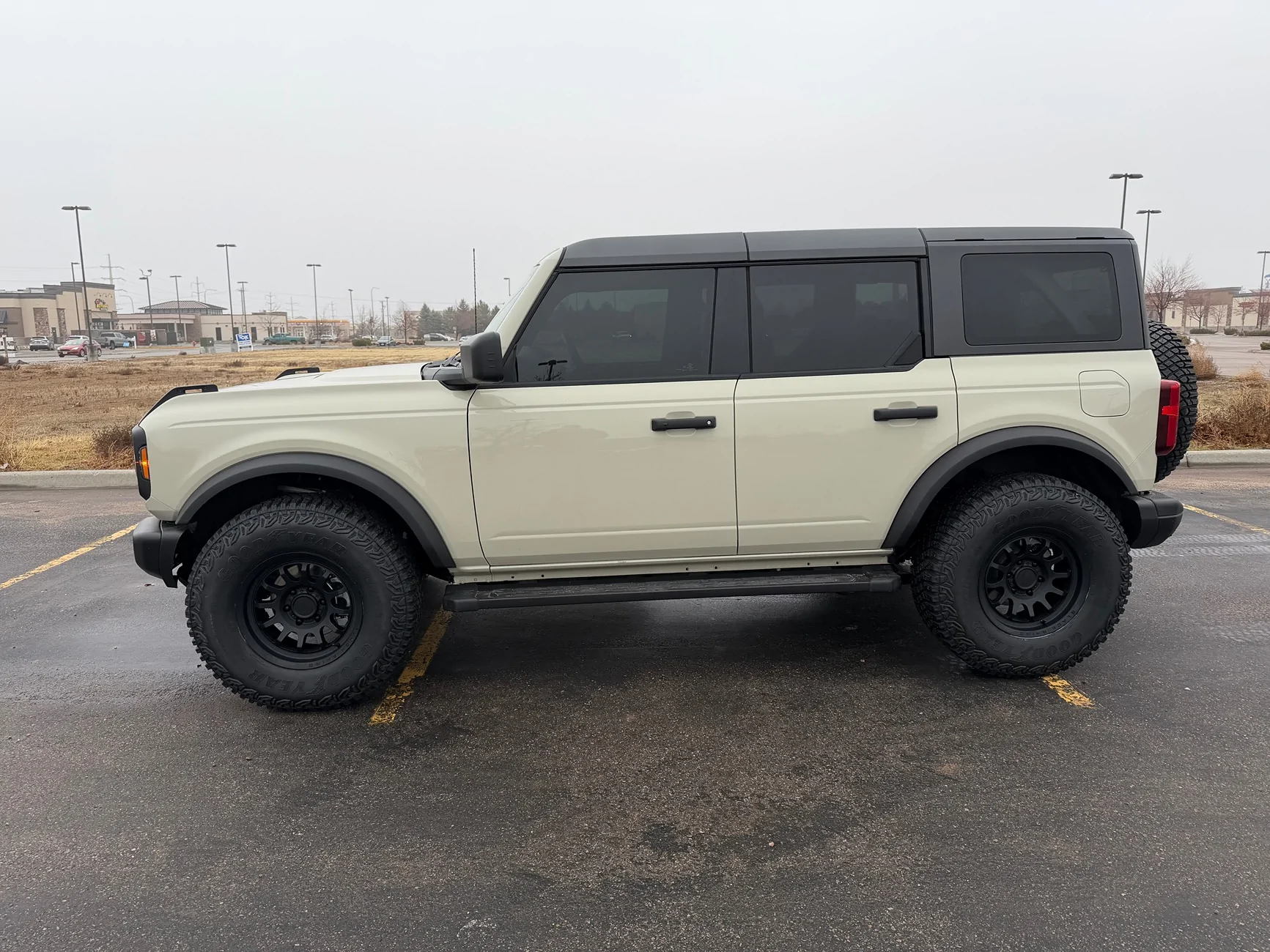

Mounted some Goodyear MT 315/70/17 tires (Sasquatch) on Black Rhino Rapid 17 x 8.5 0 offset wheels. Wheels are 23 lbs, tires 53 lbs for a total weight of 76 lbs. The stock Black Diamond aluminum wheels with the 265/70/17 General tires are 74 lbs. Bronco drives better with these vs the stock wheels/tires, smoothed out the shifts and took some of the harshness out of the ride due to more rubber. Eibach coilovers ordered but haven’t arrived yet.

Thanks for this. I recently installed the Eibachs (love them) and am now trying to figure out wheels/tires. For now I'm going to put the MT Baja Boss 255/85/17s to get to 34.6, but eventually would like to upgrade the wheels with a lighter rim. I had my eye on the RTRs which are also under 25lbs but this is a good option too.
