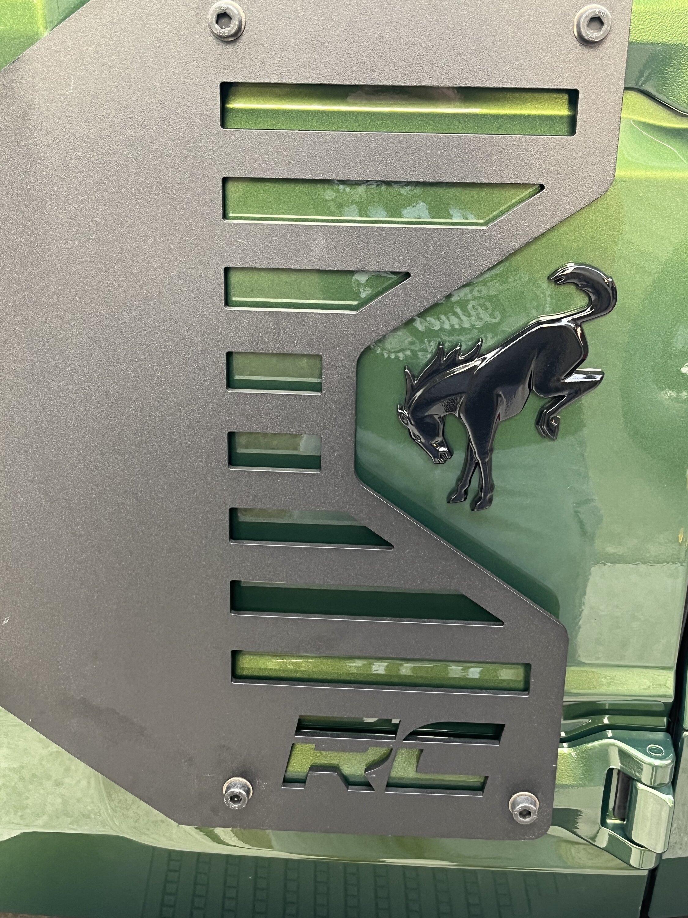

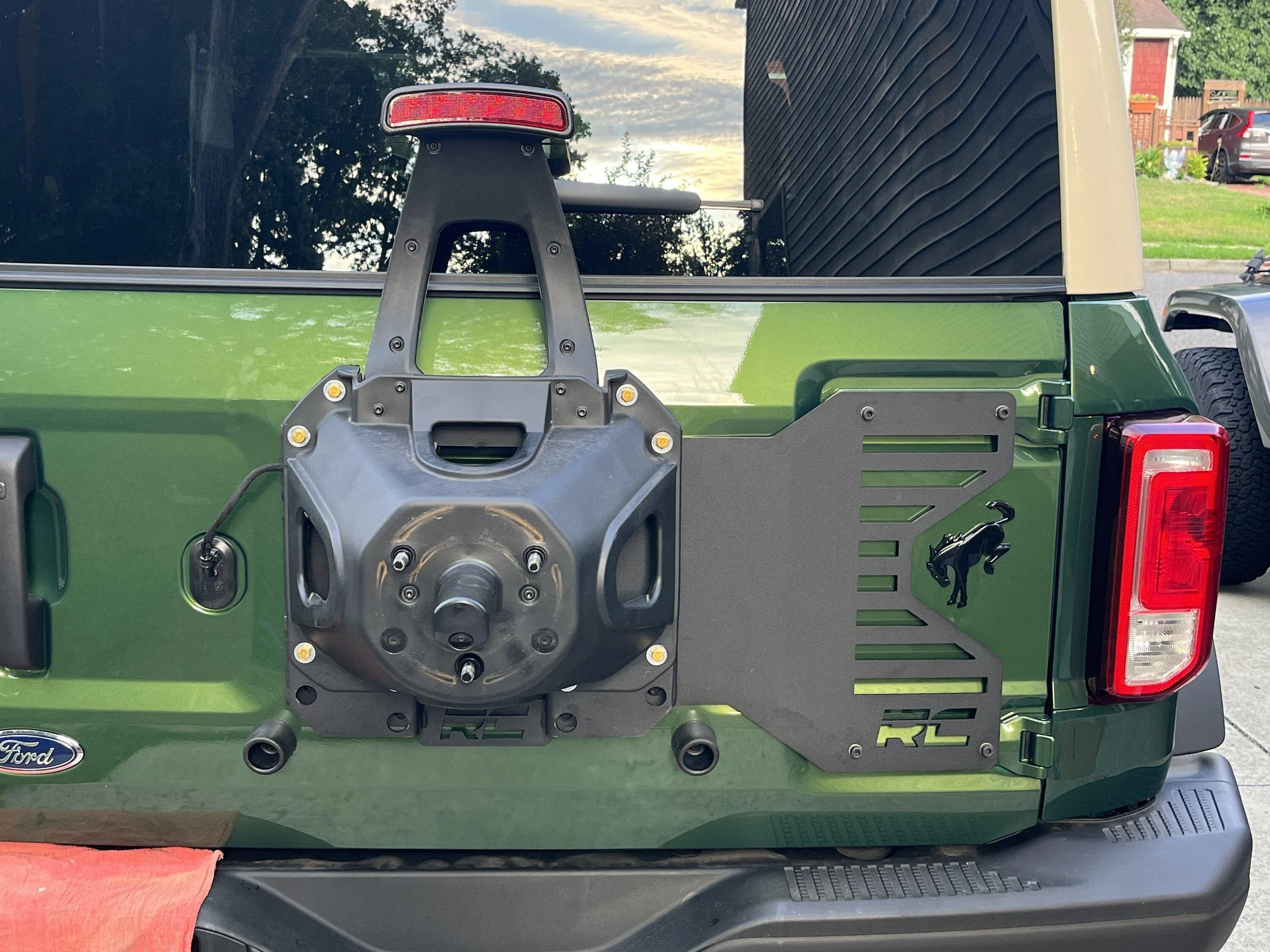

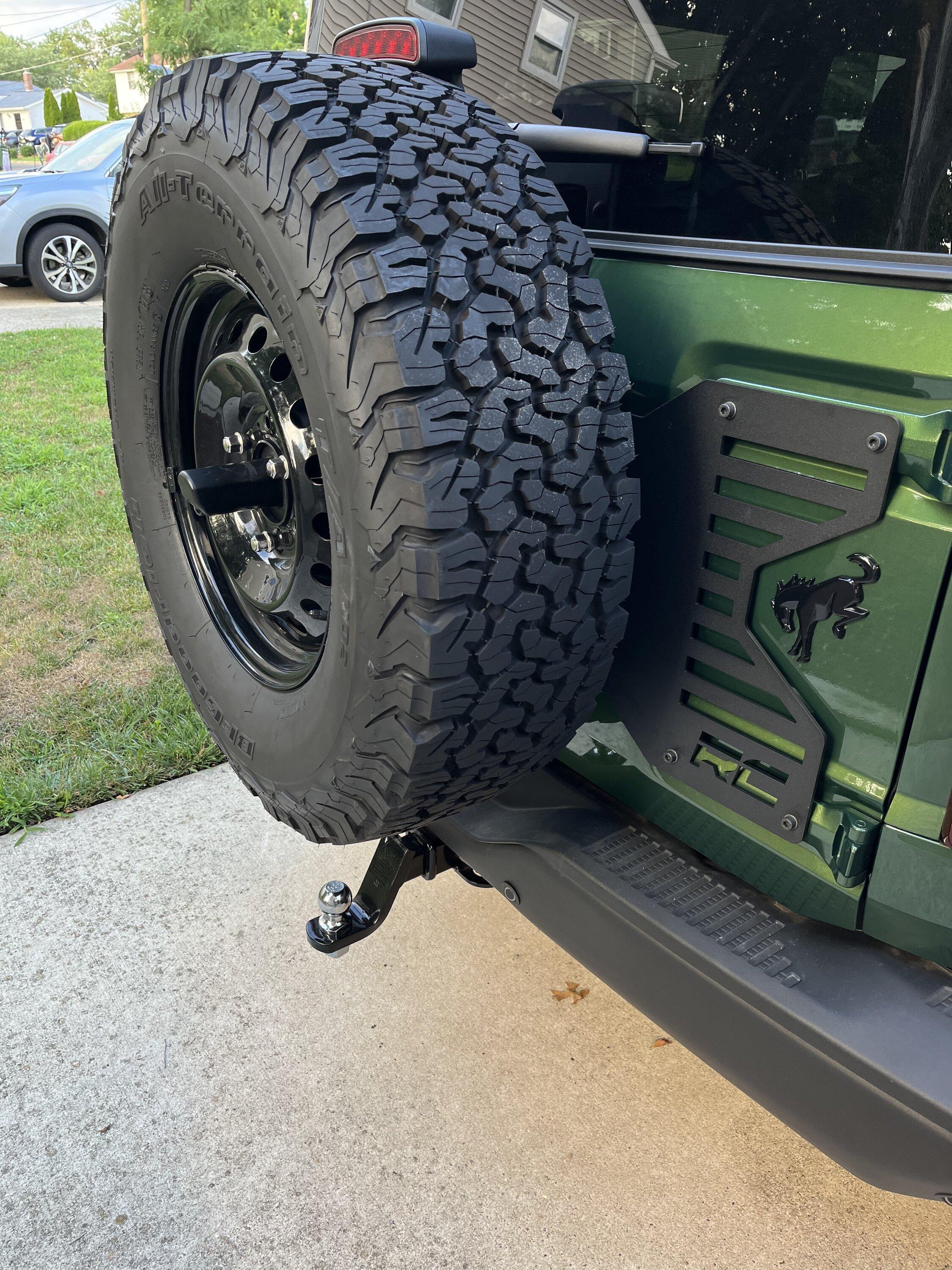

Been a while since I posted here. Giving the credit card a little break. Anyway, I had an issue getting a trailer tongue on the ball. The 33” spare tire sits lower and the tongue lock hits the spare when hitching up. Rough Country has a tailgate/spare tire support and relocation bracket. Got that installed tonight and gained approx 2” of space below the bottom of the spare tire. Makes hitching up trailer simple and supports the spare more on the hinges and less on the tailgate. Only complaint I have is they should have provided all black bolts. They sent gold bolts and silver nuts. Can’t see them from the back (blocked by the tire) but from the side it’s obvious they should be black. Overall pleased with the install and end results.

I ran into the same issue with my receiver ball but both the trailers I haul have enough room I can open the tailgate. It works out great imo cause once the trailer is hooked up and gate is closed the tire is too close to release the latch.
