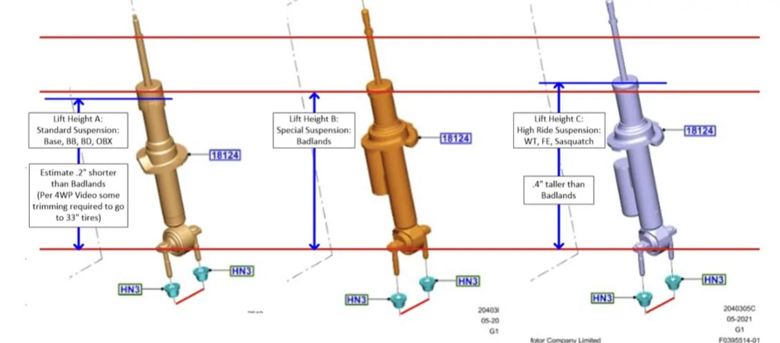

Ford Bronco Big Bend SAS suspension swap 2495B76E-9712-4106-8712-45787EFB76D9
this diagram makes it look like the bolts don’t have a part number for Ford. Luckily the nuts have the same number, so the threads will be the same.
I’m planning on using an air hammer to minimize any warping of the bolts.
