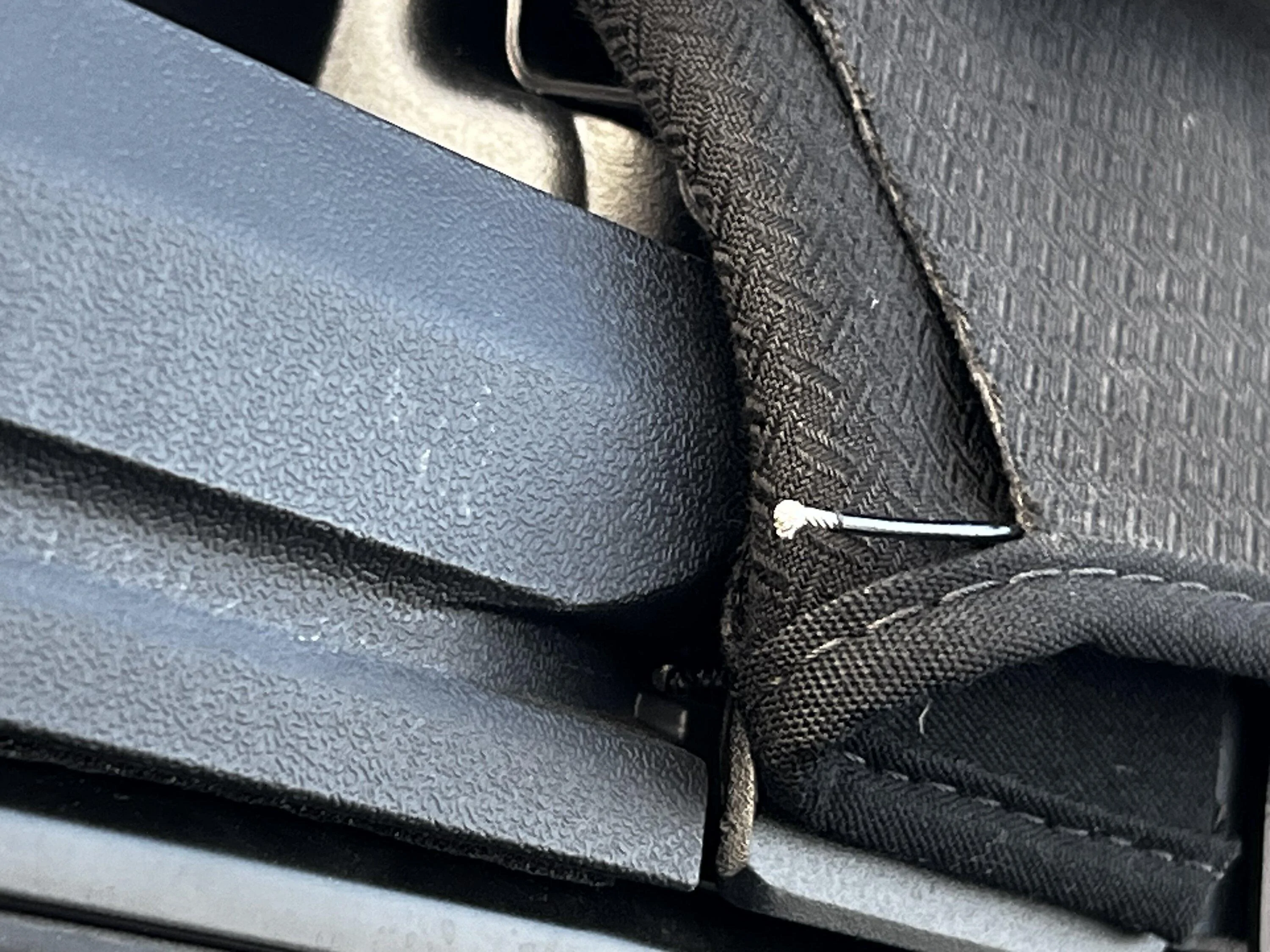

I have the sky rider for my 4d and both tension cables have snapped causing a lot of wind noise and flapping when closed and driving on high speeds. Has anyone else experienced this issue with the cables? Curious to know.

How do you replace the cable? It didn’t look like it had the capability to weave back in.

I had both of the stops on my cables break off too. Waiting for them to ship out a full replacement also.
very simple. There is no weaving. Just tie the end of new cable to the old. Pull it through whe you pull the old one out.

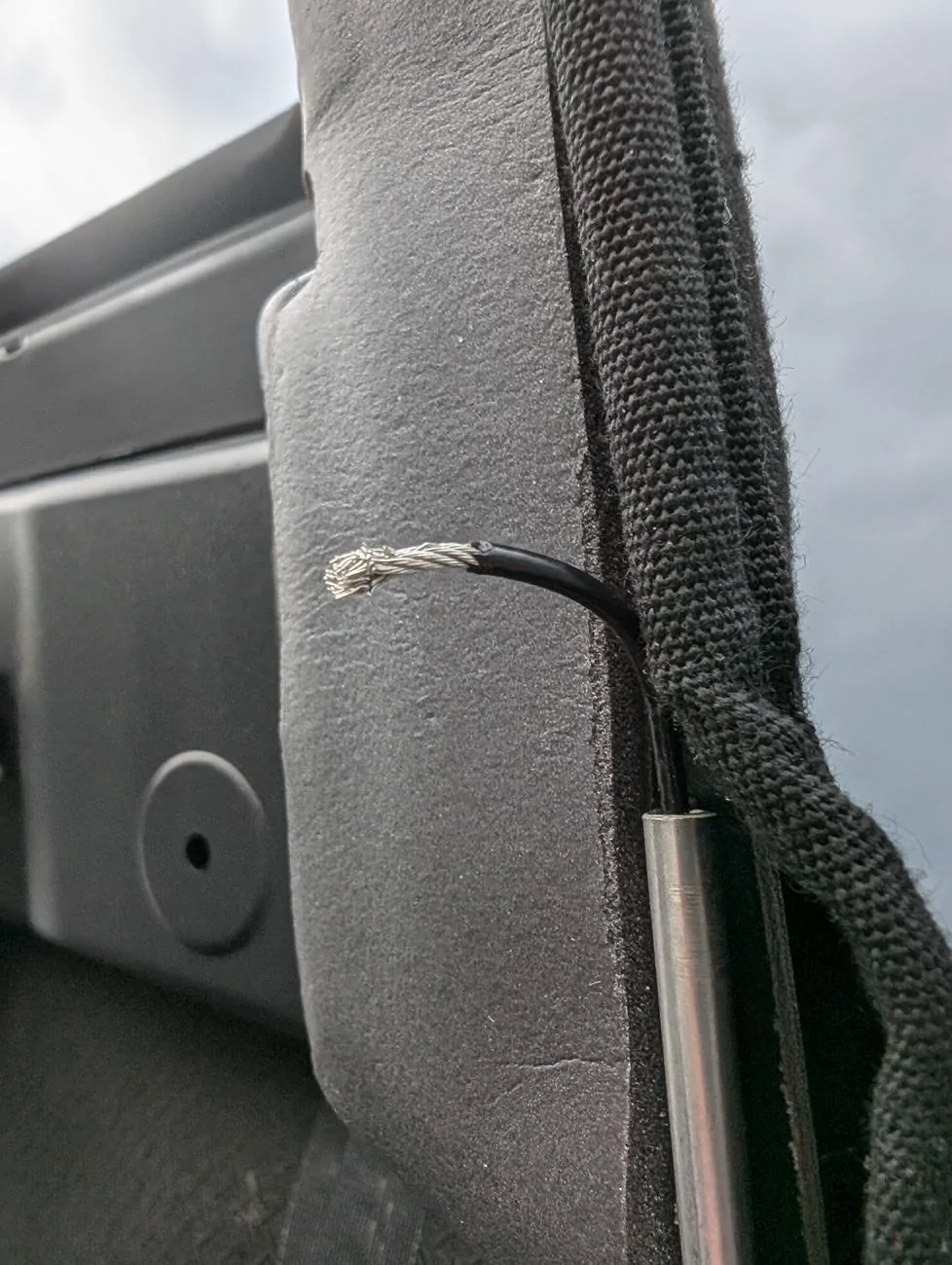

Tension cord on left side broke less then 2 months after install. Light usage and no offroading. Bronco 4 dr Outer Banks. Double version of top. Since I purchase about 4 months ago and waiting to install in warm weather (June 2024) they tell me it's our of return option and the cord is "at least a 90 day wait" on back order...yet you can buy brand new tops!
I'm leaning toward trying for OEM full top and selling at a loss. They don't stand behind the products. I hope to update but they are not offering anything other then "we'll send you a cord in 90+ days"...in other words when it getting cold in the Northeast.
